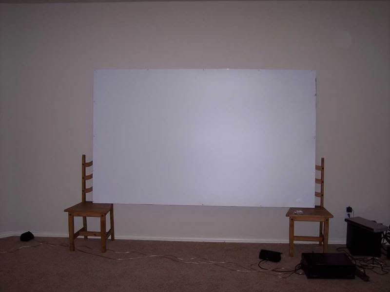

I'd been hearing a lot about laminate countertop material for use as a DIY screen in the DIY Screen forum. After some impressive screenshots of the Wilsonart Designer White laminate and hearing of how well it withstood poor treatment as compared to fabric or painted screens, I decided it was for me. Having four kids from 8 to 14 months means it needs to be pretty stout stuff to survive our house. After propping it against the wall and running the projector on a box, it looked very good.
Unfortunately, I didn't take any pictures of the rolled up laminate or the projected image. Just imagine a big white 5'x10' sheet rolls up and you get the idea.

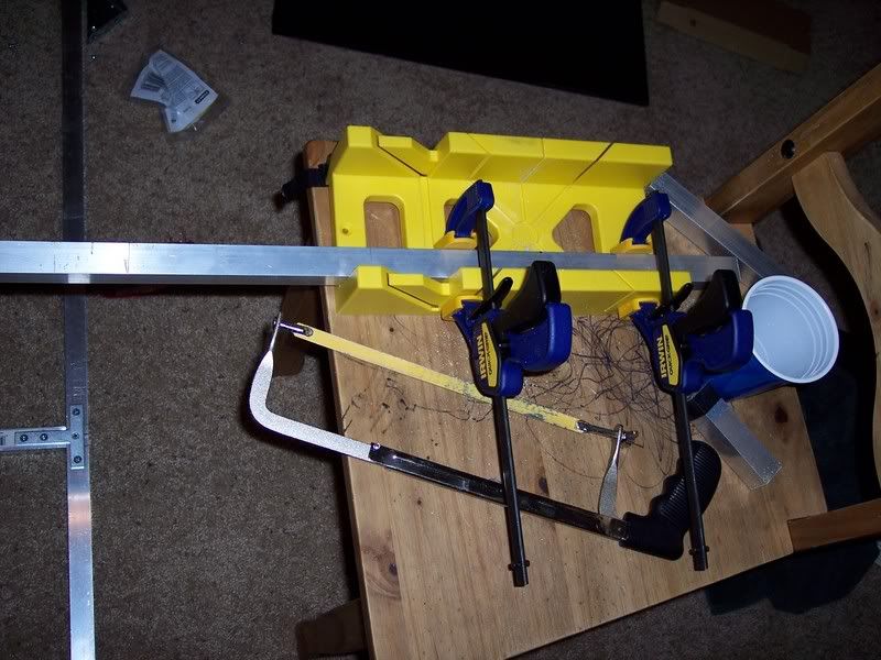

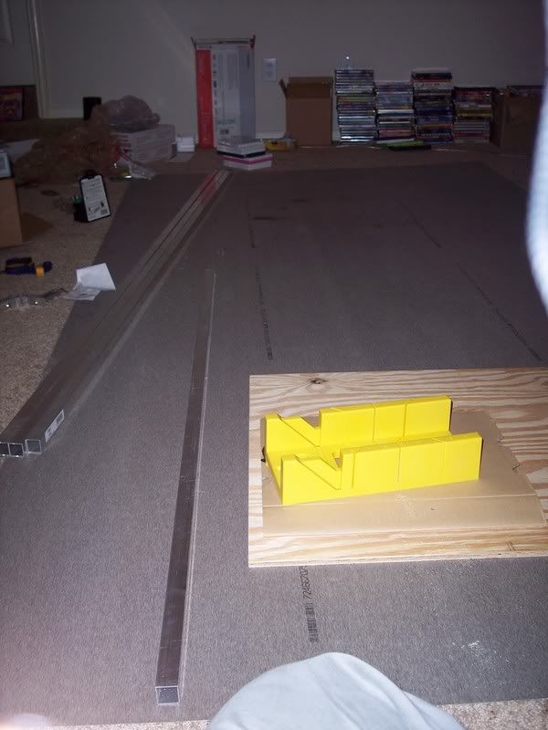

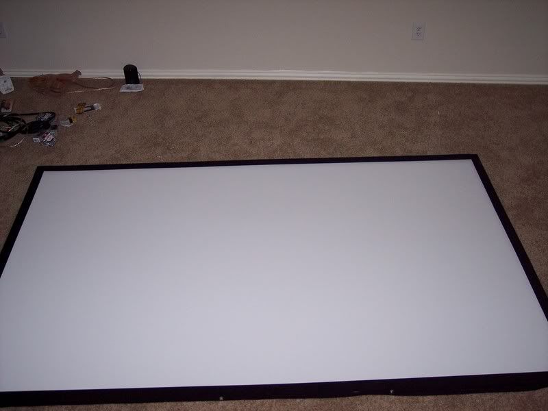

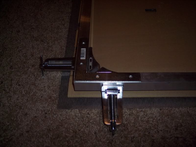

It took me some time to figure out how I was going to mount the frame. After viewing the master DIY screen building thread in the DIY section I decided to go with a frame built of 1" square aluminum tubes. The dimensions will be 60" tall x 98" wide. After the 1" masking is applied, the viewable image will be 58" x 96" with 112" diagonal.
The base materials. Four 1" square x 96" aluminum tubes, the laminate, a miter box, and my knee.
Putting the corners together.
Completed... but not complete. I should have known better, but for some reason I thought I wouldn't need to support the inside of the frame. I was wrong.

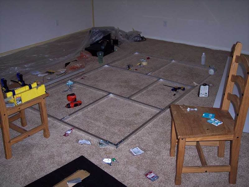

While doing a search for stage pictures, I came across a web page where the owner did a DIY screen with an aluminum frame. Taking some tips from his design, I added some cross bracing. The web page was for The Bridge Home Theater, and I believe the owner is here on AVS. I apparently bought almost all the straight 1" square x 96" tubing from all the Home Depots in a 10 mile radius when I built the frame the first time. There was only one tube to be found at one of the two stores I'd previously bought from. The local Lowes wanted $33.96 for the same size tubing that HD only charges $11.96 for. Fortunately there was another HD within 12 miles that had another straight tube.
Adding the cross bracing. Notice I like to keep my work area tidy. Two 56" tubes placed vertically 32" from the sides (leaving 30" in the center), with one 32" horizontal brace on the outer thirds and two 30" horizontal braces in the center space.
Cutting the new cross bracing.
Now the screen is much stiffer and almost perfectly flat.

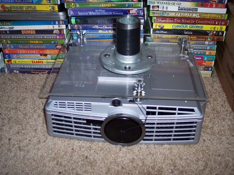

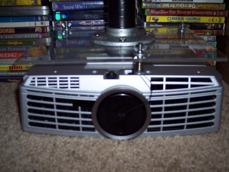

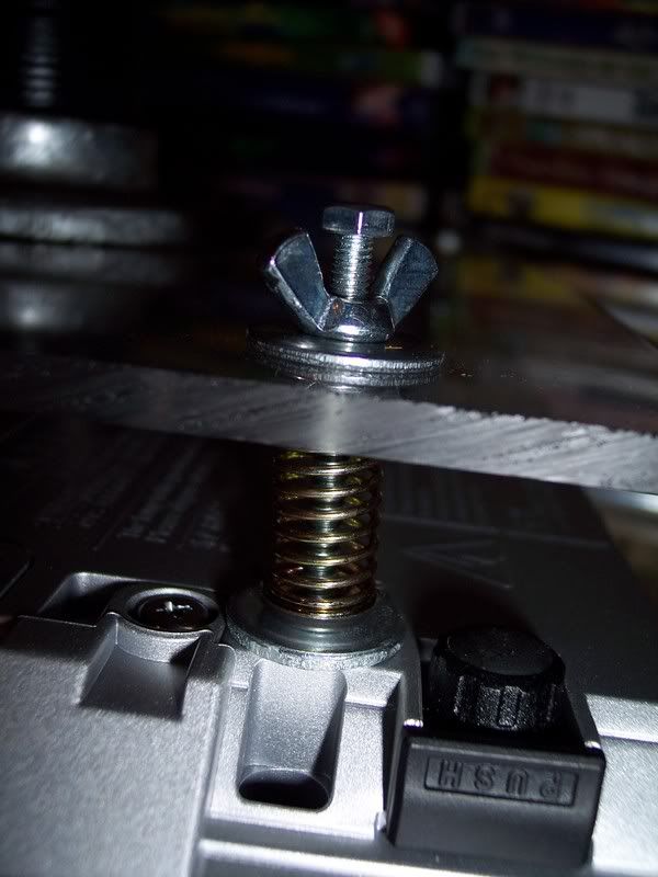

Monkey_Man here at AVS developed a really nice DIY projector mount. In keeping with the DIY sprit of the project, I decided to make one. After taking the time to get all the pieces rounded up, I finally put the proejctor part together.
The projector part of the mount.
Closer...[
CLOSEUP!
Clearer closeup shot.

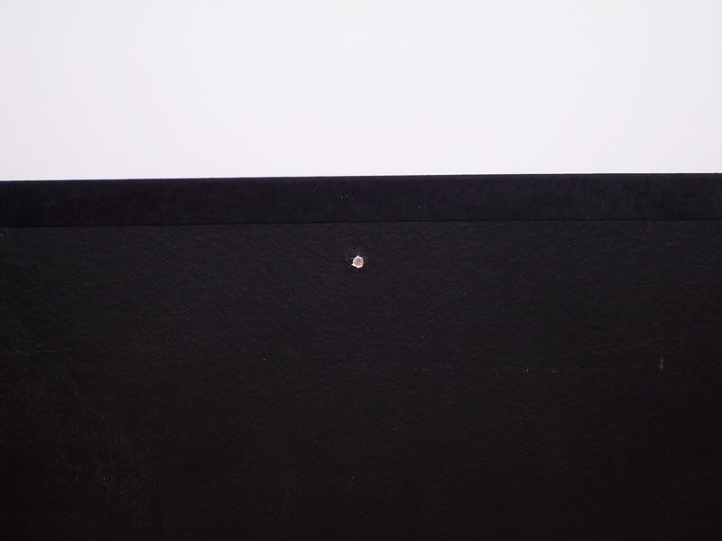

Ahh... Time to paint the screen wall in preperation for the screen. The paint was Glidden flat from Home Depot in their Dark Secret color. Of all the blacks they had, it was the closest to my liking. Eventually it'll be covered by a false wall and GOM/Velvet, but it will make a good base coat and serve it's purpose of absorbing stray light right now.
The screen wall before paint.
The black wall of Savannah... After 1-1/2 coats. I say half because most of the wall was completely covered and there were only a few spots that needed touch ups to get full coverage. Overall, I was impressed. We used a lot less paint than HD said we would, and should have enough to paint the ceiling as well. Unfortunately, the weather turned warm again, so I can't open the windows and air the house out, so painting will have to wait until we dip down into the 70's again. Looks like that's sometime next week.

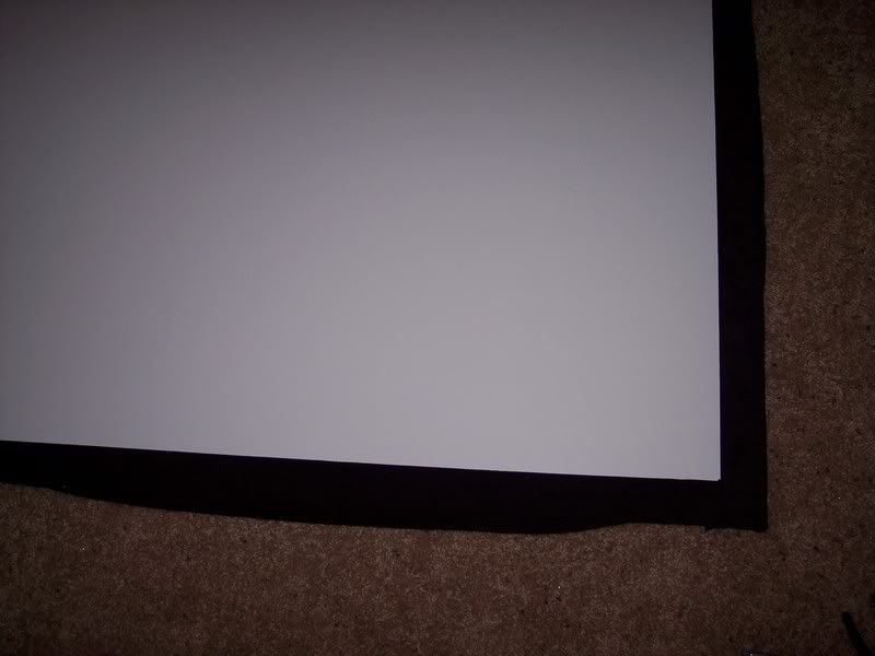

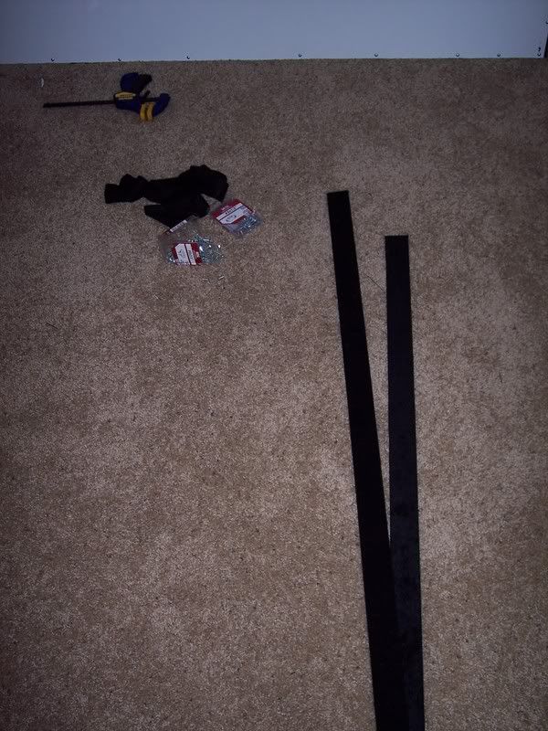

Making the masking for the screen. Here are a few pictures, but it was very simple. I picked up some 1-3/4" by 1/4" wood trim from Home Depot and 3 yards of velour from Jo Anns fabric. I wanted velvet, but they were sold out of black. Still, they seem to absorb the light really well. I used 3M 77 Spray Adhesive to adhere the fabric to the wood. Word of warning: wear long sleeves, especially if you have hairy arms like me.
Basic masking off of the frame.
Masking on the frame.
Adding masking between the laminate screen and frame to hide the frame.

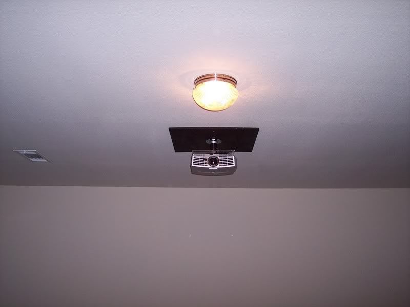

I got the projector mounted! It's starting to feel more like a theater, but it's not anywhere near where I want it.
Monkey_Man DIY mount from the side!
From the front, where the magic comes from.

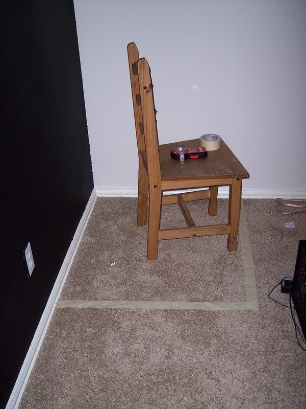

My wife, in a brilliant move to help with screen placement, taped out where the front colums/gear rack area will be.
Left side of screen/side wall.
Right side.

OK, time for an update, lest everyone thing I've been doing nothing.
9/28/2006
Another late night at work finishing up a project deliverable, but I got the screen and frame masked.
The screen is masked. You can see the that the frame masking looks a bit loose. This is because it will be held in place when the screen is mounted to the wall.
A close up of the looseness. The fabric is screwed into the back of the frame at certain spots, but the excess will be used as a buffer between the screen and the wall.
9/29/2006
One step closer... The screen is mounted! The list of things to be done before we're done with phase I is very short now. Technically we're functional, even though the cables haven't been run.
The screen is mounted to the wall using seven #10 x 3" screws and finish washers. There are 4 on the top into the studs and 3 on the bottom.
After screwing the bottom down and re-attaching the masking, I discovered that we've got a nail pop in the sheetrock. I'll tap it down and retexure/paint it this week.
In celebration of our first official Family Movie Night in our last house a year ago, we decided to order pizza and watch Harry Potter and the Goblet of Fire on DVD. Last year we watched it on a 32" WEGA CRT. This year, we watched it on a 112" 16:9 screen. Needless to say, the kids were impressed, and I got a better idea of what needs to be done before the sleepover next weekend.
