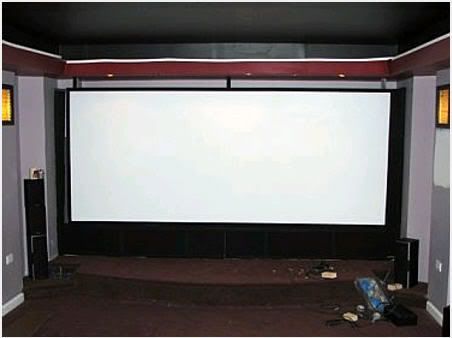

It really depends on your design plan for the treatments even floor to ceiling treatments are often done on frames, I assume you have seen many of the theaters on here and seen the various types of framing treatments. I chose to go with an art deco theme and so made my panels and columns to reflect that fabric is staples to frames and then trimmed with moulding which is not yet up in this picture. The part with the spot on it is the column.
and based on the thread title here is my screen wall though not the best shot of it.

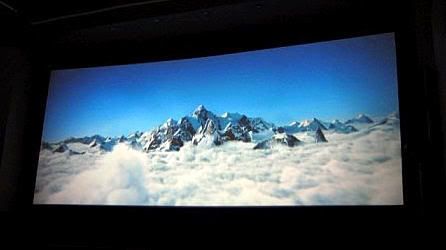

I am not completed "the finish" but now got lazzy and its been like that for few months in the same way. I want to thank lots of members for giving me the tips and knowledge.
I took my own way of 140' of curved screen. Bought 12 foot pine 2X1 wood and made a frame. then used black out cloth 4 yard and streched to the side and stappled it. border I used some welcro. Then fastened center of the screen almost 10 inches and pulled the sides from the straight line and fastened just with wood blocks so I can take it off when ever I want it. Pretty cool screen for just for $80.00
Those who want to know more I will give all the details of How I made the screen and curved. Happy to post in this thread too.
I use self made box with two prism to make the image to 2.40:1 ratio.

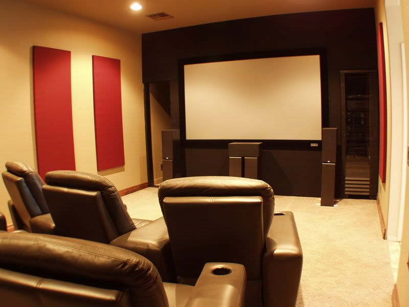

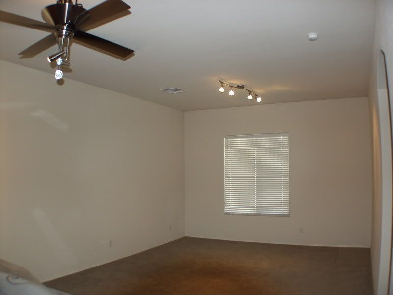

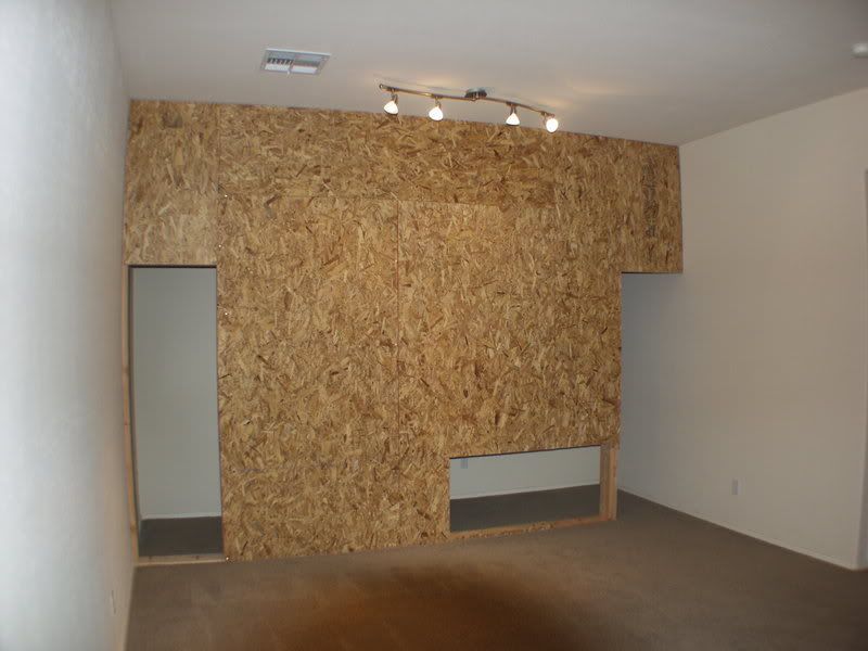

It seems as though the wall and columns are framed out and painted black. It also seems as though some then build a smaller frame and wrapped the fabric around that frame and used velcro to attach that piece to the wall and columns.
That's how I did mine,,,,, (except I screwed the panels in place from the back side of the screen wall.)
BEFORE,,,
DURING,,,,
AFTER,,,,

Verrot, looks good, but what is going in the space on the far left?

I guessing that is for access for verrot to get behind the screen wall, or a future second rack ?
Calvin is correct,,, it's for access. It will be a treated hidden door. I have the door framed, I just need to cover it with insulation and GOM, then install. I made the mistake of starting the next project on the list before I completed the door.

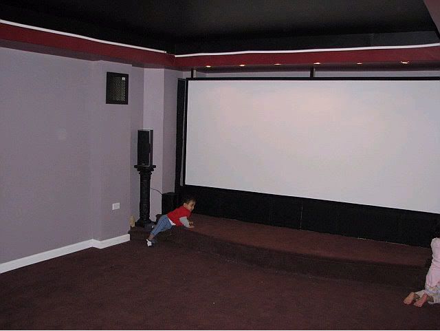

Before:
Before the 10ft wide SMX 1:78 screen went into place:
After:

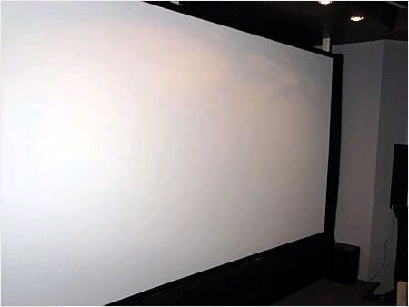

Here is a pic I took as the screen system went in.

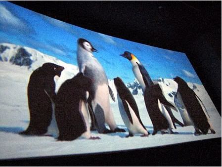

Digger scene fom Matrix Revolutions:
