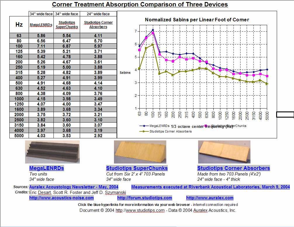

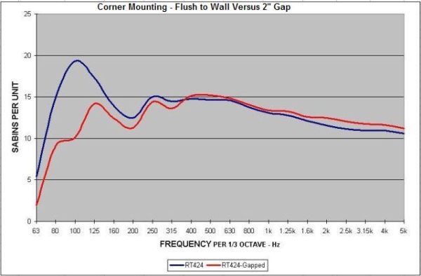

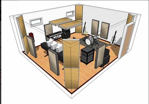

$20 a yard for the GOM (including shipping) from GIK, but I want to match the GIK panels which have the FR701 black 408 color, so what you gonna do? Got to match the existing GIK panels I bought a few years ago...
CREATOR: gd-jpeg v1.0 (using IJG JPEG v62), quality = 100

Originally Posted by nathan_h View Post
Yeah, though I am much more worried about the waterfall right now. Even with a lot of bass trapping (think a half dozen traps) and Antimode, set to flat, my response below 100 is really out of control.
I am certainly no expert, but I see no bass trapping in your room. I read through the last two pages carefully but couldn't find any absorption deeper than 3 or 4 inches, which results in plenty of mid-range and high frequency absorption. You mentioned that you were going to fill the 8" gap behind the baffle wall with insulation, but looks like you chose to glue some mid-range absorption behind your screen instead. Superchunks stuffed in every corner possible with a reflective membrane on the front surface is your best bet. Wide panels straddling the corner are a reasonable option but they need to touch both walls. Again, this is just my understanding.
As you can see, impacting the lower octaves (<60 hz) with broadband absorption is a wasted effort. The first graph is per linear foot and I the second is for an 8 foot length I believe.
I'm sure you have seen all these before, but this is what I base my opinion on.
Love the Asian carpet by the way, though running it up onto the riser looks like a potential accident waiting to happen.
[IMG][/IMG]
[IMG][/IMG]
