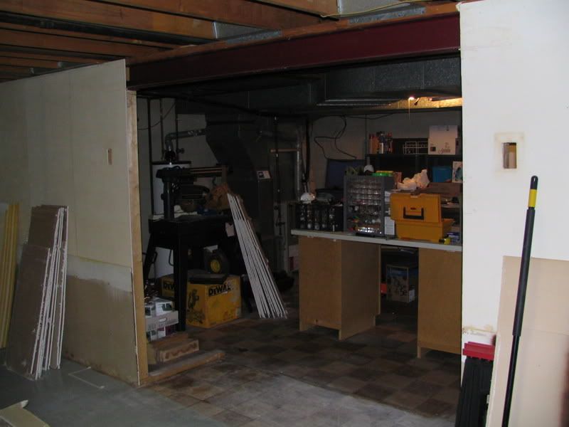

I was able to get a little more done this weekend. The cove that used to be the bar needs to come out and a regular wall put in it's place.
Start of wall removal
Paneling down, now for the drywall and studs
Wall gone - exposing the chaos that is my workshop
New wall in place. Looking from workshop towards theater
Finally a step towards building something new instead of just demolition.

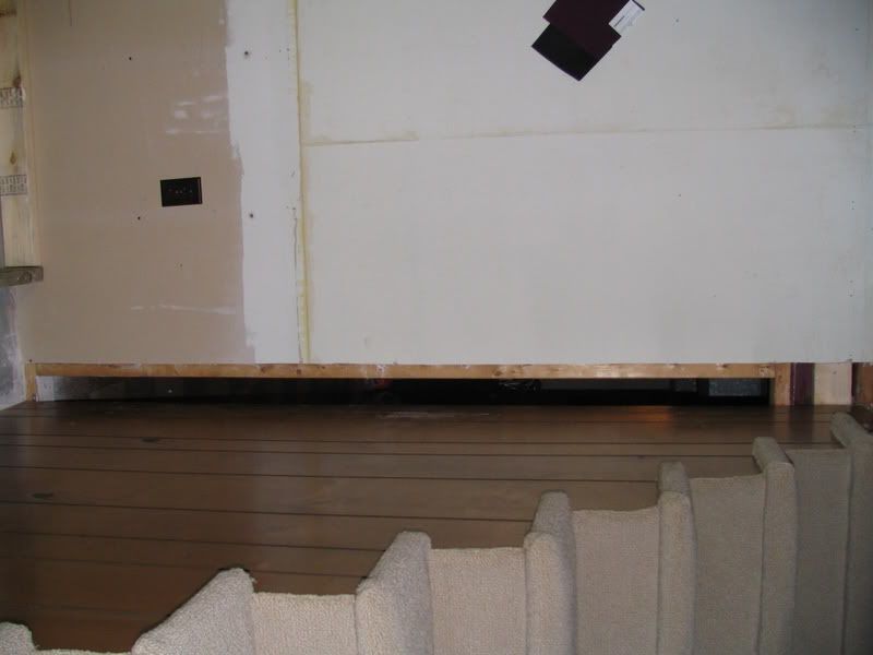

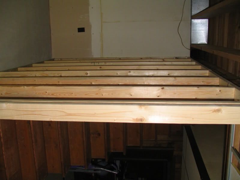

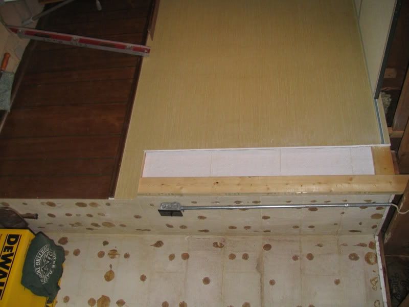

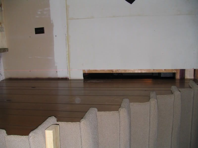

I finally have a real room. Sort of... At least now I have 4 walls. I spent a good portion of the weekend manipulating the existing structure to get the back wall in place.
I had to trim off the drywall, add a few nailer boards for the existing drywall, and add a section for the new wall to nail to.
Drywall trimmed. I love the laser level
Here is the 2X4 added for the new wall to nail to

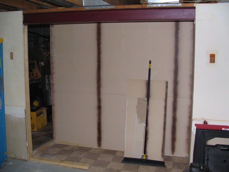

Now for the other side of the wall. I had to remove the drywall and paneling to see if I had to add something to nail the other end of the wall to

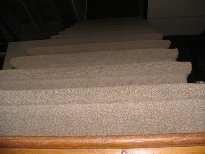

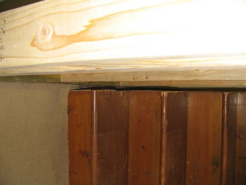

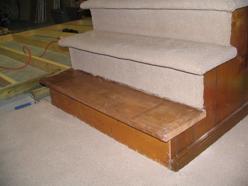

The carpet on the steps needs to be removed so I can trim the stair tread flush with the wall. One down, millions of staples to go
Carpet removed, treads trimmed, wall built and in place. I have a few more fasteners to add and the remainder of the door to frame out but I say it qualifies as a wall. The theater is officially enclosed.
You can see the existing make-shift theater in the background
The stairs aren't square (big surprise) so there is a larger gap at the base of the steps then there is at the top. I will deal with that another day.
That's it for now!

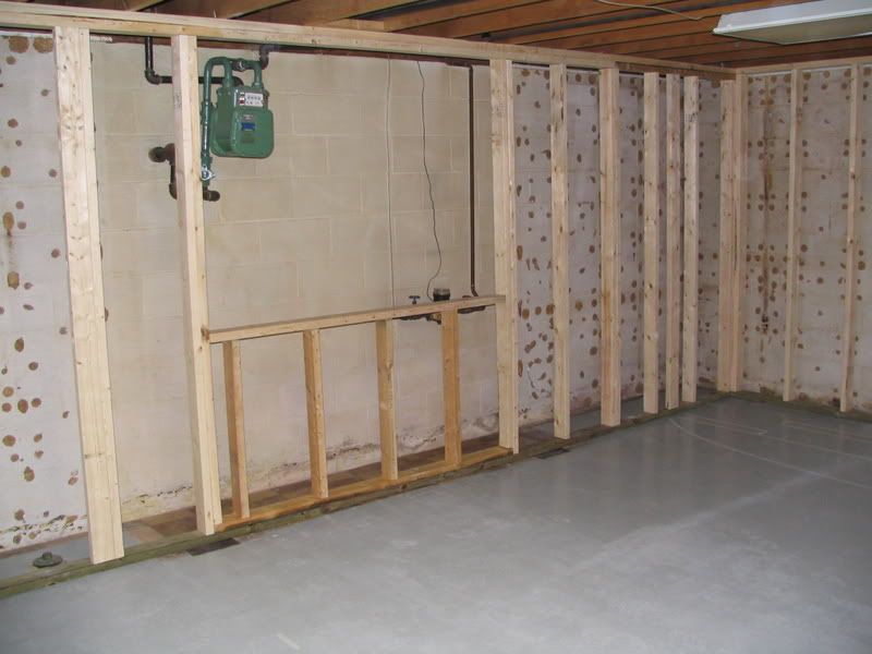

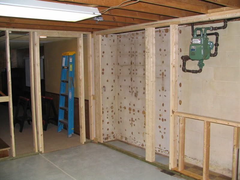

Yesterday was a big day! My Dad came over to help with the framing and we ended up finishing 95% of the walls. I have a couple odds and ends to finish but not much more than a few hours.
We finished the left side first as it had the most work to do. Right inside the door is a cove that will be a snack bar/storage area, to the right of that will be a column then a false panel to access the gas and water meter. Still have to figure out how to finish that out. There will be more framing on the upper part of that opening. To the right of that will be another column. It is about 5.5 feet between the columns.
The front wall is done too. I still have to build something to cover the window that would be removeable if I ever needed access. You can see the tape lines for the stage on the floor.
Here is another shot from the front wall looking back at the snack bar and the entrance.
And one last shot showing the left walls distance from the block.
Next comes the addition of an air return, lighting and electrical, and then drywall.

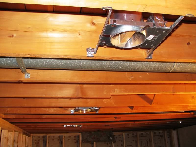

Well things are moving pretty slow with the construction but I have had a little time to sneak off to the big box stores for some supplies. I also have been scouring the web for deals on electrical products.
I got 6 of my can lights installed. I decided on 3 zones:
Zone 1 - 6 Halo H5ICAT 5" cans (general seating)
Zone 2 - 3 Halo H36TAT 3" cans (screen wash)
Zone 3 - 2 Halo H36TAT 3" cans (snack bar cove)
I ended up getting all my cans from North Shore Lighting online. Great service, excellent prices, and only one state away so shipping is quick.
Zone 1 cans are up, zones 2 and 3 are in the mail.
These are so easy to install. I think I did all six in about 15 minutes.
I also picked up all of my boxes - a variety of Carlon low and high voltage.
Since I have Boston VR965 speakers with subs built in I need power behind the stage so I got 2 Leviton surge protector outlets to plug them into.
Hopefully will have some time this weekend to get rolling on the wiring...
