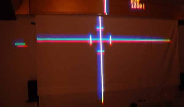

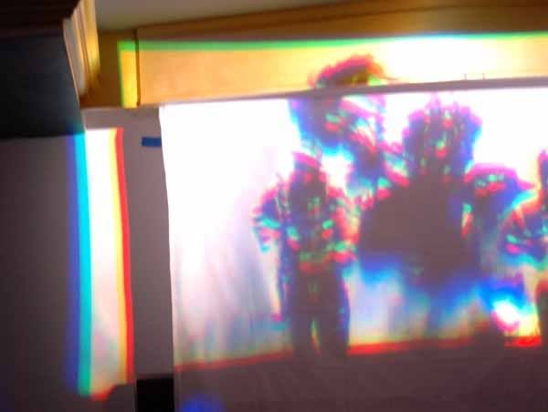

First the good news, then the onto the fun.
HDMI cables arrived (my almost two year old intitially wore them as a belt and declared them pretty). I brought the PS3 down and went PS3 via HDMI to Yamaha V661 receiver to Moome ISS HDMI card in switcher to PJ. Everything went good, which was a relief since multiple HDMI connections can create snafu's, especially with a boutique product like a moome card which ads HDMI to older technology.
Dropped in my only SACD, Dark Side of the Moon (figured I'd try them out since the PS3 can play it), and had music while I monkeyed around with the PJ. The machine is not level. But its not as bad as I was thinking. I deleted all the old input memories and it made things better. Here is convergence at the begining of the night in an old input memory.
Here it is in the new block, after I midpointed all the settings. Its a bit better.
If you display a red-only image it doesn't look too bad:
But in realitly, it still sucks (both images from transformers trailer on PS3):
I am leaning towards taking it down and redoing the unistrut. Do you think one person of okay, but nothing great strength can handle taking down the PJ alone? I'd remove the lenses to lessen the load. I can wait for help on Monday, but it compresses time if I need to take it down, redo the strut and rehang in one evening while my friend is there. I am debating whether to take it down so I can do the rebuild on Saturday at a more liesurely pace, then my friend just has to help me heave it back up.

Fix the out-of-square condition. You can measure using a long tape from one corner of the screen to an opposite corner of the PJ, then reverse using identical reference points at both ends. When both measurements are equal, the PJ will be square to the screen.
Level the projector in both axes.
1) Register a new signal with a representative input resolution (1080i probably a good choice.)
2) Write down the white balance settings, just because. Seriously... do this.
3) Clear the memory by using -NORMAL at the top level of every menu option EXCEPT WHITE BALANCE! That is, Adjust, highlight Alignment, hold down the CTL key and hit the NORMAL key, then answer NO when prompted. This will set to zero (or mid position) all the settings in the Alignment menu.
Do the same for the other menu items, passing over white balance
Do the same in the Operate menu for static and blanking.
4) Remove the lenses and use the Coffee Can Lid trick... punch a small hole in the center of a can lid of appropriate size, use this to center the crosshair on each tube face with the centering magnets. This is critical to cool electronics.
be aware that the red centering will move slightly when you close the oscillator board. Observe this and try to compensate by over-adjusting the centering magnets on the red just a little.
Set the stepped scheimpflug rings on all three tubes for your screen size per the chart inside the lid.
6) Replace lenses, bring up the cross hair test pattern again. Angle the Red and Blue tubes to line up the cross hairs horizontally.
7) Use the centering magnets again to line up the cross hairs vertically. Remember the red drift when you close the oscillator board!
There should be very little adjustment needed... if there is a lot of vertical to make up, go back to the coffee can lid and check the three tubes again.
NONE of what I just described above uses the electronics at all (that is, no electronic adjustments have been made yet.) This is a reasonable first mechanical setup procedure.
Some other tricks I've learned:
Your eyes will see blue relative to red a lot easier than green, so when lining up or converging line up R to G, then use the G defeat and line up B to R.
The adjustments in NECs go (very grossly) Static (little should be needed if the mechanical is good) followed by Alignment followed by Convergence.
Controls within the Alignment and Convergence groups often interact... for example, you can pull out keystone with one control at max, but it is better to use a little bit of the several controls that effect the desired adjustment. This will become obvious when you are doing it.
Above all, FIX THAT MECHANICAL!

Just saw the pics... The PJ is probably too far back, by at least a foot. Using Amplitude to fix this will guarantee you are using too little tube face.
Unless you are working with a wear pattern, you probably want to fix this when re-doing the strut.

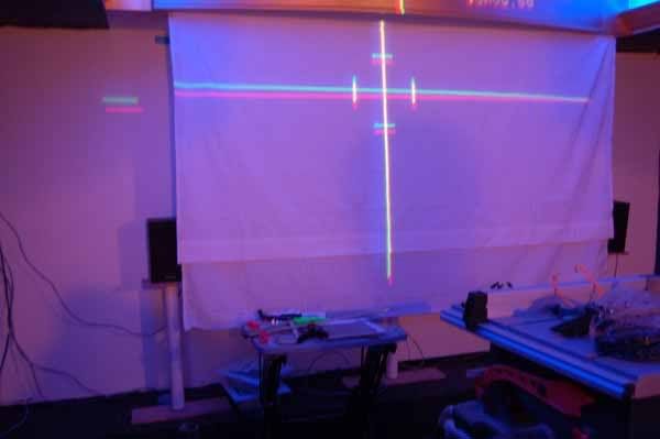

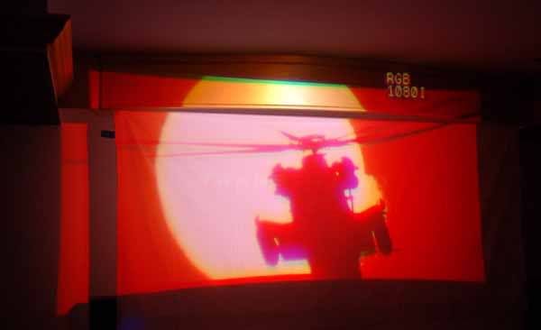

Well my buddy rescheduled till Wednesday. So my wife and I spent some time getting the mount as level and square as possible. I think we are there. We also hoisted the PJ like a turtle onto sawhorses under the mount.
I sparked it up, adjusted nothing, and the PQ is much better. Still out of focus, and needs some work, but the images are recognizeable (if mostly on the floor). Here is that transformer shot. Still rough, but much better:
Here is a close crop of another shot. Still a mess, but not a disaster.
Probably take tomorrow night to finish my non-HT projects, then see how we do on Wed/Thur before the in-laws show up. Cutting it close.
