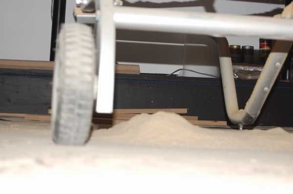

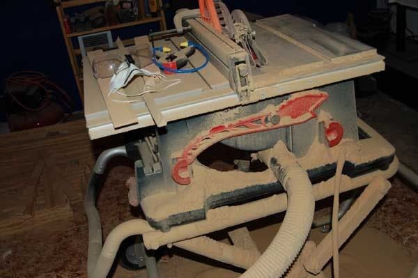

Okay, a bit of progress. I finished cutting my mdf into 2" strips. So the ply is cut, the mdf is cut, next step is beveling the mdf, then its mitering and frame assembly. This could take a while.
Here is the 200 or so pieces of trimmed mdf. They will all need to be re-fed through and a bevel added.
Dust went everywhere. I tried to vacuum after each session, but it was time consuming, so towards the end I was just plowing through. The dust mask was an MVP. I added the binder clip to prevent it from fogging my glasses. worked well.
Here is the mini dust mountain under the saw.

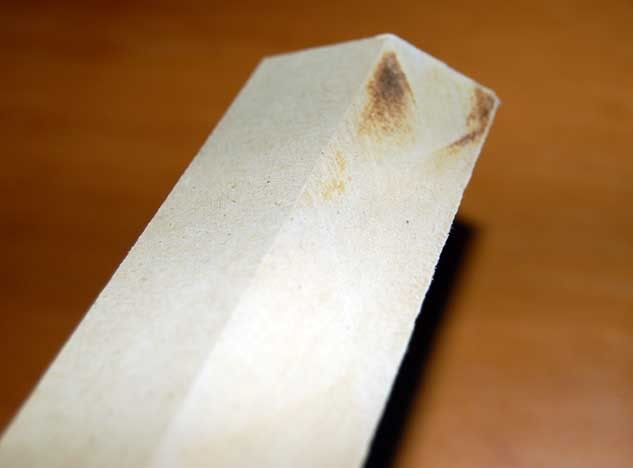

Back in business. Sort of. Tonight set things up to bevel the mdf. I cut enough to make a mock up frame, but the miter saw is in the garage under the baby's room, so couldn't take it further.
Adding the bevel adds quite a bit of resistance in terms of pushing the mdf through the tble saw. So much so, that I guess it was smoky (none that I saw), and set off the fire alarm. The fire alarms are networked in my house, so all the fire alarms went off. My daughter slept through it, which was a big break. I yanked the detector off the ceiling, which ment it still went off a couple more times on battery power, but the rest of the alarms in the house didn't go off.
The mdf showed a few schorch marks. But really not too much. Here is a couple pics of the one who showed the most. Really not too much. Should I get a better blade to cut the mdf better?

I got scorch marks at the end of my MDF bevel cuts also. Some strange force causes it to want to twist at the very end of the pass. I agree with McArthur, the GOM covers up any flaws with the bevel cuts.

Thanks for the comments guys. I am quite concerned about the even-ness of the cut. I am not super concerned about the scorch marks showing through the fabric. But to be honest with you, the bit that concerned me the most was that the force required to push the mdf through the saw makes me worry that I am stressing the blade too much. I am not sure why having the blade on an angle makes the cut more difficult, thinking about more I guess the surface area cut is about double the straight cut, but its an effort to feed the mdf through. I'd say the effort is a 5 or a 6 out of 10, whereas the straight cuts were a 3 or so. I am a little paranoid because I am a leg amputee from a brushwacker that had a circular saw blade fracture.
I think I have convinced myself to swap out the factory stock blade. I'll start researching which blades cut MDF best. Any recomendations?

Well looks like I should get one with at least 50 teeth, and carbide. I'll see what the stores have. I don't remember what the stock blade for the bosch was. Probably not that.
Q: What should I use to cut and mill MDF?
A: MDF can be treated much like a fine grained hardwood. Its high glue content means that steel cutting tools will dull VERY quickly; thus the use of carbide tools is highly recommended. Always keep your tools sharp for efficiency and safety.
The following recommendations are from the The National Particleboard Association publication:
* For general shop or table saw use with decent cut and good blade life, a 50 tooth, 10 inch combination blade may be used.
* For those demanding a better cut, consider a 60 tooth, 10 inch blade with alternate top bevel (ATB) teeth at 15 degrees, 10 degree positive hook, 5 degree side clearance, 10 degree outside diameter clearance, and low approach angle (blade projecting no more than 0.5 inch through top of material).
* For an even smoother cut, consider an 80 tooth, 10 inch blade with 15 degree ATB, 10 degree alternate face bevel, 15 degree positive hook, and 7 degrees side clearance. This is costlier and may result in a shorter blade life.

Long rip cuts can be difficult and scary, especially with a bevel like that. A hold down or two mounted to the rip fence would add some protection and probably give you a smoother cut, as well. I would post some links but the system won't take them since this is my first post. Options range from Board Buddies (search Amazon for Board Buddies) to a feather board (search for Bench Dog 40-011, as an example). Feather boards are easy to make if you have some solid hardwood scraps laying around. The idea is that the feather board is mounted vertically, clamped to the rip fence, so it holds the MDF tight against the table as you push it through the blade. The uneven-ness in your test cuts probably resulted from the MDF lifting up slightly when you repositioned your hands during the cut. A feather board or equivalent hold down helps prevent that.
A new blade would be a good idea, too. I wouldn't spend a lot of money on a blade to cut MDF, unless you're interested in finding someone to resharpen it for you. MDF is really tough on blades and by the time you're finished making all of those bevel cuts, the blade will likely need to either be resharpened or replaced. A 50-tooth thin kerf combination blade in the Diablo line of Freud blades would probably be adequate for your needs (search for Freud D1050X Diablo).
[snip]
This is a good and helpful description. Thanks for making my thread the first you posted (& welcome). I am new to the table saw, had a related thread where a featherboard was mentioned, and I have one that applied pressure horizontally. It was in the way of my push stick when vertically oriented. I did clamp a longer piece of wood to the fence, but I might need to make it a tighter fit. The board buddies thing is intruiging too.

The mdf showed a few schorch marks. But really not too much. Really not too much. Should I get a better blade to cut the mdf better?
Hey DC - just finished doing the exact same cutting for my panels (although I used lumber vs. MDF) about 30 minutes ago, and I have an idea as to why your scorch marks are there at the ends....check your throat plate on the table saw - I found that mine was not perfectly flush, so that when the very end of the wood would pass the throat plate, it would 'drop' a couple thousandths of an inch and bind against the blade a little. I ended up shimming mine just a hair to get it flush, and the problem went away. I did also notice the bevel cuts were harder to push through as well - perhaps just because there is more material to chew through (plus my impatience to "get 'er done" ).
Thanks will do. I had to google image search to figure out that the throat plate was though. . . That is a logical reason, my assumption was it was my failure to apply consistent pressure while feeding the material.

Got a later start tonight. Swapped out the blades for the 80T Diablo. Found a big part of the problem, the old blade was dull. I guess 150 cuts of 1/4" ply and 200+ cuts of 3/4" mdf were enough for the factory issue blade.
The new blade cut well. The bevel cuts still more effort than the straight cuts, but I don't feel like I am forcing it at all. Got 20 of my 200 cuts done before I decided to cut the night off.
Live and learn. Didn't expect that the blade would dull in a relatively short period (albiet with a good number of cuts). But what I read this morning showed that mdf is a real blade eater.

Glad to hear you're back in the game! With a new blade, now you'll have enough kerf/sawdust at the end of this to sell to the neighbors for their gardens!
