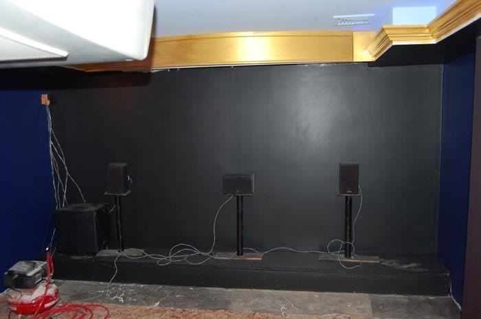

Just got the official word that my company wants to promote me and relocate me to Pennsylvania. So we are going to have to sell the house and the theater.
Since the theater was only 80% done we are hustling to get it into a marketable condition. So no more fabric frames (we moved the mdf and wood to the garage over the weekend), some custom things will be scaled down.
Here is the plan to get to sale-able:
1. Paint the screenwall black (done)
2. Fill openings in rear soffit & paint black (half done, won't be a bass trap now)
3. Put finished coats of blue on the walls (half done)
4. Wrap columns in fabric
5. Frame tops of columns with vellum paper instead of frosted glass (tested, looks good)
6. Add baseboards and other moldings (cover staples, add bottom piece to crown)
7. Either - build fabric screen wall and use some of my SMX, or make a non-AT DIY screen (leaning towards the latter but will require some tweaking of the CRT PJ - which I stink at)
8. Carpet, add a love seat for staging
9. Watch as many movies as we can assuming we aren't busy with move-prep
Could use some input on #7 - I am kind of torn since the false wall is a big part of the clean look, but it might be a waste of the SmX since the next buyer might not want it, and the next theater might have a different screen size.

Man what a bummer, for me anyways. You're close and I was hoping to be there if you ever had meet. What a turn of events, especially with you being so close to the finish. Congrats on the promotion and best of luck with the move.
With number 7 you can get some of the Dazian Celtic cloth or you can get the AT screen material form SeymourAV if you want to hold on to your SMX. Good luck.

Dave, congrats, though too bad on the loss of the hard work that went into this one. Of course, there's always 2.0, taking the lessons from this one.
I had a Parkland Plastic DIY in my first apartment setup, and it was great (and cheap/easy to build to boot!). Granted, it means you need to have visible speakers, but for most buyers, they won't even notice, and the few who do, you can tell them "well, here's a link to SMX screens for an inexpensive way to do what I originally intended for $XXX")
You could knock out a parkland screen in 3-4 hours easy, a little more if you go with flat black trim (which I eventually did).
If you don't have the false wall built yet, then DEFINITELY go with a DIY non-AT, for cost and speed reasons...

I am vaguely aware of Parkland (I have seen wilsonart mentioned also). Any thoughts on a source for that? I am leaning towards the non-AT screens. We have a lot of other projects to do.
Heh. I know how that can be.
I ordered my Parkland direct from them, as I needed a 5x10' sheet. I'm not sure if they still do that or not (working for an integrated e-commerce and manufacturing company, I can't see how fulfilling small orders like that could possibly be worth their time...)
If you need 4x8' or smaller, people on the DIY screen forums swear that you can find appropriate material at HomeDepot or Lowes. I never looked hard, as I needed the bigger size. Next time I'm there, I'll have a look if I remember. (It seems like since we bought our "new" house that I might as well get my paycheck direct deposited at HomeDepot... )
I had built a fairly ghetto blackout cloth screen originally, and wasn't satisfied with it, and don't think mine would have looked "right enough" for a home sale, but perhaps if more carefully done, it would be OK. I eventually put the blackout cloth inside of light-block curtains, so I can't offer it to you, but it's readily available at fabric stores.
The plastic is way easier though. If you hit a home store, look for something that's bright white but without any real gloss. Some texture (even like 80-100 grit sandpaper) is fine, but you don't want something with a lot of gloss, but rather a diffuse white. The Parkland was originally intended for laundry room type wall coverings. I'm virtually certain this is the product I used: http://www.waterproofpanels.com/polywall.shtml
I built a frame from 2x3 lumber, with luan plywood on top (obviously build this as flat/planar as you can!), and the plastic was contact cemented to the luan. A couple of French cleats on the back and some pine trim painted flat black on the front and I was done.

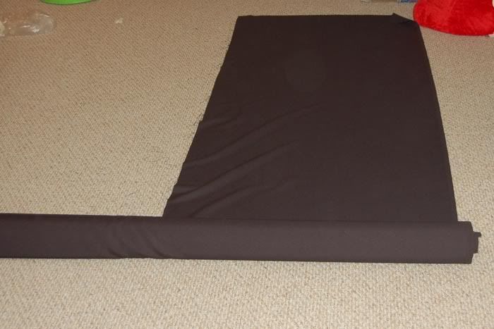

Well we've been scrambling to get this place saleable. I have to admit, it is really bitter sweet to be building a theater for some one else. I harbor a secret fear that a buyer might rip it out.
Step one was to paint, starting with the screenwall going black (makes a HUGE difference)
And we added finish coats to the side since they won't be fabric anymore. We went with an eggshell finish since this is for resale. The box containing the sump hasn't been repainted:

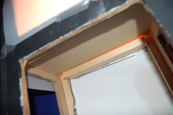

Also been tinkering with the column sconces. I have some velumn paper up in this test shot. Gives the frosted glass look. I got some plexiglass that we'll add later:
Here is an under shot to see how much light will bleed into the speaker area, not too bad:

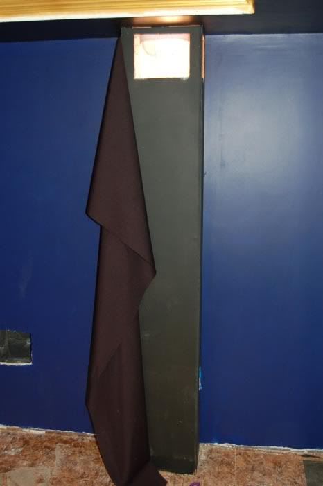

We started the fabric wrap of the columns. First cut the fabric:

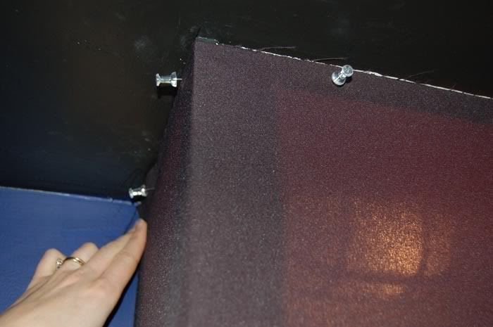

Then tack (we'd lose the tacks over time. We are down to 3 after completing the wrap of 5 columns):
The fabric draps a little when tacked. IT is a real challenge to keep the fabric taught. The first column and a half took us about 2 hours. It got much faster as we got rolling:

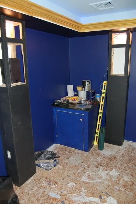

Here is a nearly finished product (we used about 700 staples for 5 columns, the 6th one needed caulk, so its drying).
And two side by side (fabric needs to be trimmed) - one of these holds a speaker:

Well, my kludge DIY speaker stands were meant to be hidden behind a false wall. Now that we are selling, they don't cut it. Only cost $4, so not a big loss.
I am debating between these two, both sanus, priced within a buck or two of each other.
Option A is adjustable, but I'd set to its lowest setting ~28" (2" higher than current) -
Option B comes in various sizes, but I'd get the 24" one (2" lower than current)
The big if on these is whether I'll retain them when I sell the house. The first one I find sleeker, its metal vs mdf, and might be better in a non-dedicated space. The second one is probably closer to the correct height, and it will be easier to find a center channel stand that coordinates. Any thoughts?
I am not going to DIY new ones (or fix the old one) since we have enough projects. Should have updated room pics in a couple days. We added the crown, most of the baseboards, and column trim. Essential to-do's are the sconce covers (had a misshap here, so redoing), the DIY screen, calibrate/converge PJ and carpet (an estimator is coming in today).
