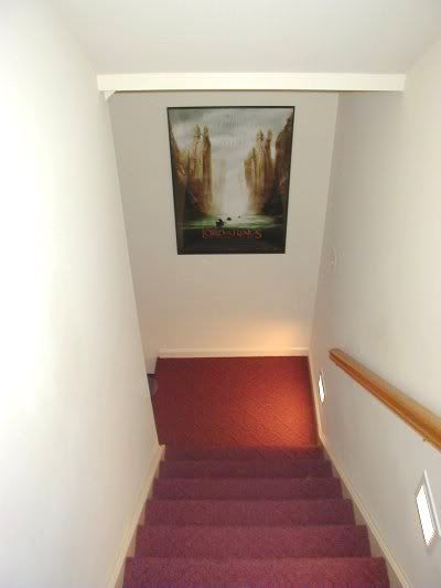

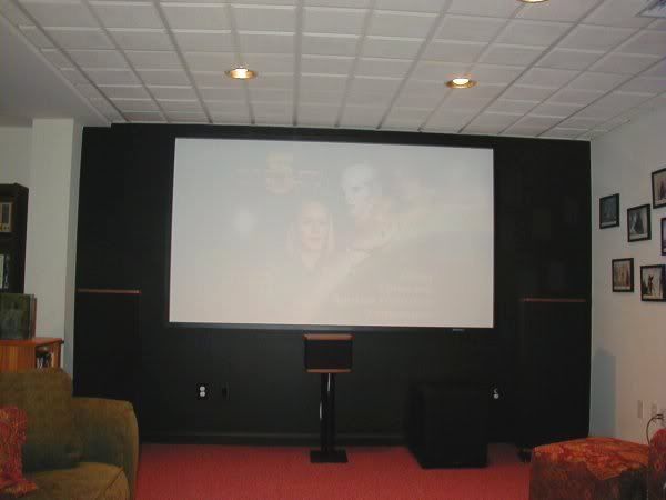

I used to have an NEC 9PG. Incredible projector. Here are a couple of pics of my old theater (two years gone since the divorce and sale of the old house, though as I said, I still have most of the equipment).
Front screen wall, with the Vandersteen speakers and Paradigm sub.
The rear of the room, with the 9PG visible.
And the stairway down to the theater.

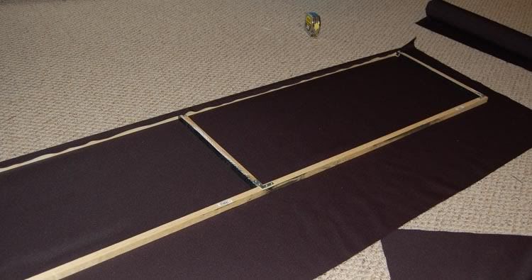

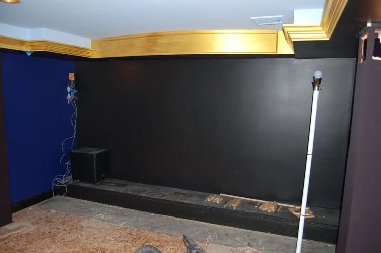

Okay - we've been working hard over the last two weekends since the promotion new hit, and we are now ready for carpet,. We put in a rush order. The measure is coming on Tuesday (we hope), and the install could be as soon as Friday. We are going with a basic charcoal on the floor, black on the stage, no patterns (cheaper given resale). I am on the road during the work week for the next two and a half weeks, so we hauled to get it ready.
I don't have great shots, but we finished wrapping the columns in fabric - a tip - spray adhesive - we only used it on the last one because the staple wouldn't fit between the column and the sump pit cover - what a difference. So easy to keep taught and clean. We added staples in the upper section too, but a plus.
Along the staple lines we added 3/4" square wood to hide the staples, painted black they disapear in the column. We also added the second piece of trim to the bottom of the column (was going to be to hide staples, now makes a more dramatic crown). On this shot you can see we ran out of the ones my wife pre-painted with the glaze, and part of it isn't glazed yet. The glaze really adds IMHO.

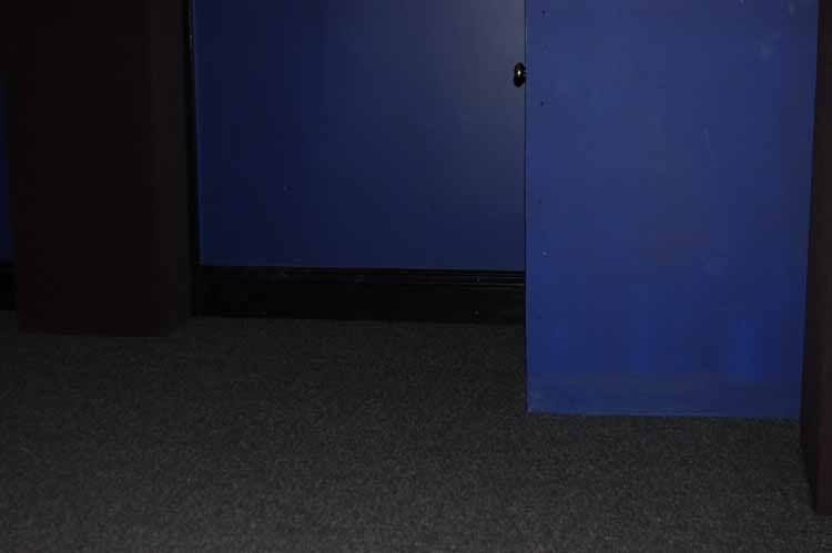

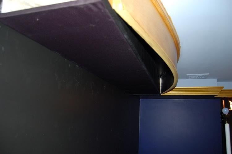

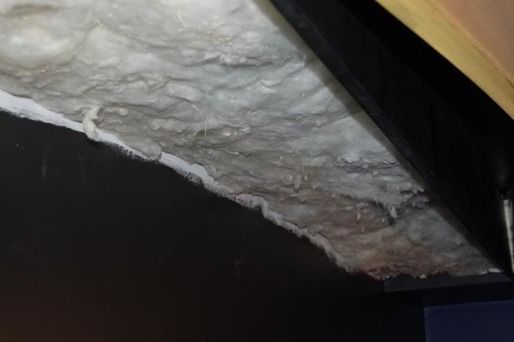

The next task was under the marquee, we had no idea how to cover/hide the inside/bottom of curved section and the insulation. For the curve section, we just painted the interior black. It made it blend so well. Worked great.

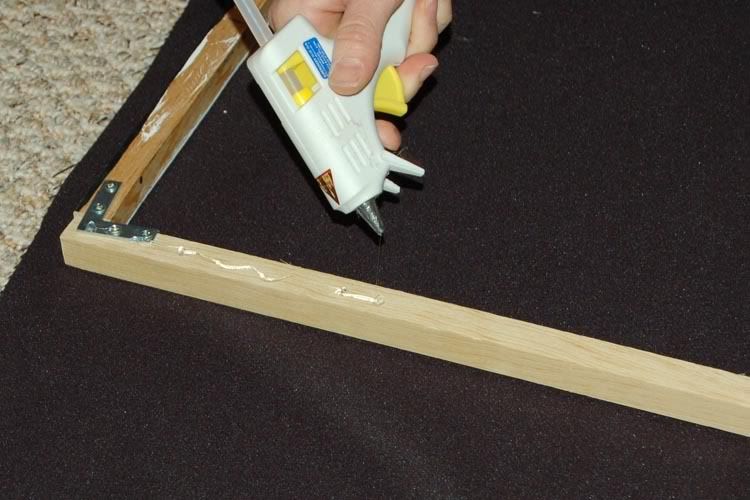

We started to frame out a solid cover, but it was too heavy so we made a switch to a fabric cover. This was again 3/4" square wood, with L brackets, on black dazian janus.
Hot glue guns are sweet
Then a friction fit
Black is beautiful, can't see the transistion in the room at all:
We cleaned up the room some, so its as open as its been (baseboards are up, too)
The short list is getting real short
1. build screen (wilsonart designer white on order)
2. build sconce covers (wood is all cut, was cut before, but I screwed up the size)
3. carpet
4. some TLC on the sump cover (new hinge)
5. finish speaker access panels - panels made, just need to cut the holes in the fabric on columns, hot glue gun the fabric aside, then velco up the panels
6. re hang door
7. put in new speaker stands
8. converge PJ / calibrate audio
9. clean, touch up paint.
10. add seating
Rats, not quite single digits. But getting close. Realtors come in next weekend, so I'll have their impressions soon.

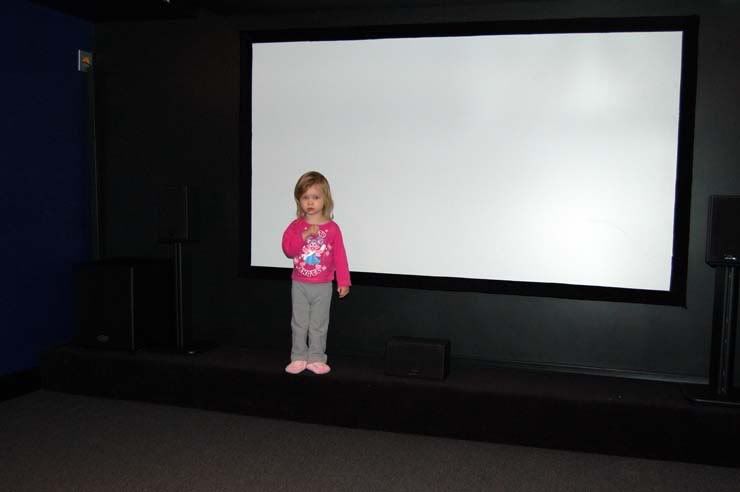

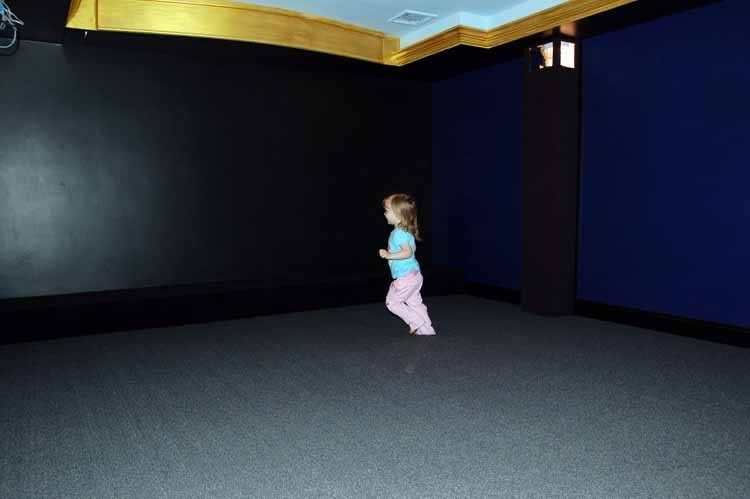

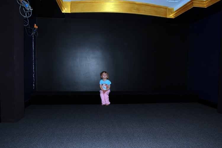

I am PA for work, but carpet went in today and my wife sent some pics. Again we went with a basic grey on the floor, and black on the stage.
My daughter seems to like it!
The baseboards, column and sump cover:
Transition to the adjacent room:
Can't wait to see it myself!

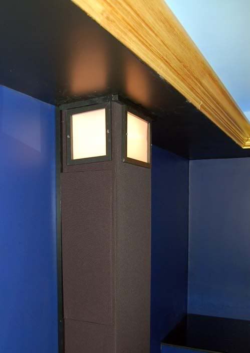

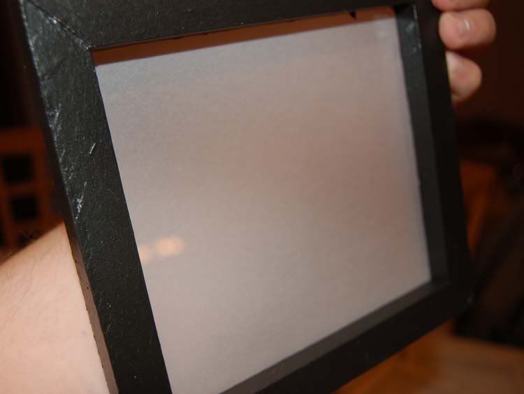

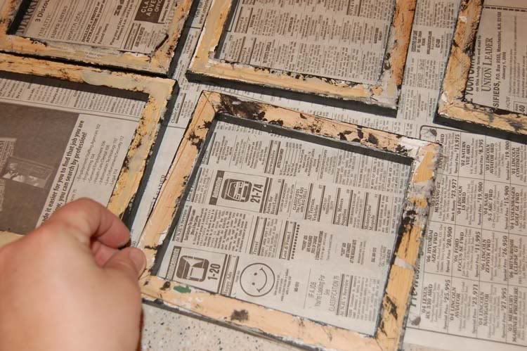

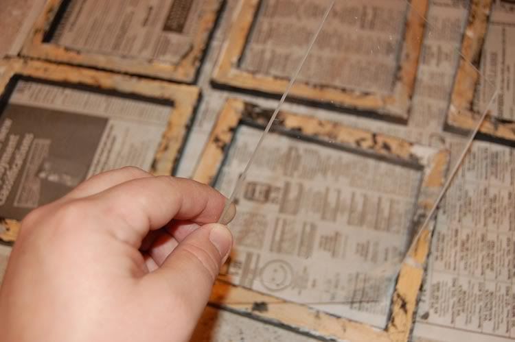

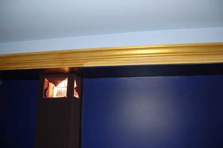

We've been working on the sconce covers. First we made frames out of 1/2 x 3/4 wood, mitered, glued, and stapled the corners, then painted black. Next we got some plexiglass at Lowes, and a $3 cutting tool. Scored the plastic using a straight-edge and snapped to size. The pieces didn't snap perfectly, so there is some irregularity, but its all stuff that sits behind the frame.
Here is the cut plexi and a frame:
Liquid nails, and set into place:
Then we cut velumn paper to size, and double sided taped them to the plexi:
And walla - cheap, easy (somewhat time consuming) DIY frosted glass:

EDIT - anyone have any thoughts on how best to attach to the column? I intend to pre-drill and screw one per column so that people can change light bulbs - I was debating gluing the other 2 per column - but not really sure how I would hold them in place while the glue dries. I can bite the bullet and drill and screw them.

I am debating whether I should glue and fire a nail north into trim above. This would eliminate my concern that drilling or nailing through the plexiglass will make it crack.
My concern is that it won't stay flush while the glue dries. Maybe I need some new clamps.
For the one cover per column that I will use screws (to change bulbs) I might need to go through since there would be no glue to dry. I had planned to make the side panel away from the door/facing the screen the one to provide access, so any visual imperfections caused by making it accessible would be less noticeable when you enter the room or sit down to watch a movie. Alternatively, I could make the front one accessible, which would be a larger opening for bulb swapping, and might be better for stray light at the edges/join. Any thoughts?
I guess once I test out drilling the plexi will help me figure out how challenging this will be. More tonight.

If it turns out you can't drill it without cracking it, you can certainly heat/burn a hole through it with a nail heated by a torch, or a soldering iron that you don't care too much about anymore...

That's an interesting thought.
I have plenty of scrap plexi, so drill first, heat second. HT builder meets rouge CIA operative. . .

Soldering iron was a great tip.

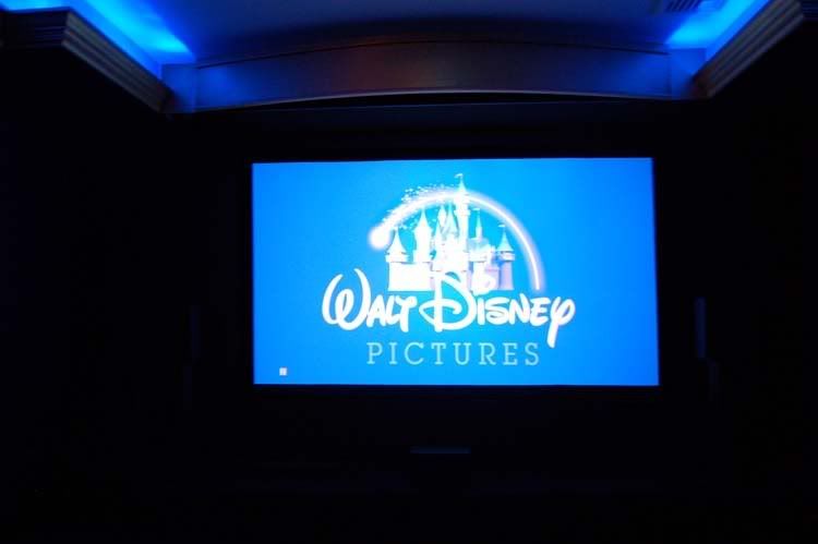

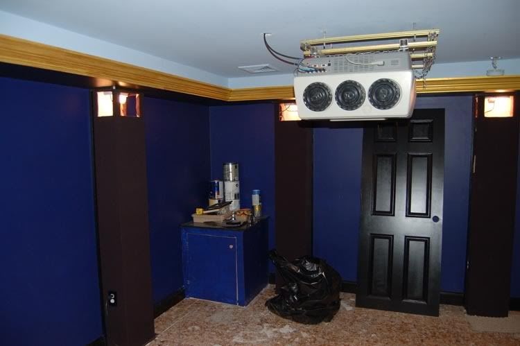

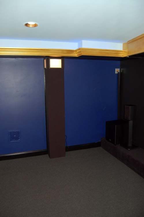

Well we are at about 94% I'd say. I am over due for room pics:
Screenwall from the PJ point of view:
Stages are irrestistable:
Looking back from the screen at the rest of the room.
Sidewall, near screen:
Closeup of the column, w/speaker in it. We made fabric frames and velcro's them in place. The sconce covers took a bit out of the light output, but its acceptable:
Last but not least, JTFoley stopped by and helped me with setup, making that process go MUCH faster. Great guy, appreciated the help:
I was watching a few pixar shorts with my daughter, she loved the "For The Birds" one. But when she was elsewhere I went with a little jack-jack:
Realtor's open house is next sunday. Hopefully by then we can finally do a premiere night for us. My wife and I are very pleased with the end result, and the journey - just a bit bittersweet that life throws curves.
Thanks to all in the forum who helped us figure this out.
