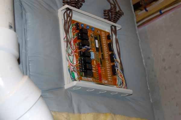

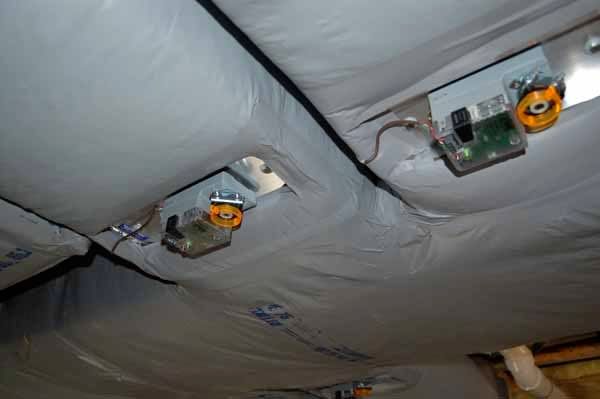

Here are some updates. HVAC is getting close. Zoning system was installed, and we ran with two zones last night. Basement zone won't be activated until the basement is done. They have some cleaning up to do.
Here are the new runs.
There are several dampners on these runs
Close up of two dampners
The control panel
The caffeine that powered the install

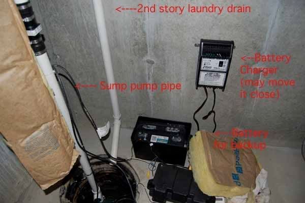

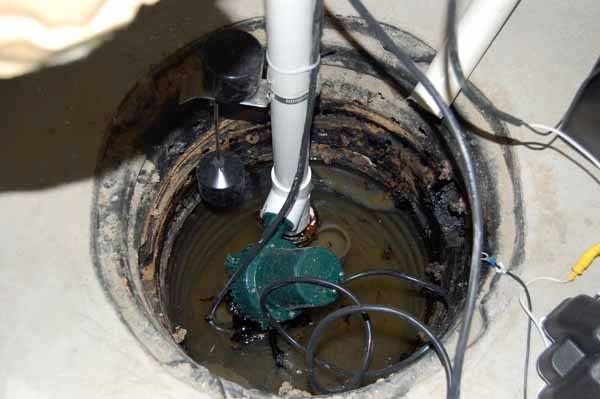

Also, here are the pics of the sump pump installed. We may need to frame around this or make the pipe a decorative column some how. Plumber put it in straight up/down instead of hugging the wall. Also might need to move the charger and battery to a more compact location.
Get pumped
The lay of the land

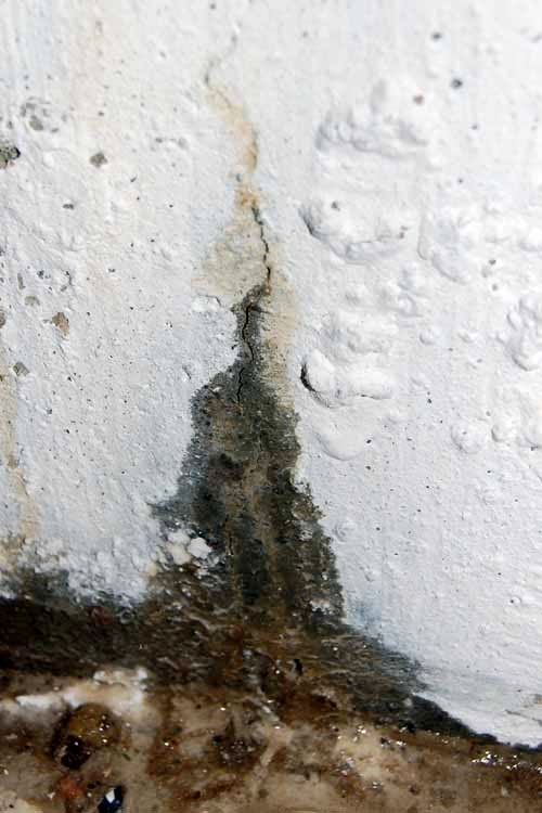

Contractor came to the house today. I am out of town on business, but my wife sent me some shots. They sealed the walls and floors using Kwik-Seal (I think?). I had a tthread going trying to figure out what to treat my walls in. Timing got tight, work got crazy, and I am sorry to admit we went with what the contractor recomended, as opposed to some of the products recomended in that thread. I was very intruiged by the Kryton product Soundood mentioned.
The contractors strategy was two coats sealer in portions of the basement, let dry, then move all the stuff onto those areas so they can repeat the process tomorrow.
Here are the pics:
The playroom
The theater
Utility room (the moisture is from the bulkhead door being open a lot lately)

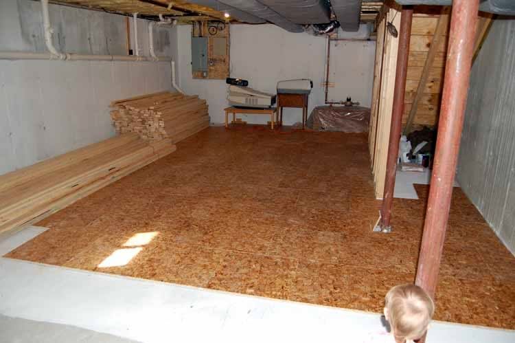

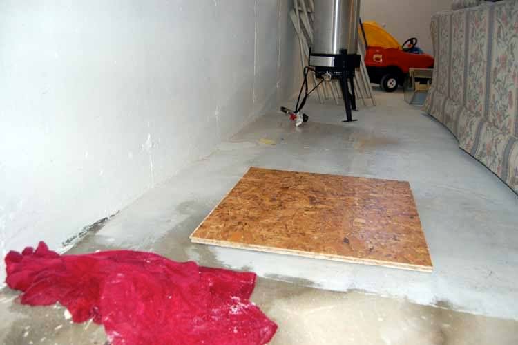

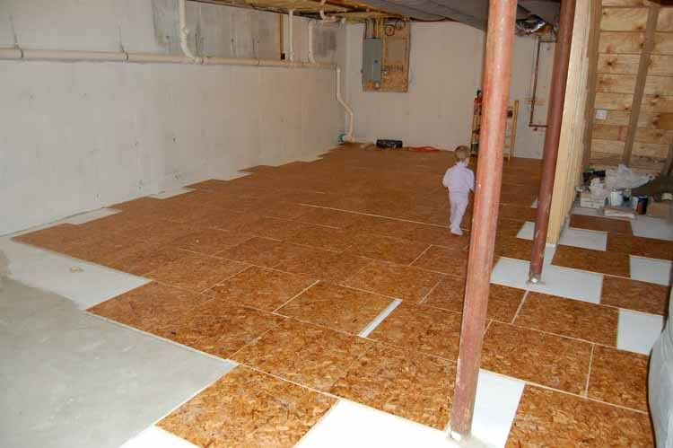

More sealing has gone on, and the dricore panels arrived. Timely result since we got our first water intrusion since we bought the house. Contractor is going to apply a waterproofing cement and seal it. Its underneath our bulkhead door.
Funny thing is the contractor thought the dricore was a waste of money until he saw it in comparison to the leak. Then he told us it was the best money we could have spent, and kept repeating that he wished he had invented it.
Could use some feedback on the Graphic Eye. Posted in the thread, but no response. My basic question is, does the controller box have buttons on it that let you "turn on the lights" without needing a separate switch?
Here are a few pics:
The intrusion:
Close up:
The puddle that made the contractor believe dricore is a good product
My daughter checking out the panels, loosely laid out

Posts: 4,604

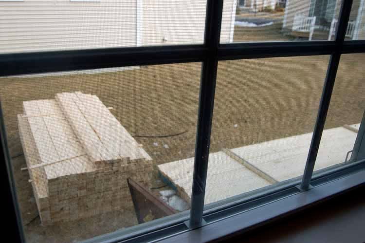

Thanks Jason. I snagged a 3104 on e-bay for less than I expected the 2404 to be. Hope it works out.
My wife reports the lumber has arrived. Framing starts tomorrow.
ta-da
More (dricore looks nice)

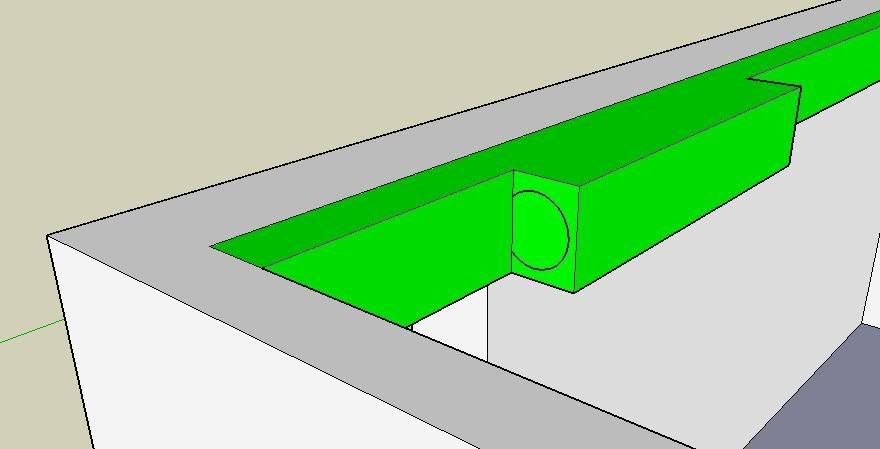

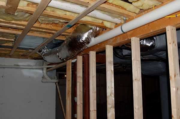

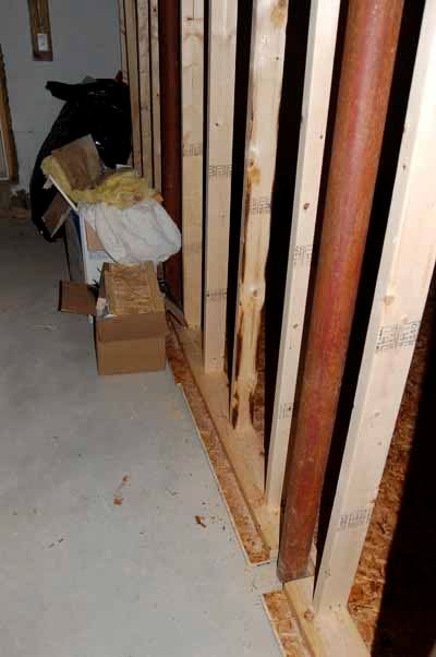

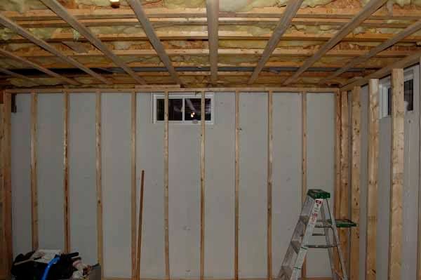

Well, the HT is largely framed, as is the basement. Still a few spots to be done, but definitely some progress.
Here is the screenwall - yup covering up the window:

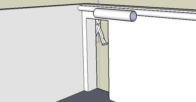

Here is a bit of flex for the 1st story, that will have to be soffitted. Maybe a soffit in the soffit - need to figure out how to isolate this. Suggestions?

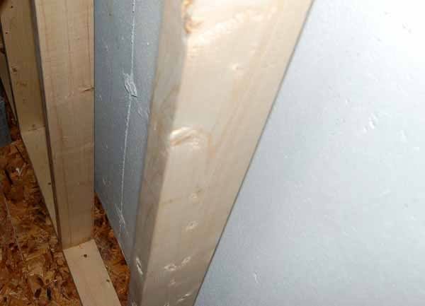

There were some compromises on the stag-stud wall. My builder wound up spacing away from the concrete for the three walls adjacent to exterior walls instead of using the larger baseplate. Since it is still a deeper cavity, w/mechanical decoupling, I don't think it is a big deal. The reason for this was some of the plumbing lines intrude into the wall space, and would narrow the room unnecessarily.
For the wall between the H.T. and the utility room, I spec'd staggered stud - but it appears my carpenter didn't quite follow, as all the studs were flush with the H.T., and there seemed to be quite a few more than 16 o.c. (didn't measure though). He used a 2x6 baseplate, so it shouldn't be a problem to add the studs on the other side for the sheetrock to go in the utility room. Here is a shot from in the util room. (Managed to encase all my lally columns in walls).
In other news, santa-e-bay arrived, looking good. G-E 3104:

Called a drywall supply store RC-1 is the same as "hat channel" for RSIC applications, right? They come in 12' lengths. My room is 17x13. I am debating whether they could be run lengthwise at 12' and just stagger the last 1' every other channel. Not sure if that would work. I gotta read up. Would make it an easier install process.

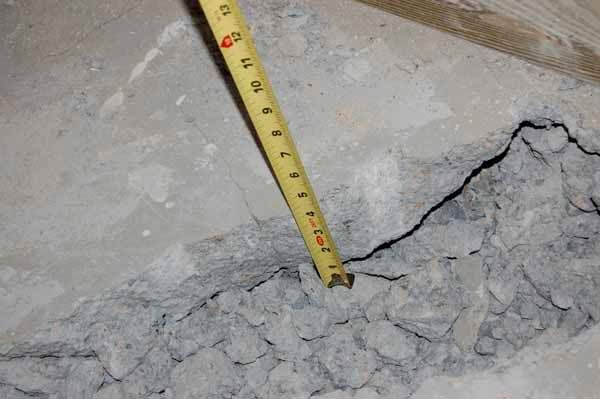

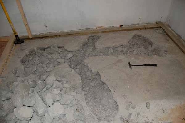

Its a PITA balancing the contractors. Electrician has been hard to run to ground. Finally came today to eval the work. Seems to be on board. HVAC guy is irritated at the carpenter for how he soffitted the trunk lines. Plumber is waiting for bathroom walls to be framed, and concrete to be demo'd.
That was started today. They jack hammered the floor today. Tomorrow they dig.
Its not the thickness of the foundation . . . .

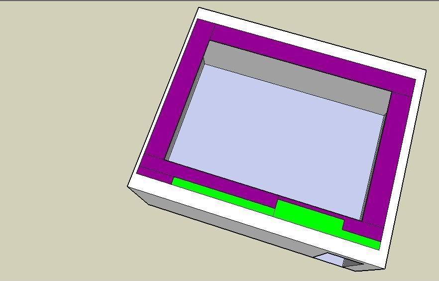

Could use some input on my soffit.
If you look at my floorplan it is to be for lighting (9 or 11 small cans), conduit (all outlets in columns, so soffit runs the wires), and presumably treatment (bass trapping?).
Here is the existing setup with a sewage pipe and a bit of flex that feeds the first floor encroaching in the space. I think I need to soffit them, and drywall them for sound isolation purposes.
I started a quick and dirty sketchup:
Here is a sketch of what I think I should do - soffits in 2 phases. Phase 1 in green, enclose pipe (w/access) and flex duct in the double drywall + GG shell. (in green)
Phase 2 would then be the conduit/treatment/lighting/etc space (in purple)
My questions are -
- Does this approach make sense?
- Will the "phase 1" soffit areas change my accoustic treatment plans?
- Does it make sense to plan to use the soffit for treatment given this irregularity?
- Or maybe exclude the side soffits should be excluded from treatment?
May be notable that the screen is AT (SMX), and there will be some space behind the screenwall for treatment also.
I posted in bocapimp's thread to figure out how Ruben/Boca handled getting treatment and lighting into the soffit space, but would welcome input on that as well.
Finally, general dimensions - I was thinking an 18" out, 12" down. Seem reasonable?
Thanks for any input.
