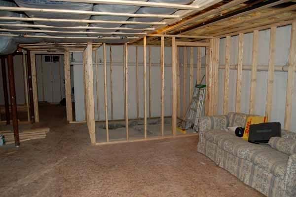

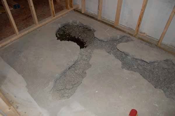

Minor update.

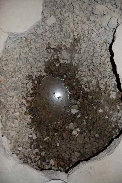

Carpenter finished (sort of) digging the hole for the bath, and framing the room. He missed a piece of the line that was supposed to go back into the shower (I think). Tommorow the plumber comes to install the ejector pump, and rough in some of the piping.
I am working up a sketchup model - so might have some meager renderings to post in the next day or two.
Bathroom framed (that sorry couch w/a slipcover will be my initial theater seating - its actually pretty comfortable, just not what's in the final plan - - budget ought to be a 4 letter word):
Trenches dug
Water table is HIGH!

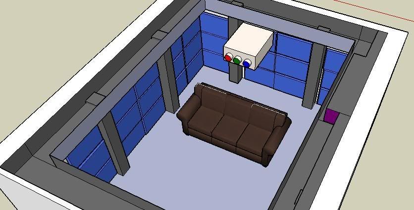

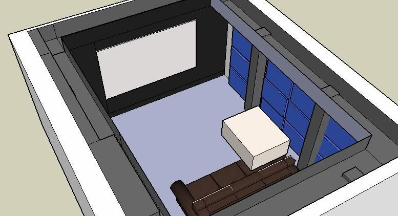

Made a couple of quick stabs at sketchup renders. Needs a lot of work - fabric frames need to be cleaned up, fill in the empty spots, add the counter for the second row - but its a start.
Looking at the screen:
Looking at the PJ

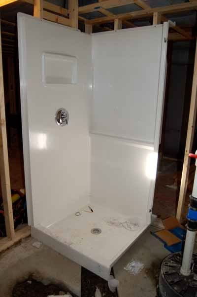

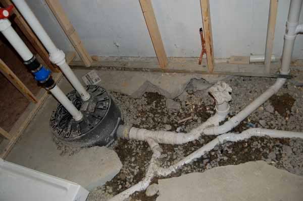

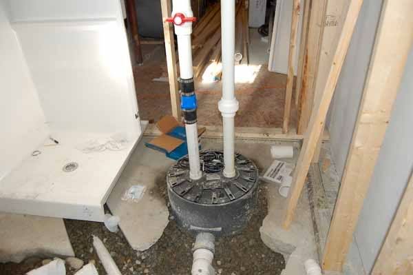

Plumbing update -
They mostly finished up today, a few things left to connect, then inspections. My plumber is from Ireland, and has relatives over visiting, so he won't be back for a few days. Electrician isn't out till next week, so should be kind of quiet here. Gives me time to work on some other particulars.
Onto the plumbing pics:
Here is a pic of some of the dirt hauled out. A small fraction. My wife says the pile was huge. before they filled back in. Note the dirtline on the wall
Here is a pic of the ejector pump. You only see the tip of the iceberg. The actual was much bigger than a keg. At least 3.5 feet tall.
Here is the shower placed w/2walls. It is 36x36. It is made in a way to be directly attached to the studs:
These are some of the supply lines.

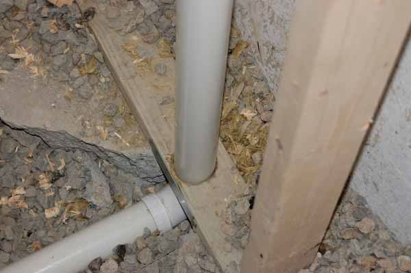

Here is a shot of a PVC (venting I think) splitting a baseplate. Hope its code:

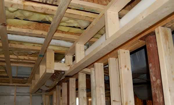

A few updates. Between long hours at work, a few things have come along.

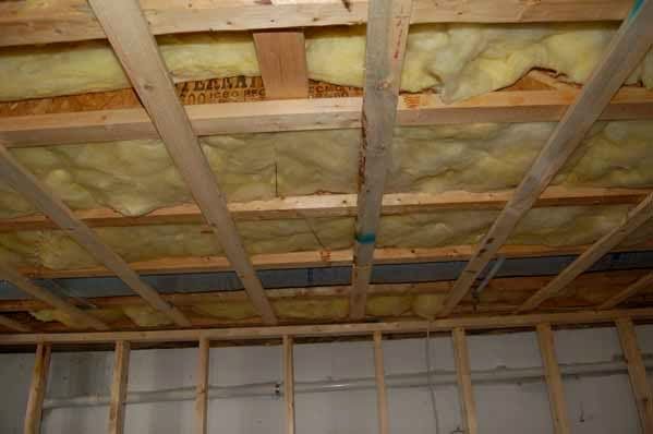

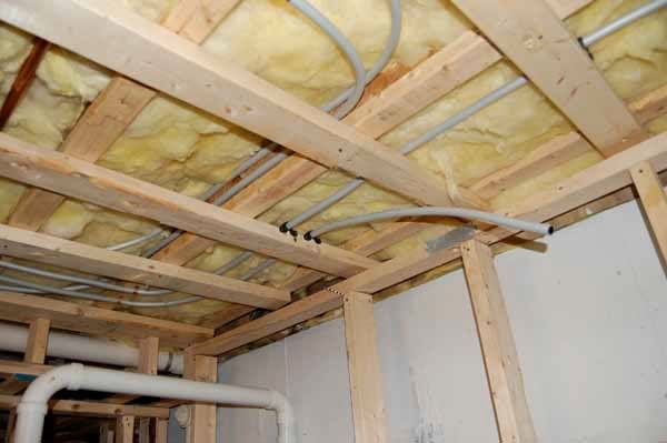

Framing continued. They put the staggered stud wall in between the media room and the utility room.
They framed the soffit in around the HVAC stuff. This is phase one. A second pase for treatment and electrical will come.
Similar for sewage pipes:

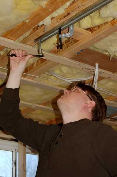

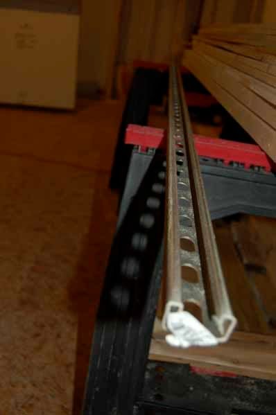

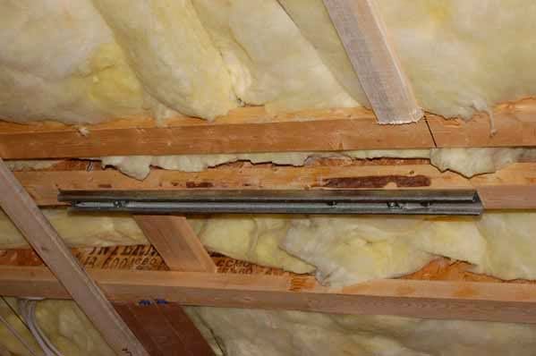

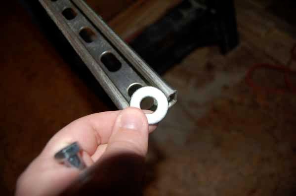

On to preparing the mount.
My carpenter put some strapping up for ceiling. This is good, as it will help allow the strut channel to sit beneath the RSIC.
A little Sawzall (merry christmas) action, and the place is clear.
Here is the strut. It will carry the burden of the 150 lbs CRT PJ
Lag bolts and washers to hold the strut to the joist.
Sawzall has some work to do.
To the ceiling:
Viola! (one of three)
I never would have done it without expert help.

Well, we passed the framing inspection today, completing the trifecta with electrical (last week), and plumbing (two weeks ago).
A lot has come along in the last few days. HVAC is in tomorrow to run the ductwork into the bathroom and the HT. I compromised a bit on the HVAC due to limitations in the MA code on flex. I think it will work in the end, as we are running wrapped and lined duct with requisit turns, and what not. I think the cost will be in the soffit, where I had hoped to preserve space for base trapping. As it stands, the entire back wall will be eligible for trapping, and portions of the side (I think). Should know in a few days.
Plaster is going up next week, so I need to make my wiring runs. I am debating between running the speaker wire bare, or in conduit. Same for the PJ. Also considering what runs I'll need for the connecting the EQ rack and other spaces (if any).
Can't find any flexible conduit thicker than 3/4" here, so might have to rush order some online if I go that way. Was debating 2" to the PJ, plus 2" to the front stage (3 channels + sub), then either direct runs to the surrounds or put those in 3/4" conduit. I might also run 2" conduit between the EQ Rack and a closet desk I will be adding in the playroom. There is already ethernet between the two, so might not be necessary. The other decision is whether to run cables/conduit to the places in the playroom where I have added cable drops from the EQ rack. I don't see running parallel display, or audio, but you never know. Drywall hangers are coming, and I am out of town for easter. Ack!

I couldn't find any 2" ENT around here either, and I have accounts at the local electrical supply houses.
They were able to get me 1" transferred in from another branch, cost was $88 for 100'.
2" was available, but they had to order it, 2 weeks leads time.
Tim
