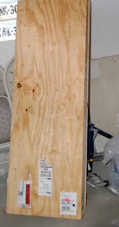

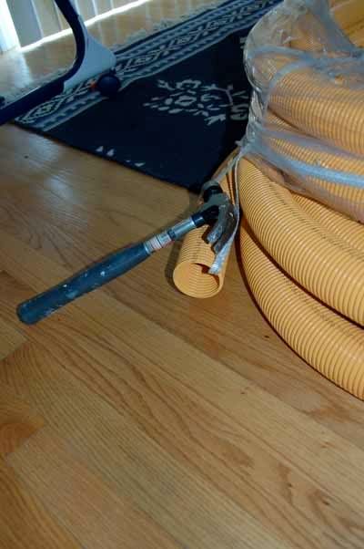

My rack rails arrived yesterday. I went with a pair of 35 space rails, 2 vented spacers, some screws and a plexiglass door. Shelves and other items to come later. The plan is to put the spacers on to ensure that the studs are placed properly. Shelves and a drawer for spare remotes will have to come later.
The door came in a wooden crate! I got home later and couldn't find my hammer, but I am looking forward to checking it out. It was expensive, so I hope it is nice. I had convinced myself to skip the door, but my wife talked me into it. We have an 18 month old, and the rack will technically be in her playroom . . . . Probably a good call.

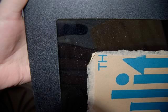

Speaking of the rack, I mentioned earlier, the rails, two blanks and the door arrived last week. The door was impressive as it came in a crate. Here it is:
Here is a cross section shot:

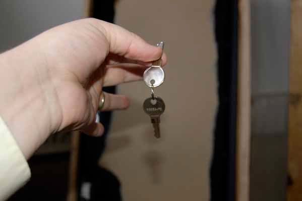

Here are the keys(!)
Here is a close up of the plexi-glass - its tinted, pretty nice:

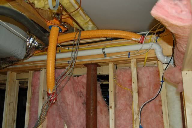

In other purchase news, some conduit arrived. I ordered 2" flexible conduit from smarthome. It comes with a nylon cord in it. I can tell you from experience, tape that cord down before you install it. Otherwise it will come rolling out in front of you and your horror while you ar congradulating yourself on a job well done. Fishing a new string is a PITA. I wound up ripping it out, and installing some more (I have lots left over). I ran 2" conduit to the PJ, and to the front stage. I ran speaker wire for the surrounds. Here is 50' of conduit:

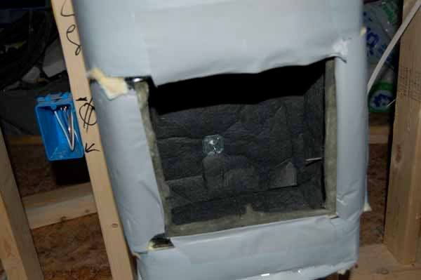

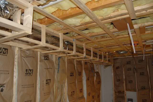

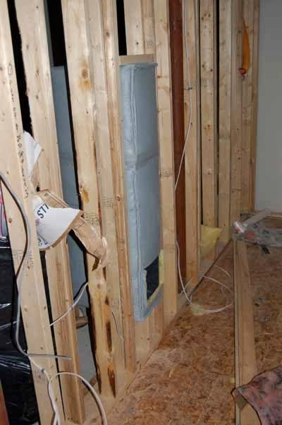

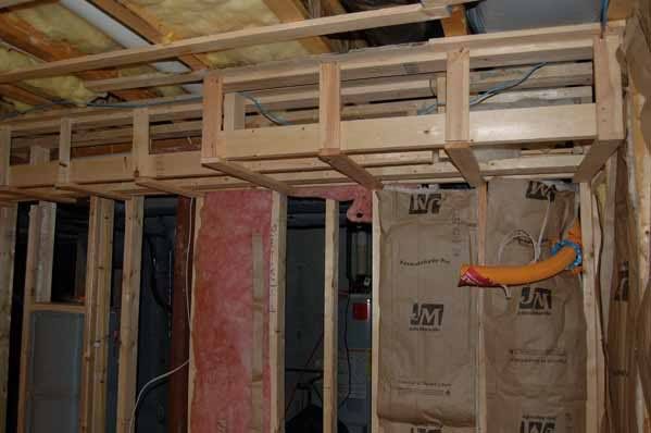

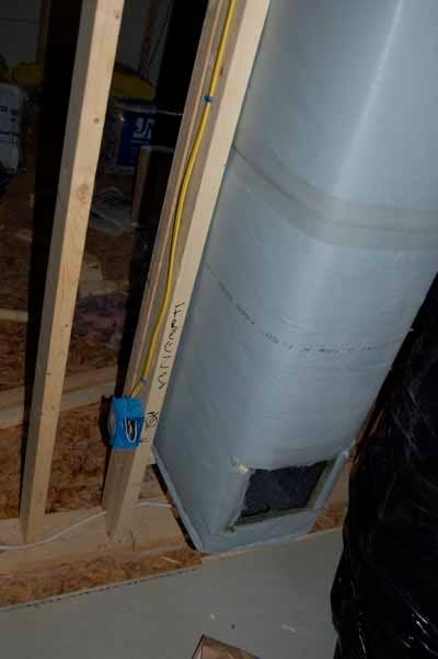

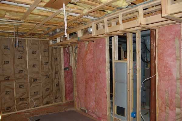

In other developments, my HVAC guy built a baffle/transfer box for the return. We couldn't get the return to connect in, so we are venting into an adjacent room. To address sound control, it is a wrapped and lined box, with a partician in it. The return is set low, the air comes in, rises over the partitician in the lined space, drops, the exhausts low opposit from where it came in.
Some pics:
In the room (not screwed in yet):
In the utility room:
Close up of an entrance (you can see the lined interior/partician):
dc_pilgrim is offline
I hate to do this to you, but...
Get a pail of electricians pull string. Wrap about 30 turns around your palm (maybe more for 2",) tie the bitter end around the center of the ball (butterfly style,) and cut the loops with scissors... Instant pom-pom on the end of a VERY long string.
Jamb pom-pom in one end of conduit, attach shopvac to other end of conduit, watch new fishtape FLY out of bucket.
FWIW, this method should also work when the conduit is partially occupied, but you can avoid that little horrorshow by always keeping a string in the conduit.

I second the above. After spending 30 minutes trying to get a screwdrive tied to a string to "work" its way through the pipe (I should of videotaped this, would of been really funny), I tied a paper towel to a string and sucked it through with my shopvac. Took about 10 seconds.

Sure, now you guys tell me .
It wasn't that big a deal in the end, as I have plenty of conduit to spare. But I am glad you told me in case I have any problems pulling the wires through later. I have decided to leave the conduit empty for now, and pull my front speaker wires and video cables after sheetrock (Friday). I have gone back and forth, and if I was DIYing, I'd pre-run and leave the conduit empty for the future. But its been enough of a struggle with the contractors that I don't trust them, especially since the plasterers are a separate subbed out crew. Hope my speaker wire to the surrounds come out okay.

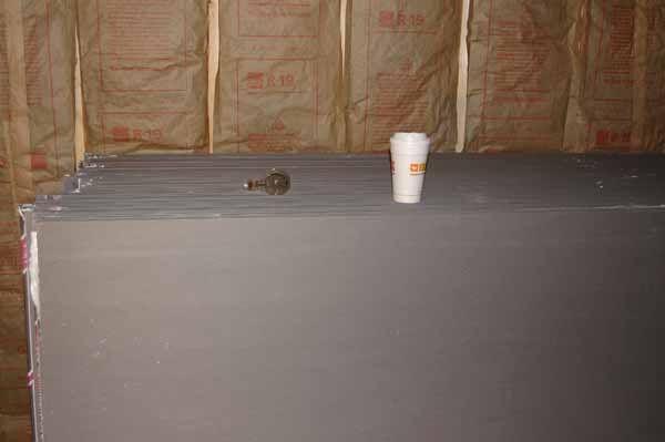

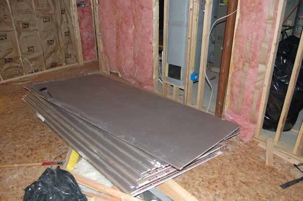

Blueboard (type of drywall) was delivered today.. Here is the half-inch for the rest of the basement:
They stacked it on its side, which was kind of weird. In all the threads I have read, I have only seen it lying flat on the floor. Perhaps because otherwise there is a risk it will come crashing down on your wife's leg, like these 15 sheets of 5/8ths did:
Needless to say, we had a bit of a scare. I was moving it smidge to look at the HVAC return which had been adjusted today. I wanted to verify the decoupling efforts. In a blink of an eye, gravity kicked in, and 15 sheets were keeling over. I was holding the baby, so my wife rushed in to help. She wound up getting bowled over, and just missing having a rusty nail jammed into her torso - - so we are thankful it was only bruises. So far she is being very gracious about it. Hope it stay that way. Anyways, you can see the return in this shot of the rear. It is screwed to strapping that is not attached to the stud that connects to the utility room side (stag stud):

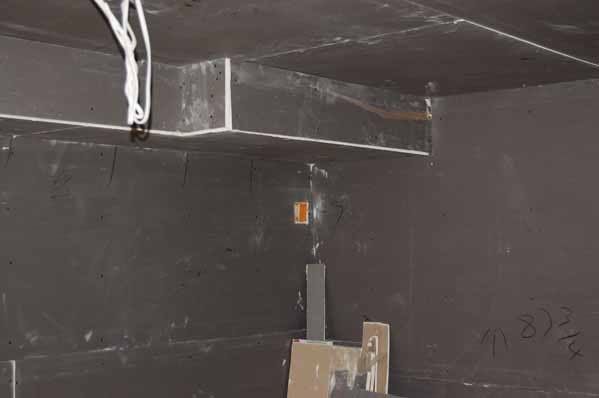

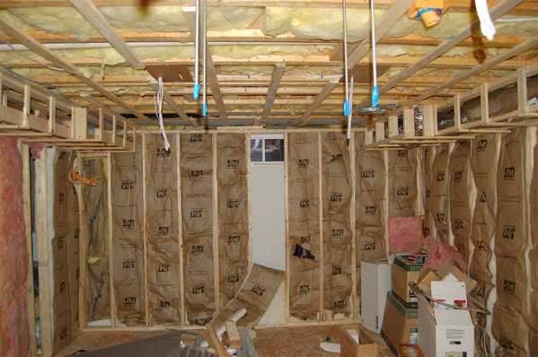

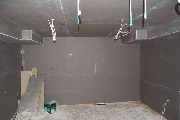

Moving counter-clockwise, here is the back wall (the sump pit charger is going to be moved):
And the side soffit (taken from the front)
Here is the future screenwall:
Here is a bump in the soffit that we did to mirror the HVAC. We need to decide what we want to do with the front view now that we know we have these bumps. You can see some conduit popping into the room too. I will trim that back after the sheetrock is up.

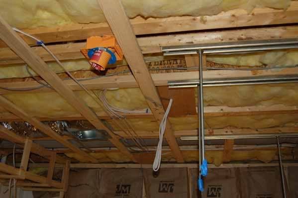

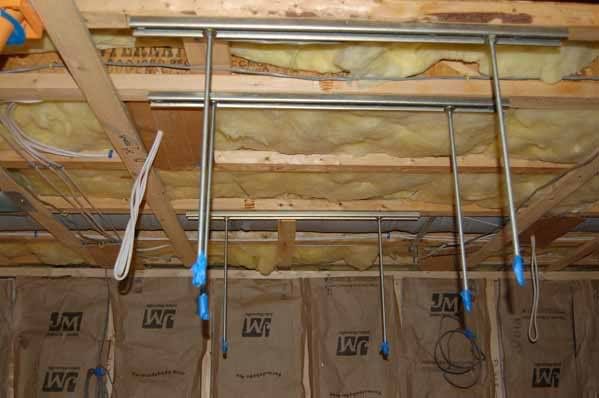

I added some threaded rod coming down from the ceiling to be used as part of the mount for the CRT projector. It hangs 18 inches. I plan to trim it back after the rock is up. The intention is that RSIC clips and hat channel will ride over the strut attached to the joists (see earlier in the thread) - you will note, there is no RSIC clips up right now, nor hat channel. Yes, the carpenter has a few things on his punch list (including more insulation in the ceiling/soffits). Yes, this makes me nervous.
Here is a shot of the conduit to the PJ. It will be trimmed back after the rock is up. The box is loosely nailed, as I wasn't sure what height to make it, since the RSIC clips aren't up, and the hat channel isn't here (!)

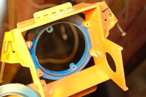

I was wondering about the blue ring around the conduit ends, is that some sort of plaster ring, does it attach to the low voltage box or does it have the wings for existing work and eventually grip the sheetrock? Never noticed them before at the local home stores.

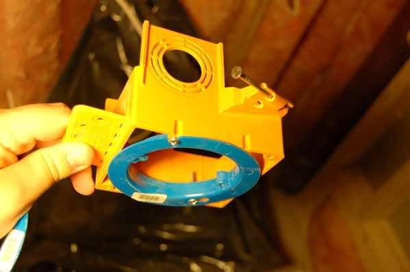

Oman - thanks for the concern. Like I said, we are thankful. The blue ring was something in the aisle at HD where I got the carlon box. I think it is a ring for a ceiling fan mount - or something similar. Anyways, 2" conduit fits in neatly, and the screw holes, while not perfect, did line up. I can take more detailed pictures over the later half of the weekend if you like, I have one set loose right now.

If you get to it that would be cool. Seems like a good option to tidy up the conduit. Thanks.

Oman - wound up staying in NH little longer than planned, so couldn't get more pics. I did find this on the Carlon website. The screw holes that lined up (not quite perfect, but 90%) to the box are the ones on the outer ring (the open one, and the slide-one).
http://www.carlon.com/sd-cgi/hsrun.h...logObjectId=90

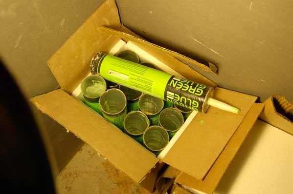

I can NOT believe it! They only used 2 of the 4 cases of green glue. They'd need at LEAST a portion of the third (I over order). UNFRICKENBELIEVABLE!

Hm, did they in fact apply it correctly?

Okay - I can call off the dogs. He ran out of sheetrock - he still has 6 more sheets or so to hang.
Phew!

Oman - here are a couple more. Mind you, it seems the knocked the rings out on install of the sheetrock.
and another:

Okay here is the update from the sheetrock hanging day - -
Here is the screenwall. There will be a false wall about 18-24" away, with an AT screen (SMX). I am still thinking through the front. Initially I was thinking no stage, and a straight false wall - not unlike Larry Chanin's (although he is shadow boxed) - now I am debating an arch, or a curved marquee, since those bumped soffits came in.
Here is a closeup of the side soffits in the front. You can see the box for the conduit. The ring got knocked out, and the conduit isn't popping through at the moment, but the opposite wall is still raw.
Here is the threaded rod for the CRT PJ
Here is a close up - holes are a little bigger than I would have hoped:

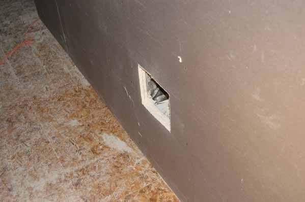

The return came in good:

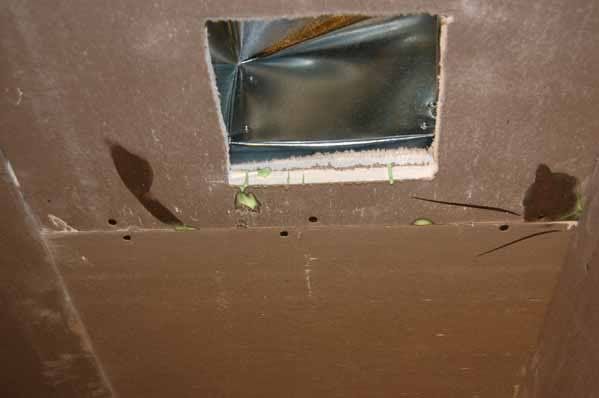

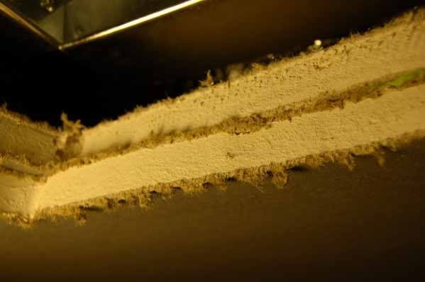

Here is a suppy (1 of 2)- quite a gap due to the RSIC clips + hat channel (note some GG):
This close up shows the gap. The HVAC guy is going to loosen it, and bring it flush with the sheetrock, the affix to it when the grates go up.

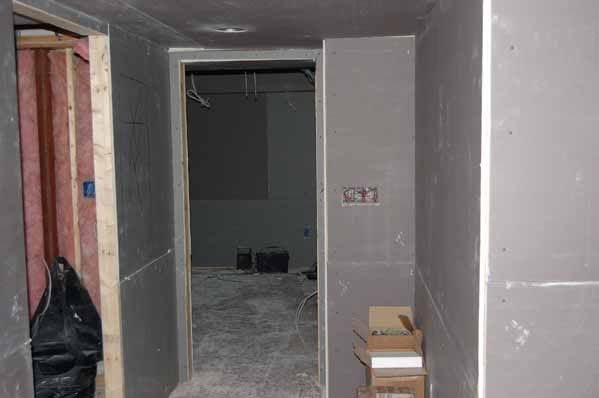

Here are some of the "empties"
Here is the entrance. The rack isn't cut in yet (I can't wait to see the door in action either Max).
Accross from the rack, is the grafik eye - waiting for action -
Dave, your Boston is showing
You spotted two unused cases of Green Glue, but not six missing sheets of rock, before posting? You may be a little too emotionally invested in this project!
It's a lot healthier to take a pragmatic approach to major reno projects, and just accept that some stuff will be done wrong and have to be corrected.

Out of curiosity, is blueboard any different than "regular" drywall?
Gonzo
My Home Theater Odyssey
PSN: mule-tool
mbgonzomd is offline
post #118 of 523 Old 04-24-2007, 05:13 AM
Mr.Tim's Avatar
Location: SC
Posts: 2,844
Quoted: 281 Post(s)
Liked: 193
Yes, blueboard is designed as a substrate for plaster. The paper facing is designed to bond with the plaster veneer.

I always assumed that blueboard is also less prone to water damage (D'OH (slaps forehead,) plaster is a wet process.)
I didn't plaster, but used blueboard in my bath remodel and in my basement (prevent wicking from concrete.)

Thank for the pics,
Your is project is really starting to come together.
Any concern with using blue board downstairs in the basement. I've always been told at the minimum you want to use green board and more recently the paperless boards to prevent any mold issues.
Edit: jtnfoley just answered my question, I'll have to rethink what I want to do in my basement now.
