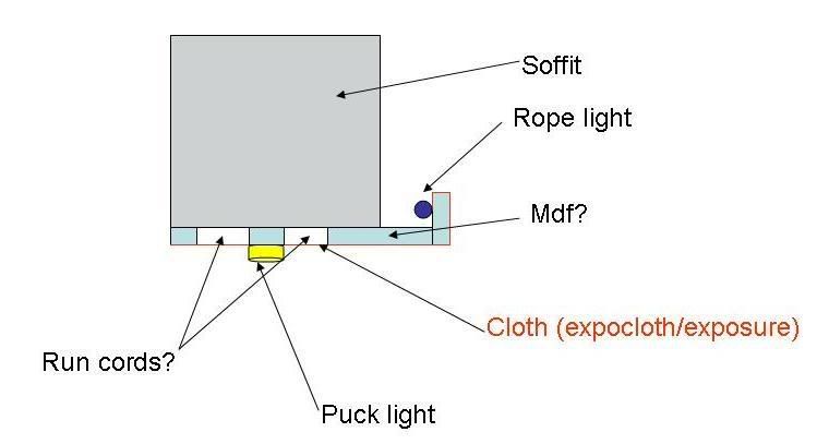

Well electrician is coming tomorrow to inventory what is needed, and will be doing install work on Thurs/Fri.
I need to shore up my lighting plan on the soffit. We want to do several lights to wash the wall, similar to what Gpowers did - in part because I am totally copying his design. I was about to do a thing describing my plan, but I did a search, and Greg already has my plan with a few variations.
Here is a post with his PDF of what he did:
http://www.avsforum.com/avs-vb/showt...&&#post5499287
Oh well, the pictures are drawn, so I'll finish my post:
Here is the sketch that Ruben did for me, that I will use for the rear wall:
Here is what I came up with for lighting on the side wall:
After reading his pdf, I may add lino to the bottom of the soffit depending on what Bpape recomends.
I'd rather use the lights Ruben has, but the puck lights should work also.

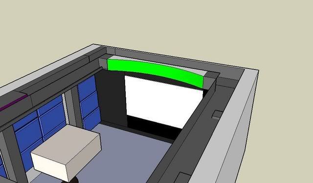

Been contemplating my screenwall. With the soffit bump out been debating adding some interest points. Not sure if I'll mirror it on the stage or stick with the flat desgin that I had originally planned. Too early to say, but do people like concave or convex?
Concave (ignore the purple/green colors, just for effect)
Convex?

Convex, most definitely.

Definitely convex. Concave just looks too odd.

Go convex, concave does look strange. Glad to see all the progress Dave.
Okay, okay. Works better anyways since I remembered that vent. I probably will need to shrink it down some similar to BigMouth's and not run it all the way to the side soffits.

Dave,
I assume you're going to have some cross supports and that the MDF section of the sffit is just not hanging off the one 2x4. I'm sure you are, but I've seen crazier things. Is there a reason you can't do the smaller cans in the soffits versus the puck lights? I might have missed that.

Yes, I know Ruben had some additional mdf spanning the gap where he attached his lights. I expect my soffit will not be as big as the dimensions Ruben used, but I haven't remeasured the existing ones yet.
The problem I have for the cans is the side soffits are largely full of HVAC ducts (flex). The lighting is mostly for wall wash effect, although I am a bit concerned if there will be enough lighting in general. There are two 6" overhead cans and rope light for clean up time.
Gotcha. I have 4 six in cans in the main part of the ceiling and I never use them. Maybe only for vacuuming. I use primarily the three 4" cans above the stage that highlight the screen and two 4" cans in the rear soffit (large - about 6 feet deep) which is over the riser. Oh and the rope light of course, although I'm going to go blue soon I think (maybe we can work something out if you have extra). Thats all that's required in my 12 x 19 room.

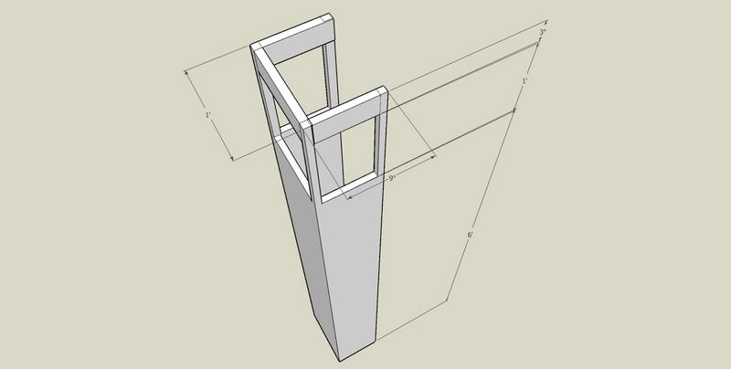

Carpenter wants my column design.
They will house Ascend HTM-200 speakers (Dimensions: 11" x 6.5" x 6.375")
Here is what I came up with. I assumed a ceiling height of 7'3" below the soffit. But, I'd take the balance out of the 6' height.
I am thinking I might want to make the opening 18", not 12" as I drew them. There will be 6 columns total, two without speakers, which will just be solid. I am thinking MDF, stuffed with insulation based on everything I have read. I may trim out later with crown ir the like. I will wrap them in expocloth. Did I miss anything?
Basic design:
Post this Q over in the DIY speaker forum... there are some scarily advanced guys that will tell you the response curves of the enclosure (ignoring room effects) based on enclosure geometry and driver data alone...
I enjoy mowing my lawn. It's the only two hours of my week where I know what's expected, understand the job, can forsee completion, and look back and see progress.
Good idea!
Gave it a shot.
http://www.avsforum.com/avs-vb/showt...2#post10407712

I just replied to your questions. I'm using the same surrounds as you and columns to hide them.
I couldn't answer about the response curve, but I was told it shouldn't impact it based on my discussion with Ascend and others.
