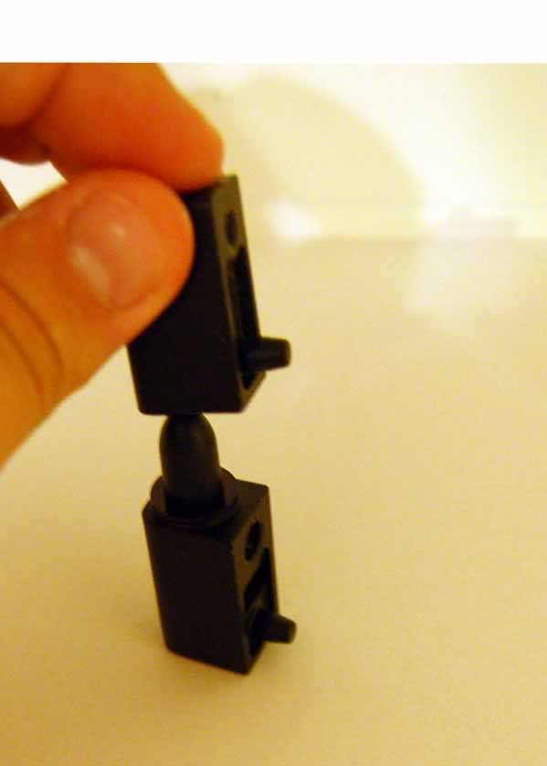

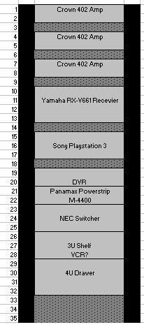

Finished re-securing the rack. The carpenter left it with only a couple screws in place because I wasn't there to supervise. So I took it out, lathered it up with construction adhesive, put it back in the opening. Clamped it and let it dry. I then painted the wood liner black, and put the rails back in last night, using a bunch of screws. I then attached one of the crown 402 amps, using just the 4 screws in the faceplate. This amp weighs around 25 lbs, and I wasn't sure how stable it would be held in with just the screws in the faceplate (I don't have rear rails). But it is solid as a rock. I am really pleased.
My door will go up later, as I need to work out a couple details on the trim. My hinges got misplaced, and the replacement set arrives today.
Here is my plan for the rack. Spaces went awfully quick. Shoulda gone bigger. I am tempted to move the amps to the bottom, since the sources would be better at eye level, but this plan seems better from a heat perspective. I have a few 1U blanks/vents in the plan that I will be ordering. I need to buy shelves for the receiver and sources too. And the drawer. Any flaws? I'll get a couple pics of the rack in the next day or two.
dc_pilgrim is offline
post #226 of 523 Old 06-26-2007, 10:40 AM
chinadog's Avatar
Location: Knoxville, TN
Posts: 5,559
Liked: 40
Dave, FYI. When I installed my power conditioner, I installed it in about the same location as you. Made sense to me initially, figuring it would be an equal run for equipment above and below it. If you install it on the top or the bottom, some components may have shorter power cords, so a potential issue.... BUT, the problem is that there is a master switch to kill it in within reach or kids. Also, the wife didn't know any better and just killed everything to the rack. Nothing tragic, just something to think about.
Bud
chinadog is offline
post #227 of 523 Old 06-26-2007, 01:29 PM - Thread Starter
AVS Club Gold
dc_pilgrim's Avatar
Join Date: Oct 2004
Location: South Central... PA
Posts: 4,818
Not a bad thought Bud. My rack has a door which might protect against prying hands - but I realize now the lock on the door is meant to go into a full rack, not just rails. So I need to provide for a latch for that to be any defense - I didn't have a lot of thought into the power conditioner's placement, except it has a convenience outlet on the front (and several in the back) which I was trying to keep convenient - - though I will probably never use it.
I am debating custom mounts (pretty yes, but expensive and behind a door) and whether to ditch or downsize the drawer. I'd like to leave a little more space for expansion (eg another amp when I go 7.1 down the line, maybe HTPC or a scaler) but I think I'd like a place to store sundries like remotes and whatnot.
But if my door winds up being unlocked, I agree the power conditioner is going higher. My daughter loves buttons. Good tip.
post #228 of 523 Old 06-26-2007, 09:09 PM - Thread Starter
AVS Club Gold
dc_pilgrim's Avatar
Join Date: Oct 2004
Posts: 4,818

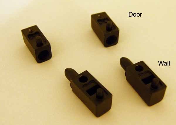

Here is a few pics of the re-worked rack.
Re-installed, with all my rack-mount stuff installed (one amp needs to be moved down a slot, may eventually paint the NEC switcher black)
A closer cross section shows - some rough plaster, the painted wood lining the opening, the rails, and part of a vented blank
Back o'the rack-
Now here is what I am thinking about the door. The doors are made for full racks, and the instructions suggest on a full rack you just install the hinges on pre-machined slots, and walla. With rails only I will have to improvise. Calvin gave me a few pics in his thread which showed me how it sits in its natural setting.
My plan is add trim over the wood and plaster, flush with the inside seam of the wood, and the door will rest on the trim (to be painted black).
I would then just add the hinge to the meaty part of the trim, piercing it, and ultimately anchoring in the wood behind it. My fear here is that the trim will split (it comes in pine)
For context, the top hinge just rests on top male/female style
Then next concern is that the keylock will need to "lock" by cutting a slot in the trim. From what I have seen on the web/tv, a biscuit joiner would be ideal for this - I don't have one of those, so I will have to try a manual cheaper tool. I am thinking either perforating with a drill and then a knife, or maybe the hand-held drywall saw I just picked up.
Any flaws?

Originally Posted by jtnfoley View Post
DC, post some closeup pics of the hinges and latches... I've got several racks with unused doors and I may be able to provide the correct striker, or thoughts on how to do the striker/hinges cleanly.
Forgot to grab a latch shot. Here are a couple of the hinges. I think at this point the plan is simple - measure the heck out of everything. Pre-drill the holes through the trim and into the side of the of the 1x4 beneath it, and screw securely. For the latch I will either dremel the side of the trim and insert metal reinforcements, or cut some trim away and affix a piece of metal in the place.
How they connect
