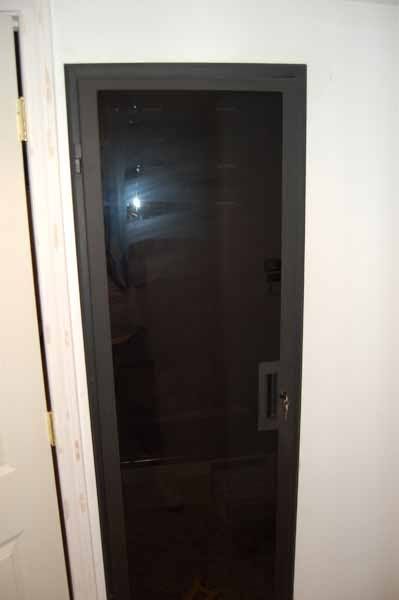

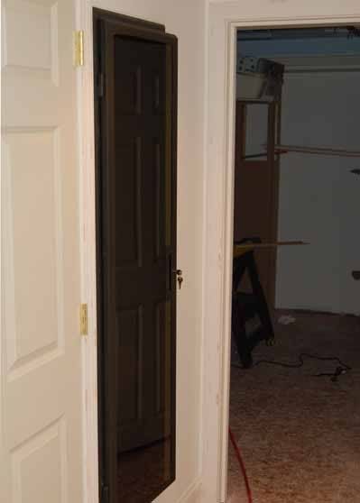

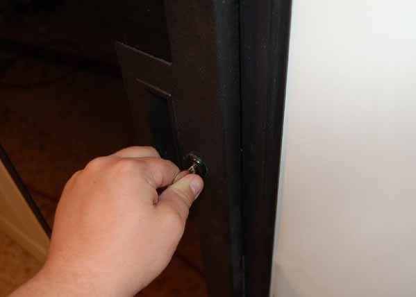

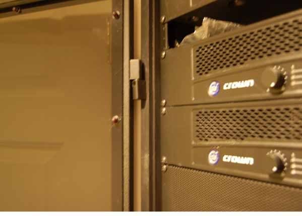

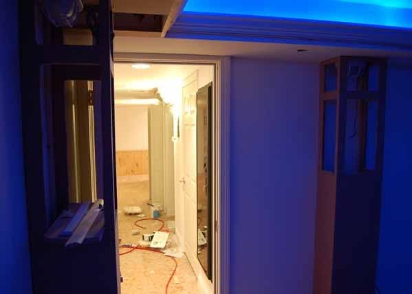

Well, the door is up. It wasn't as easy as I hoped, as I snapped a drill bit, which got trapped where my screw was needing to go. Net result, we forced a screw in anyways, and it worked. We also discovered the opening my carpenter put in was something less than level, so it isn't as pristine as I might like, but it will get the job done. The pics:
On the approach
Straight on:
From the HT:
Open (amps will be reshuffled a bit later):
Latch - I'll need to add a piece of metal to the trim, and just protrude in towards the rack, and the latch will grab. Should be fine once I get it:

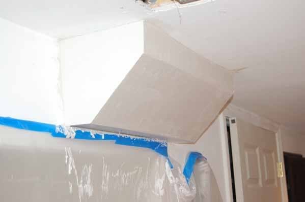

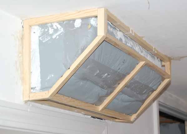

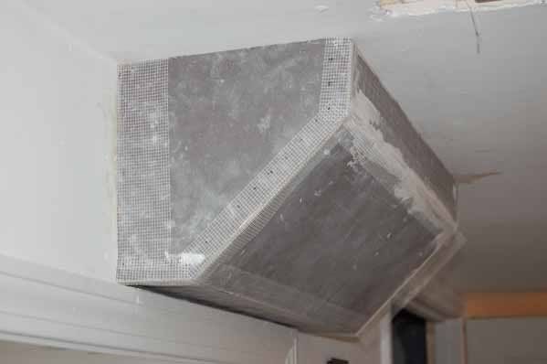

Playroom update -
Had the day off today and we took on the eyesore in the playroom. Yesterday we framed our fix, but here I'll show the progression from evil to good.
First, what our carpenters built. Big, sconce blocking, non-disapearing, thing:
Next, was a version of the same thing, slightly smaller, with less craftmanship (uneven edges random pieces of molding to disguise that the wood wasn't sufficiently sized, wood in lieu of mesh on the front. To spare the guilty we neglected to photograph it, and instead I'll show you what we thought of it, specifically, adios:
Yesterday we started the healing:
This morning we carefully cut blueboard, with mitered angles, exacto-knife jujitsu, and a dash of staples and adhesive:
Finally, tonight, post toddler in bed, we got messy as, pure novices, we mixed up a batch of veneer plaster, (two trips to get the right mixing bit for the drill), lifted our trowels and other scraping implements, and did the race against time of trying to make the plaster look right before it dried. I am a lucky man to have a wife with a steady hand and an abundance of patience (with plaster, and me). It came out pretty nice, mostly on par with the work the pros did in the rest of the basement. It should be as near to invisible as its gonna get when we paint the walls.
Plastering notes: It is very messy and tedious. Oh, and its messy too.
dc_pilgrim is offline

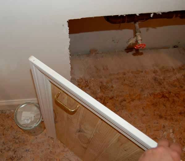

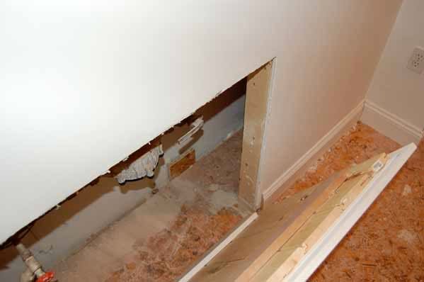

Okay this is this weekend's project. Sorry, more playroom stuff. One of the last couple revisions to the carpenter's work. He built an access panel to the main water shut offs, then nailed it shut. Seemed like less than perfect access, so we are going to redo it, and put it on hinges and that sort of thing.
Here is the target:
One of the things we need to fix is that he attached the molding to the panel, not the wall. My wife is a stickler for the trim being plush with the wall, so we will need to re-do that. In doing so we will likely need to address the baseboards, triming them back slightly to accomdate the panel's trim being affixed to the wall. I am thinking the dremel might be my best "close quarters" tool to shave back the baseboards for the other trim.
In terms of the inside, I am not sure if we can just attach hinges and a magnetic latch to essentially function as a jam, or if we need to build a jam, or sister up the 2x4's with additional material to better accomodate the door. At a minimum, I am thinking we will need semi-beefy hinges as the access panel is fairly wide, and cumbersome. Any thoughts on hinge types, maybe cabinet hinges?
(will open right to left)

Given that it's in a playroom, I'd be inclined to leave it semi-permanently closed, to minimize the amount of kids getting in there, being kids, and playing submarine commander, turning water off to the whole house...
Also, for as infrequently as you'll need to get in there, any solution that looks good is by definition good enough. Having it on a hinge provides no functional benefit (and may make it more a PITA if anything ever needs worked on in there beyond turning the service on/off).
Put a toybox in front of it, I say...
Dave, this just happens to be my area of expertise.
European concealed hinges
Face Frame Concealed Hinges
Hidden child safety locks
Once you get that trim off the door, I can guide you to a hinge that will do the job. The nice thing about the Euro hinges is that they clip onto the mounting plates, so if you need to major service work you can unclip the hinges from the mounting plate and move doors out of the way.
If you email the address for support on our website or call, you'll get me, or you can just PM me here at AVS Forum.
Hope this helps

Sokoloff - interesting point. Ultimately it has to be changed due to a desire for clean lines. I think I am still leaning towards a hinged door, but perhaps one that has a better latch/lock.
Chip - I'll drop you a PM, as I hope you aren't working late.

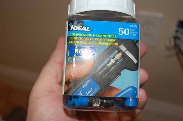

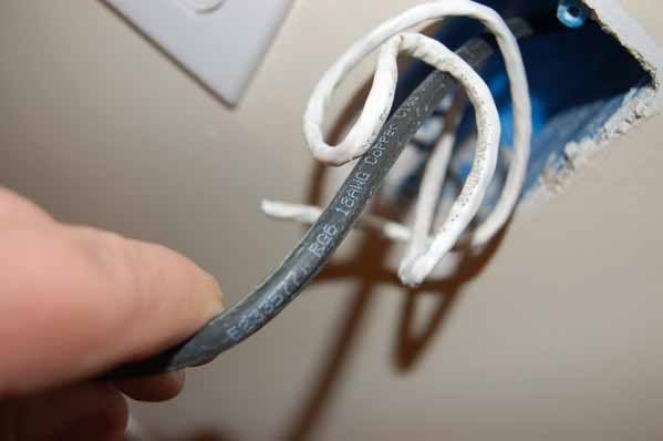

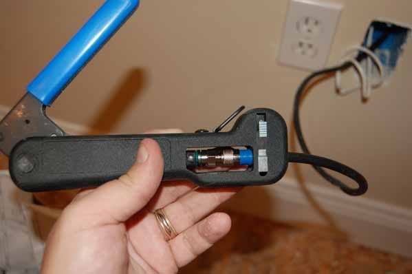

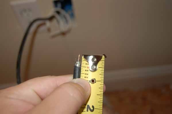

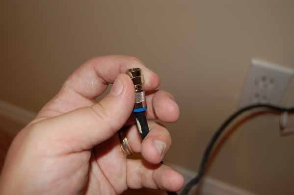

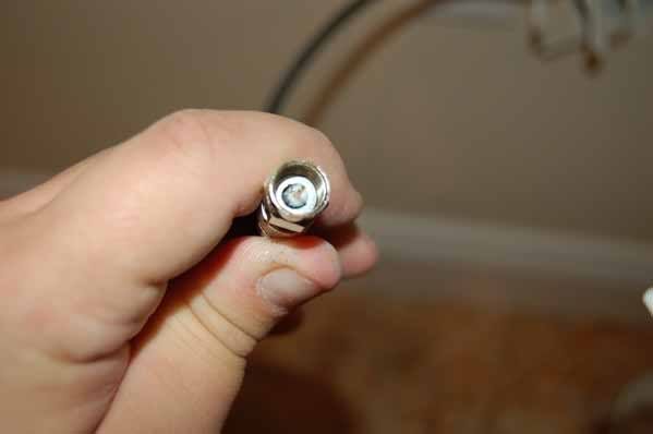

I was having trouble with my coax terminations, the connectors kept falling off. Very annoying. I posted a thread in the AV Distrib forum, and got some helpful responses. I took pics on each step, and some one else might find it a handy tutorial:
http://www.avsforum.com/avs-vb/showt...php?p=11197788
Originally Posted by fedders View Post
A couple of pointers:
1. Make sure you have the right connector for the coax. Match Quad (4 shields) connectors with Quad coax. Match dual (2 shields) connectors with dual coax.
Check
and check
2. Make sure to prep the coax properly. roughly 1/4" to 3/8" of center conductor should stick out out of the white dielectric. 1/4" of foil on the dielectric should be exposed. All braid should be pulled back over the jacket so that all you see is the foil for roughly 1/4".
3/8" for the conductor, 1/4" for the foil (approx)
3. Make sure to seat the connector properly. The end of the white dielectric should be flush with the inside of the connector where the threading stops. If you look at the end of the connector, you should see a hole in the middle that is smaller than the threaded part of the connector. This is probably 1/4" from the very end of the connector.
Set in place
4. Before you compress the connector, make sure you do not see any loose braid strands near the center conductor. If the connector is seated properly and you are looking at the end, you should see the silver from the connector on the outside, white dielectric in the middle, and the center conductor on the center.
5. Compress all the way. Make sure you are using a tool that is matched with your connector. Most compression tools are inter-changeable (in my experience), but some are not.
Rock and Roll
6. If you've done all this and you are still easily able to pull the connector off the coax, you may want to look for a different brand of connector.
Hope this helps,
Carl
Doesn't separate!

I have the same system for the RG6 connectors as well. Works like a charm. My only complaint is that they won't fit the RCA compression connectors (at least the ones I have). Did you see any RCA fittings for the Ideal in your area?
The door on your equipment rack looks great. I'm thinking maybe I should have done that instead of the wood finish
Thanks. Never owned a table saw, so I am still figuring out the ins and outs. It is slated for a lot of work cutting ply and MDF into the pieces needed for fabric frames.
I picked my compression tool at HD - I'll check on my next run to see if they have any RCAs.
Glad you like the way the door came out. Its a bit spendy (what isn't), but my wife kind of pushed for it since the rack is in the kids playroom. The benefit of a lock! Before I decided on that I was thinking wood trim too. Too much time in Bud's thread admiring the trim!
