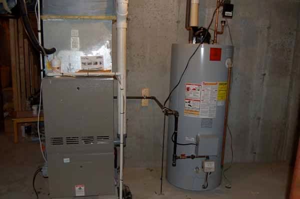

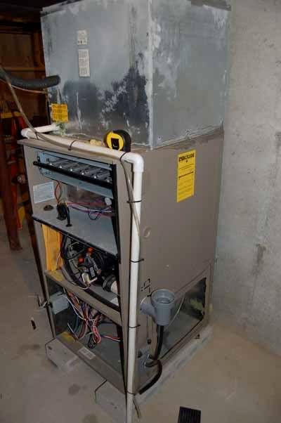

First challenge: gotta move the furnace and the H/W heater. Builder put them in the cheapest and worst spots. In evaluating bids, it was only a bit more to run a zone per floor as it was to run a zone for the basement and the rest of the house (~2000 Sq ft, two story sideways colonial). So all the existing ductwork in the basement is coming down. The beams run where the lally's are, so the duct work will have to pop under that in places which may ugly it up in spots.

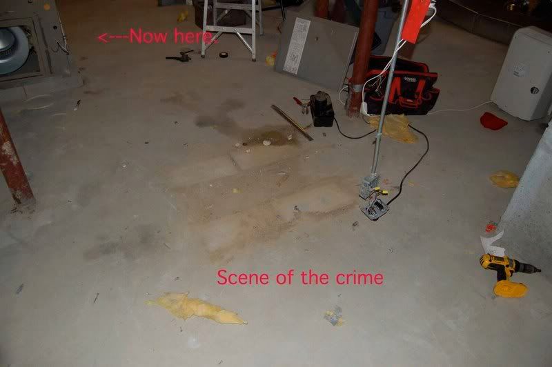

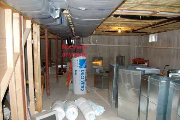

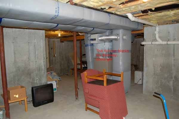

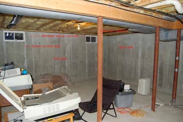

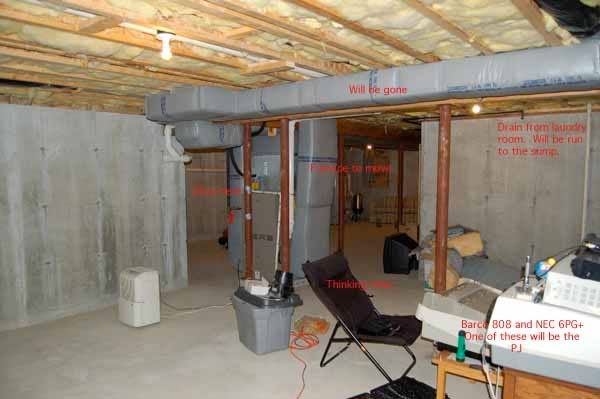

Here are some shots of the space
Before
After:
From the screen location - before
After
Furnace sitting where the door will go - before
After (looking the other way)
Here is a shot of the screenwall.

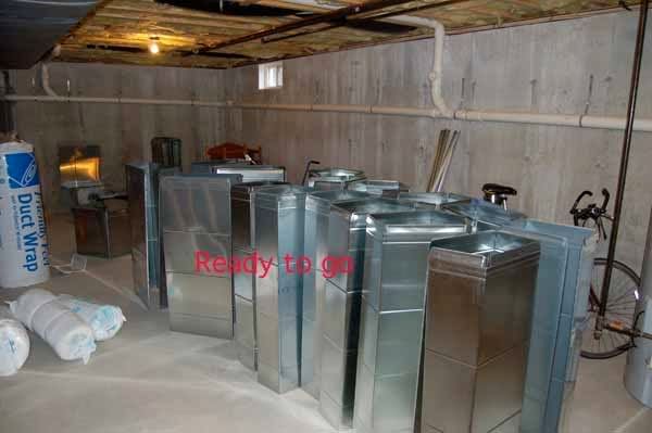

HVAC guy is stopping by tonight. I need to propose some matters on the ductwork. In the existing layout there is a metal duct running the lenght of the bottom of the room. I think this is going away.
The design goal is to put insulated flex duct into the room, and get a few turns into the duct before it exits the room to reduce flanking paths. This was pointed out by Bryan Pape in a conversation I had with him. This is what I have come up with my initial thoughts on routing the ducts. The perimeter of the room will be soffited, so that will be the logical location for the duct runs.
Any comments on what I have come up with?

Got good news from my HVAC guy though. The legacy ductwork in the HT space is going away entirely. So I won't have to work around that.

Added the before pics to post #3.
The HVAC is now moved. Pics of that tonight. Ran into an issue regarding the height of the run going under the beams.

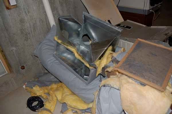

Well, the supplies got ripped down in the Relo (pics soon, really), so that is no more. We're still not 100% back running since the beams got in the way, and I was going to lose too much headroom at the entrance - as in hit your head at the door.
When my guys ripped down the supplies they found out that no adhesive was used in joining the ducts together, except where they would be visible to the inspector. Apparantly there were 5" gaps at the joins after 2.5 years. No corner to small to cut.
dc_pilgrim is offline

Here are some pics of the relo so far. We had to rethink things on the fly, but everything is working out. Here are some action shots:
Preparations:
Gone!
Crime scene
Episode IV - A New Home
Carnage!

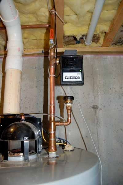

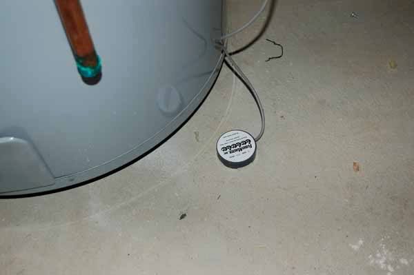

H/W Heater moved today. Some pics:
Gone!
Pipes plugged up
Relocated next to the furnace
The shut off regulator (if the tank bursts)
The sensor for the shut off device

Been checking out your thread good stuff so far. Glad to see a fellow New Englander, Southern Mass to boot. I'm in West Bridgwater, and by your screen name I can kind'a guess where your at.
Question about that shut off regulator. Did you have it before you moved the H/W tank or did you have it added now? Did you install yourself or by a pro? and How much materials and labor if any?
My Tank is right next to my future HT and something like that would be nice to prevent future problems. Thanks.
