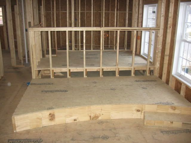

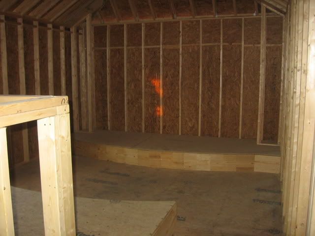

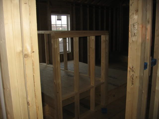

Here is a photo looking to the back of the room where the edit bay will be. The room entrance is on the rear left of the pic.
This is a photo from the common area looking into the theater entrance.

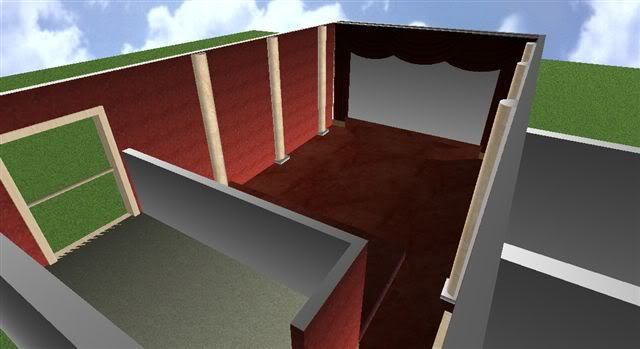

OK, I just did a really BAD render of the room...looking from the screen to the back.
Please don't pay attention to the color scheme...i just did shades to be able to tell the difference between different surfaces.
It kind of gives me an idea of the space...but I still need to figure out the height of the wall behind the theater seats.

OK, I have been working on some renders of the room.It is far from perfect...but it is really helping me visualize the space.
From above behind screen:
Above edit bay:
From entrance...view into edit bay and theater:
I'll work on ceiling and furniture when i have more time...also wall design and color hues will be different.

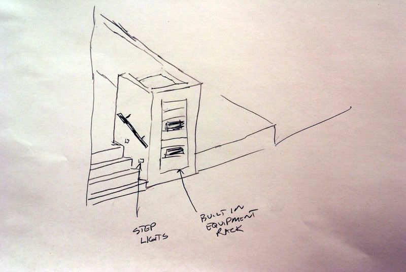

It's looking better every day.
I've got any idea for you but I tend to work the old school way, back of a napkin kind of approach.
This way some of the equipment would be accessible from the ground floor. Like when you just want to pop in a dvd and not have to climb up to your office.
Would also keep other family members from having to go into the work zone. It could actually be a back to back rack with some stuff aimed into the work space up in the edit bay.

DC... I love the rack idea...but I was planning to put a recessed display for my Emmy in there. I am now thinking about a short rack below that display... but I'm not sure it will fit. I may be able to get a 5 to 6 space unit in there.

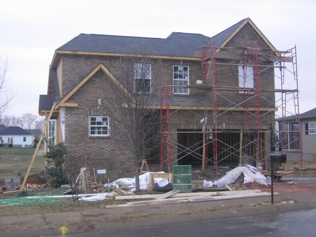

Scott,
Here is a pic of the front of the house. The theater is upstairs left. You see why I can't move the window. But it will be covered like I said in my earlier post.
-Cam
Originally Posted by scottjohnson View Post
hey DC, nice ideas you have here.one comment if i may, if the floor is up to the bottom of the window, as per rendering, the window will need to be moved up also. the reason i suggest this is, if he needs an inspection it won't pass, there has to be a certain distance between floor and bottom of the window, so children can't fall or get shoved through. like i said great ideas, just my thought.
-Cam

Ok, Here is the progress so far.
View from the entrance:
View of the screen and stage.
View of riser and edit bay from stage.
I have run into some snags. My 3 foot wide walkway hat to be at least 3 feet 6 inches for codes. I think this will be OK...because my rear riser is now 10' 3" wide.
The edit bay is 6'10" deep (rather than the 5' 9" i suggested) per codes needing the half wall a certain distance from the window.
My rear riser is 6 feet deep at the edges and 5 feet at center...I am having it shaved down to 4.5 feet deep at the edge and 4 feet deep at center. I will prob. move the riser steps to the walkway side.
As it is now... I think I will be able to fit 5 standard seats in the rear row and 3 berkline type seats in the front.
My distance from screen to riser will now be slightly shorter than 12 feet.
The front stage is missing the step across the entire front..I will see if this can be added.
Not my ideal situation...but still workable.
