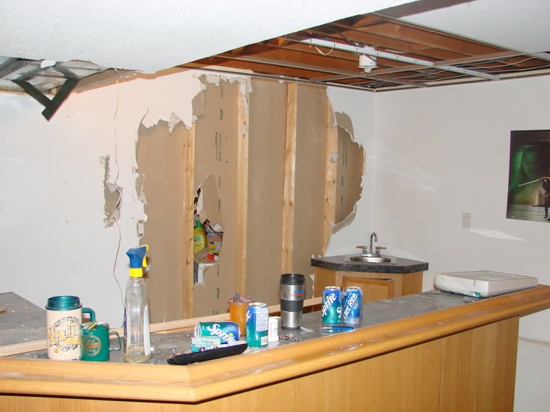

post #7 of 301 Old 01-30-2007, 12:38 AM - Thread Starter
NeoOiler's Avatar
Location: Edmonton, Canada
Posts: 610
Yeah I am gonna double drywall both walls that I am making and insulating both. I dont think I can go the green glue route..too expensive. Absolute soundproofing is not that essential the whole fam will probably be in there most of the time or in the adjoining playroom anyways.
Here are some progress demo pics from the past few nights demo...enjoy..hahah' Dont mind all the Sprite cans, cutting out aspertame, and caffeine.
BEFORE..........
DURING......
DONE.....TIME FOR CLEANUP
Ryan

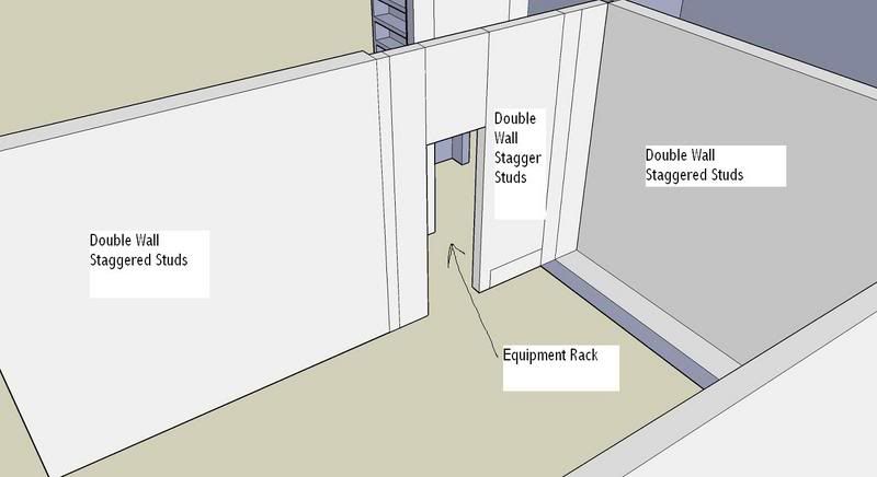

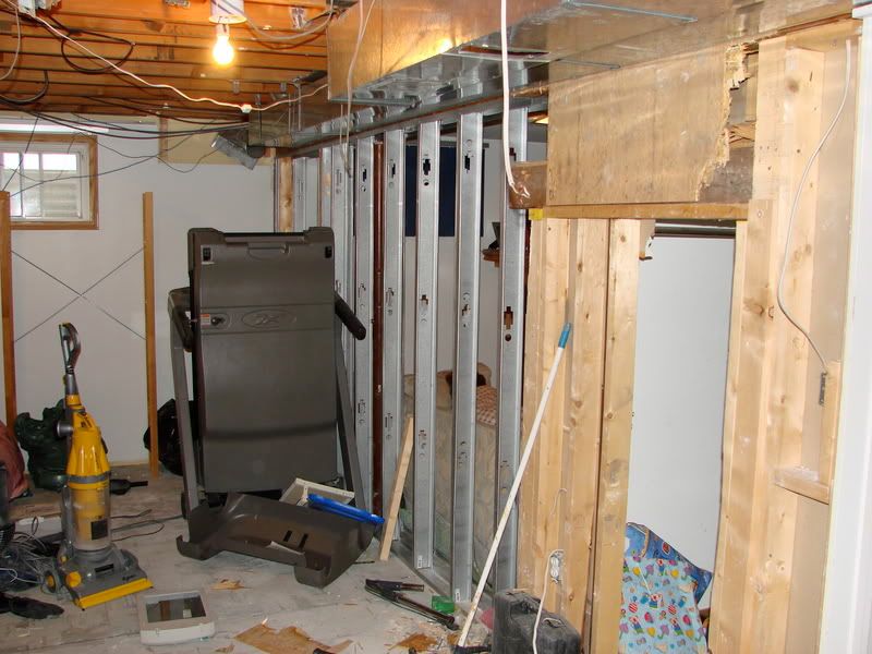

post #28 of 301 Old 02-03-2007, 06:23 PM - Thread Starter
NeoOiler's Avatar
Posts: 610
So I started doing my double steel wall stud, do I leave a gap between the two walls?? Do I join them togther in anyway..
Please answer....building right now..
ryan
IM FINALLY FINISHED...(WELL ALMOST)
THE PITT CONSTRUCTION THREAD
NeoOiler is offline
post #29 of 301 Old 02-05-2007, 01:25 PM - Thread Starter
NeoOiler's Avatar
Posts: 610
Hey everyone got a nice bit done this weekend. Main double wall is up. Filled in Laundry room door. Making that a double wall as well.
Little bud helping Dad
VIEW FORM SCREEN AREA
EQUIPMENT RACK LOCATION
Any suggestions as I keep going??

NeoOiler's Avatar
Posts: 610
Just wondering if anyone has any suggestions for the cavity under the stairs?? I am not really sure what to do. Any suggestions would be appreciated!
Ryan
