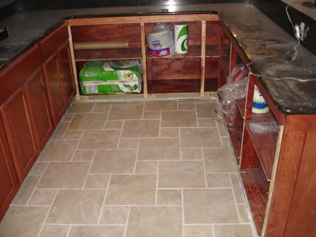

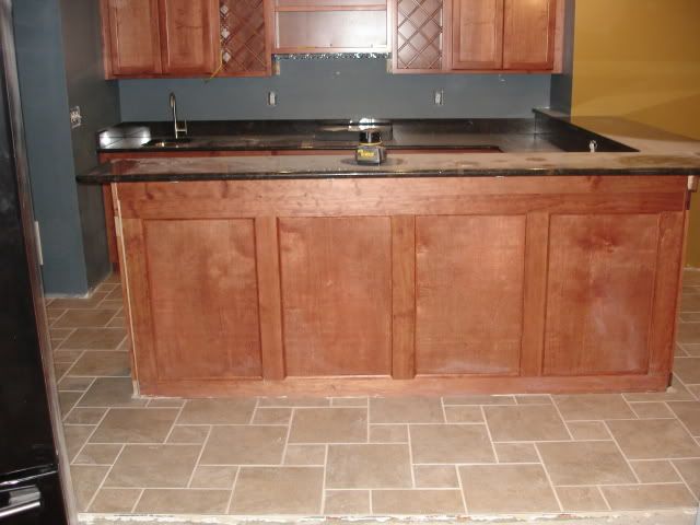

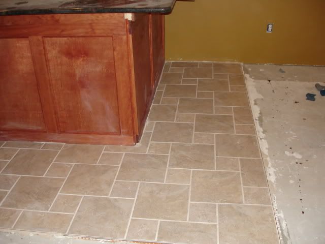

Hey Jay...the bar looks GREAT. Regarding your Barney encounter (LOL BTW) I hope you and he get things worked out....sounds like he owes you one
Thanks for the compliments! The Barney Incident (as I now refer to it) ended up being no big deal and is hardly noticable unless you get on your hands and knees. That doesn't sound too good....

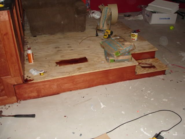

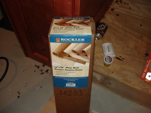

Hey Jay, I was thinking of using the Blondewood for my bar also because it doesnt have as much grain as oak. What did you end up using for the trim to match?
#282 ·
Originally Posted by RPh Drew /forum/post/18463881
Step away from the purple dinasaur
Just great....now I am never going to be able to look at MJ again. Such sweet innocence. LOL
#283 ·
I ended up using some nice pine for the trim. Matched faily well but if I could do it again I would have skipped the blondewood and gone with birch instead. When staining the blondewood I noticed that no two pieces stained the same. Some had more grain than others. Not very noticable until you get up close. The birch gave up a more even stain.

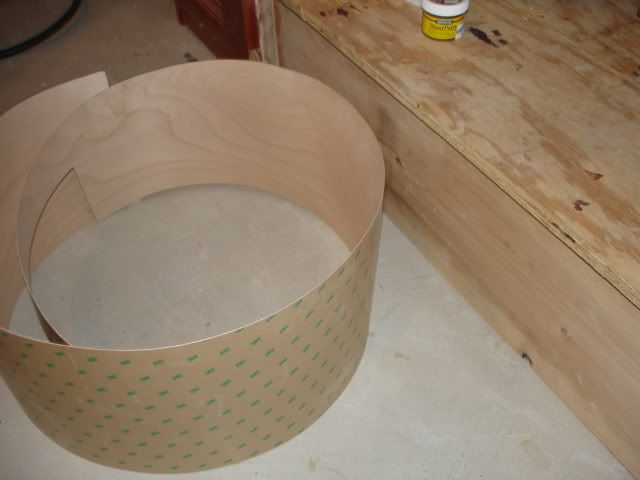

I used birch for my rack that I built. I stained so much nicer than the blondewood. In the end they aren't too far apart and most people will never notice the variations. I notice them but I am learning to live with it!

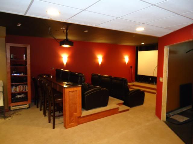

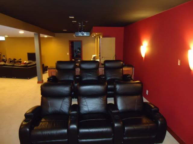

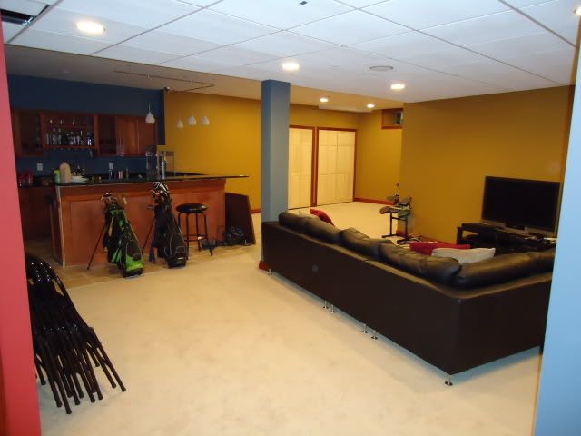

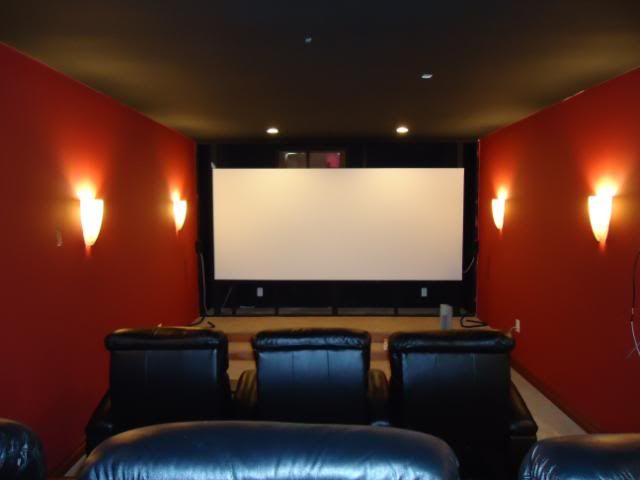

Well I finally got a free weekend recently and got some little projects finished. First up was putting in the undercabinet lights. I ended up going the very simple, cheap and effective route. I installed Seagull Ambiance® Low Voltage Linear Lighting System. Wire up the transformer, screw in the track, run the wire, plug in the light fixtures into the wire and done. Here is how it looks with the overhead lights on and off.
Next up was finishing the drop ceiling in the middle of the basement. I had to complete a bunch of complicated cuts that I was just to lazy to finish before. Check that off the list. I am flying now....not.
Then I wired up some temp sconce lighting in the theater. At least I can see in there now.
Last but not least I used my kreig jig to build a frame around my equipment cabinet. Turned out better than I thought. Now I just need to build a wall to slide it into. Maybe next weekend.
Yes I realize I need a little bit of dusting.
