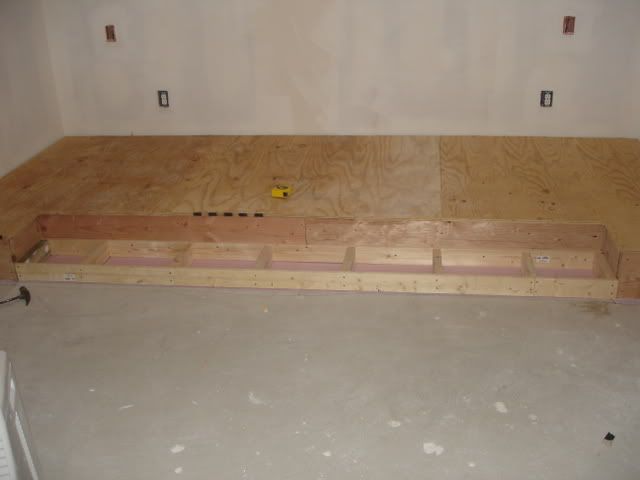

Home Theater is 12.5' x 23' open to the basement
Two rows of seats with a riser with bar stools behind
1080p Projector with 11'w 2.35 screen (SMX) and lens

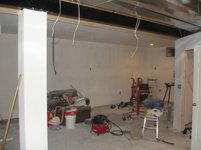

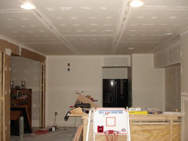

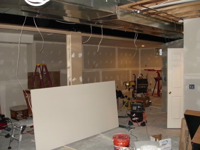

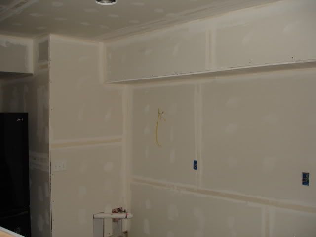

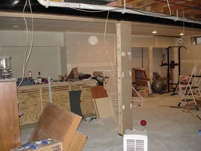

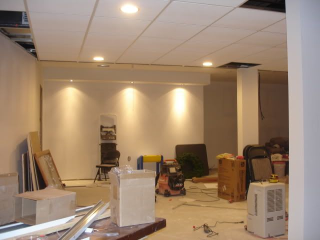

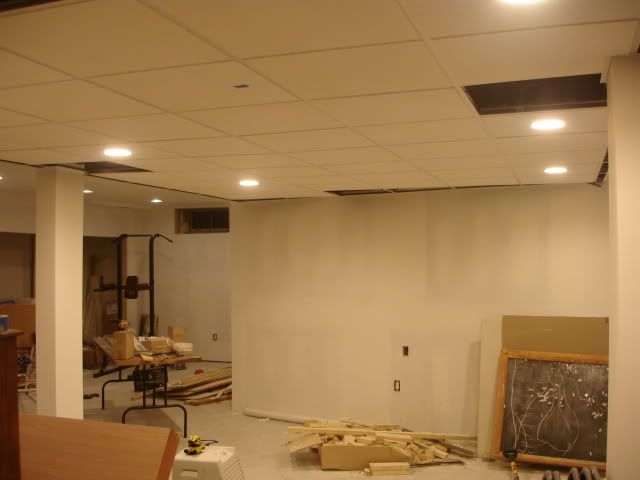

So in a little more than a month I have managed to tape my drywall. That's right, just tape. I probably could have knocked it all out in a weekend but what would be the fun in that? I am actually starting to get the hang of taping. Too bad, because now I have to do the top coats. Check out the handy work.....
Workout Room
Bar area
Bar area from other angle
Imagine this with cabinets...
Looking into the HT from the bar area
HT area doesn't look like much now but just wait, in about 24 months it is going to rock!
I really need to clean this place up. Wish me luck!

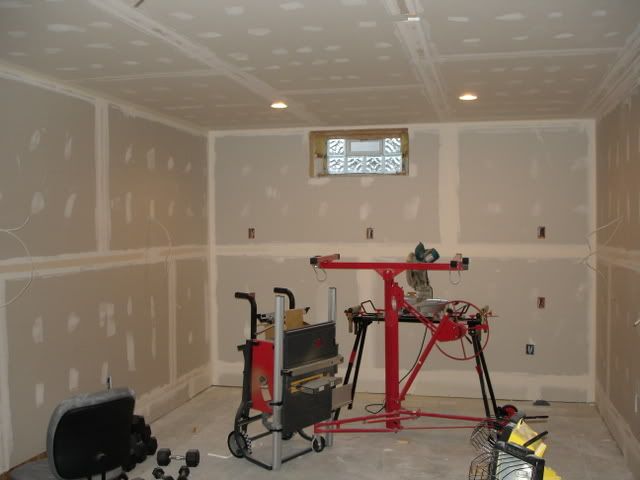

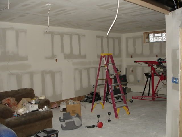

That one was pre-exisiting. The builder would not make all the windows glass block so one of my four is just a regular window. I think there is some rule that you must have one operating window in the basement. I have been pricing out replacing that regular window with Glass Block but everyone offers $125 a window with a $250 order. I am seriously thinking about replacing it myself. I mean how hard can it be? I will probably make it 3 times harder than it needs to be. LOL

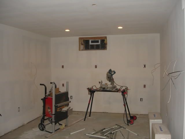

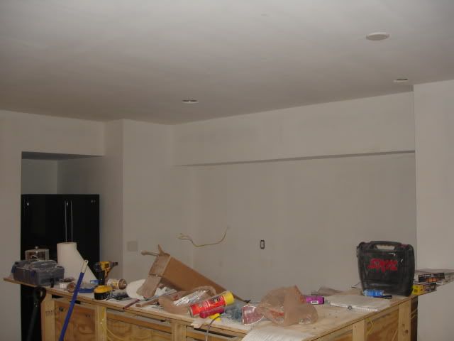

I haven't really had much time over the last few weekends to work on the basement, with family obligations and all, but the drywall is 95% done. Just need to final coat the corners and do a light sand and I am done. Should finish up the weekend after Labor Day since we are going up north this weekend. Next is MAJOR clean up. Then paint and the drop ceiling in the middle of the basement.
Things I have learned about mudding drywall....
#1 No matter how much you think you will save time by mixing an entire bag of hot mud DON'T DO IT! You will have to toss it before you get a quarter of the way through it. Thank god my mud was free.

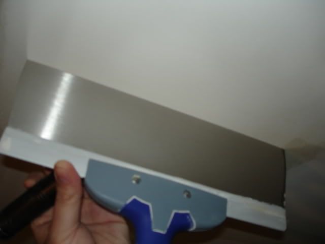

#2 Get a cool little sanding tool like this one. This thing rocks and it makes sanding a breeze!

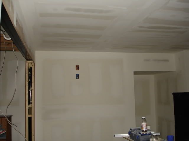

#3 Read everything on Drywallschool.com and follow it. I have very little sanding thanks to that site. See how nice it looks?

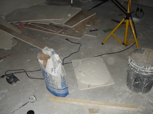

#4 Clean everything out of your work area before starting or you will have to move everything around like I did 500 times. Look at this junk...I have no idea how I am going to clean that chair. Any ideas?

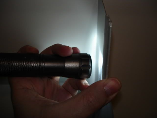

#5 Get a little flashlight to check your seams. If you can see light it ain't right.
Perfect!

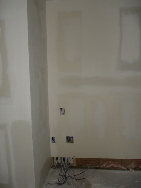

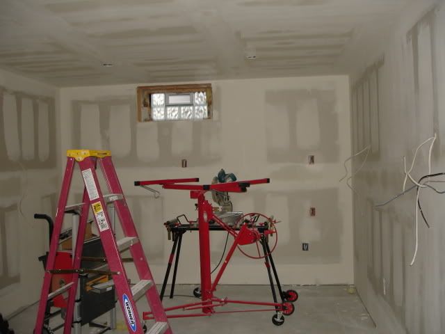

#6 Mud can hide anything. This corner was totally jacked and I made it look halfway decent. For those observant folks....yes those are all my cables pouring out from under the drywall. I need to pull them through the hole I made.
(I've rotated this image is Photobucket 12 times but it keeps posting like this.)
#7 Don't try and make the wall behind your screen wall look perfect. It is just going to be covered. Well at least if the next owner is crazy, and doesn't want a theater, he can pull down the screen wall and have a nice looking wall.
