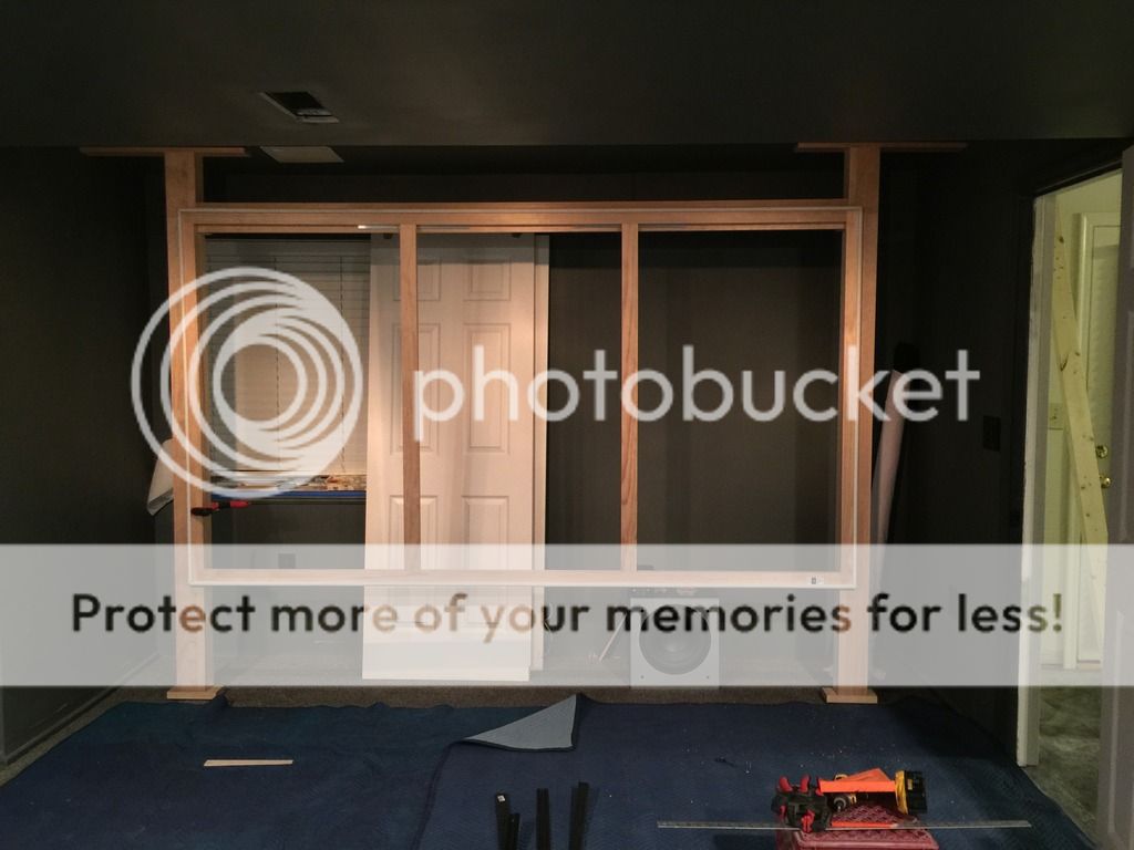

@BIGmouthinDC I've used this thread as a blueprint of sorts for the very near future remodel of my bonus room/ht. I can't thank you enough for providing your insight to the rest of us diy'ers trying to save a buck and create a room that our family's can enjoy.
I do have a question though. How exactly are you guys framing your AT screens? My plan is to use an AT fabric like white spandex over black/grey spandex. For some reason I haven't found how you or anyone else framed their screen. I know your original 16:9 screen was hung on top of the false wall. Did you friction fit your screen in the CIH setup?
Sent from my SM-N910V using Tapatalk
1st Cav is online now
Old 08-27-2016, 08:10 PM - Thread Starter
Posts: 27,164
Mentioned: 175 Post(s)
Tagged: 4 Thread(s)
Quoted: 3014 Post(s)
Liked: 2532
nearly every sceeen I've hung has been with z clips on the front face of a minimal frame, with black fabric frames surrounding it.
As for framing a DIY screen you want straight wood that is going to stay straight, so that rules out 2x4 studs, my go to wood is the finger joined pine boards, same as the minimal wall. If you use mid span supports make sure they are set back from the front so they don't show a crease through the fabric.
Thanks for the pics, they are extremely helpful. And the mid span support advice is great, I never would've thought about that...at least not until I had finished mounting it and realized after the fact.
When you say you surround the screen with some type of black fabric frames, are you referring to the large fabric frames that make up the entire screen wall or are you talking about a separate frame that specifically surrounds the screen (think black velvet border around a Carada screen).

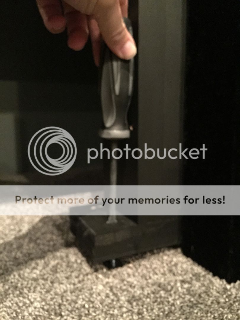

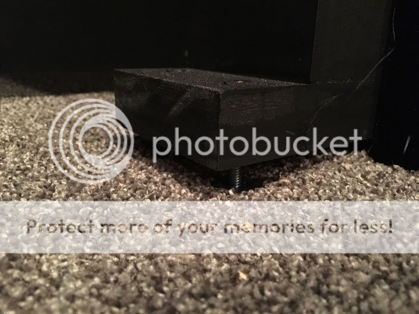

I just finished up my screen wall this weekend and thought I would share my results here as well. Since I don't have a stage to attach the goal posts to I had to figure out how to secure the bottom to the floor so they don't move around. I ended up getting some adjustable feet like they put on the bottom of desks and I put them in the bottom of the posts. I left them loose enough to move them around, attached the top of the posts to a couple of the ceiling joists, then once I got the posts plumb in both directions I tightened up the feet to hold them in place.
Newt1822 is offline

can you show the feet closer up?
BlueWRXPride is offline
This is the best picture of the feet i can get without taking it apart. Also since the mounting holes for the feet went all the way through the bottom plate, used a dremel to cut a small sot in the top of the screw of the feet so that i could use a screw driver inserted from the top to make it easier to adjust the feet.
This is an awesome idea! I am going to be building a false wall over a concrete floor with a drop ceiling, I wasn't sure how to attach the bottom without having to do a runner over to the actual front wall. This is a fantastic solution. My first option was to overbuild it massively - this is a much better option.

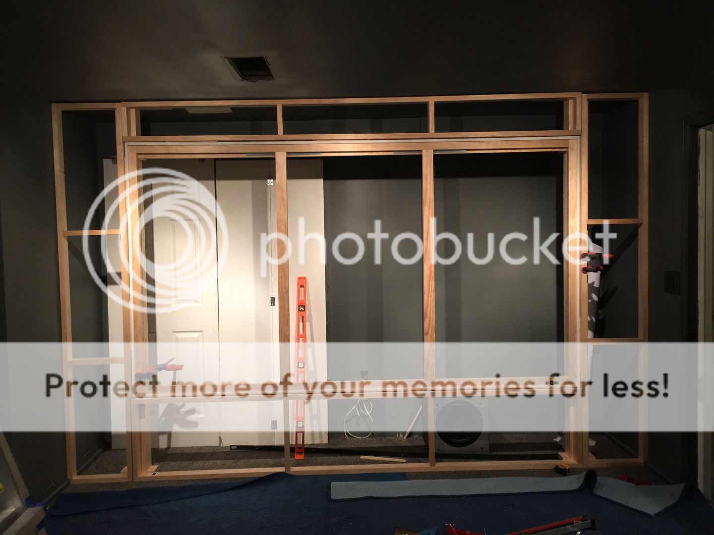

Another tribute to BIG. Without your advice, I would have probably framed out a 2x4 wall with lumber from Home Depot that would twist up like a pretzel.
I need to add another cross brace at the bottom. My screen has clips that attach to the bottom keeping it a consistent distance from the screen wall. They also lock it to the wall so you can't pull the screen down until you unhook the clips.
