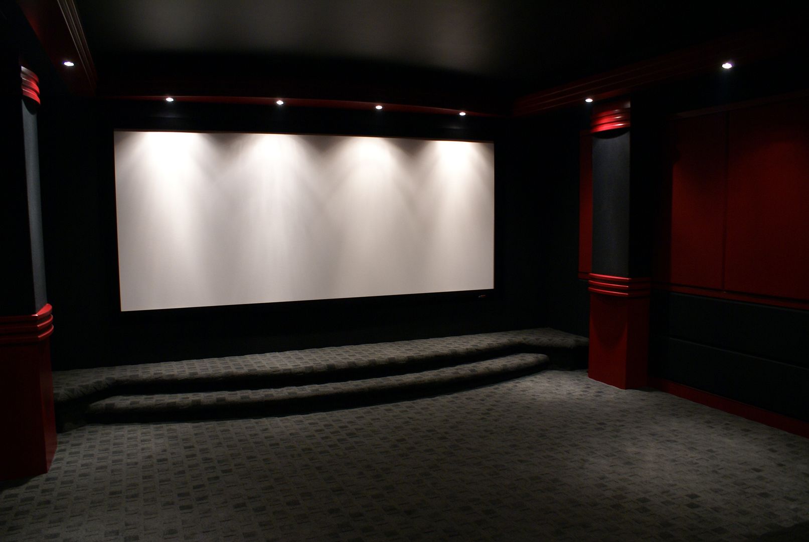

As for the Marquee over the stage:
the rounded piece was actually a double layer of PVC wood composite which bends pretty easy. The long straight pieces were the finger joined pine. The rest was ripped 2x4's The thing is 2 inches thick. Stuffed with 2 layers of Linacoustic, wrapped in black GOM. It's mounted to the ceiling with 2 screws (through the uprights in the back) and 2 tubes of Lock-tite adhesive (the stuff in the commercial where the guy glues the hammer to the ceiling)
here are some construction pics of the details.
details on that Finger joined stuff:
Measure twice cut both sides at once, my template:
Finished frame:

1) looks right, not the one I've seen in the past but should work
2) just cut wood to two inches
3) I just laid the piece of wood on the floor over top of the drawn circle and eyeballed the line onto the wood, then went to the miter saw and aligned the blade with line on the wood. Doesn't have to be exact. While it is set cut an identical one for the other side.
4) I have since removed the screws, it is up there with Loctite power grab.
5) I didn't drill through the fabric in the visible area it was the back edge.

Question regarding the lights that flood the screen wall...
I assume you place the 3-4 lights in a straight line in the ceiling (or upper stage in your case.) If so, what is the approximate distance from screen to light?
I want to make sure the light is not too focused but will instead create a nice wash like I see in Jesto's, Damelon's, and your theater.
Cory
manthatsnice is offline
post #163 of 525 Old 11-17-2011, 09:14 AM - Thread Starter
Posts: 27,401
Mentioned: 225 Post(s)
Tagged: 4 Thread(s)
Quoted: 3520 Post(s)
Liked: 2978
I don't have down lights on my screen.
At Damelon's I think they were about 5 -8 inches from the screen surface. They were those small 3 inch halogen cans. The screen surface is an inch or two to the right of the red edge of the front light tray in this picture.
Ask him and he may go measure for you.

That's what I get for not looking back through your build...
It looks like you guys put Damelon's on the curve. I'll ask Damelon for the measurements.
