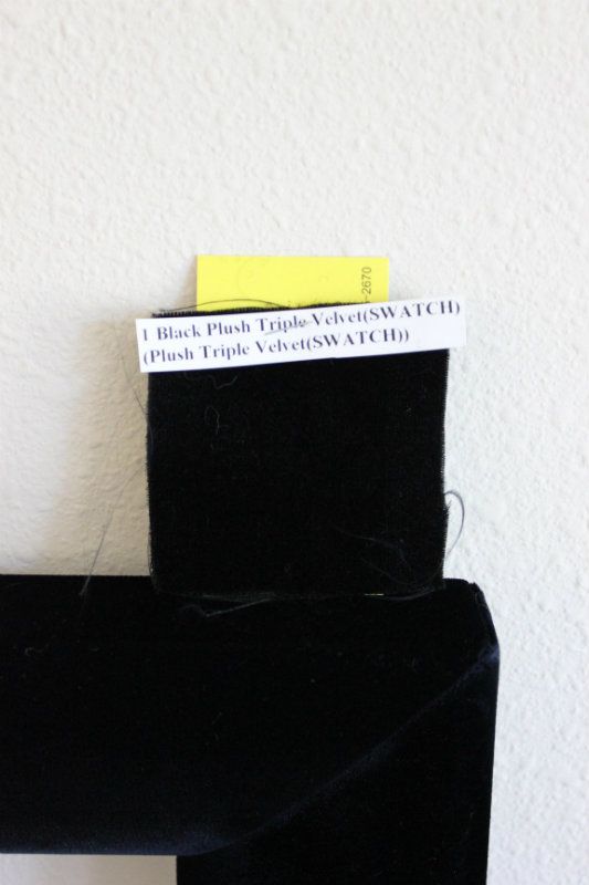

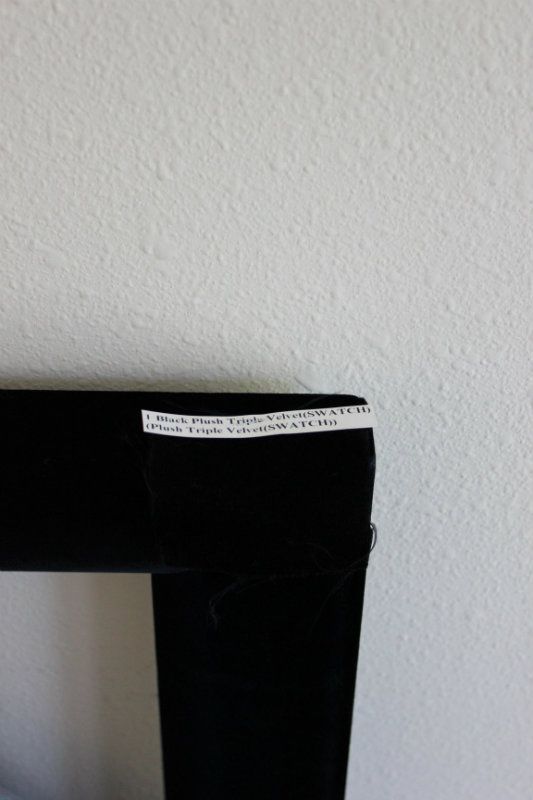

Received the swatch of Black Plush Triple Velvet from SyFabrics. Here are a few shots against Seymour's Fidelio-wrapped frame.
It's dark enough for me.

SWEET!!! My order is sent!
How many yards are you going to order?

I need a little more than 5, but am going to order 7 to cover future repairs.

Spaceman said he could barely blow through it, I doubt the acoustic transparency is sufficient for covering speakers.
post #210 of 525 Old 11-26-2012, 08:39 PM
Spaceman's Avatar
Location: North Houston
Posts: 2,013
Mentioned: 8 Post(s)
Quoted: 41 Post(s)
Liked: 145
Originally Posted by AT1AW View Post
Space... What do you think the acoustic qualities of the fabric are? I plan on having speakers behind panels on my wall... do you think this would be good to use?
I'm assuming since we are talking about black velvet, you are referring to panels on your screen wall and not panels covering side or rear surrounds. Is that correct?
Either way, I don't think you would be happy with the result....sort of like wrapping your speakers in a blanket.wink.gif I think black GOM FR701 is the fallback for screen walls if your front speakers sit directly behind fabric. You might also look at Acoustex Fabrics. They have a black in their Designer Series that might work. I used both FR701 and Acoustex fabrics on my side walls and based on unofficial blow tests, I would say that the Acoustex fabric might be a little more transparent than the FR701. Haven't seen any numbers to prove it. Just an observation.
Spaceman is offline
