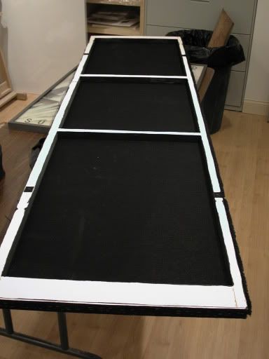

From time to time I've seen builds posted where the screen wall looks like a load bearing wall, so last week when I had mine apart for carpet installation I took a couple of pics to document my approach which is minimal and considering I intend to join the 2:35 club at some point easy to modify.
I started with 2 rectangular frames of finger joined pine trim boards. Connected on the top and bottom with a cross member. I doubled up the outside leg with a space between the two boards.
I stood them in place and screwed through the top into the ceiling and bottom to the stage. Added Linacoustic and some leftover eggcrate from my speaker building projects. Also three blocks on the side walls.
Next built 4 frames and covered with black GOM. Added a few dabs of velcro. A little goes a long way because if you use too much it's really hard to pry off a panel. Paint the visible sides of the frames black before attaching GOM.
Then I put up the two sides, the screen and the top and bottom panels, in that order.

The screen is a Stewart with the deluxe frame. It mounts with 4 large head screws. The frame has 4 brackets. Each bracket has a slotted hole that fits over the the head of the screw and when you lower it an inch it's locked in place. If you look close at the first pic you will see 4 white spots on the inner vertical supports. That's the screw heads sticking out and the paint roller didn't make complete contact.
With the GOM panel resting on top it's wedged into place and isn't going anywhere.
Bpape: I'd say the design would hold about a 150 lb frame.
What dimension of boards did you use, and did you use the same boards for your frames that you wrapped the fabric around?
I'm also curious if you needed to make sure these were screwed into a joist on the ceiling, or if just into the drywall was good enough?
I've been admiring your screenwall for almost a year now, it is nice to take a look at the magic behind the fabric. Simple is good.

Without taking it apart again, I think the uprights were 1 1/4 x 3 (or 3 1/2)
Here is another shot of the bottom panel.
The smaller pieces were 1 1/4 x 1 1/2
I stuck a couple of pieces of larger stock on the ends for a little stability
Drywall was fine for me. (two layers)
the two side panels actually have pieces that are not square. Since they sit at an angle I cut all the pieces to fit the appropriate angles. If you look carefully at the pic you might spot it. Sorry don't have a close up.

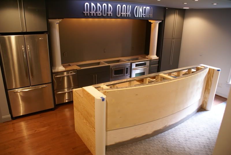

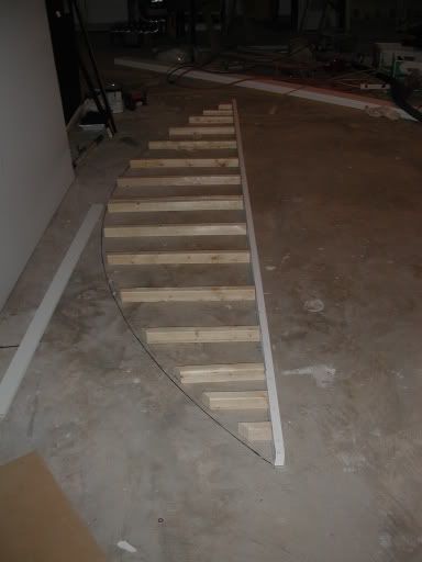

As for the Marquee over the stage:
the rounded piece was actually a double layer of PVC wood composite which bends pretty easy. The long straight pieces were the finger joined pine. The rest was ripped 2x4's The thing is 2 inches thick. Stuffed with 2 layers of Linacoustic, wrapped in black GOM. It's mounted to the ceiling with 2 screws (through the uprights in the back) and 2 tubes of Lock-tite adhesive (the stuff in the commercial where the guy glues the hammer to the ceiling)
One other little detail, I put a couple of cross pieces of black Gaffers tape (and stapled) across the big sections to keep the linacoustic from sagging the GOM.
here are some construction pics of the details.

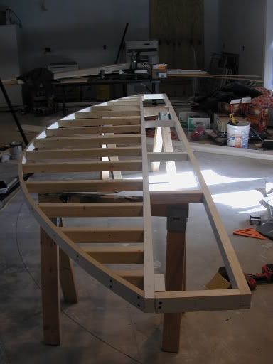

details on that Finger joined stuff:
Measure twice cut both sides at once, my template:
Finished frame:
I practiced lifting into place 4 times before I did it for real. I temporally screwed 2 pieces of wood to the side walls to hold the back straight edge. I cut 6 2x4's the exact length to wedge between the floor and the marquee while the glue dried. I wrapped the ends with scrap GOM to protect the GOM on the marquee. I also had a can of Acetone and some clean rags on standby in case I got any glue on areas That I didn't want. And I did, and it cleaned it off. I did have to touch up the paint because it came off too. But the glue on the black GOM came off cleanly.
HT Geek likes this.

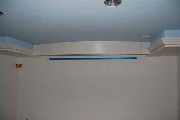

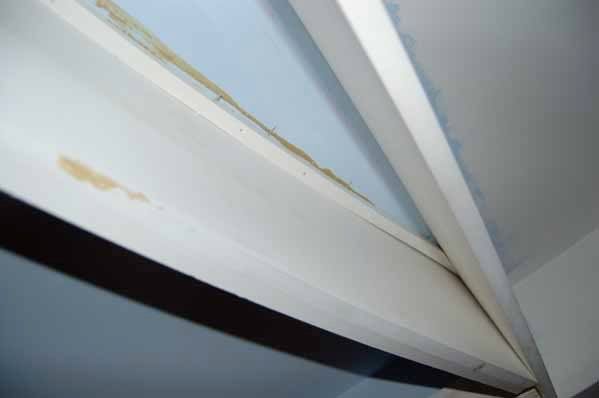

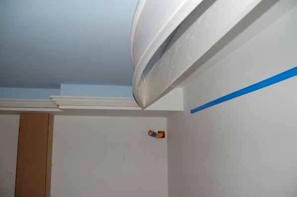

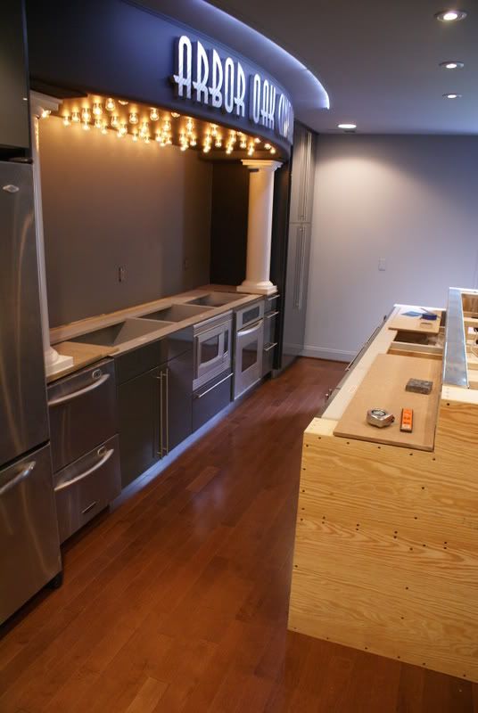

An alternative to Big's marquee approach, I asked my carpenters to build a curved marquee, and this is what they came up with (taken from my thread at post #179). Not sure if this is a good recomendation or not, as it wasn't DIY and my carpenters grumbled that it wasn't easy to do. Came out pretty nice though:
Here are a couple of under shots, under construction. The curved part is made of some kind of composite. Like vinyl. It feels plastic to the touch, is meant for outdoor work, and they tell me its paintable. I have some doubts, but worst case I'll remove the trim and wrap it in fabric. I had discussed keeping the portion of the soffit over the stage open, to allow it to be used for bass trapping, if needed. Anyways, some under pics showing the guts.
Another, closer:
A reader in my thread speculated on what the material was:
Originally Posted by jtnfoley View Post
The flexible exterior plastic trim is probably this stuff: http://www.komatrimboards.com/
I picked up a 1x12x18' of this from Taylor Lumber in Marshfield ($72) to play with the material and decide whether its' right for a few boat projects. (It is, IMHO, so I bought a 3/8x4x10 sheet of it for $120.)
Can be glued/screwed/cut/machined like wood, is available in several moulding profiles, and being PVC can be solvent welded with PVC/CPVC solvent from a plumbers supply.
Nice matte white by default... Hmmm..... DIY screen fodder? I'll have to check!
I can tell you from firsthand experience that this material has a fantastic affinity for latex based paint.
This is technically an engineering Foam, so cut edges are really porous and must be sealed and sanded prior to painting if the edge is going to be visible.

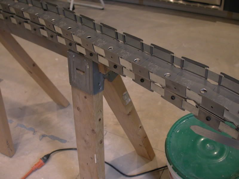

Here is another arch in the back of my room: Yet to be finished back end.
some constuction details

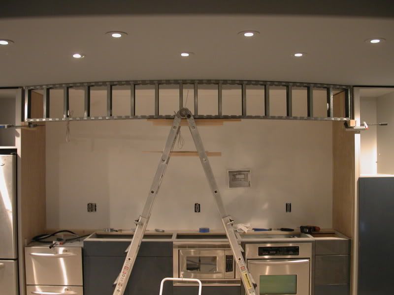

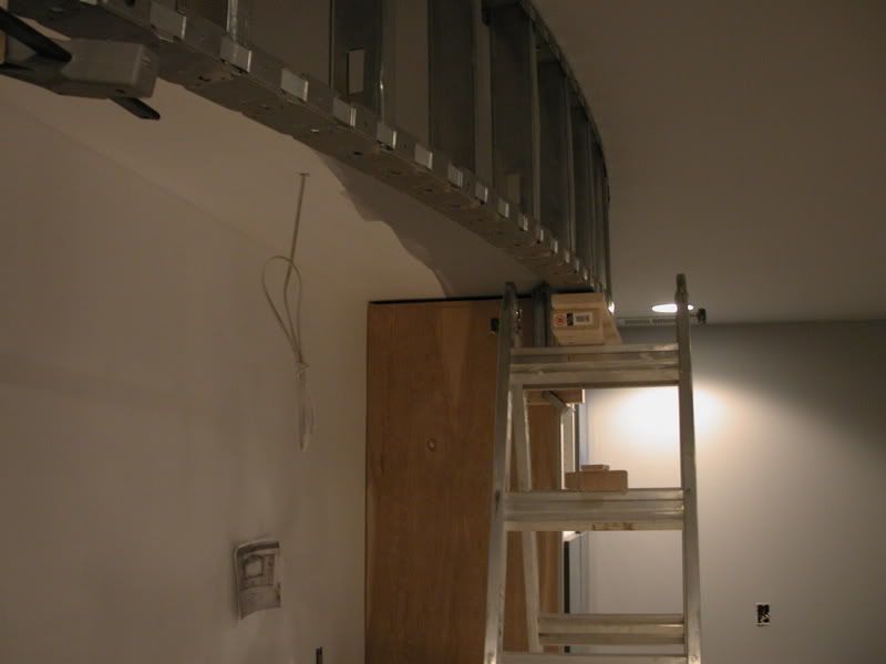

Using the Flex-trac to create a curved soffit. http://www.flexc.com/products.html?t...x4&mode=simple
