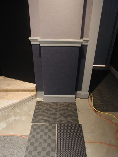

As I mentioned earlier, I hired out bpape to do the acoustical design for my room. I haven't implemented any of this design yet, but that is what I am in the process of figuring out how to do from an aesthetics point of view.
The chairs ended up being located more towards left of center of the room, as opposed to being offset to the right like show above.
Originally I just planned on doing the simple fabric framed panels hung like pictures on the wall. Bryan said that I can still use the above design even if I go w/ the all cloth (or mostly cloth) look, but just to leave some blank space behind the GOM.
I'll see if I can sketch something up for what I am currently thinking for the side wall look, but I am currently contemplating just going about 2/3rd the way up the wall covered w/ panels, and leave the drywall exposed above that, with maybe some wood trim breaking up the lines between the cloth and the drywall. Note, that the panels called for are 2" thick, so I don't know if that is going to be too big of a depth change going to the drywall, and maybe I should just bring the cloth all the way up to the soffit.

The side walls are currently a tan color, with the ceiling,front and back wall a darker tan color. The carpet is a mixture of black, brown and tan. We are thinking whatever wood we introduce into the HT room (columns and new trim) should be a close match to the wood in our bar (I think it is medium to dark cherry stain on maple, the pictures in the first post are pretty accurate for those colors).
So if we go with a black cloth for the screen wall, does anyone have any suggestions for the cloth on the side walls?
I was thinking a dark tan or brown or something like that. Also, if we end up going with the various shape panel design like above, I am likely going to have to pick out two colors. But in looking through the online GOM samples, I am having a rough go finding something "brown".
Any help/suggestions anyone has to offer would be much appreciated. I'd also like to get some other ideas or feedback for the panel/column layout design.

I'm still trying to figure out what to do with my side walls. Like I mentioned earlier, I am thinking about leaving some drywall exposed at the top of the wall, along w/ the soffits and ceilings.
But, if you take a look at the first picture in this thread, you may notice that there is more space between the right soffit and screen as there is between the left soffit and screen. The screen is centered in the room, but the soffits are different widths. I don't really know how much this bothers me, but it dawned on me that if I ended up covering everything but the ceiling in fabric, that I could make the soffits the same size. Any suggestions?
I don't know if I really want that much fabric, but it at least gives me more to noodle on.
I am in the process of ordering a bunch of GOM samples. Finding brown/tan GOM colors is a royal PITA.

Hey Aaron,,, here's my suggestions for your walls treatments/colors.
First off,,, IMO, too many different colors are distracting. The multiple colors will lessen the detail of the more elegant details that one's attention should be drawn to. (like the wood trim you may use on the columns)
First thing I would do is paint the side walls and soffit the same darker color of the rear wall/ceiling. I'm sure you don't want to hear that, but the two colors are a bit much when you add the beautiful woodwork + possibly two different colors of material on the side wall.
Next,,, paint the baseboards a darker color. (preferably matching one of the two material colors in the side wall) or better yet,,, remove them all together and run the panels and columns all the way to the carpet.
I like the design you came up with for the side walls. I think that the cherry maple with the material in the mid section within the columns is a wonderful idea. I would, however, use the wood sparingly and eliminate the wood trim area you have marked along the top of your mock-up drawing. (only use wood on the columns) Mixing several vertical lines, along with several horizontal lines can again become distracting and detail is lost.
I also like how you have broken up the area between the columns with the different sized and orientation of the panels. Here, however, I would lower the top most part of the sidewall panel to end at the same height as the material on the columns, match the column material color with the panel material, then, instead of mixing the orientation of the panels, (some short and vertical, some long and horizontal) I would only do one of the two. Example,, only do tall vertical OR long horizontal panels. Adding a more subtle detail, like beveled edges, on the single panel type can add a touch of elegance. This adds detail without distracting the eye from the greater picture,,, which is the overall design. Fewer individual panels with an edge detail is also less costly and easier to construct. (BONUS!)
Fabricmate and other companies manufacture simple to install track systems that are easy to create rectangular shapes with, then install the GOM onto with the OC in any configuration you like "underneath" the suspended GOM. This track system comes in a variety of edge profiles and sizes so you can easily add simple details like this. Lighting in the room will bring out the beveled edges for more detail if you so choose.
If you are going to go through the effort of building columns, I would definitely relocate your speakers inside of them, or build the column over the top of the current speaker location. Keep the sconce, or another lighting alternative that might be cool is to install small flush mount directional accent lights into the side of the columns, above the top-most portion of the panels, facing down at an angle from the side of each column, onto the fabric panels instead of the sconces. This accent light would add a very cool dimension to the beveled panel idea by creating shadows on the panel material.
Something like this.
I LOVE the carpet you chose for the room,,,, I would definitely pick one of the colors out of that carpet for the panel material color. (I prefer the dark gray color)
That's my .02,,, Love your room by the way. That bar is B-E-A-utiful!!!

Verrot, Thank You! This is exactly the sort of feedback that I have been hoping to get.
Actually, that is what I want to hear. I really like the front/back wall/ceiling color a lot. Since I am going to be covering the front wall, and most of the back wall anyway, I think painting the remainder of the sidewall that same color is an excellent idea.
I was originally thinking of removing the baseboards and replacing them with something stained the same as the columns. If just having the panels go all the way to the floor will work, then that will be something I will consider, and maybe get rid of the baseboards all together.
I need to noodle on this one. I don't think the column would look quite right going in the location where the side speakers are. I would also need to make the column a lot deeper than I would want if I were to put the speaker inside of it. I can't quite visualize how it would look surrounded by the column, but not hidden.
I hadn't thought about having accent lights shoot from the side of the column. That might be pretty cool. I really like the vertical panel layout you drew up. If my ceiling was higher, I might prefer the other way, but I think the vertical orientation will give the room a little more height.

Originally Posted by Lindahl View Post
I love the carpet too... where can I get it?
The carpet is made by Masland Carpets
The style is 'Rhythm'
It was one of the styles that BIGmouthinDC was looking at a while back. I really liked it, and then when we went to pick out carpets, our decorator explained to the carpet guy that we were looking for something 'fun,dark, etc etc', and it was the first sample that he pulled out. I said "That's it!", and we were done picking out carpet in the HT room.
As fair warning though, it is not cheap.
aaron_hinni is offline

Hey I remember that picture:
It actually looks much better in your theater then I could ever have imagined. WAF said go with the squares. After seeing yours I would have picked it as well.
My design consultation fee bill is in the mail!
Here is a grey version
Masland carpet isn't discounted a nickel in this area. The Sandman got a great deal in Florida but here it was $45 yd installed. OUCH!!!!
