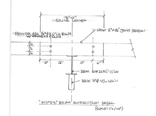

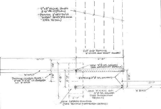

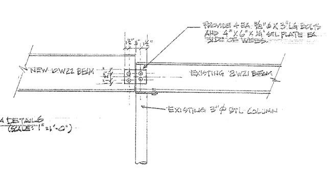

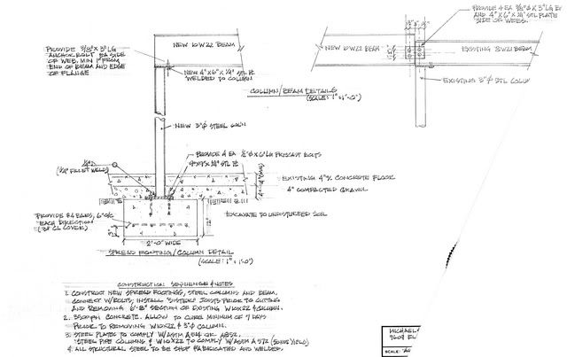

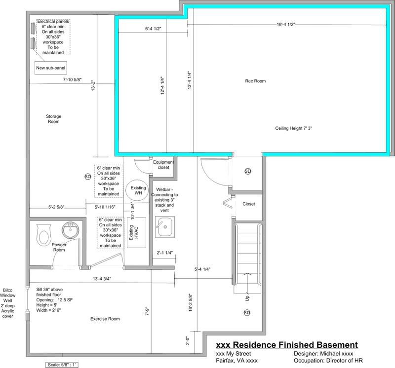

Got the plan drawing back from my engineer. First cost overrun - I was quoted that it would take around 3 hours of work, ended up with a bit over 7. We settled on a flat $550.
Anyway, here are some images of the plans.
This one shows the removal of the current beam and the addition of the new replacement beam.
Here we have the new beam extension. Nothing a little Elmer's glue and spit wouldn't hold togther.
Here are how the joists with be sistered so that I don't need to replace the current ones.
Any finally how the columns will have to be installed. Because the two new columns are so close together, the engineer want one large footing. It will be 4'8" long x 2' wide x 12" deep. Once the column is installed I have to add more gravel and then repour the slab. That's a heck of a lot of concrete!! But also likely where I can save money if I am willing to do it myself.
Looking online it seems I can rent a small concrete mixer for around $20 per day. Assuming I can get it into the basement, that should make the mixing part of the job pretty easy. I'll just need to rent it twice.
The metal work and column and beam installation I will likely farm out. Hopefully I'll find some help because it's a pretty small job.
Anyway, please let me know if you see anything on the plans that could be inproved. This is still all in draft form with the engineer.

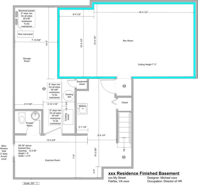

Usually the post down from a beam lands below the floor. When you pour the floor, the post is locked into place laterally. I don't know why the engineer has it so far below the slab, but you could certainly ask.
Submitting plans is sometime a bit of a guess. Some require full sets, some a sketch.. who knows.

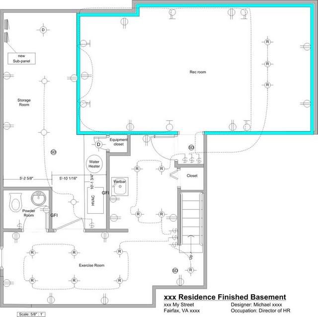

If any of your mechanical is existing, I would note that on the plans (eg "Existing mechanical to remain"). Otherwise they might think you are putting in a new hot water heater and hvac system.
Also, I would label the electric subpanel as "new xx space subpanel". I have never seen a 110v subpanel (first, because we have 120v power, and second they are 240v). Something like that could send up a flag.
I suspect they will require plumbing and electrical plans if you are adding fixtures. Vent and waste sizes, recepticles as required above countertops, GFCI in bathroom etc.
If your window is a required egress window, the window well has minimum dimensions as well.
Then again, they might just accept it and point out any problems during construction.

Mark - Yeah. I've read the documents a few times. They aren't particularly clear when it comes to simple versus the other route. I understand that simple won't work, but as for what's involved with the non-simple route I'm not entirely sure. Best I can tell is that I'm going to be shuffled from one department to the other. I do have the plans that the engineer created for the column/beam shifting part of the the project. For the window well I plan on bringing specs of the window well I plan to install. I'll create a seperate map of the lighting and outlet locations including GFI outlets. No clue how to document a wetbar. It's a sink for crying out loud and there is exisiting plumbing nearby to tap into.
Mr. Tim - I had the engineer change the plan on how the lally columns are attached to the floor. It's at slab level now so much easier to build and install. The sub-panel text has a typo. It should be 240v. Thanks for catching that.
Did I mention I hate this part of the process?
edit: Here's version 2.1 with the changes.

Okay. I'll change the name to rec room. Version 2.1 on it's way...

hehe yeah the permitting process can be a pita, depending on where you are, how good a day the clerk is having, what phase the moon is in..
You can't go wrong with pointing out the details that you know on the plan. If you demonstrate knowledge of the codes you are usually given some leeway around here.
I know the sink is just a sink, but some people don't even know that it has to be vented. Most codes allow studor vents now, so it's not as big a deal. I personally dislike them, but they have their place. You could put "connect wet sink to existing 3" stack in wall" or whatever your situation is.
Also, if you build a room around any fuel-fired appliances, you will have to provide fresh air intakes. If your water heater is electric and the hvac doesn'tuse oil/gas, you don't need them.
Good luck,

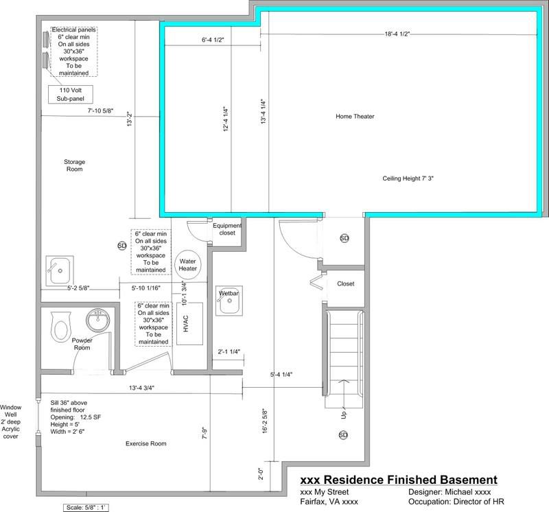

Version 2.2 of the construction plan and version 1.0 of the electrical:
And again, many, many thanks for the feedback. Having the little things caught now is way helpful.
edit: I should also mention that the electrical will change a bit. I don't have the rope or riser lights on the plan, nor the 20 amp outlets noted that will go into the closet.
edit x2: I fixed the name of the "rec room" in the electrical diagram. Not gonna bother updating the image file.

post #106 of 2687 Old 06-20-2007, 12:04 PM
dc_pilgrim's Avatar
Join Date: Oct 2004
Location: Houston
Posts: 4,604
Rec room is probably a better description for the tax assessor.
Any thought to adding a shower to that powder room?

post #107 of 2687 Old 06-20-2007, 12:26 PM - Thread Starter
Cathan's Avatar
Join Date: Mar 2006
Posts: 4,204
Yes, we've gone back and forth on the issue. What you can't see on the plan is that the washer and dryer will be on the wall behind the powder room. If I push that wall back it really would eat into the space you need to access the back part of the storage room. And if we bump out the wall in the "excercise room" it will get pretty narrow.
In the end we figured that we'll have two full baths and 2 half baths in a house with just two people. We won't use the basement shower and our two guest rooms upstairs have a full bath of their own.
Also, it mean less hassle for me not having to build one and therefore the theater will get done sooner.

post #108 of 2687 Old 06-20-2007, 12:26 PM
drin's Avatar
Posts: 527
Rec. room is a much easier description to get past the inspectors than home theater. I put home theater on my initial plans and they told me to change it before submitting.
Also as mentioned above, if your hot water/furnace are gas fired you'll have to provide adequate ventilation. They'll probably ask you to calculate the total volume of air required to provide full combustion for those appliances and put the number on the plans, along with the volume of air in the room surrounding the appliances. I suspect you'll find that the air volume in the furnace room (once the theater walls are up and finished) won't be enough to provide combustion, which means you'll either have to provide outside ventilation for the units or make enough volume available in the basement.
I ended up changing the furnace room door and the door at the top of the basement stairs to fully louvered doors. The air is now pulled in from upstairs into the furnace room. It was MUCH cheaper than coring through the concrete sill to install an outside duct.
-drin

post #109 of 2687 Old 06-20-2007, 12:30 PM - Thread Starter
Cathan's Avatar
Join Date: Mar 2006
Posts: 4,204
Drin - funny you should mention it, I was literally just calculating air volume based on something Tim sent me. I have roughly 1,400 cublic feet of space in the storage area. That would allow for 28,000 BTUs (50 cubic feet per 1,000 BTU) for both my WH and furnace. I'm at work so can't check what they actually are rated for so no clue if it's enough.
Cathan is offline
post #110 of 2687 Old 06-20-2007, 12:32 PM
drin's Avatar
Posts: 527
That's the standard required air volume that I usually see used. 28,000 BTU sounds low for a furnace and hot water heater, however. That will of course depend on what part of the country you're in.
-drin
Resident curmudgeon
drin is offline
post #111 of 2687 Old 06-20-2007, 12:36 PM - Thread Starter
Cathan's Avatar
Join Date: Mar 2006
Posts: 4,204
Either way, I'll add the info to the plans and will ask if louve doors are allowed. If not, I'll draw in two vents going into the excercise room. I think it's 1,000 BTU per square inch of vent opening.
Cathan is offline
post #112 of 2687 Old 06-20-2007, 02:16 PM
BritInVA's Avatar
Join Date: Mar 2006
Location: Ashburn, VA
Posts: 3,797
Michael,
My Furnice is 100,000 BTU which seems pretty standard for most 4/5 bed houses in this area. According to Combustion Air Calculator it needs 6667 cu ft of Indoor Volume.
This is what I failed on. My unfinished space & Rec Room only accounted for ~5,200 cu ft so I had to add more vents to the stairwell to 1st floor which was a PITA as now get more furnice noise on 1st floor.
Good Luck
Mark
BritInVA is offline
post #113 of 2687 Old 06-20-2007, 04:22 PM - Thread Starter
Cathan's Avatar
Join Date: Mar 2006
Posts: 4,204
Seems my water heater is 40k BTU, but I can't find anything on the furnace (Trance XE90). TRane's website turns up nothing and Googleling it seems to give me a range 40k-100k.
If I assume the whole think is around 100k, no way in heck I have enough airflow. I'd be surprise in my unfinished basement did. Looks like I'll have to figure out a venting system.
Cathan is offline
post #114 of 2687 Old 06-20-2007, 06:17 PM
BritInVA's Avatar
Join Date: Mar 2006
Posts: 3,797
My furnice has a label under the main panel that has input BTU 100,000 and Output BTU 80,000 (does not seem too efficient).
I found this site that has specifications for the Trane XE90 - but looks like there are numerous models.
Cheers,
Mark
BritInVA is offline
post #115 of 2687 Old 06-21-2007, 02:57 AM
drin's Avatar
Posts: 527
That was my finding as well in my basement. I'm surprised we weren't gassed in our sleep from incomplete combustion gases!
The two options that were available to me were:
