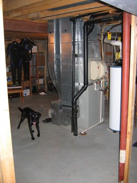

Currently we have a completely naked basement. It holds some stuff and contains our workout gear and laundry machine, but otherwise it's pretty empty.

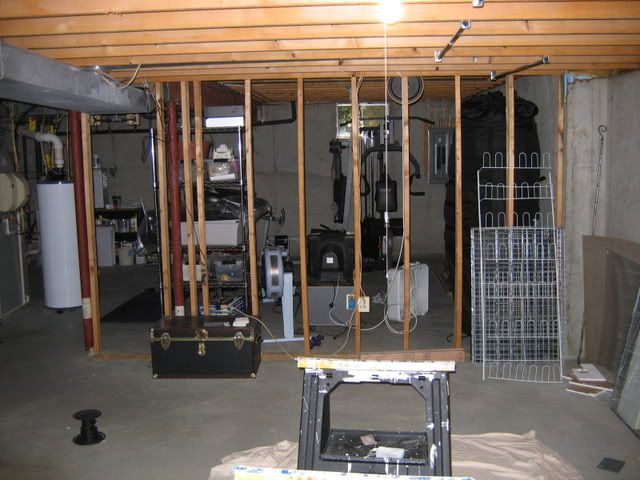

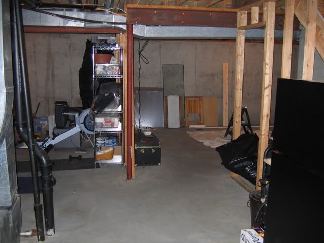

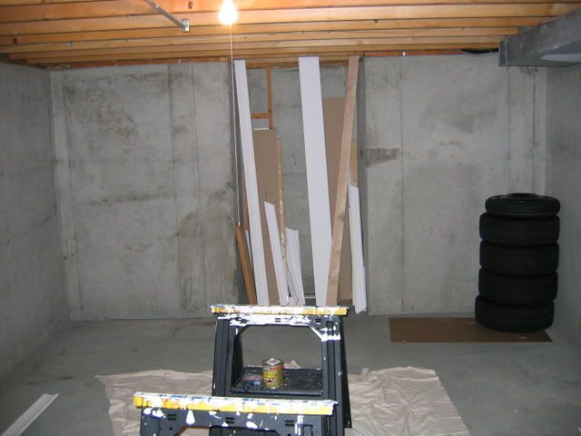

Here are some photos of what I have to work with.
The lobby space:
The theater back wall:
The view looking towards the front:
The view looking into the lobby:
View of a stupid pole and beam:

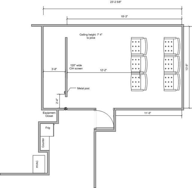

As you can see it's not bad space. Basically I'm thinking a layout that looks something like this:
You'll have to excuse my noob Visio skills and the spelling error. I've only just started playing with the software and I really am a crappy speller.
If you look closely at the design I'm just not sure what to do with that second pole that is in the current false wall. I'm hoping to perhaps integrate it into the screen wall. The space that is available behind the screen wall is basically limitless. I am however hoping to perhaps build a beast of subwoofer similar to what ebr has done. clickie
Also, the measurements are concrete to concrete, so not the final interior room dimensions.

I gotta ask, can you move that pole?

dc-pilgrim - Whether I can move that pole is a fair question. I just don't know the answer. That beam runs from the pole to the back wall. And the ceiling joists rest on the beam and are cut to length. I imagine moving the pole to increase room width of the room would be cost prohibative. However moving the pole a few feet along the beam to create more depth could be a posibility if I really needed the space. The question is what would that get me? Any thoughts?

I like your ideas. One question though - is there a reason you're not putting the screen wall on the opposite end? You could work the pole into a wall along the riser (i.e., rear seats sit in an "alcove"). Then you could make your equipment closet in between the two poles and behind the front seats and roughly inline with the front of the rear seats. You could also put your PJ in the back wall and keep any fan noise out of the theater. Not sure if that makes sense. If you fire me your Visio file I could probably show you what I mean.

If you do what Brew is suggesting, you would be able to get the back row a few feet off the wall, which will make those seats sound a little better. You would probably have to shift the back row out of center, but that would likely not be that big of a deal.
You may want to consider shifting the rows to the far wall even if you keep the set up as is. Currently without walls your room is 165" wide. Subtract a minimum of 11 inches for the walls (if 2x4 construction and 2 layers of 1/2" drywall and 1" air gap---even more if staggard studs and 5/8 drywall x2). If you are doing a typical recliner seating, 3 seats is usually about 105", which leaves walkways of about 24" on either side. If you are going to have columns, they will likely encroach on the walkway even more. Just some food for thought while in the planning stages.

Strange/Gonzo - Flipping the room is something I have throught about, a lot. If there was a way I could move that pole six feet or so back along the beam it would give me the "ideal" space for what I want. HVAC, projector location would also be a plus. And I'd get a few more inches of ceiling height over the second row riser.
Anyone know how feasable it is to move a pole so that it's not sitting at the end of a ceiling beam? I would even care it it resulted in having to add a second pole somewhere further down the span.

Michael, check out the beginning part of my HT thread. I detailed how I moved 2 poles in my basement. It can be done, and its not too bad on the wallet. I did it for about C$1800. If you want more details, let me know.
I really think you should flip the design if you can. Don't let the support pole hold you back. There's enough expertise here to help you through it.

From what I see in the photos, the lally column supports a steel beam from its end. I don't see why you wouldn't be able to move it 30" down the beam, so the beam cantilevers into the theater room. Might need a larger column. And a footing for it below the frost line. And a structural engineer.
Flipping the room, though, sounds like an easier plan.

Moving that pole really is what I'd like to do. It just makes sense. I'll draw up a rough plan of a flipped design and post it ater this week
Anyone know what hiring a structural engineer costs? Any referrals for the NoVA area?

Michael, the engineer cost me $800. That was for "sealed" drawings that were good enough for our municipality to issue a building permit for. From my experience, there are a bunch of these structural engineers who do this stuff all the time. Do you have the original blueprints of your house? That will make their job a whole lot easier and may save you some money.

dc-pilgrim - Whether I can move that pole is a fair question. I just don't know the answer. . . . However moving the pole a few feet along the beam to create more depth could be a posibility if I really needed the space. The question is what would that get me? Any thoughts?
Hope you weren't expecting me to answer the tough questions. - I was just thinking 3'8" is a lot of space behind the screen. I can see maybe 30" or so depending on treatments and speakers (and comb filtering). I have 18" allocated to mine, but my room is only 17' long.
Given NOVA, (I used to live there) an engineer is probably double what the midwest guys would pay.

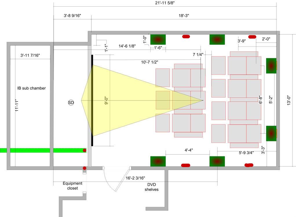

If I were to keep the design as posted, the wall behind the screen wall is completely variable. I just through down a random depth. I will be building a massive sub (think 100+ sq foot enclosure) behind the screen so will need a bit more space than the typical screen wall.

Michael,
I did the post removal thing. It cost about $500-600 for the engineer and about $500 labor and materials. So I bet you would be in the $1000-2500 range in NoVA.
Gonzo

Thanks. I just hate the premium costs we have to pay in this area. Just another reason to be self-sufficient and go the DIY route. I have some down time later today, so plan on calling a few local engineer firms.
