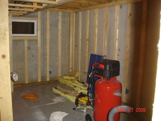

longwa,

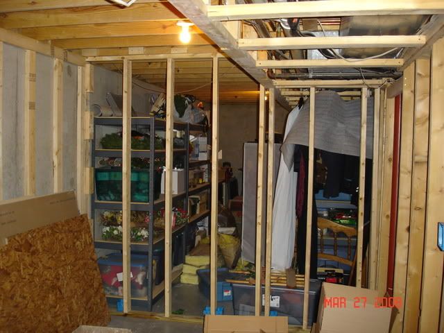

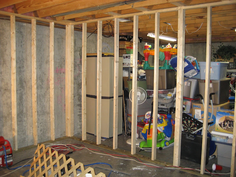

I told you our builds/messes are very similar see lookie here.
The area behind the framing will remain unfinished and will be storage. Now it is where all of my overflow gets stashed. The wall will eventually be the kitchenette area. I just got a mock up of the first rendering of the kitchenette from my kitchen/cabinet designer. Looks good but I am going to have him make some adjustments. I was going to link it here but alas it won't let me.
Here is another shot of some framing and misc items that I am constantly shuffling/working around.
The rest of my build/basement is too disorganized/messy now that I do not feel as though in good conscience I could show any more photos at this time.
I was able to get the two cans associated with the stairway mounted as well as the stair lights. I was also able to get the cans in the kids area mounted and I got the locations of the cans in the theater area worked out so now all I have to do is mount them tomorrow. Still much to do before my electrician shows up Saturday.

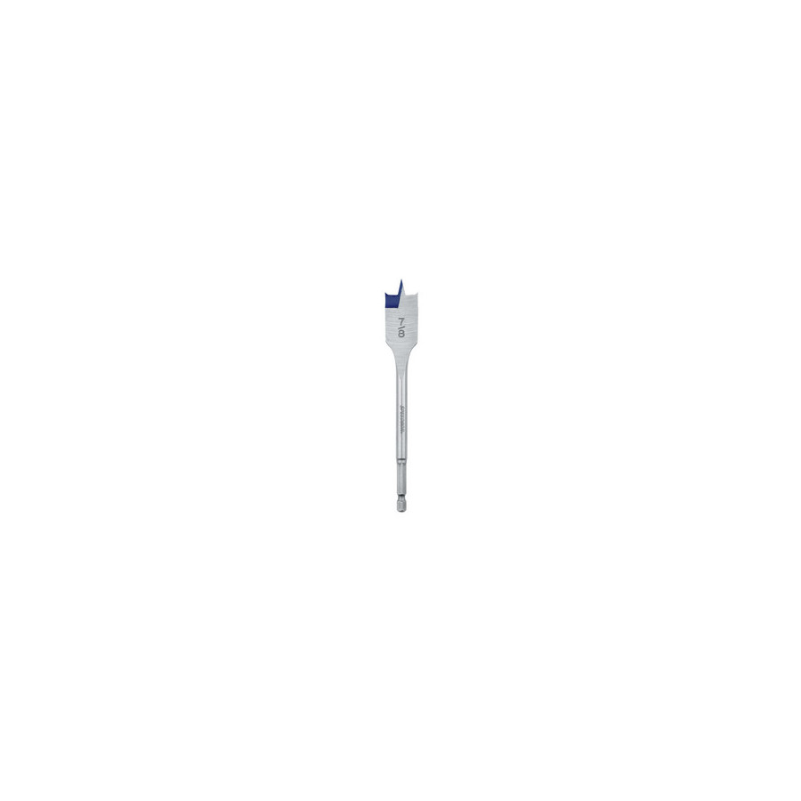

I normally use this type of bit to bore larger size holes is 2x4's etc.
My electrician suggested this type of bit and I must say it is much nicer to use than the typical "spade" type bit.
Faster but most importantly smoother ie. easier on the wrist and more precise.
Yeah, I have those same bits and occasionally it will get stuck and practically tear the drill out of my hand. I had forgotten how much more powerful a 6A corded drill is vs. my 18 volt cordless drill.

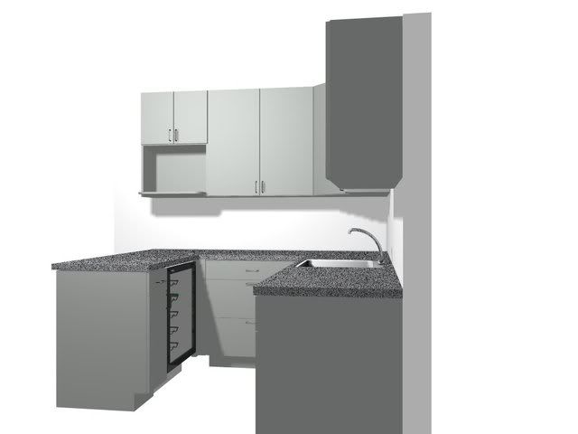

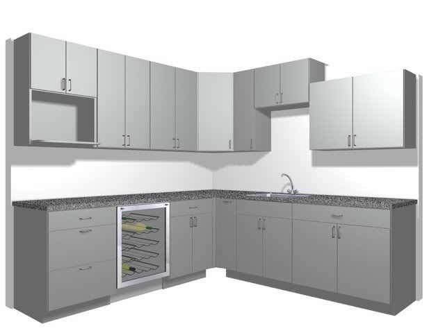

I am still working on the kitchenette design with my kitchen designer and have had a second mock up presented and we are getting closer to what I really want for the basement.

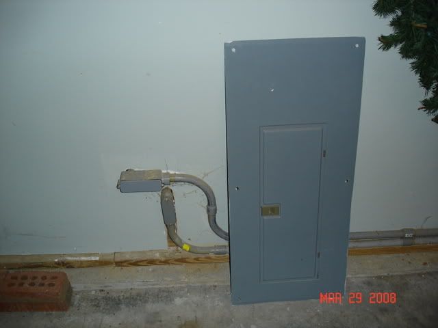

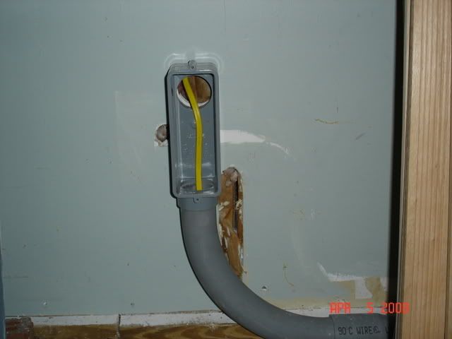

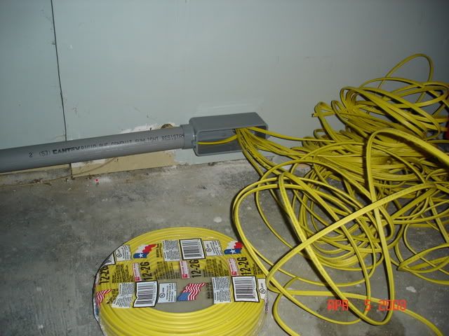

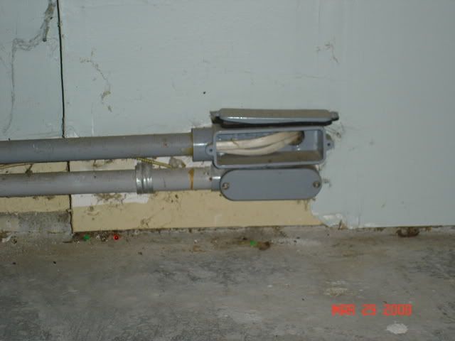

Well I have now passed the 1000 ft mark on romex at 65 bucks for 250 ft. which comes out about 26 cents a foot. I am not sure if I will get it all done with 1250 ft or not but I can say I did not anticipate having to use so much romex.
Here are a few pics of my electrical so far.
The old......
and the new.......
I think I can get it all done with 11 circuits which is 3 more than I and the electrician originally worked out.
I changed out 2 separate 1/2" conduits for one 2" conduit. I had to tear into the drywall so we could fish the wires from the conduit into the electrical box. Obviously the mess of wires you see is what runs into the basement and has not been fished through the conduit into the electrical box.

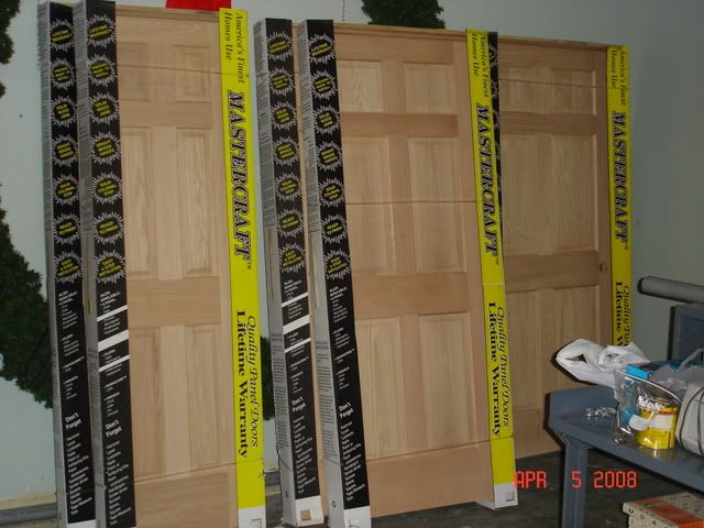

My wife an I also picked out some doors that were on sale this past week for the HT. We decided to go with Oak 6 panel doors. Here they sit ready to find a home in the basement.......
but it will be awhile before they make the trip downstairs to their final home.

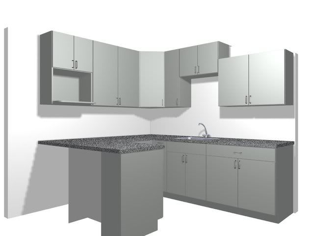

I have been working with and e-mailing my kitchen designer on what I want for the kitchenette area. After many e-mails and ideas/concepts I have narrowed it down to these two final designs. More than likely I will select one of these designs for the kitchenette area. I was able to get the image to load to photobucket so now I can share here.
Behind Door Number One. Candidate number 1.
Behind Door Number Two. Candidate number 2.
Another view.
I'm leaning towards number 2 because I want a snack bar and the design is more compact and does not intrude into the workout area and where I may in the future add a popcorn machine.
Give me your opinions, suggestions, and ideas.

Oh and no one has commented on my kitchenette design? Come on guys and gals I need input!

The kitchenette is simply divine. It made makes me laugh ... and cry...
Dude! It's a kitchenette. Looks a okay by me.
Cathan, thanks and using a term like divine.......well you may have been watching too much HGTV!
Actually since this is the other feature besides the HT that my wife really gets excited about it is key to keeping her motivated about the project.
Anyone else besides Cathan want to chime in about the "divine" kitchenette?
I was actually looking for adjectives or comments such as That Rocks!....or.....Cool, should look sweet in the basement......or Dude why are you worried about a kitchenette in the basement as long as there is a fridge with beer in it your set!
Hearing that my kitchenette is "divine" is kind of like your wife/girlfriend telling you that your new suit, sweater, NFL jersey, tool belt etc. looks "cute" on you.
Thanks anyway Cathan!

Really I just wanted you to know that I'm reading along and following your work, even if I don't comment after every post.
But seriously, my thoughts are best captured by your own words -- "Dude why are you worried about a kitchenette in the basement as long as there is a fridge with beer in it your set!"

Number 2 would look REALLY cute in your little theater thingy. Fess up...isn't that what your wife REALLY calls it? Your "theater thingy?"
You'll probably find number 2 much more user friendly with the U-shape than number 1 with the L-shape.

another vote for #2.
The designs allows for an excuse for squeezing by the ladies

#1. i like being able to walk right up to it instead of around and into it. later.
My little basement (about 600sf) used over 750' of Romex. I added 7 new circuits and rewired one exisiting. It adds up fast.

Another vote for #2

I like #2 as well. Just be sure you leave enough room between the two sides.
