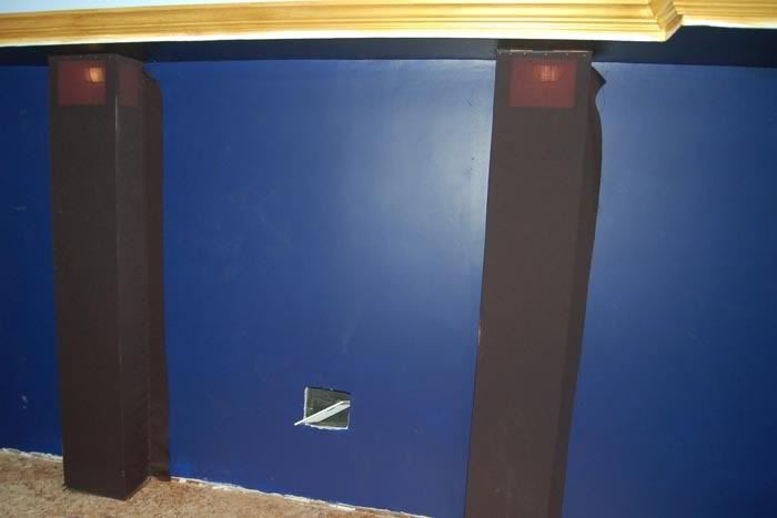

The columns are going to be covered in black velvet and I plan on painting the speaker grills and frames flat black

I know what your saying but I am going to cover one and see how it looks. I saw another members columns and really liked the look. I would show you some photo's but the avs members pictures are all down. I plan to trim the sides out in oak so they will almost look like large speakers. As anything with this build I have been designing it on the fly
Now you put doubt into my design

We just wrapped ours in black janus. Ours were on-wall, which may have made things more challenging. But my wife did comment that she was glad we went with the janus over the expo since we had a bit of a tough time keeping things taught, and if the fabric was directional it would have been that much harder.
I'd go with something like dcpilgrim if you are going that route--something like black GOM(I have Anchorage Onyx, which I liked much better fabric-wise than the standard GOM--is that 701?). The oak trim would make for a nice look with black fabric. Have you gotten any black velvet yet? You might agree with me after you get some in your hands.

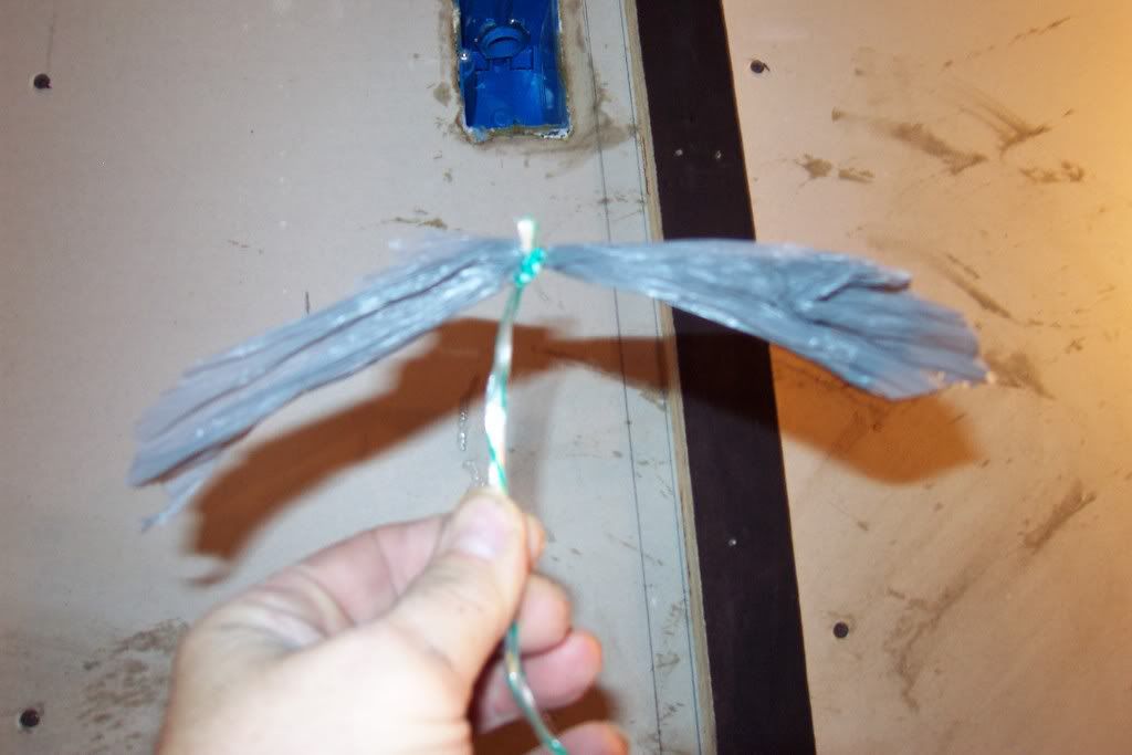

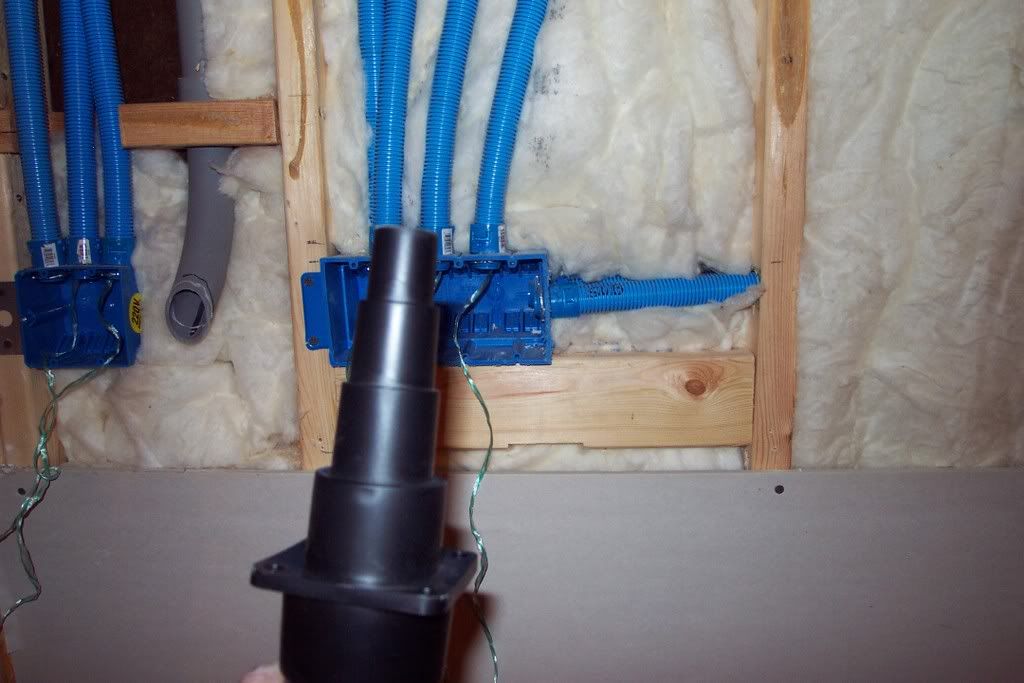

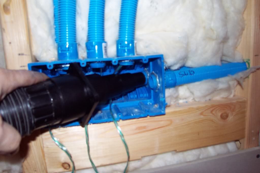

Hello All

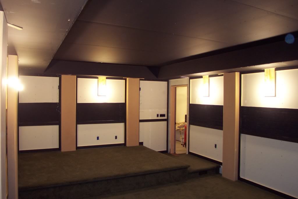

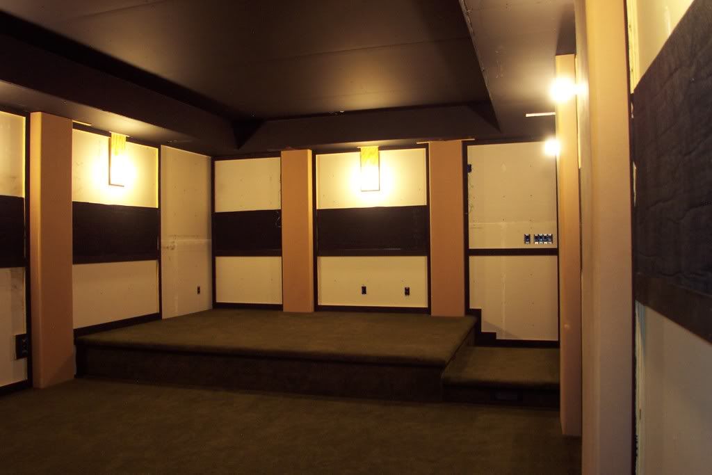

Well I took the day off today but thought I would post my progress from the last 2 days. I finished all the furring strips except a few plug outlets and started putting some of the linacoustic up. I used spray adhesive to attach it to the walls and that seemed to work real well. will finish the rest tomorrow.
I also pulled the string into my smurf pipe for speaker cable and sub cords. I used the shop Vac to pull the string with ease on the end is a piece of plastic bag from one of the many trips to lowes
I found that rubber tip at Lowe's it really concentrates the suction

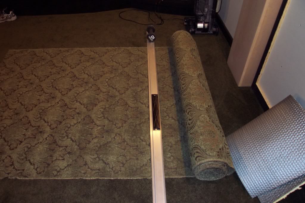

Hello All

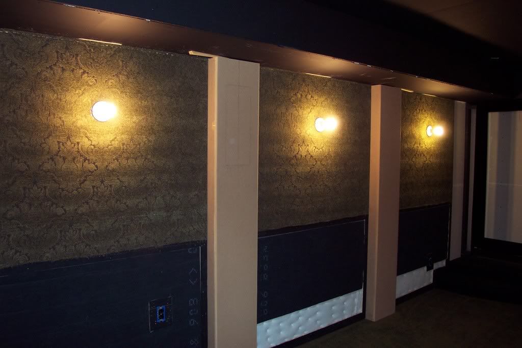

Today was a big day I got some of my green fabric up on the wall
As I have been flying by the seat of my pants with this build and the design changes weekly I have decided to cover my columns in cherry or oak veneer. I'm thinking if I covered them in black fabric that would be just too much black.
My green fabric has a design alot like wall paper so I treated it as such when lining it up. I was getting in a groove when hanging it and think I should have the rest up by tomorrow afternoon. I tried hanging some of the exposure but found it to be too stretchy and with the slight pattern that it has just didn't want to even try to make it line up. I ordered some fabric with little to no stretch and no pattern. I hope to get it by the end of next week.
The wife and I still can't believe how well this fabric goes with the carpet
Here are a few pics

very nice choice. keep it going!!

The fabric looks great!

Great fabric! It's going to look amazing when the sconces go in over that.

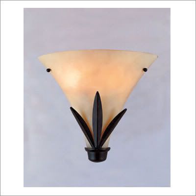

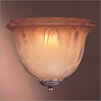

Here are the sconces we picked. I ordered 2 of each. we liked them both so we are going to choose from the 2 which one will go the best in the theater and then we will put the other in the hall outside the HT. So when we figure it out I will order the other 3 needed

Scott, you're so close! I like the top one better.

Things are really looking good, I like the fabric lots. I can see where those Jamo's go... Keep it up!
I like the first sconce better.

+1 on the first sconce!
