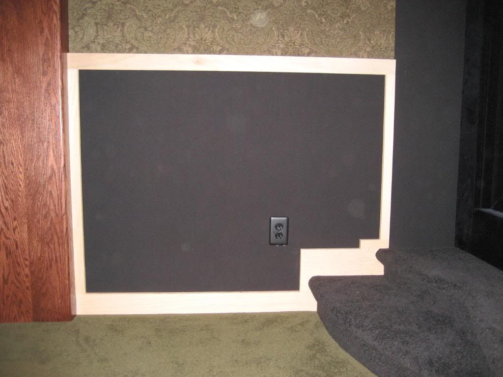

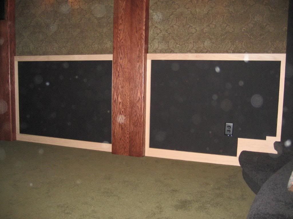

I have to many dang projects going on plus I have my own lawn bussines and the grass is about to start popping so I will be working everyday for the next 9 months
I need to go TRIM crazy. I'm going to post some pics tomorrow of some trim installed

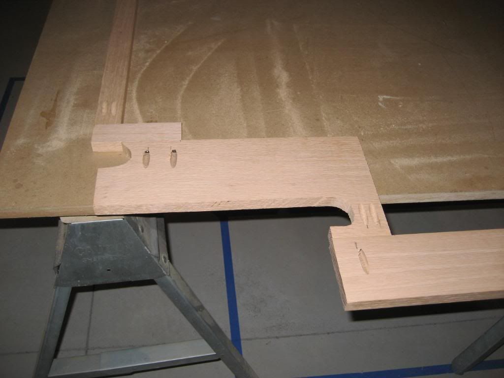

I figured you got a new toy...I saw all of the pocket screw holes on the bottom of the table you built!

I will say the kreg pocket hole jig is a beautiful thing
This is one purchase I made from a late night (2:00 am, couldn't sleep) info-mercial. I kept watching the demos, going, "This is great! What's wrong with this picture?" But I finally decided to buy one. I've got projects lined up, but no time. I'm glad I did. It seems to be a very popular tool.

erkq
I have not used a drop of glue the joints are so tight theres no need for it I decided to build my frames similar to strange_brew's frames (aka Craig) he used biscuits http://www.avsforum.com/avs-vb/showt...0#post10751030
I got 3 others done and have 4 more to build then sand and finish

That jig looks really cool, next time I am over please show me how that works.

I have not used a drop of glue on these the joints are so tight I decided to build my frames similar to strange_brew's frames (aka Craig) he used biscuits
Wow... thanks for the pics. That's exactly what I want to do with the Kreg. That, and cabinets for media and equipment.

Chris
Its really a pretty simple tool to use. Here is the kit I have http://www.kregtool.com/products/vid...egjigk3MS.html
That is awesome. I'm going to use that pic to show my GC because we're going to have some problems with my thick base trim and rounding out by the stage and riser. Thanks for the pics!

Queendvd
I used some cardboard to make a template. Then cut some scrap wood till I had it where I wanted it then I cut the oak. I still ended up doing it a couple times till I got it right. I will get a few more close up pics once I have them all stained up and installed for good.

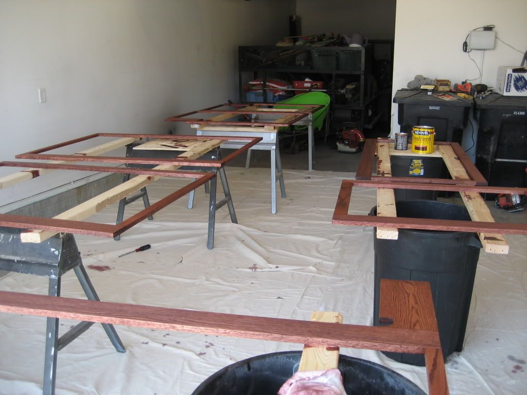

Its a miracle I got almost all of my lower trim pieces sanded and stained today. Clear coat next

What color is that? It looks like the same color I used. (Varathane-Early American) Looks nice
