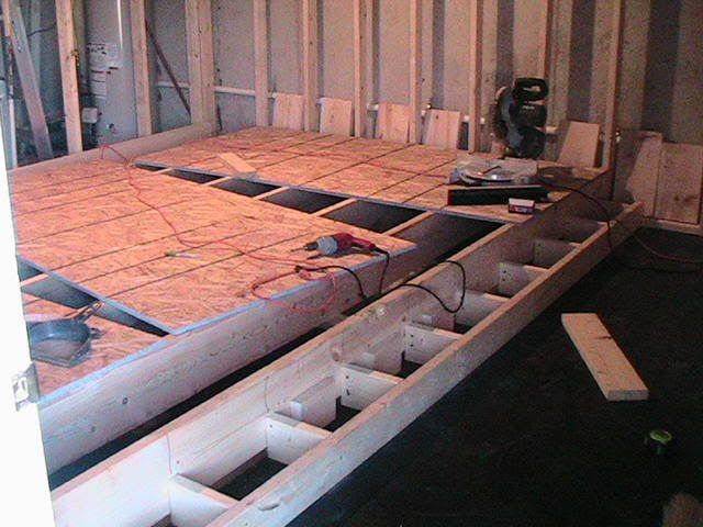

My SMX frame will be touching the bottom of the soffet as it is. We will see where it comes out. My frame is 151 x 68 and screen wall is 165 x 89 to the bottom of my soffet and I want to be about 24" off the floor to the bottom of the screen. I have a little wiggle room but not much.
I got 50 bags of sand down in the HT the one side I got done took 27 bags I carried those down one at a time that was way to much work so I got a little more creative cuz my back was not liking that. I used my mower to wheel it to the basment window slide them down a ramp and then wheeled them into the HT with my drywall cart. I should have done that with all of them
I should have the stage finished tonight and then on to the riser.

Well I finally finished the stage. It took 60 bags of sand to fill it all I need to do now is put GG in between the 2 layers of OSB and screw it all down. Next is the riser I am also going to order my linacoustic this week.

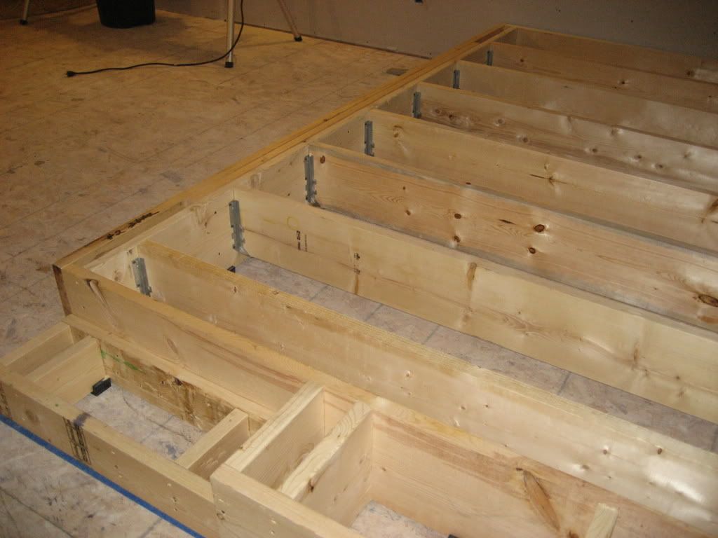

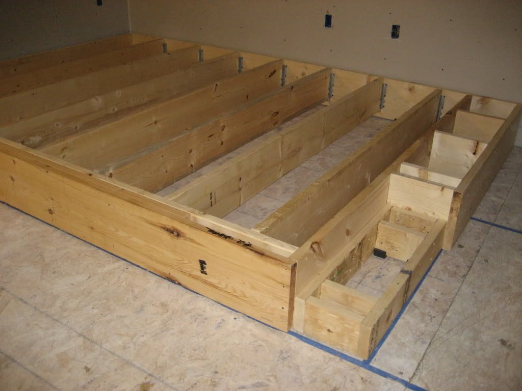

Well I got rained out at work today so I spent most of the day working on the framing for my riser Here is where I'm at. Riser dimensions are 7'7" x 11' and It will end up being close to 13" tall once I put 2 layers of decking on.
I decided I wanted to get my riser up off the floor on to some rubber Stud Beam Isolators. I also used 2x10's with joist hangers hoping I will get a good tactical effect from having the deck suspended. Tomorrow I plan on picking up the decking & insulation. I also need to order my step lights and thats going to hold me up

I agree with your idea to get as much of the deck suspended up off the floor as possible. When I build a theater, I will be doing the same.
The subwoofer in my living room transfers enough vibration into the floor that you can actually "feel" the bass. It definately adds to the experience. It makes me grin ear to ear every time. Of course it helps that I have a vertically mounted driver sitting right behind my TV. link
I really hope you get the same effect!

I'm not 100% sure it matters whether the sub is upfiring or downfiring....but what I read is critical, is the ports be terminating in the listening area. After doing sound demoing with my setup over the past week or 2....you can hear the difference. It's really cool hearing the frequency changes that low....never heard anything like it !
Wolly....anyway to have those little feet only in the corners, not every 2' ?
That way you'll have more "span" to vibrate the booms...the more fixed supports you have, the less movement.

I could take some out and see how much it flexes when you stand on it

Because of the way risers are built, the only thing that will add to the springiness of the floor surface is to remove the rubber feet from the taller end boards that your hangers are attached too. You can have as many supports as you need on the to sides boards parallel to the joists and it won't reduce the springiness at all.
I would put several on the side boards near the corners and a few along the middle. Place as many as you need under and around the step to provide solid support there.
One other suggestion. Since you are essentially carrying all of the weight of the floor out to the corners, I would put some additional metal angles in the corners where the front and rear boards connect to the side boards. Something like this http://www.framingconnectors.com/product/3
Once you think you have something that looks good....start jumping. If you and one or two other people can jump on it and it doesn't feel like it's going to break, then I'd say it's good to go. If it doesn't feel strong enough, start by adding just one support in the middle of the front and rear board and so on from there.

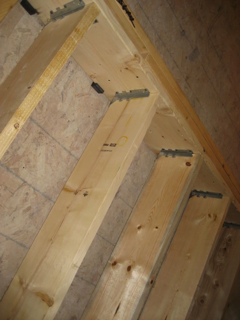

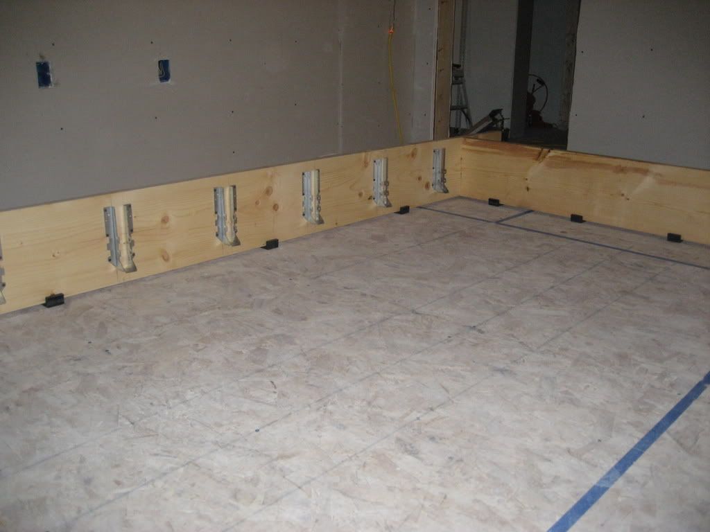

I would suggest....you've got the "ledgerboard" fixed on the wall....I'd fix the opposite end to the floor with the little feet, and the rest 100% floating or spanning that distance. You've got some serious framing there....you won't have a problem.
More span = more BOOM....I'm spanning 14.5' with 2x10's.
