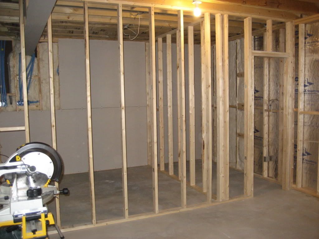

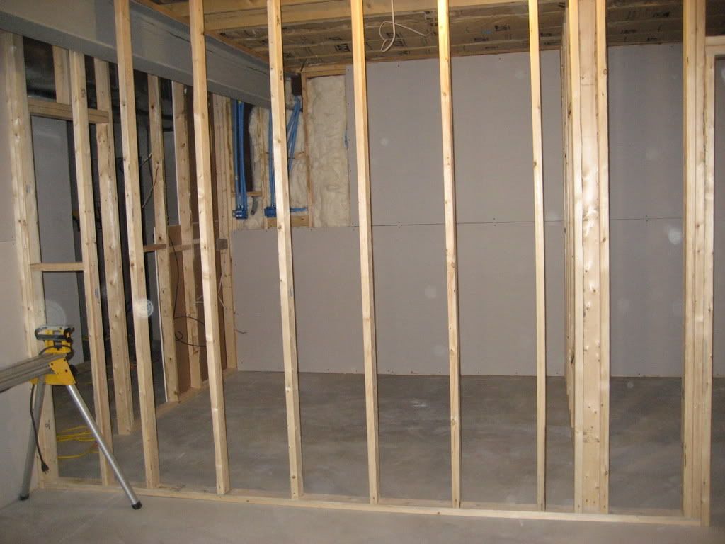

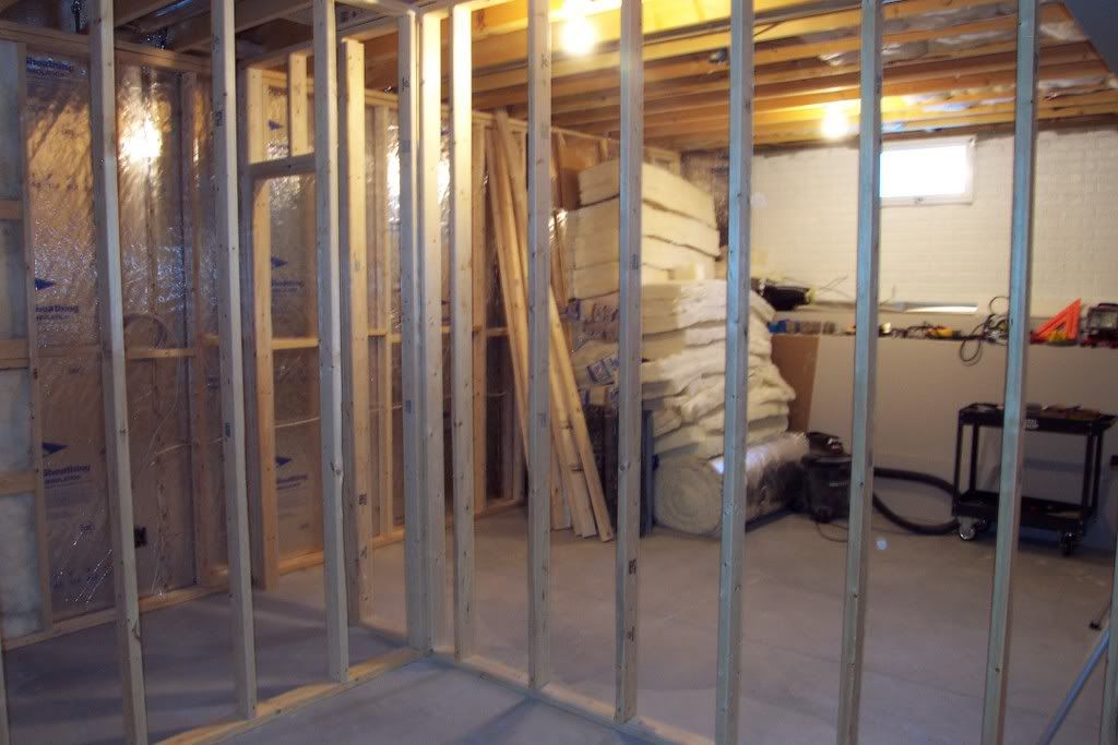

Evening All
Well I finished up framing the equipment room and the new closet for the bedroom today. Tomorrow I'll finish up re running my electrical wiring and start hanging some drywall back up I think this layout works alot better then the way I had it set up the first time. Now to decided if I just want to build my own rack or buy a middle Atlantic rack.
component room roughly 9x10
Closet is roughly 4x9
Looking out into the 14x14 bedroom
In the spring I will need to cut into the foundation and install two large Egress windows one for each bedroom. I mite hire some pro's to come out and do that
Scott

Scott, not using pressure treated lumber for the bottom plates?
Cathan is offline
post #195 of 1239 Old 12-14-2007, 09:59 AM - Thread Starter
W00lly's Avatar
Location: NEBRASKA
Posts: 2,424
Mentioned: 10 Post(s)
Quoted: 44 Post(s)
Liked: 70
Nope. I should have but did not.

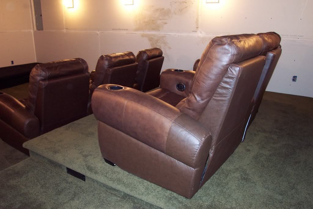

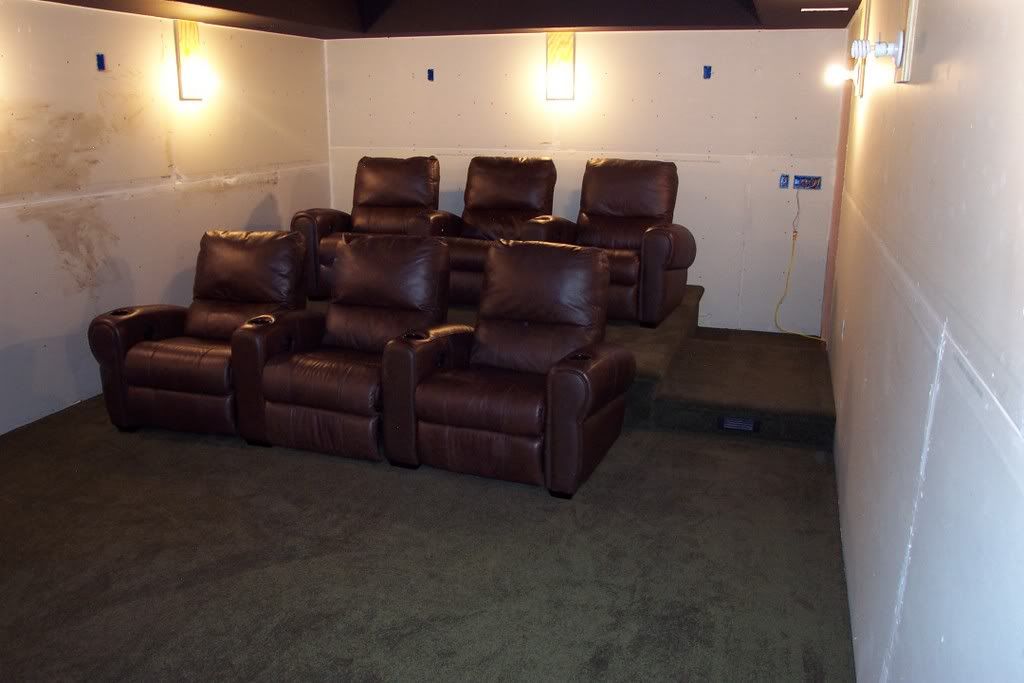

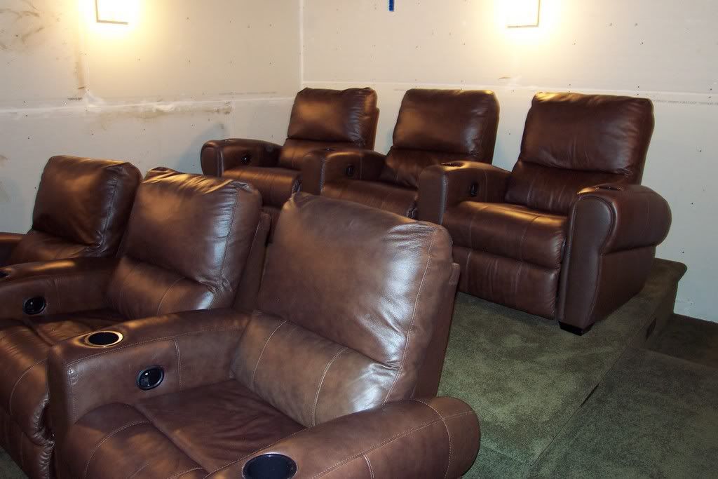

post #200 of 1239 Old 12-14-2007, 09:54 PM - Thread Starter
W00lly's Avatar
Location: NEBRASKA
Posts: 2,424
Quoted: 44 Post(s)
Liked: 70

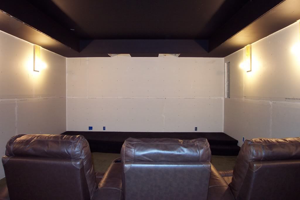

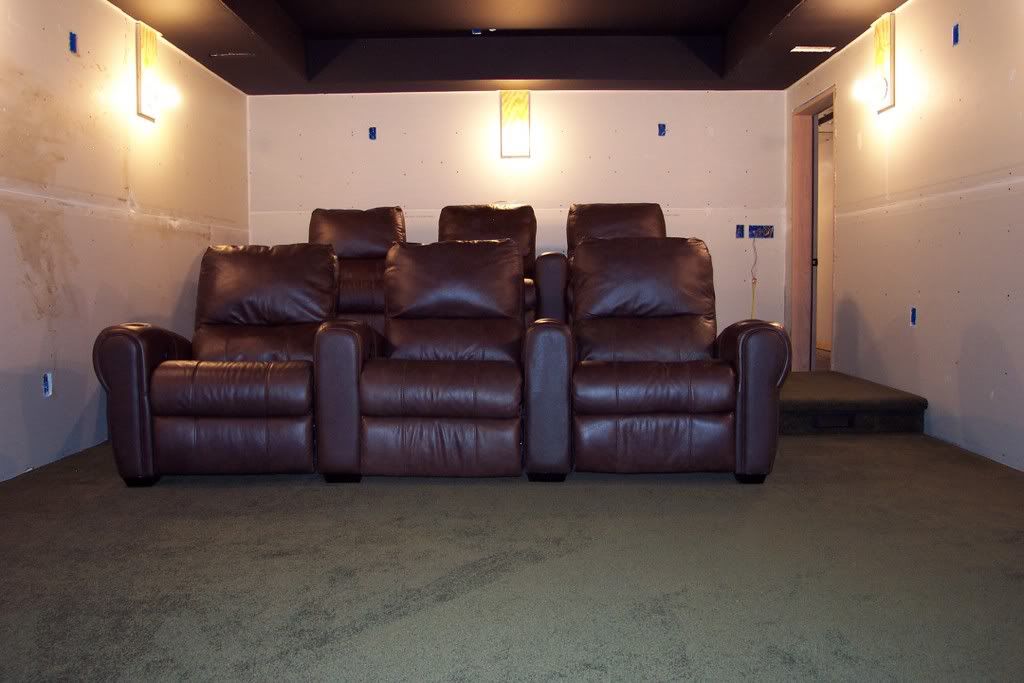

Here you go Calvin
here are my $1100 set of chairs man that was a steal. I love finding awesome deals when you have the cash laying around
Now to get started on my wall treatments also I painted the ceiling black for the mean time as later on down the road I will be doing a star ceiling
Scott
The CopperFields Cinema
          Current Photo's
W00lly is offline

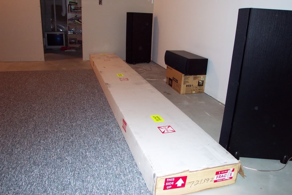

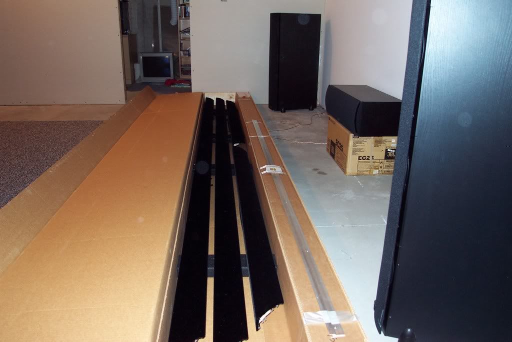

Screen wall next
Can't wait to put my SmX 12' 2.35:1 screen together. I have had it for over 3 months now and I have been itching to take it out of the box
Scott

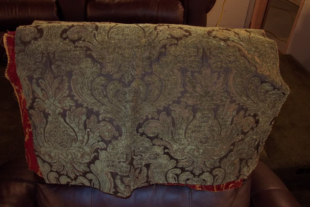

Well I spent about 2 hours in a fabric store today that supply's upholstery and drapery fabric. When I walked into this store I could not believe how many fabrics they had - thousands. Needless to say many were way out of my price range starting at $20 a yard on up I brought a few home and the wife and I chose this one
Scott

Looks Nice
Check out the drape section at JC Penny. You might be able to find a similar pattern at a cheaper price (if you don't need to go with a larger cut of fabric than a drape panel). I got mine below what the fabric store would charge for the fabric alone. My drapes happened to be on sale...Plus sometimes if you buy something... they will print out a %off coupon that you can use for the next purchase. I bought one valance and the coupon printed out...and then bought all the rest of my drapes and valances with the coupon!
-Cam

Wow Scott, very nice. How do you plan to do your walls? Is that fabric only on the top, top to bottom, etc.

Hey Judson
I plan to go with black about 4 foot up then the rest the green material. I am also going to do some columns of some sort in between the sconces. I am heading out to place the fabric order now. I am also installing those LED's today I will try and post a little video later tonight of the them in action
