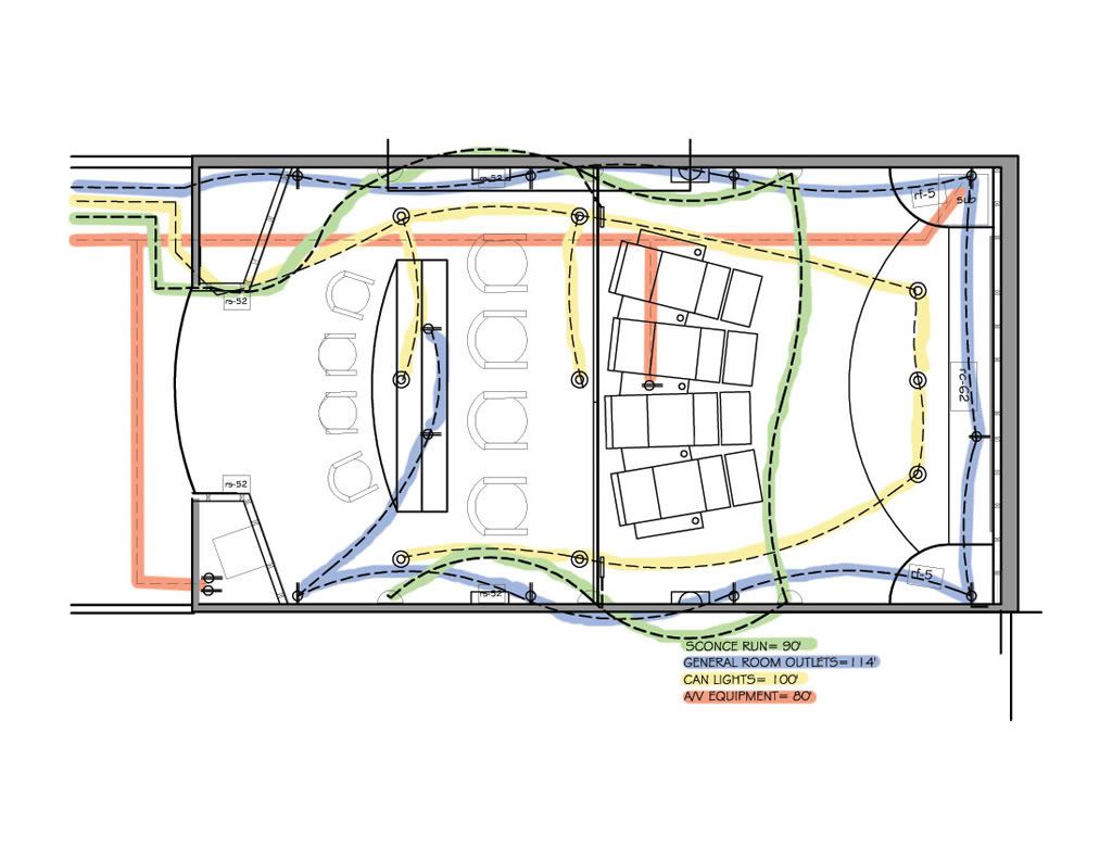

Here's the electrical plan.
One thing not shown is riser lights on the sconce circuit.
I'm very much novice at this, and would appreciate any comments.

post #101 of 1838 Old 08-19-2007, 04:18 PM
Dan Woodruff's Avatar
Posts: 1,217
Tony,
I don't remember you mentioning it but if you are going to have columns, you might want to consider placing your electrical outlets in them along with your lights.
This will help keep the outside noise out.

Dan, Now you mention it!!! The boxes are in---and drywall cut already. Wouldn't be a big deal to change it now, but two reasons come to mind for doing it like I did. One, a sconce on a column will narrow down the room that much more. Two, I like the look of a sconce between columns. I suppose, sound isolation is just not as important to me as it is to most here.
