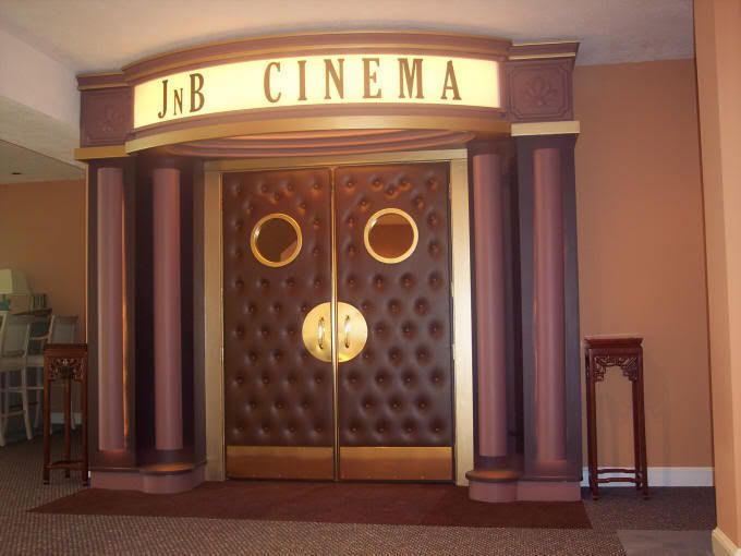

I haven't mentioned, but I am at the point of needing a "theme". I've struggled with this for some time and have settled on one now. I actually need to credit the guys that came over for the home theater meet. They helped pull the thought out of me. I'm from New Orleans, and wanted my theme to bring back childhood memories, so I've chosen a "French Quarter" theater theme. What is that exactly? I'm not sure. I'm thinking a gas lamp look for sconces, maybe some wrought iron railing? color scheme maybe a bit medeterainian?
I've also got a good inspiration photo for the entry. I'd credit the owner, but got it from a BigMouthinDC post and he got it from somewhere else too.
I will likely follow it pretty closely, other than color scheme. Will also go to one column on each side. I really like the doors and will follow those as well. Probably on double swing hinges.

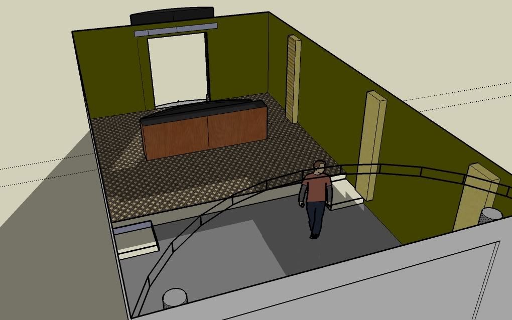

I'm also studying my side wall elevations. I was planning acoustic treatment from the floor up 48". If I do this in the rear of the room, it will have to step up with the riser. This starts to look like its "squashing" the sconces in the rear of the room. Do you think I could get away with keeping it the same height all the way across the room? Essentially, only 36" high in the riser area of the room.
I might would opt for this approach even if a slight audio compromise. I think the aesthetics would be more important. Aren't they sometimes?

post #185 of 1838 Old 06-09-2008, 06:12 PM
AVS Club Gold
Dan Woodruff's Avatar
Posts: 1,217
The acoustic treatment needs to reach ear level.

I love those doors. The marquis is excellent too. I know they are not yours, but they look great!
I wonder about soundproofing those bad boys, though.

Dan, the rear bar is going to be at 36" height (same as a kitchen counter), using 24" tall bar stools. I just sat in ours that are upstairs, and ear level for me is at 56". If I put the Linacoustic up that high, I think the decor will look funny. I'll be left with about 2.5' of space above. Heck, it would come right up to the sconces too.
I can stay at higher than ear level all the way back to the riser, which is halfway (16'). I've got to believe that most of the reflection issues are cured by the time you're 16' from the speakers? no? Maybe I can just keep a shorter barstool around for people that are troubled by the acoustics. Except that they won't see the screen on a shorter stool........oh brother, this is a very complex hobby.
CJ, I'm sure they are a poor choice for soundproofing. I'm not going to much trouble to soundproof to start with, so the doors won't be a real factor. Plus, they are COOL !

Tony,
I realize that ear height puts your acoustic treatment above where you want to be but for the treatment to be effective, ear height is imperative. Remember when you were at my place and I had you listen to the ringing (snapped fingers) above and below the treatment?
I guess it's reasonable to believe that those seated at the bar won't necessarily be listening critically. I was just reminding you that there will be a significant difference in the sound at the bar compared to your front row. That back row will probably sound as if there is very little treatment or none at all.
One home theater I visited in Highlands had the treatment at the top of the wall rather than the bottom. He did it that way because he felt that many people would be standing in his theater. He made sure the treatment went below ear level while seated in the front row. I felt he had a bit of a first reflection problem but maybe that was just me.
You might want to ask for suggestions in the Acoustical Treatment Master Thread. Terry Montlick, Dennis Erskine, Ethan Winer and several other acoustic professionals and hobbyists reply in that thread on a regular basis. I'm sure a couple of them have encountered this issue in the past and will offer ideas on how to solve the problem. http://www.avsforum.com/avs-vb/showt...2&goto=newpost

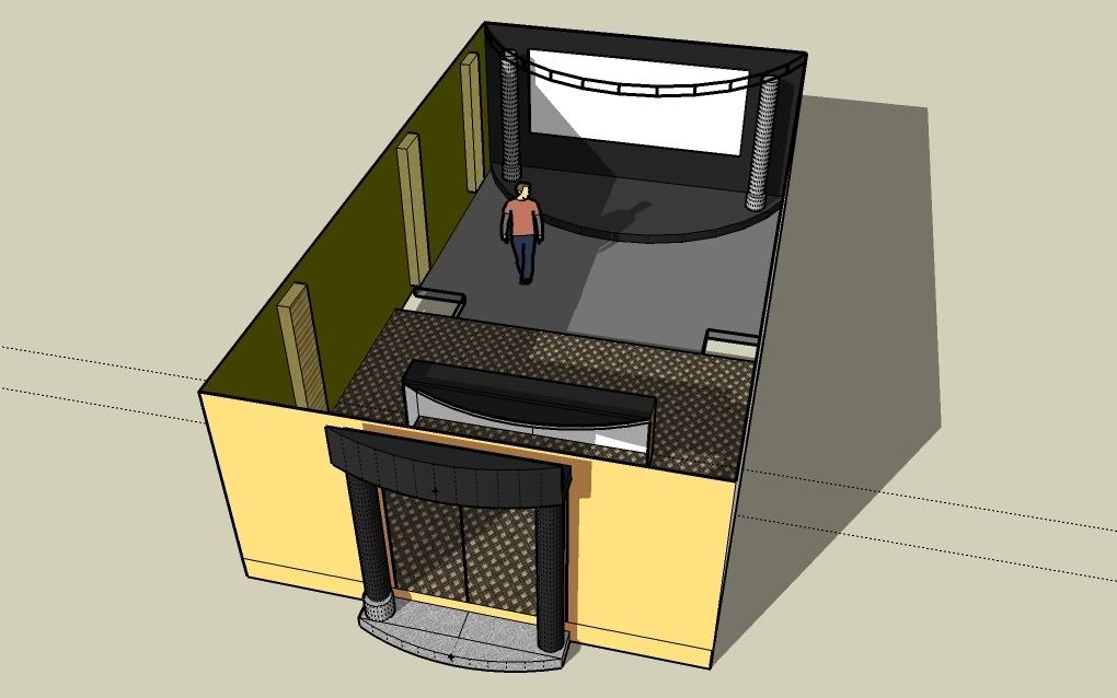

I started framing in the entry. An issue I'm having is that the area just adjacent to the entry is going to be pool / ping pong. I wanted to do the radial steps as drawn in the plan, but I'm concerned about a tripping hazard for ping pong. So, I framed it out as one rectangular (8'x14" tread) step. I'm thinking I'm thinking I will try to visually get the radius in with carpet on the floor, and the overhead marquee.
I hope to frame the bar over the weekend. I picked up the lumber yesterday. I've decided to eliminate the part of the bar on the middle row side. So it will be a one sided bar. The middle row will now be a sofa and not swivel chairs. My wife feels a sofa is more condusive for the family to "cuddle" together, and she's probably right.
The bar will be 10' long with a radius. It will be 1' deep on the ends and radius out to 2' deep in the middle. As said earlier, top of bar will be 36".

Big, I framed up the main wall of the bar just now (10' long). I'm planning on having a 12" leg on either end on one side, and a 6" leg on both ends of the front side. There will also be one 6" leg in the middle of one side (I got this from one of your photos). All of the bottom plates will be screwed down to the riser. Do you think this gives enough stability to the bar? Seems like it will be shakey to me. Maybe once the sheetrock is on it will "tighten" it up? Any thoughts? I can draw a plan if that wasn't clear.

A sketch would certainly help.
Are you planning a one or two level bar?
On thing I would do differently is minimize the middle leg and go for bracket supports. see this Pic

You should plan at least a 12 inch overhang at the ends if it is curved (small at the ends)
My bar top is 18 inches overall at the ends 25 at the middle.
Also you might want to think about using plywood on at least one side of the base (you can put drywall over if you want) that will give a little more rigidity to the frame support.

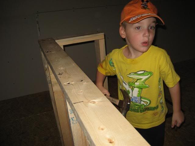

post #202 of 1838 Old 06-13-2008, 05:33 PM - Thread Starter
tony123's Avatar
Posts: 5,057
Liked: 37
Thanks BigMouthinDC! That's very helpful.

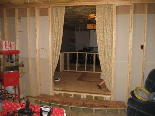

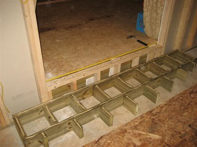

Here's a few photos so you can see what I've done today.
It's framed 10' long and 15" in depth. By the time I do overhang, the top should be 10'6" wide, 18" deep on ends, and 24" deep in the middle. So, I think I've framed right into the figures you suggest. It feels pretty steady, but I may still need to put the little short walls on the front side as well.
The isle on either side measures 43.5" now, so after the wall treatment takes an inch and the bar top takes another 3", I should be at about 39.5" for the finished isle. It feels generous at 43.5", so that should work out fine.
In the last photo you can also see the step I framed to the entrance. It looks to simple to me without the radius, so I guess I'll do that after all. I'd like to match the radius on the entry step to the radius on the bar top. I hope it works that way. Oh, same radius on the front stage too.

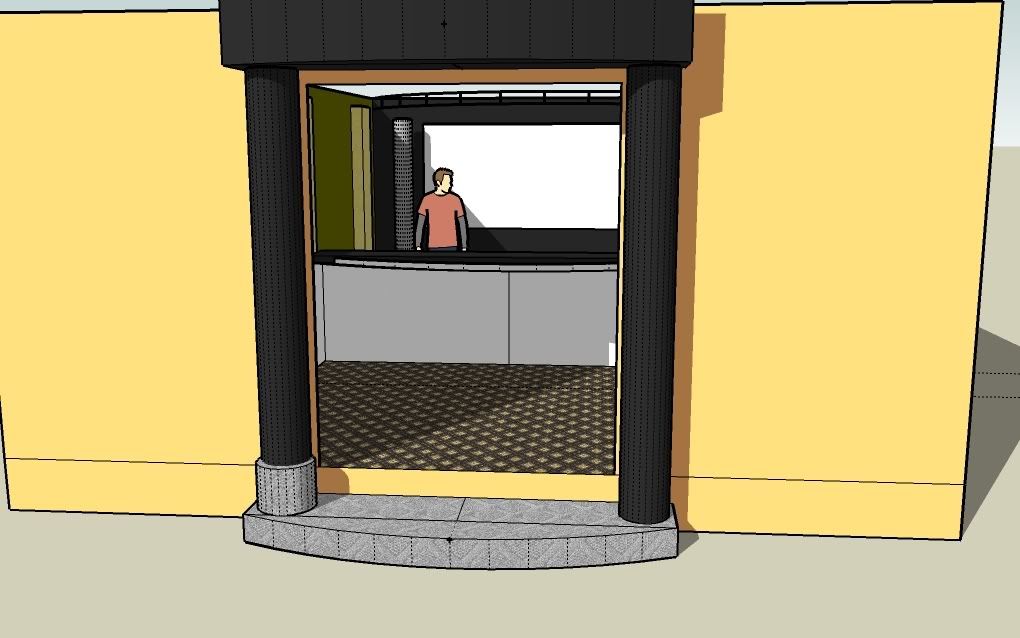

You've put so much work into this project I almost hate to criticize that step up design...but I got a big mouth.
Putting a step up right at the threshold isn't a very wise idea...in fact I am not certain it is code legal. It will be very dangerous for those leaving the theater and might not look down for that step down.
Given your constraint of not wanting to extend too much into the game room I think I would do some surgery on the riser and take a bite out of the riser right inside the theater entrance (half moon maybe) have one level equal to your step outside the theater then another up to the level of the riser but do it inside the theater and put step lights on the vertical portion of the step.
Your design also prevents the use of two way swing door that you said you wanted.

Big, I need a big mouth around, no worries. I came upstairs halfway through "Atonement", and read your post. You had my mind racing through the rest of the movie. I'm trying to figure how I'm not going to have to chop into the riser.
As for code, I'm not certain what it is either, but I do have the same situation in three other locations in the house that all passed code (basement door to steps, garage door to steps, and front door to porch).
I do understand that it may be unsafe regardless of code. At the very least, I'll be sure it is well lit, but I may brainstorm another option. I could come out into the gameroom if it comes to that. It would only be an issue for long shots in ping pong. And, I can always put my opponent on that side.

I'm a little slow but it just dawned on me why you commented that the double swing door would be dangerous.
I've been walking in and out of all our doors in the house. In the ones that open to a step, the door swing is always away from the step. That makes sense to me now. Pulling the door away, causes you to take a step back and look first. If it would swing out into the step, you could push your way through in one motion and take a step before you looked.
I'm thinking that my solution will be lighting and an in-swing door.

Good idea on the carpet color change. I'll do that.
Resale....never say never, but I ain't movin' unless they pry me out of here.
I got the step done this morning.
And my helper today...
I'm happy with how it came out.
Next up, I need to start resolving the screen wall.

post #209 of 1838 Old 06-15-2008, 07:23 PM - Thread Starter
tony123's Avatar
Posts: 5,057
Liked: 37
I don't know why I didn't take the advice of trying "SketchUp" sooner. It was really as easy as everyone claimed! Here are a few images of what I've done with only two hours time. That includes downloading and the learning curve. The colors and materials aren't right, and some of the geometry is still off, but I was just so darn proud of it I had to post the "works in progress". It should be mandatory for everyone to do one of these before building.

Have you let your helper actually nail anything together? I still remember when I visited some friend of the family with my mom when he was building a restaurant or something and he let me hammer in a nail. I felt soooo important. I suppose it may have been because it was a business, but really I'm sure just the memory of actually helping build the place (at least in my mind I helped, now as a person around building all day I realize that a kid hammering in a nail is definitely going to slow down the progress for a bit) was so cool. If he hasn't hammered in a nail yet find a place to let him, he may just remember it forever.
