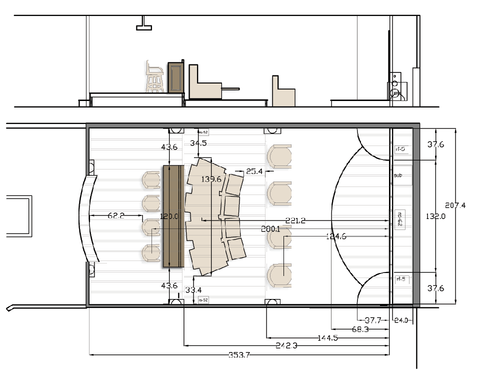

I've included a plan and elevation of where I'm currently headed design wise.
I like 3 rows, a front row that can swivel for easy conversation, and a rear row of barstools and bar. The room will likely be 50/50 use for live sports events and movies. I like the idea of being able to eat at the bar while watching football, etc. The middle row will be a row of four coaster seats that we already own.
I would like to do a constant hieght 2.35 screen with side masking. I don't want any of the equipment to be visable in the room. The attached plan doesn't show a location for an equipment rack, so I'm open for discussion. (the whole room is open for disussion )

I'd really like some feedback on general dimensions and layout. I've marked (in chalk) the plan onto the concrete floor and will position chairs accordingly and then watch some and see what I think. My gut is telling me that the middle row (sweet spot) would be better about 18" closer, but that makes things very tight for the front. I'm also curious if the space behind the barstools will feel large enough. I don't want to feel like you are squeezed right into the bar when you walk in the door.

I can't tell what your screen size is, but looking at the dimensions, I'd guess around 10' wide. The sweet spot for movies, for a 2.35 screen, should be around 1.1x-1.3x screen width. Your sweet spot is around 1.8x screen width. You're going to regret it. Ditch the first row, put your recliners at 1.0-1.1x screen width in a first row (closer is better for bass response, given your room length - you want to be as close to 38% or 62% as possible). Put the swivel seating in the second row behind the recliners. Leave the barstools where they are - you may even be able to move them forward a bit. That gives you serious reclining seating without the front row sticking out like a sore thumb, for when you want to be immersed a movie. And now, the swivel seating and bar stools are for game time, when people generally don't care if they (and often prefer not to) sit close or have a recliner. And now, they can swivel back and talk to the people in the bar stools, leaving the front row undisturbed. You don't want to compromise regular movie viewing for those few times a year when you host a big sporting event party.

I was hoping to get minimum of 11' width. Would realy like 12' width with a CH of 60". There is space for this, but will loose most of the "framing" portion of the proscenium.
When watching 16:9 material from the back rows, I think I would need that extra size.
Interesting concept about making the recliners the first row and make sure they are in the most "imersive" position. I also like the idea of putting the swiveling chairs with the bar. Maybe the bar becomes a two sided multi-level bar that serves the rear and middle rows? I like the "social" aspect of that for sporting events. I'll draw a plan exploring some of those thoughts.
Having four great seats for movies is probably all that's necessary. That's probably all the critical viewers I would have at one time anyhow. Heck, when companies over, I don't have to be a critical viewer.

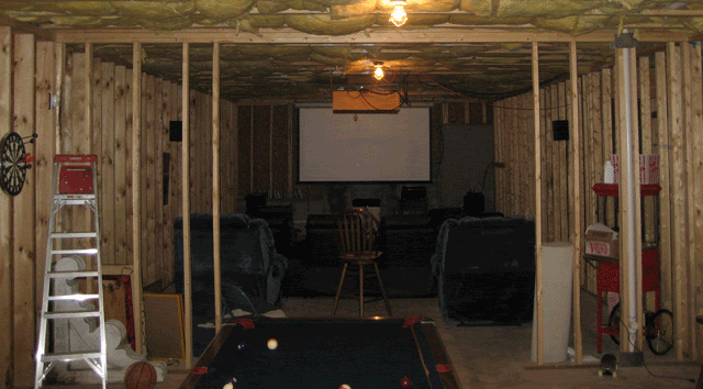

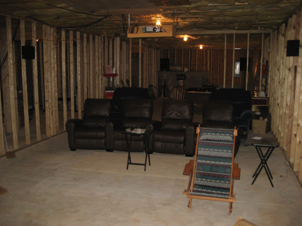

Here's a photo from the gameroom into the theater. You can see our temporary setup! Yes, we're already enjoying the room. The screen is a 108" wide, to give you an idea of scale.

Here's from the screenwall looking back to the rear and the gameroom beyond.

I've been playing with a new scheme based on yesterdays comments. The Coasters are now shown in the front row at about 1.1 times the 141" screen size. The swivels are now shown in the middle, and the rear of the room now shows an equipment closet and media storage closets.
I gave up some space as you enter in the back, but feel it was okay, as the gameroom will act as the "lobby" space.
I'm not sure how I feel about this scheme? The platform in the middle is not big enough to be used for reclining chairs if I ever decided, and I like knowing that it would be possible.
I'm going to put chairs in these positions tonight and see how it feels.

I think I like number 2 better. Looks like it will be a little more conducive to high-fives when watching the game. Plus you have 4 good seats for chilling and watching a movie.

After looking at it and considering what you said about the way the room will be used, the second layout may work better. It will certainly allow those who want to watch the movie/game to do so in the front row while the more "social" get rowdy behind them. It certainly allows for some great seating for those critical viewings.

If possible, I'd try to move your seating back a little bit to improve low frequency response. You want to be as close to either 38% or 62% room length. You're almost right at 50% room length, which is the worst place for smooth low frequencies. The angled back walls should help remedy this some, but I'd still suggest moving back, if you can give up some foot space for the swivel chairs. Anyhow, I agree with the other two posters, layout 2 looks like a more practical seating environment.

Lindahl, if I'm understanding correctly, you're saying the front row (my critical seating) should be at 38% or 62% of room length. So, not counting the 24" behind the screen I've got 360". 360*38%=137" OR 360*62%=223"
If I move it to the 38%, it will be slightly closer than 1 time screen width. If I go with 62% then it falls right where I'm currently showing the middle row. If this is critical to the low frequencies, then maybe that's an arguement to go with the critical seating from scheme#1? I don't see the 38/62 rule working otherwise.
I want to try another scheme with the bar being curved and have it a a two level/ two sided bar, so that the swivel chairs can turn around and have table space.
Once we settle on horizontal spacing, I'll use the riser calculator and see what hieghts I'll need for the given layout. I'm hoping for minimal risers.

I suppose I should also consider that 50% of the time I'll be watching 1.85:1 which will be 111" wide. With critical seating at 155" (as shown) that would put it at about 1.4 times screen width. With that being said, I feel like 155" is a good spot (outside of bass response). What would be some solutions to working around the bass response issue?
It's not a hard fast rule at 38% and 62%. As you get closer to those percentages, there's improvement. However, there's a few bad spots to avoid. Mainly, where the room length lands on a low even multiple of the seating position (25%, 50%, 75%, etc.). I wasn't so much saying that you should land right on 38% or 62% (which are ideal), but you should bias your seating away from 50%. Since you're just over 50%, moving away from 50% by moving your seating just a bit back (forward works too) should yield improvement. But, like I said before, the angled walls in the back of the room may break up some of the modes that would normally exist at 50% of the way into the room. I wouldn't completely change your layout just to sit at 38% and 62%, since the improvements made from an 'average' seating position to an 'ideal' seating position won't be that significant. It's mostly just trying to get you out of the 'bad' seating position.

I understand now. I also understand that some of these "rules" are more about avoiding the worst cases instead of getting the perfect case. Let's face it, form needs to follow function as much as possible.
I didn't anticipate struggling like this. I thought 32' of depth would give me room for anything I could dream up, but..... LOL

Fatawan, We're a family of four and love to entertain, so I think our seating needs break down like this.
30% two people
50% four people
15% six to eight
5% more than eight
I keep a movie log, and we watch right at 100 movies in a typical year. So about 20 times a year would we have more than four.
I am playing with a new layout right now that has the screen against the back wall. It's working out much better. Being "stealth" is really important to me, so I don't want the center to be obvious. I'll likely have something below the screen that houses the center.
Hope to post the new layout by tomorrow.
Tony

Since you'll only have more than 8 people 5% of the time, I think I'd consider getting 4 more coasters for the middle row.
