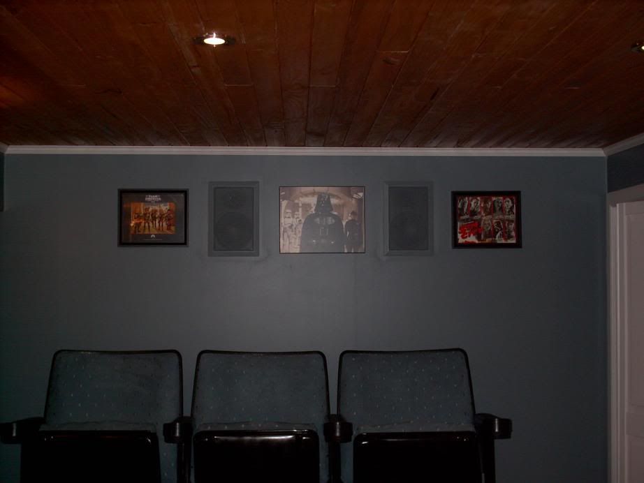

The Bunker Cinema is a 20'x12'x6.5' basement theater. My house was built in the 1950's and they really didn't think of basements as living space back then. The room started as bare brick walls.
I used double wall construction on all walls adjacent to the other rooms in the basement. All walls were insulated and finished with a single layer of drywall. All wires were run in-wall. The paint used on the walls is Lowe's Valspar Academy Gray with Cobalt Cannon on the columns.
I used knotty pine T&G on the ceiling. I was worried about what this might do to the sound, but I haven't noticed any problematic reflections.
It features 110' diagonal 16:9 screen and 7.1 surround sound.
It sounds incredible. I was blown away by the difference in sound from a rather open living room, were I had everything setup before.

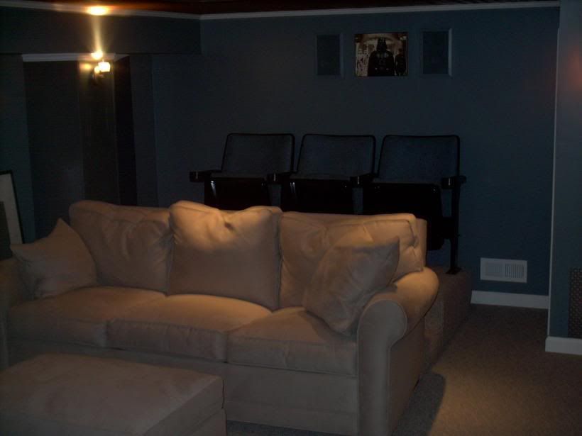

I'll be adding real flip up theater seats for the back row in the future. The back row will be for short people because with the riser I'll be close to the six-foot height mark. I have the love seat pictured jacked up with a jury-rigged riser now to serve as temporary seating until then. It works for now.

Last weekend, I finished reupholstering the rear row seats and installed these on the finished riser. I carpeted the riser to match the room.

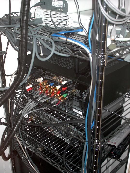

Last week I got the urge to clean up the snake pit that was the back of my equipment rack. I still have more to do but its better than it was.

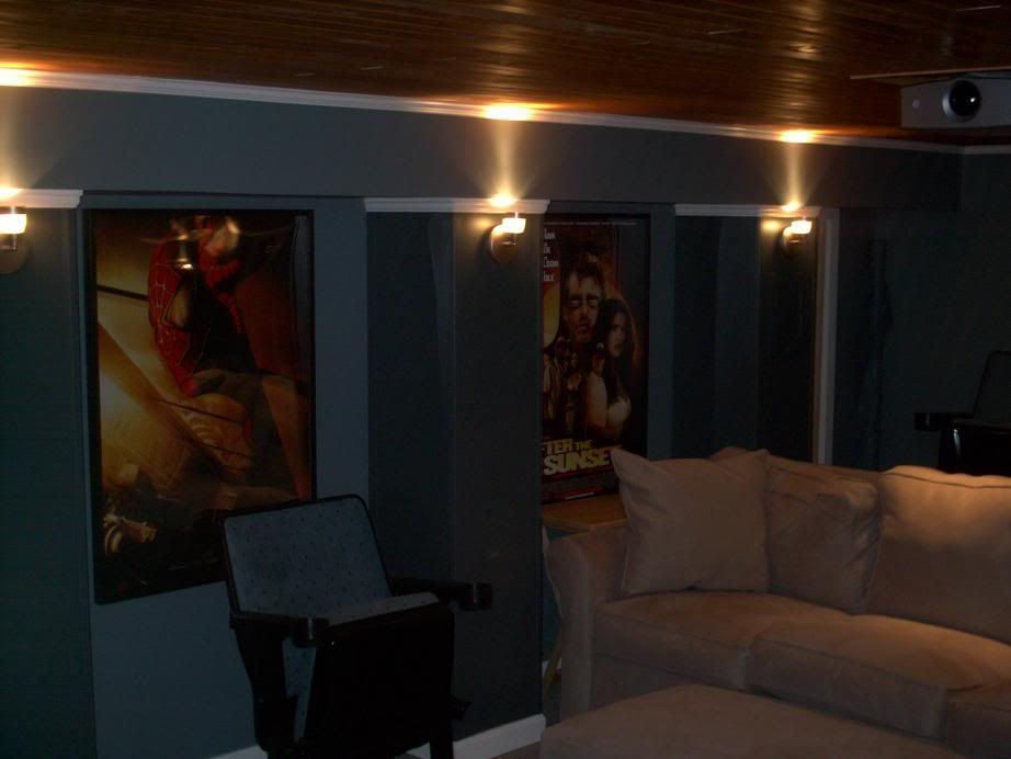

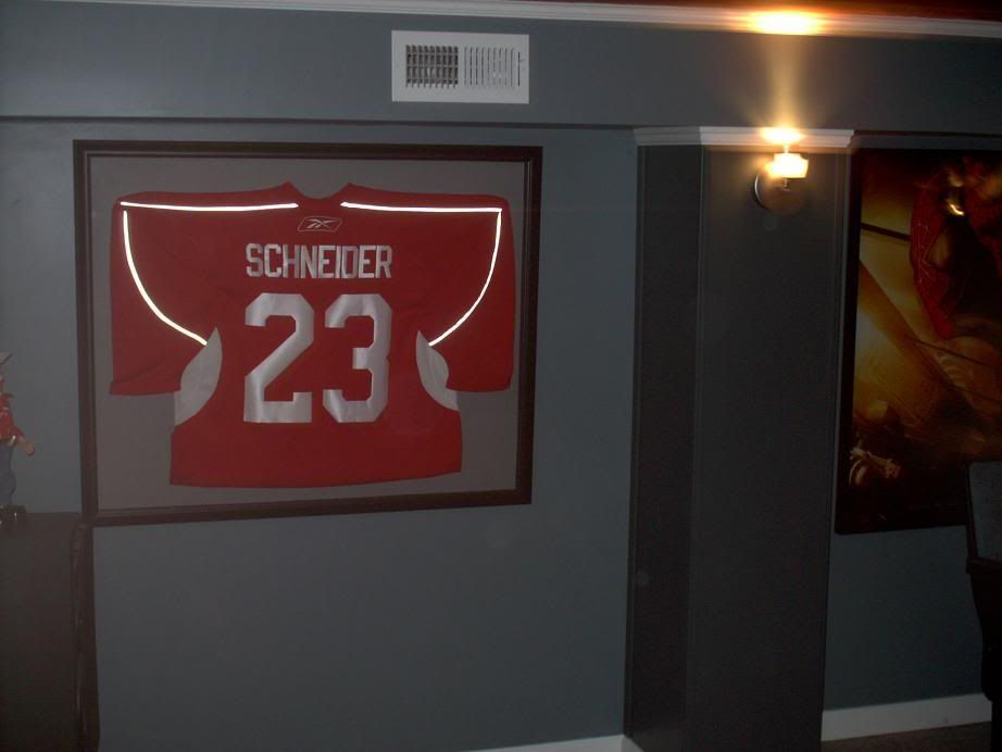

A few shots of the side wall with the posters and such in place.

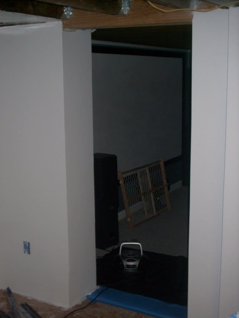

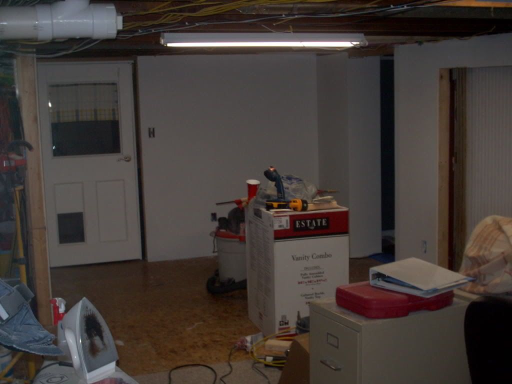

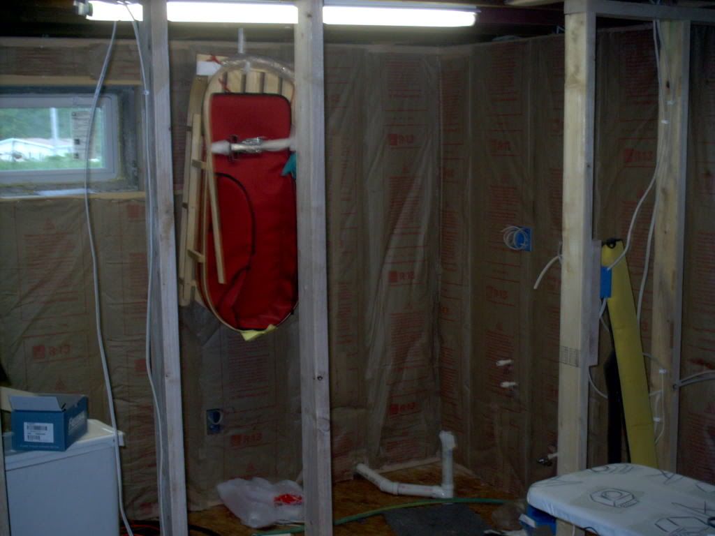

My wife and I started to tackle the rest of the basement over summer 2008. We had a baby on Thanksgiving of 2007, so progress slowed to a halt for several months after she arrived.
We are turning the rest of the basement into a multi-purpose room. My wife has been working from home so one area of the room will be her office. The basement was plumbed for a bathroom when the house was built so we are taking advantage of that.
Here are some progress pictures as things stand now.
Bathroom Framing
Bathroom Entrance
Basement Entrance
Theater Entrance
Future Bar Area (Fingers Crossed)

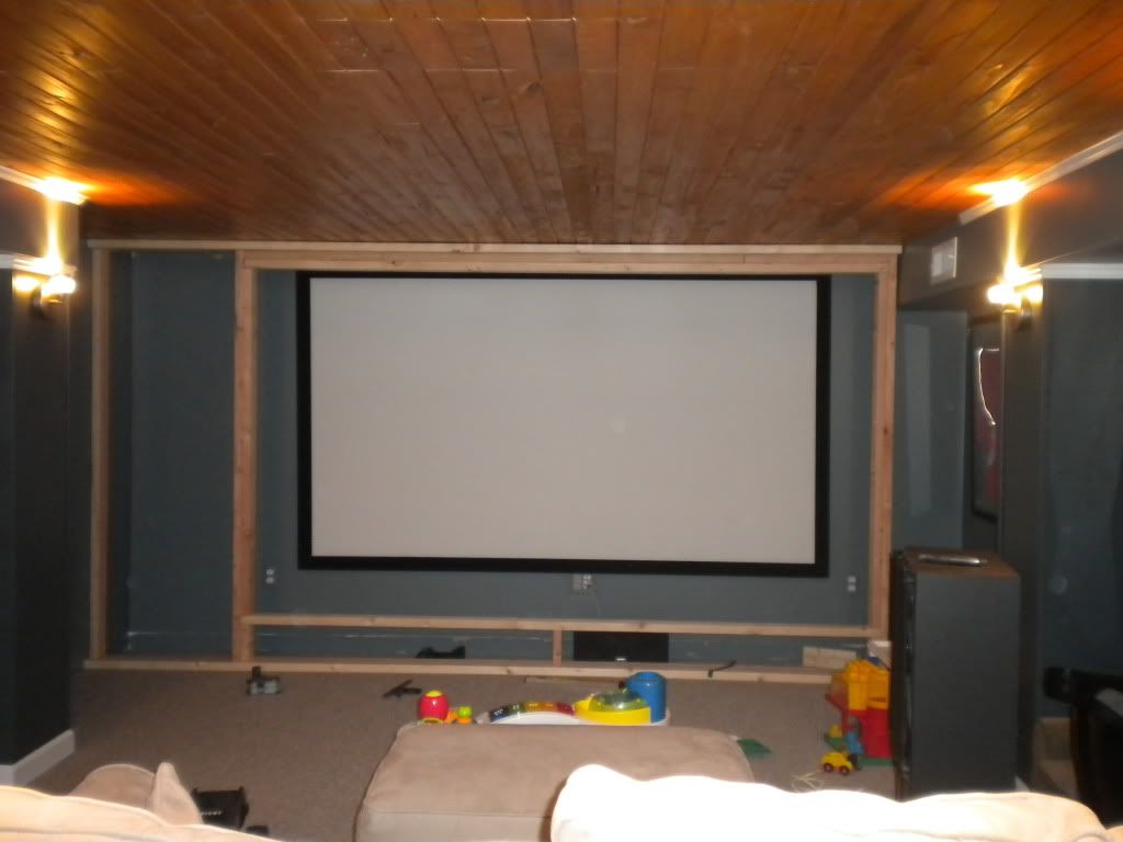

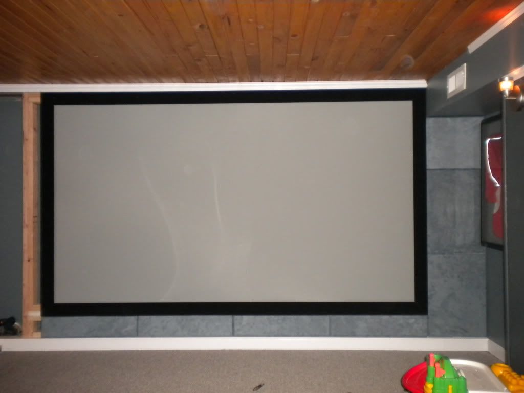

I'm in the process of adding an AT screen wall to my theater so I thought I should update this zombie to show my progress. Its been a busy three years around here. I popped the top on the house and added a second story, because we also added a second child during the same time as well.
When I built the theater I had a short throw projector and I made the mistake of locating it too close to the screen wall. I now have a new projector and in order to move the screen wall out I need to relocate the projector because in its current position the zoom is maxed out. Luckily the opposite side of the basement still has unfinished ceilings so the process is running fairly smooth. I'm dealing with low ceilings so I also had to customize my projector mount to bring the projector closer to the ceiling. Once I finish moving the projector and patching the ceiling, the real fun can begin with the stage and screen wall.
SCHNEEDOO is offline

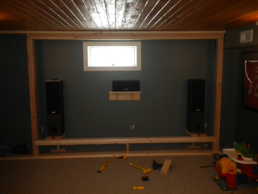

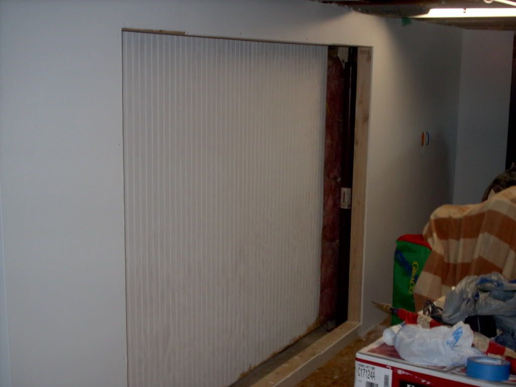

I relocated the projector yesterday and started working on the ceiling patch. The patch boards are just dry fit right now but once they're nailed into everything should look good.

Screen Wall under construction. The new screen will be 107" x 60". The old screen is up for comparison.

Thanks, it's been a great room to have to watch movies in and have Superbowl parties. My 4-yr old just loves the room and I don't mind watching the Disney stuff with her.
My projector is a Sony VPL-AW15, with the new false wall in place the main seating will be 12-feet back. The second row is 17-feet back. After I finish the false wall I'll be redoing the riser to squeeze the fourth theater seat onto it.

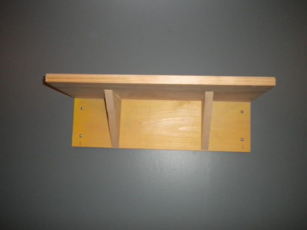

Quick and dirty shelf for my center channel.

Finishing the screen wall. I'm using a microfiber material that plays well with the color of the walls. I'll be installing hidden media storage to the left of the screen.
