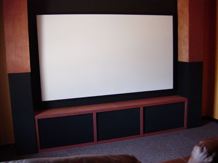

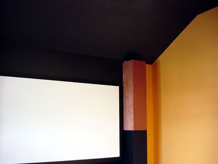

Managed to make a bit of progress today.
I placed an order for the projector (Samsung SP-H710) and mounted the screen up onto the wall.
Took me over an hour to make sure the screen was at the proper height, centered correctly and level.
That I was mounting it as a "floating" screen with hardware that I had MacGuyvered together from stuff that I found at Lowes didn't help either though.
Nice thing is that the hardware I used allows me to adjust the screen by up to 2" forward or back by just loosening one bolt at each corner so I have a bit of flexibility once I get the projector set up.

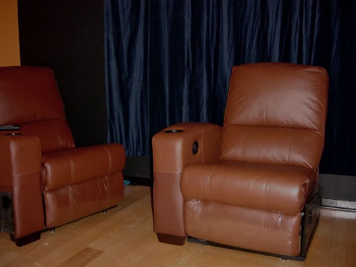

As for today's progress, I unpacked and assembled the last of the chairs, touched up the paint a bit (scuffed it slightly installing the screen yesterday) and am getting ready to work on hooking up the rope light to test how the screen looks lit from behind.
I went with a "Halloween orange" rope light so as to hopefully compliment the wall color. We'll see if that turns out the way I'd planned or not.
Here is a shot of a couple of the assembled chairs, if the rope light turns out well I'll hopefully have some pictures of that to post later as well.

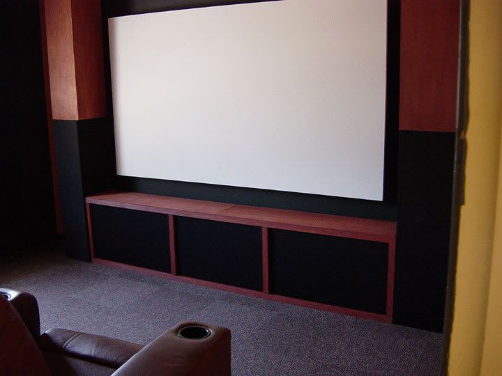

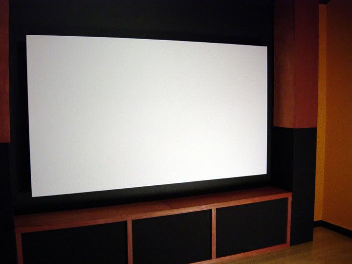

Just a small update to note what was actually done this weekend besides watching movies.
Built the lower cabinet to house the center speaker and sub.
This is what it looked like when it was framed out:
And here is the finished cabinet:
Please forgive the image quality, my camera really doesn't like the lighting in the room or the angle I was shooting the pictures from. I may try to update the pictures tomorrow if I can get some better shots.

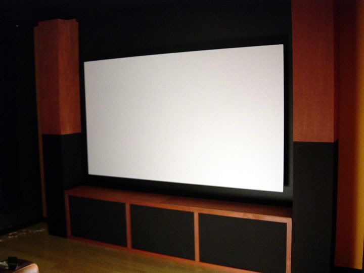

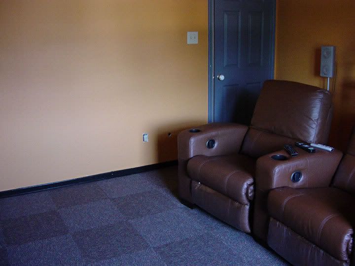

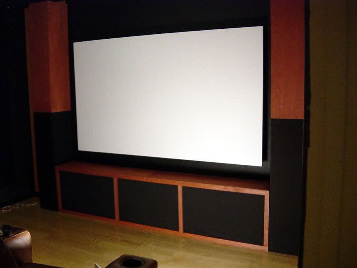

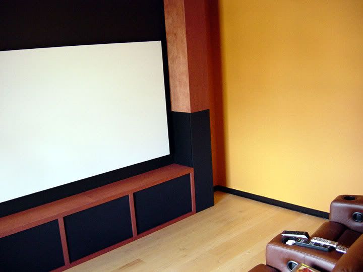

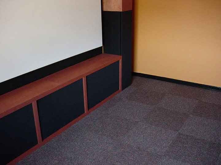

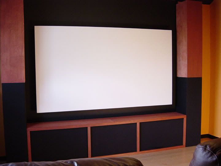

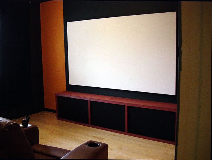

Managed to take a few more pictures of the progress this afternoon:
The screen wall from the door coming into the room:
And the seating and projector:
Pardon the flash effects in this shot, they tend to make things look far brighter than they truly are.
Frankly I may need to stop spending money on my HT and just go out and buy a better camera

Managed to get a bit more work done.
Finished the cabinets/columns for housing the speakers:
-From the doorway coming into the room
-From about two steps into the room
- And from the opposite corner
Pictures are a little off colorwise due to trying to take the pictures at night with a flash. I may try opening the window in the morning and see if I can get some clearer photos by daylight.
And while the columns may look to be a couple of inches too short that was actually by design to compensate for the height difference after the carpet is installed.
Speaking of which, I managed to get the carpet tiles ordered and they should be arriving by DHL on either Thursday or Friday.
Just in time for yet another weekend project

Managed to see a little bit of sunlight hit the east side of the house and took a few more pictures by natural light.
Main shot of the screenwall from just behind the seats..
Picture to show the transition from the wall to the ceiling..
And a wider shot of the west wall to help show the paint colors in a better light..
The black panels of the left and right columns are simply wooden frames covered in speaker cloth to allow the sound to escape from all sides and not pick up reflections. The front panels are attached by velcro to allow easy access to the speakers.
Overall I'm fairly pleased with what $200 in materials (and a fair amount of labor) managed to turn into for a screenwall.
Right now, I am considering putting small sconces on the two columns but I'm not 100% sold on the idea. Problem being of course, that one I start cutting into the fronts of the columns to mount/test the hardware there really is no turning back.
Any ideas/opinions on the sconce idea?

I also put the carpet in yesterday.
Used a "crosshatch" method for laying the carpet tiles down so that they would have a bit of contrast to one another and provide a bit of visual interest.
Of course no one will be able to see that when the lights are down However the effect the carpet has had on taming the acoustics in the room is very noticeable.
That brings the room now to roughly 80% complete.
