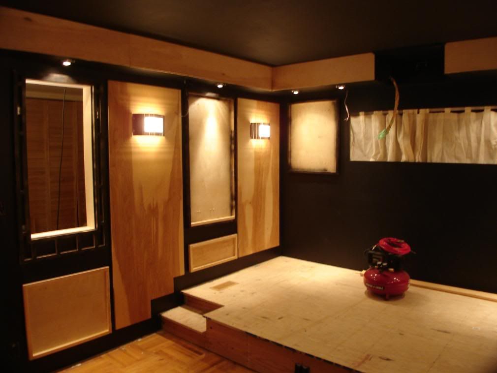

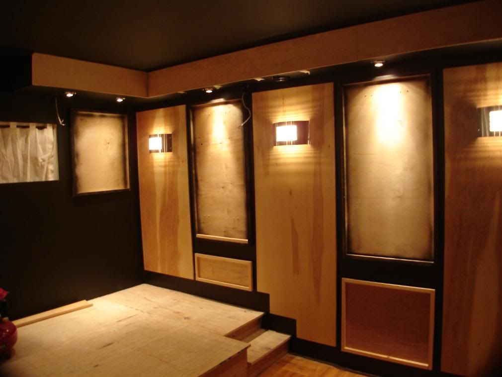

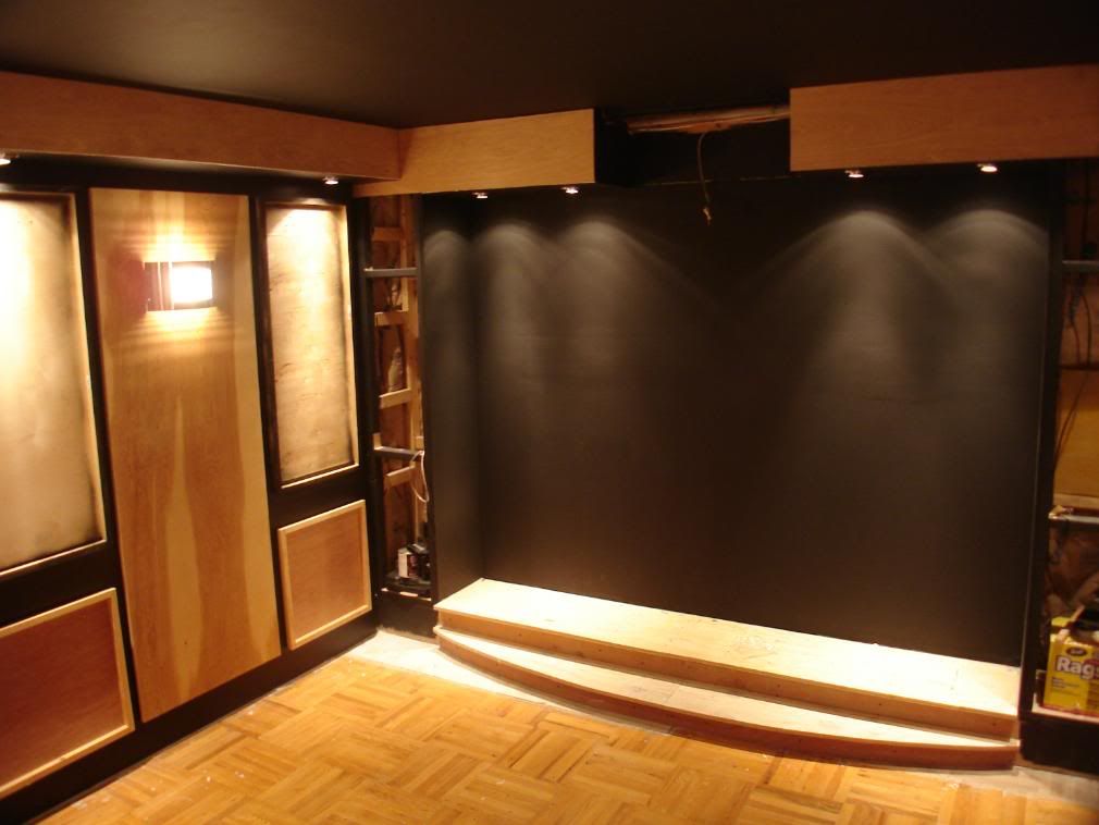

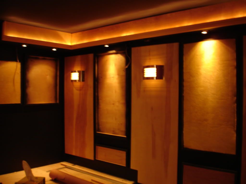

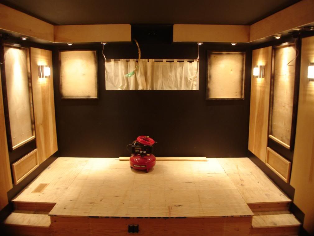

This was a crazy weekend of work and here are more pictures. I also tested all the speaker lines and cables before closing up the soffit. Everything tested well and I can see the project ending in about a month or so. I still need to paint the fascia on the screen wall black and put molding and crown in the soffit. Now on to the pictures!
The fabric panels will be wrapped in black GOM with OC 703 in the frame. Right now the wood frames are just hung in place.
Fascia wood still needs filling at the seams and a coat of flat urethane.
The curtain is only temporary until I figure out my plan for the window.
Molding will go on all edges for a clean look and more foundation for crown molding.
The facia wood on the stage area will be painted flat black to match the rest of the stage.

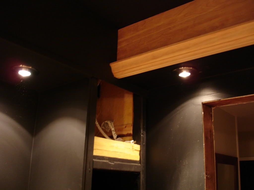

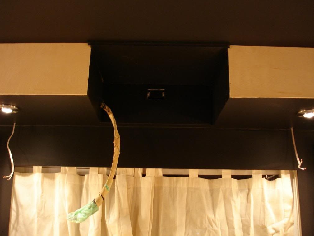

Started working on the soffit molding tonight.
Started with some 'L' shaped molding. The crown molding will also nail into this.
Detail at the projector opening
This is where the soffit meets the screen wall column.
The crown molding for the rope light will go up like this. I am holding it off camera

Before I saw the last picture, I was assuming that the crown would "rest" on top of the l-moulding. Any particular reason for doing it the way you planned vs. that way?

Since the fascia is only 9 inches, I dont want to cut off so much of the birchwood look with half of it being different moldings. The "L" shape serves more to clean up the gap between the wood and the drywall and also to give me much more to nail the crown into other than just the studs. The underside of the 'L' molding still shows and looks much cleaner. I can now spread the nailing thoughout the crown for a better hold.

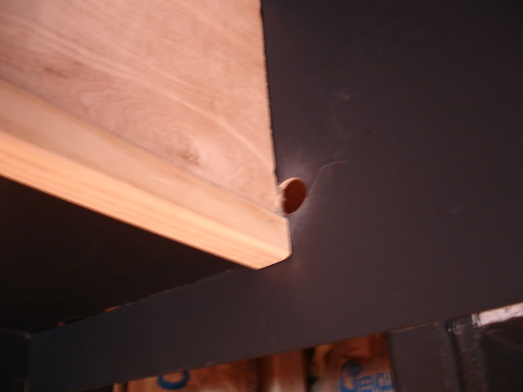

post #103 of 297 Old 01-13-2008, 07:35 PM - Thread Starter
rsprance's Avatar
Join Date: Jun 2003
Posts: 629
Liked: 24

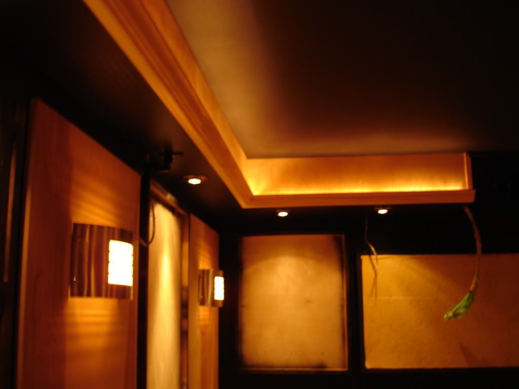

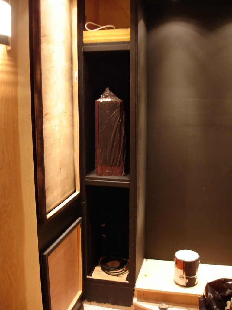

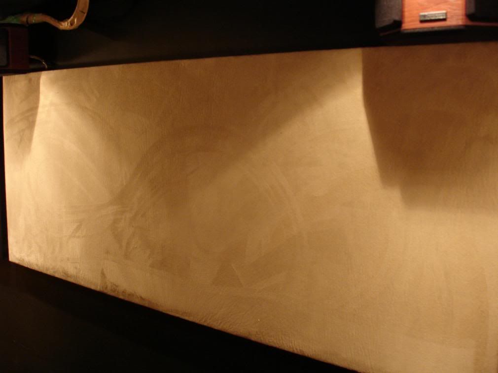

More work this week, getting the room pretty close to ready for the carpet install next weekend!
Drilled the rope light hole before putting up the crown molding.
Crown molding worked well with the "L" shaped molding.
All wood is finished with a BM flat poly.
Detail where soffit meets screen wall column.

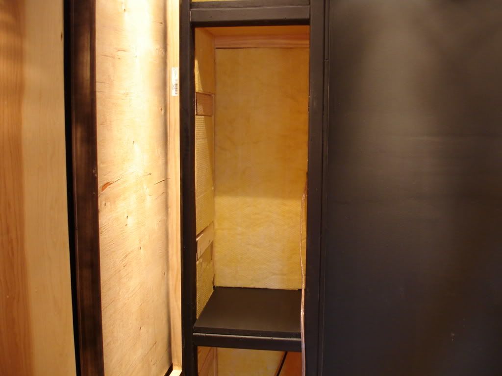

Also worked on finishing up the inside of the columns...

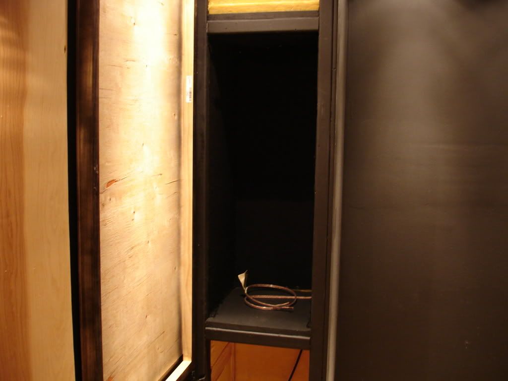

Lined the inside of all columns with OC703
...then lined the inside with GOM701 acoustically transparent fabric
Speaker fits just right

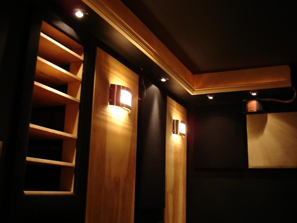

post #107 of 297 Old 01-14-2008, 06:44 PM - Thread Starter
rsprance's Avatar
Join Date: Jun 2003
Posts: 629
Liked: 24

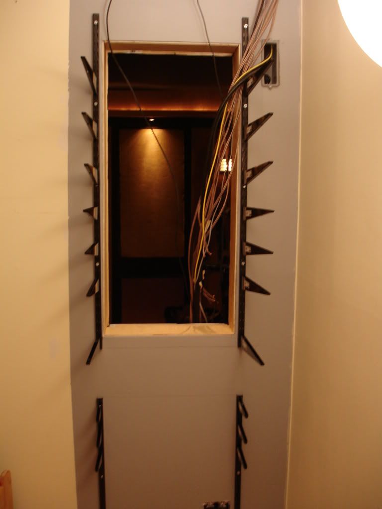

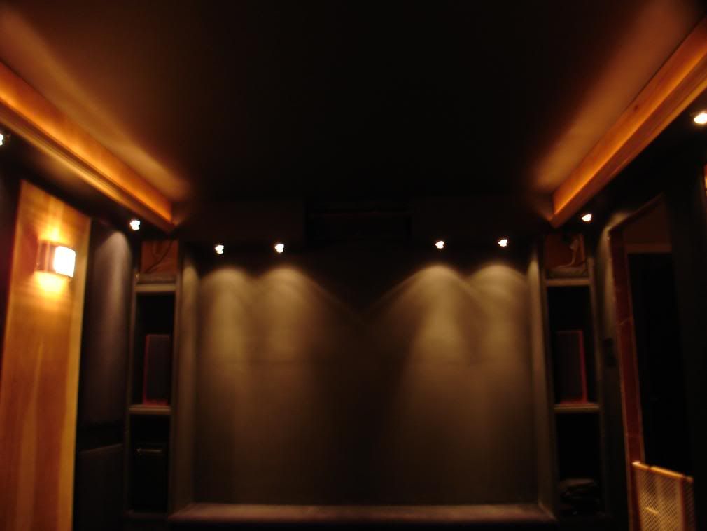

Got some more stuff done today, including the GrafikEye installation. I was dreading the wiring and how to connect everything and I had it all basically done in one hour. It's one of the coolest things for a theater and I haven't even used it with the remote yet.
Started putting up the shevling brackets. Thanks to Tom (YW84U) of Tanner Ridge for the stealable idea that saved me a lot of money!
I will notch out the shelving to fit inside the opening and cut it using the leftover birch ply from the wall panels.
GrafikEye Installed! Booya!
And here's some newly set "scenes" that show off the lighting and cove lighting better
rsprance is offline

Hi Rob,
Looking good. Can you help me understand what you put inside the speaker columns and why. I am building a very similar screen wall, and want some insight into what to do and why.
Also, what will you put in the top and bottom "boxes" that are empty.
rbuck is offline
post #112 of 297 Old 01-15-2008, 02:08 PM - Thread Starter
rsprance's Avatar
Join Date: Jun 2003
Posts: 629
Liked: 24
Originally Posted by rbuck View Post
Hi Rob,
The bottom boxes are for the sub, the middle for the L/R speakers and the top is just to give me access to the rope light outlet. i will be filling the top cavities and the bottom right with OC703 insulation since there will only be one sub.
OC703 is a sound deadening insulation. In hindsight I wouldnt have done the screen side in drywall but covered it with GOM acoustically transparent fabric instead. Since it was pointed out to me after it was already built, someone sugested i line it with OC703 to deaden the inside.
I suggest posting your design idea in the acoustical treatment thread and letting the knowledgable people there have a go at how to properly handle your design.

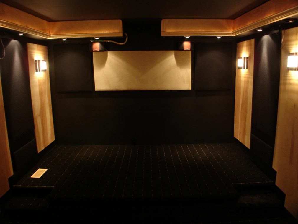

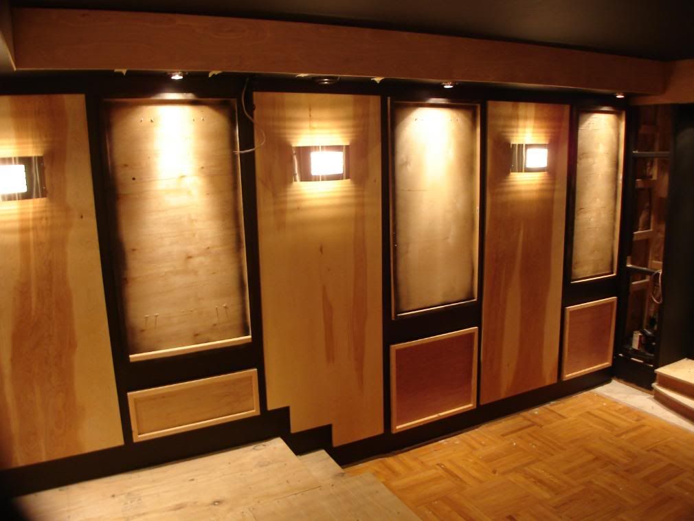

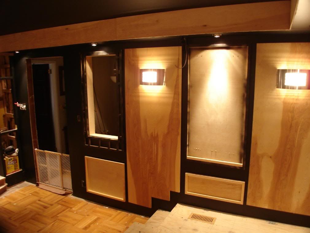

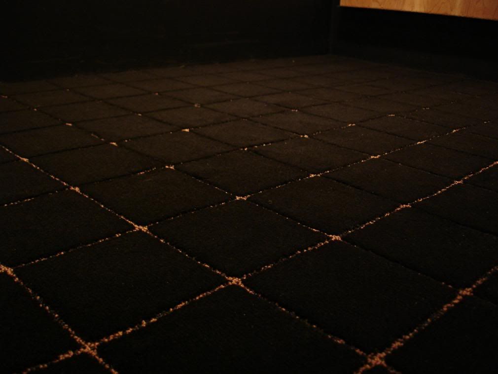

Carpet is installed!
Fabric panels are up!
No blabbing, here's the pics!
Close up of the carpet
Looking at the back wall. Got to change that floor vent!
Screen wall shots. Screen going in soon! Speaker colums with be covered with acoustically transparent fabric so you wont see them.
Window was covered up with a removable fabric panel. I was able to purchase the same microsuede fabric used in the Berkline chairs (thanks Roman) so I used it for the window panel.
I love the way the equipment rack shelves came out!
A few more misc pics
Tomorrow I'll be hanging the projector and starting to set u psome of the chairs

Rob,
Looking great! I hope you don't mind if I "borrow" a few of your ideas.
The wife and I really like the wood panels mixed with the GOM. Very sharp!
BR
bigrock66 is offline
post #120 of 297 Old 01-21-2008, 07:52 AM - Thread Starter
rsprance's Avatar
Join Date: Jun 2003
Posts: 629
Liked: 24
Originally Posted by bigrock66 View Post
Rob,
BR
Borrow away! I need to find a better way to take pictures. They do not do the room justice and the dark setting makes everything look too blurry.
