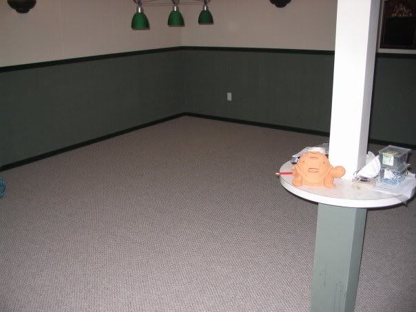

Temporary ugly test setup (the 'Before' picture). Love the carpet!
Building the sub box
Ripping out the bar
Bar's gone
Carpet is coming out... I hate rubber-back
Still ripping rubber. Check out the 'AV Rack'!
Rubber is gone. Brutal cracks in the floor

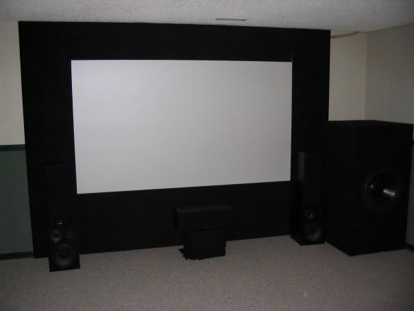

Built on a tight budget: The Cheap Seats Cinema

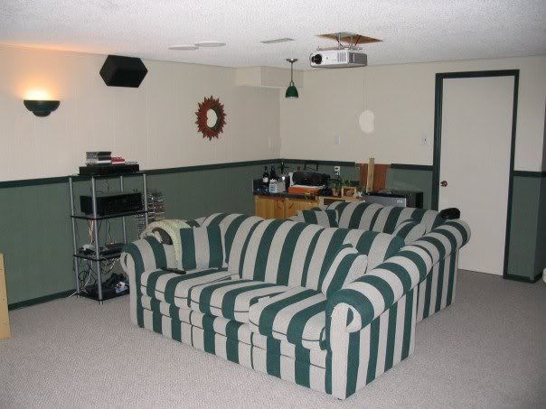

Continued from above.
Ahhh, pretty carpet
Making a screen frame
The "Cheap Seats"
Mission accomplished
I am in desperate need of speaker stands since my Ascends (which you can barely see in the pic) are standing on old speakers. I'm sure I need some acoustical treatments too, but that's more reading I don't have time for right now.
I welcome your comments and questions!

I feel your screen setup came out quite well. Looks really good. Amazing what you can do with a few bucks and a little imagination.

Looks very nice. What did you use for masking the screen, velvet, felt?

It's flannel suiting material from wally-world for about $4/yard. Glued it onto some 1/8" MDF and velcro'd them onto the frame.

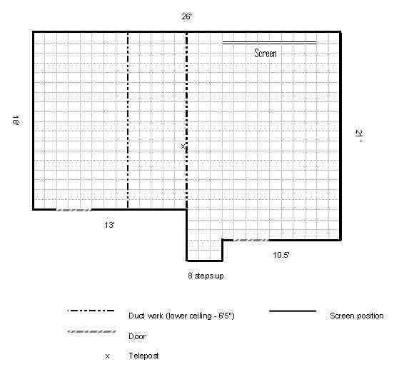

Is your room open on one side, since you said the theater wasn't using the entire width of the basement, or do have a wall and door to close off the room? I'm not sure how the treatments would work for the first reflections if one side of the room was open, so you may want to post that in the Treatment sticky. I recommend bass traps. I could only place them in my front two corners (4 inches of OC703 3pcf rigid boards covered with fabric), but it made a noticeable difference. Same for my 2" 703 boards at the first reflection points on the side walls.

My room is open on one side, so it could be interresting. I'll take a look at the treatments sticky when it's time to start tuning. Here's the basement layout. That's one big room, no walls or dividers. There's about a 1 foot dropped section for duct work, and that's it.

I think you should build a wall right along the telepost.

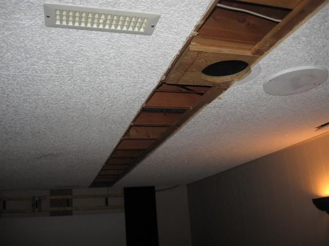

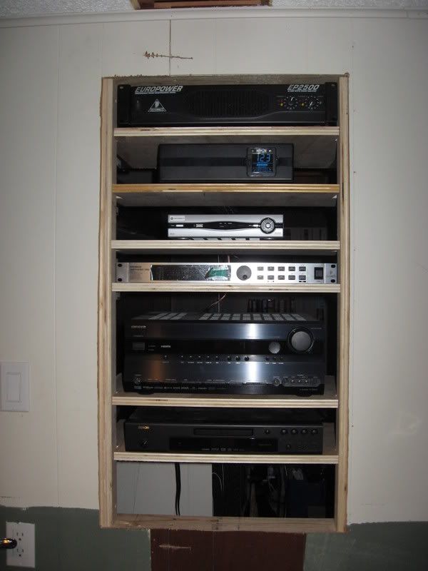

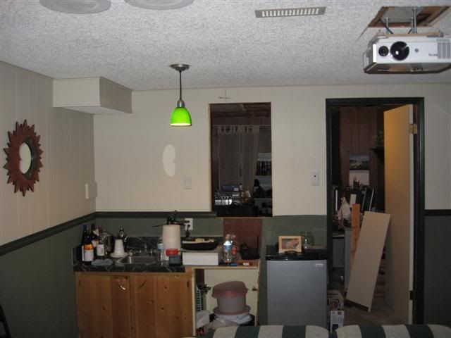

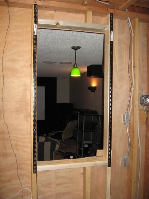

I've finally bit the bullet and started to hack up my wall to flush/rack mount the components. Here's progress so far:
Hole cut in the wall 21.5 inches wide, 40 inches tall
From the room behind:

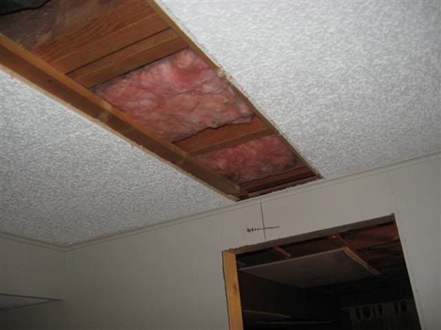

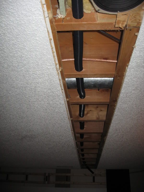

Taking out ceiling tiles to run wire for speakers and IR repeater:
More tiles, toward the screen:

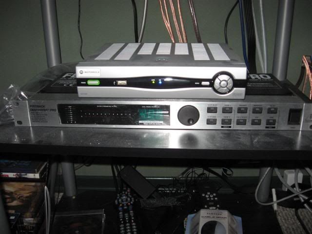

My new BFD. Ignore the cable box on top:
I also picked up a Tripp-Lite Omni 1000 LCD UPS from Costco.
Now for the fun of running speaker wire and cat5 wire. As you can see all my joists run perpendicular to the wire direction. Any suggestions on how to run the wires so I can avoid ripping out ceiling tiles again if I need to run other wire in the future? I an easily just wire-staple everything up, but makes it hard to pull anything thru later on.

pull down the crown molding and run wire behind it. Your crown looks real small so you may have to put up a larger size depending on the amount of wiring you need to pull. From behind the crown molding you can easily go down into the wall or into the ceiling.

1 1/2" holesaw, 1 1/2" smurf tube
(A/V)Ignorance is Bliss -------- sweet, cheap bliss
antwon412 is offline
smurf tube... just what I was looking for when I wasn't sure what I was looking for. I feel queasy at the thought of punching a 1 1/2" hole into 20-some joists. So would HD have smurf tube? Off to search...

HD does have the smurf tube, but 3/4" is the biggest they have. I found a different solution. 1 1/4" sump-pump outflow tube. I picked up a 20' piece at Princess Auto for $6.99. Now to punch the holes. Fun.

Progress is really slow. Ordering stuff from MonoPrice, getting wire from HD, getting shelf brackets, returning shelf brackets, getting more shelf brackets...
One thing I'm starting to learn is that I can't save money anywhere. I try to get just what I need, like a certain length of wire to satisfy two runs, only to find out I needed 3 feet more. Should have just bought the 250 foot roll and be done with it.
Anyway, this is the hose run in the ceiling:
Stuff just sitting in the rack:
The back of the rack:
