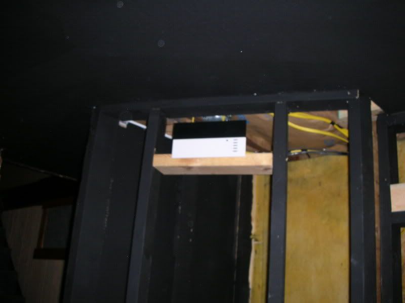

NTGRX 1S--Just want one remote wall switch at top of stairs that can turn everything off and on as needed.

1. Do I have the correct remote switch for the GE...Just simply to turn everything off and on?

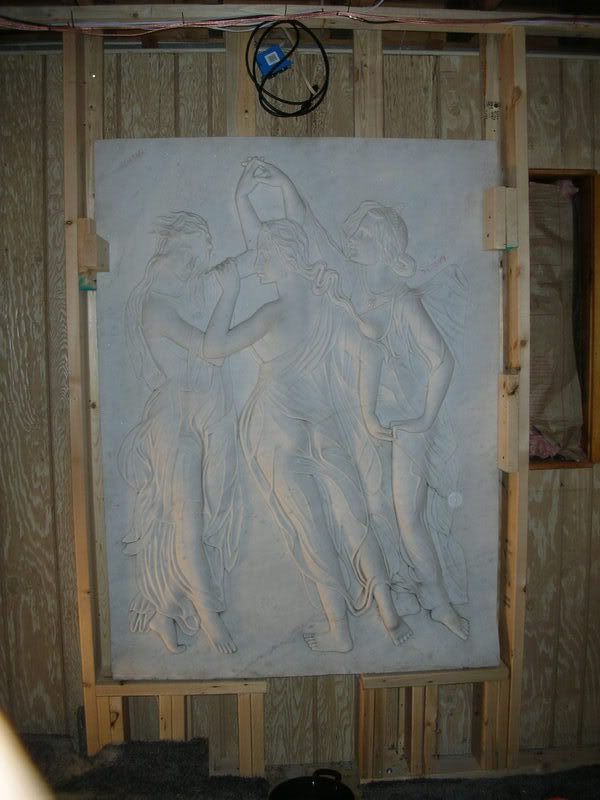

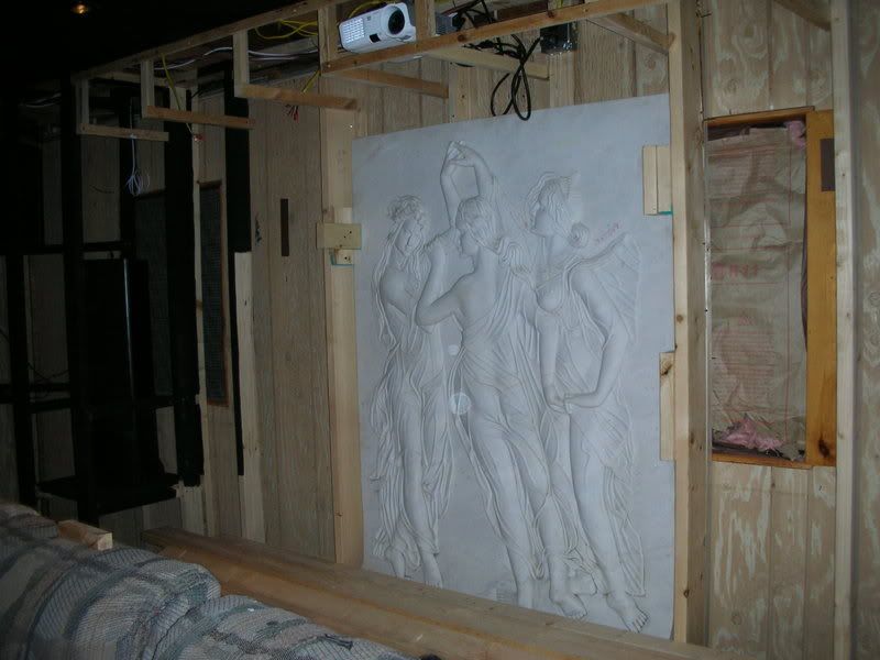

The wife found me a picture of the relief.
Relief is approx 6' tall, 4.5' wide and 3" thick at the top (not including the sculpture itself.

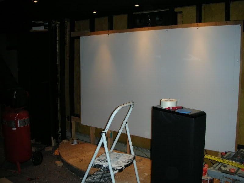

1. Screen wall is now totally framed. Heat ducting relocated. Audio rack in place. All audio/video wiring is ran. Stage is full of sand. It's too dark down there for me to take a good picture but I will once I get some lights in.

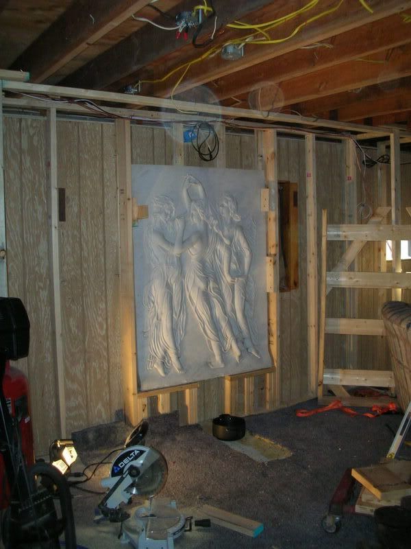

Here are some pictures of the progress. They are with the flash. More to come when I get some real lighting in.
Audio rack area:
Towards the stairs:
Wide shot:

The company that was going to move the relief backed out at the last minute. I ended up moving it with my kids and some of their friends (5 200-250 lb kids), myself and my next door neighbor (in the pictures above running the mill). Basically, we crated the relief in 2x8 lumber. We attached 3 steel loops into the crate edges. 2 on the top, and one down low. We bought down a roll back car trailer. We put the crated relief up on 2 car dollies and pulled it onto the trailer with the winch. As the relief can only be moved on edge (not layed down), we strapped it standing up right in the middle of the trailer. I backed the truck and trailer down to the entrance door and we rolled the relief in. We removed it from the dollies. Uncrated it, then put it back on the dollies. We rolled it directly in front of the cut out and used a heavy car jack to lift and then slide it into the framed wall. When I framed I left a 12" gap in the base so the jack could slide in. I also cleaned the relief with a microfibre towel and soap and water. It did wonders but there is still more cleaning to do. I have been told to use hydrogen peroxide, but will look into this more.
A little closer shot before it was cleaned:
I finally finished all the framing. My younger kids helped by painting all the framing black. I ended up with a WilsonArt Screen, backed by 1/4 plywood. The picture is really good with this screen.
The front wall is covered with 1" fiberglass. The stage and landing are 8 3/4" tall and filled with sand. I couldn't believe that sand was $4 a bag. I ended up using mostly chipped flagstone and then filled with sand. I used 8 bags of playsand total, and about 2 yards of chipped stone.
The original walls are 3/4" wood paneling. Its something like barnboard.

A shot of the projector and soffit (not totally complete). The picture also shows the relief after cleaning. I based the dimensions of the soffit on the projector. The soffit is only on the rear wall above the relief. It's 9" deep and will contain 2 lights for the relief. I am leaving the entire soffit hollow (lights will be enclosed) and will trim out the front of the projector.
The ceiling was a nightmare. The old ceiling was suspended and all wiring, phone etc was ran under the joists. We moved everything up and got the room ready for drywall ceiling. I ran a 2" plastic conduit front to rear for future wiring.

I ended up using a Lutron Grafik Eye after all. It's a 3104. I did however run 3 lights not with the GE. They are on a simple switch so my wife/kids dont need to mess with the GE to have some light. I also mounted it up high so no one messes with it. It will be behind a removable cloth panel.
We also had a new circuit run for the theater. Most of the lighting (except the 3 lights not on the GE, and the audio/video gear are 70amp box. Currently, it has 2 20 amp legs to the theater.
In all I used 3 lights in front of the screen. I left these 10" out from the wall, but they could have been further. Probably 16-18". They leave a little shadow from the screen frame. There will be 2 lights over the relief. I ended up with 8 lights for general lighting. There are also 4 lights over the seats (slightly back). I also have prewired for 4 sconce lights. The wiring connecting the Grafik Eye is temporary for testing, and will be in conduit when its done. The ceiling is filled with R-19.
