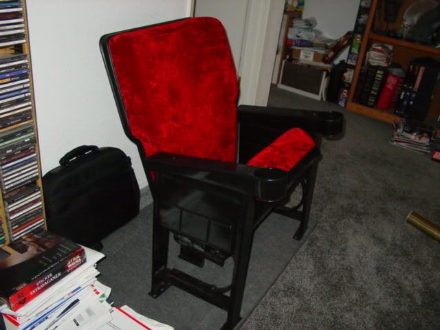

Movie Theater seat that I upholstered myself as a test:

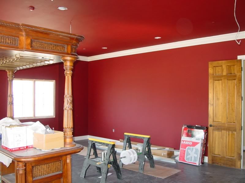

Game Room from the perspective of if you were playing pool. You can see the spools of fiber optic for the star field ceiling:

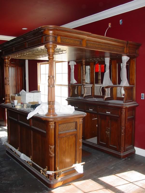

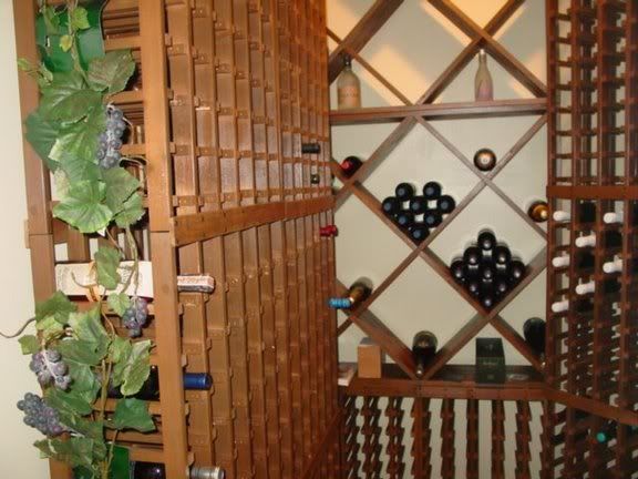

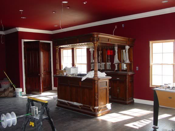

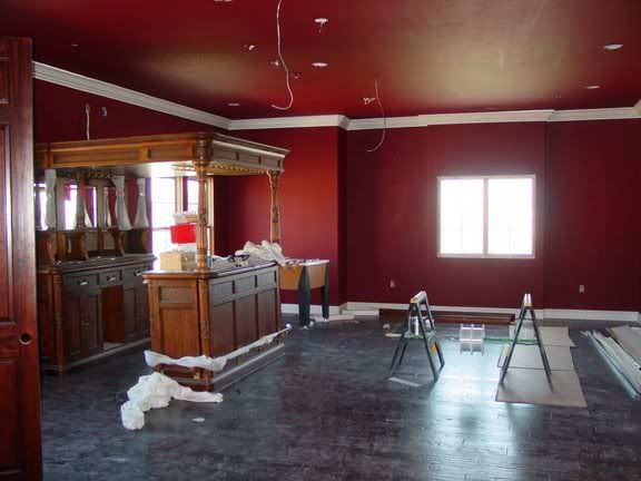

Wet Bar with sink and wine racks:
Looking into the Game Room where the pool table will be placed:

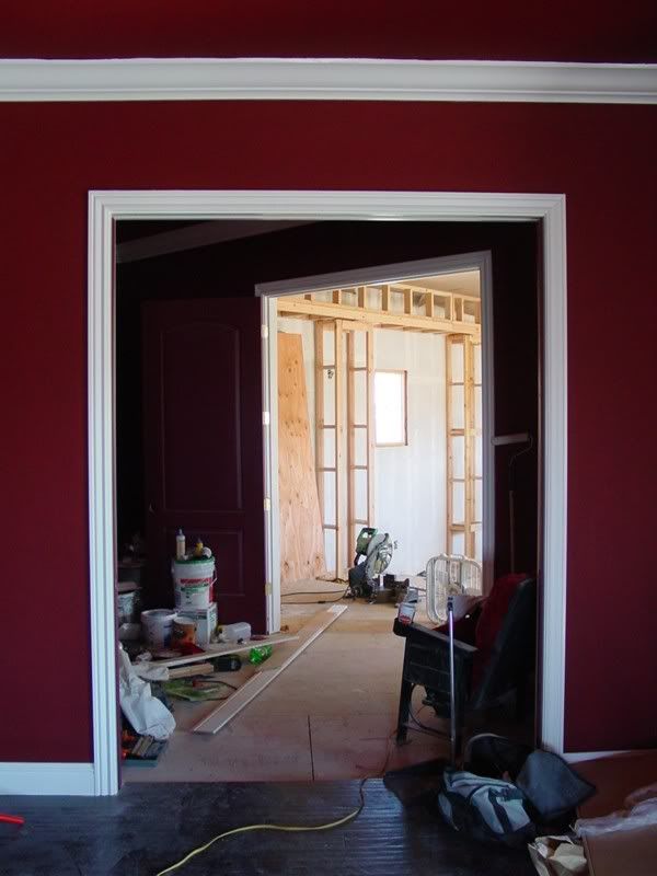

Looking into the Lobby and the double doors of the theater entrance:

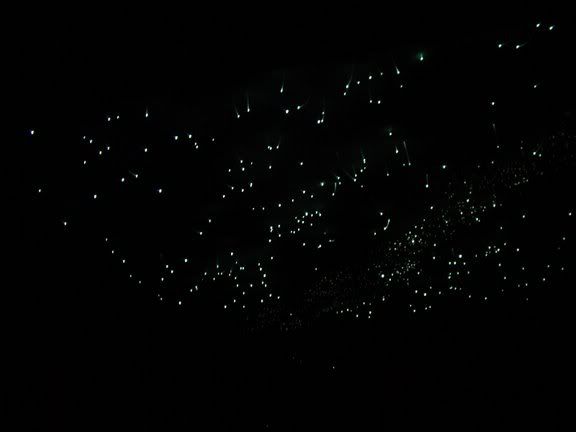

The Milky Way fiber optics start from the front left corner to the right rear corner. Constellations are placed in the relatively accurate places and the shooting stars span left to right and front corner to opposite rear corner. The strands have not been melted yet nor pushed up to be flush with the ceiling:

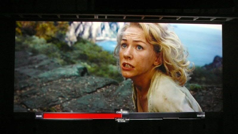

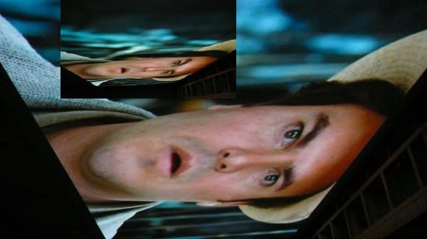

Screen shot of Naomi Watts in King Kong. This was a HD DVD source with the JVC RS1 projector:

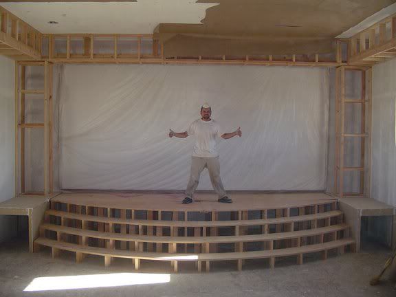

Me standing in front of the screen to provide a reference point of size. The screen is 16' wide by 90" high:

Some more screen shots using HD DVD source:
A screen shot with my other screen (2.35:1 for 8' wide screen):

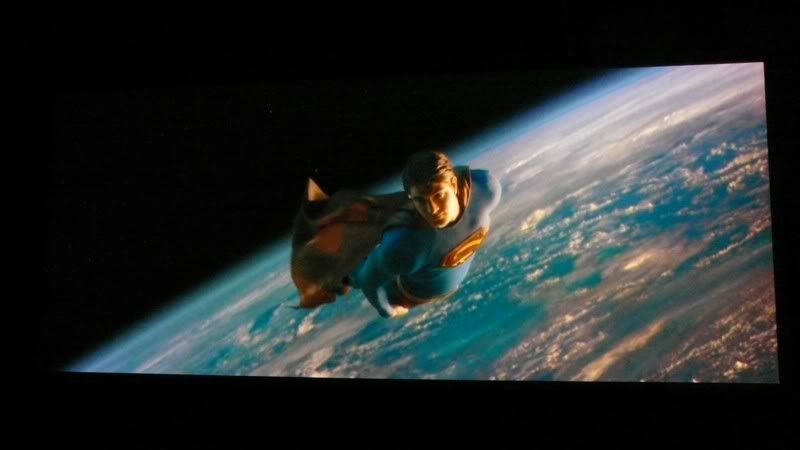

Superman Earth in background:

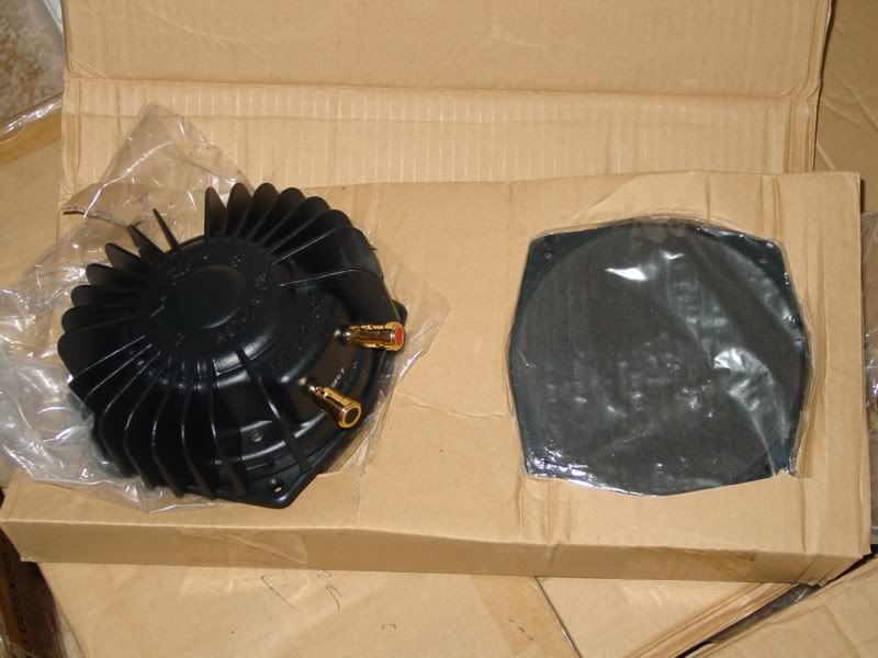

Bass Shakers / Transducers:

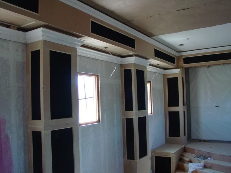

Screen, stage, and columns on the right side of the theater:

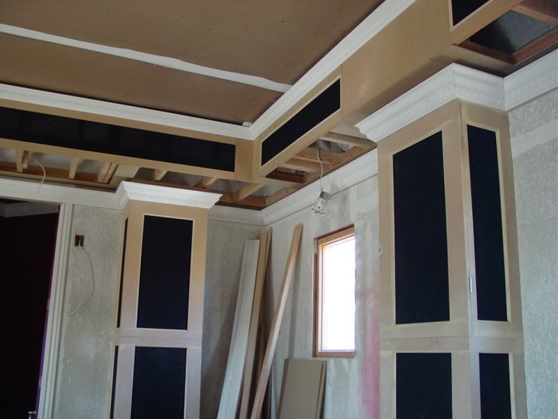

The speakers will be hidden inside the columns.
Here is a pic of the side of the column. Note the hinge.
The black panel parts are all acoustically-transparent speaker cover fabric so as not to affect the sound. We even put them in the soffits to maintain consistency in the appearance, as well as to create bass-traps.
I actually hadn't thought about the resonance of the stage. It is built of MDF, so hopefully that will absorb the vibration considerably.
On either side of the curved stage, just below the two front columns are spaces for the two subwoofers. There probably is concern about resonance since these THX Ultra2's are quite powerful. Now you have me thinking about the resonance of the stadium tiered flooring where the seats will be. Since we are planning on putting the transducers in the back, perhaps the flooring will rattle as well. I better try experimenting before the carpet is installed. Thanks for pointing that out mbgonzomd.

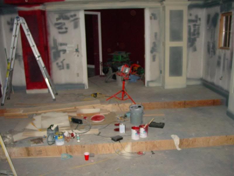

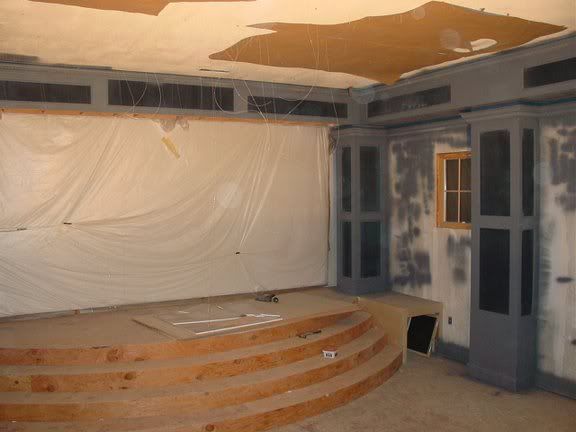

My contractor is standing on the stage in front of the screen:

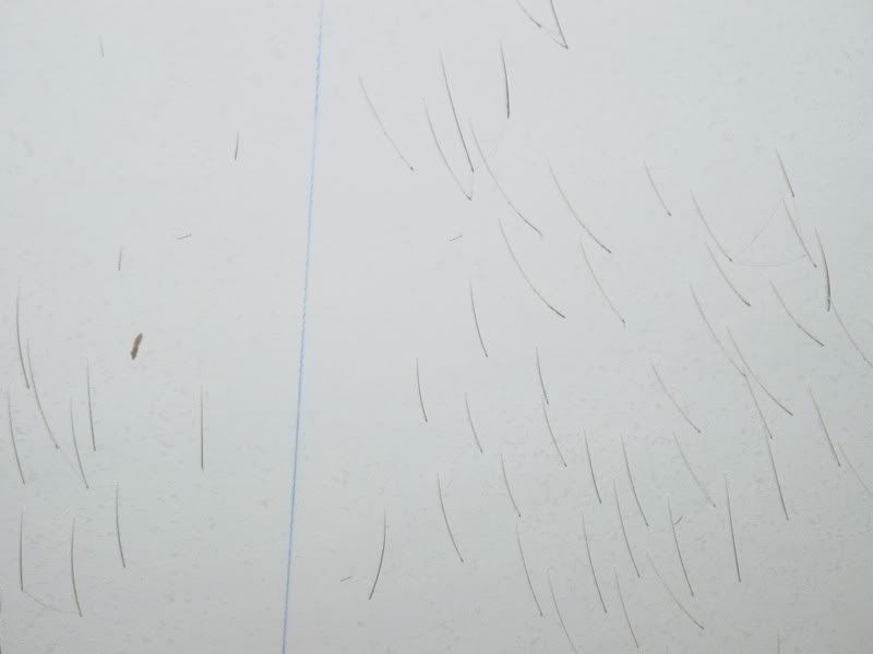

Close up of the fiber optic ends coming off the ceiling. These need to be melted so that they mushroom and then can be pushed up to be flush with the ceiling surface:

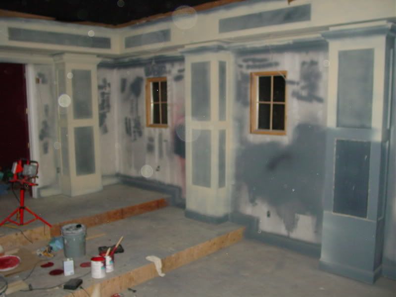

This is a picture taken from the stage. Sorry for the mess, as well as the blurryness of the images. Note the risers, and how the last one is flush with the rest of the lobby and game room.
This would be the left side of the theater if you were facing the screen. I started painting the base color of the faux. It is from Kelly-Moore and is called Tropical Straw. I paint both columns and soffits with this color, and then I will faux paint the special burgundy red mixed with glaze on top of the Tropical Straw to give it dimension and depth. It will require about 5 light coats of paint.
Here is a little bit of the burgundy red faux painted on the columns. Think "Cheesecake Factory"!
The brocade fabric will be installed underneath the soffits and between the columns, covering the windows. The double crown molding, door trim, and baseboard will be painted a glittery antique gold foil similar to the grape leaves and handrail on my staircase:
Here is a better pic of the gold in the daylight. Also note the faux paint for the beige soffits next to the sky ceiling of my living room. You can see how much more depth and visual interest it adds next to the solid color soffit adjacent to it. This will be somewhat similar in pattern to what I am painting the columns and soffits, except for the burgundy color.

I love the finish of your theater. I have a similar sized room and also use a 2.40 screen that is just over 16ft wide. My problem is that we got the room finished to a point, started using it and now it is hard to go in there and NOT watch a movie so we don't get much work done on it lately. We had the benefit of having an indoor pool that seldom got used so we did what any movie buff would do. We drained the pool, built up a stadium style room, projection booth and spent way more than we should have on equipment! I have to say it is well worth it. My only regret now is that we are needing to finish the detail work but no one wants to do it I have a few pics in the members section. Of course some things have changed since the original posts so below the link, I have a pretty updated list of gear.
http://gallery.avsforum.com/member.p...2821&protype=1
Equipment:
DPI Titan HD250
TheaterScope System with ISCO lens
Harkness Hall 2.40:1 Mini-Perfed Screen (16ft wide)
Algolith Flea
DVDO VP50
Key Digital HDMI Switcher
Panasonic BD
Toshiba HD-DVD
Toshiba Region Free DVD - Pal to NTSC
Escient DVDM300 & (3) Sony 400 disc changers
JVC D-Theater
Pioneer LD-S9 Laserdisc Player (yes I watch a disc occassionally)
Faroudja Industrial Y/C to Component Converter
Vudu Movie Download Box
Arcam AV8 Pre-pro
Sherbourn 7.1 Channel Amp
(4) Buttkickers and (2) Buttkicker Amps
D-Box 340C Controller
(2) D-Box 3 Axis Loveseat Motion Seats
(3) JBL 3677 Commercial Cinema Speakers for LCR
(8) JBL 8330 Surounds
(3) Custom Built Subwoofers
ADA 1500 Watt Amplifier
Crestron control system
Centralite lighting control
TSHA222 is offline
post #22 of 400 Old 11-25-2007, 08:50 AM - Thread Starter
calbear's Avatar
Join Date: Apr 2003
Location: Silicon Valley, CA
Posts: 222
Originally Posted by Semisentient View Post
Can you elaborate on the screen more?
Do you have any links detailing the build process, or any keywords that will help in a forum search?
The screen looks plenty bright in your pictures, is it as bright in person?
Thanks, James
Hi James,
I will use this thread to provide you some info about the screen. Here is a link which describes the build:
http://www.avsforum.com/avs-vb/showthread.php?t=854134
In case the link gets broken in the future, here is the location:
AVS Forum > Display Devices > 2.35:1 Constant Image Height Chat > DIY Constant Height > The Really BIG Picture Show
I think the screen is bright in person. I would say it is as enjoyable to my eyes as the local IMAX theater in terms of brightness.

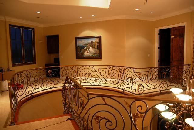

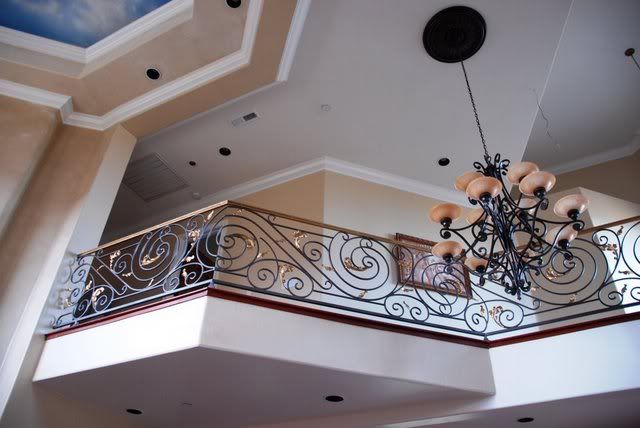

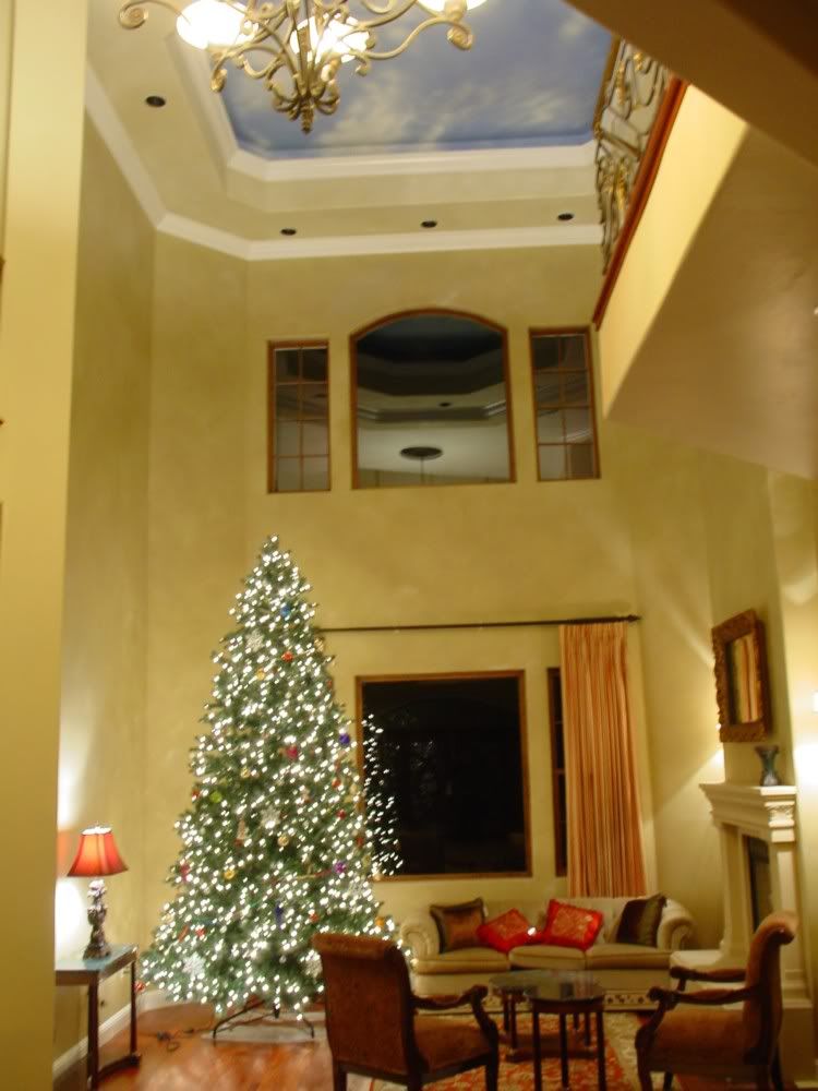

Here are some more pictures of my house...

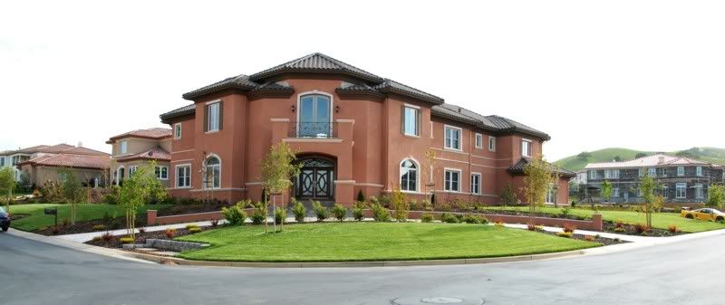

The home is located on a corner lot. Photo of the front and part of the side facing south:
Photo taken from the side:
6-1/2 car garage. 1/2 car is for golf cart if you want to drive to the golf course located in the community:
Back of the house:
Christmas photo of living room:

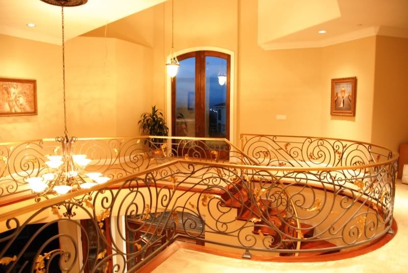

Upstairs sitting room:

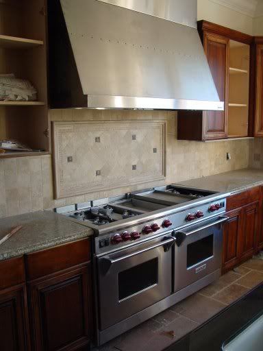

Part of kitchen where 60" Wolf double oven is situated:
Double-sided fireplace in room:
1600+ bottle wine cellar:
I should say that it may take a little time to respond back, as we have a newborn daughter to take care of. I am also finding that editing photos takes much more time than expected.
