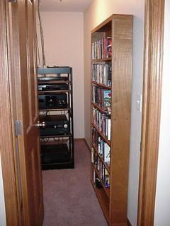

I did not put one in my eq closet. I just keep the door open when in use. However, I use an outlaw 990/7125 and it does not get very hot. Really none of my equipment does. Sure I guess if I close the door it might get a bit warm.

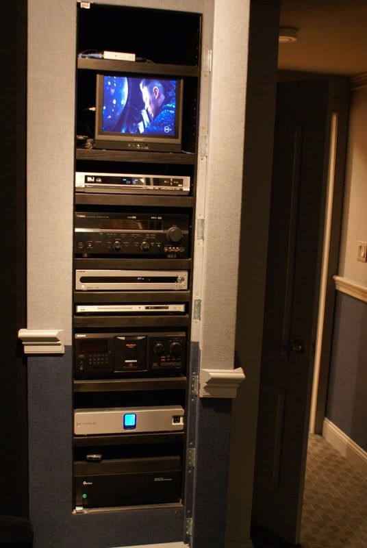

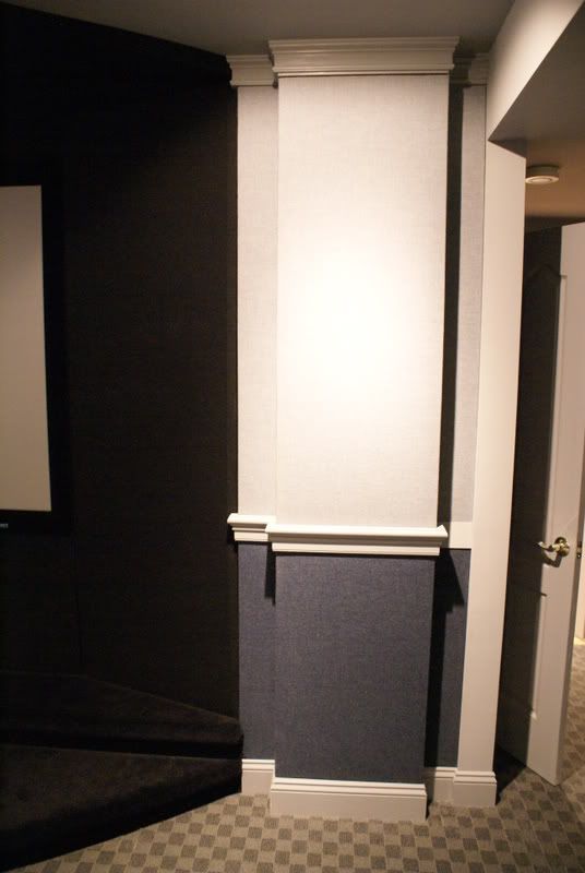

love your rack and door bigmouth. does your fan come on at a certain temp? is it a function of the fan or did you have a seperate switch for that? i like the idea of it coming on as needed. i'm trying to automate my theater without going all out, so i was wondering how to turn it on without a switch.

Thanks, It's an in-line Fantech bathroom fan connected to a Line Voltage Attic Fan Thermostat ($20) that is mounted on the ceiling and set at 85 degrees.

whisky alpha where did you get that rack and what are the dememsions im looking for tje exact same thing for my closet
That is a Sanus Systems CF55 rack. It is no longer in production, however there is a guy in NJ that has a couple for sale. Not sure of the dimensions but it is the best rack IMO. Each shelf sits on adjustable spikes and the main rack (solid steel) sits on spikes and is fillable with sand. I have had it for many many years and it has made it through many moves and I have not once has to tighten it up. IM me if you want the NJ info. I searched for one as I was looking at getting another one.
