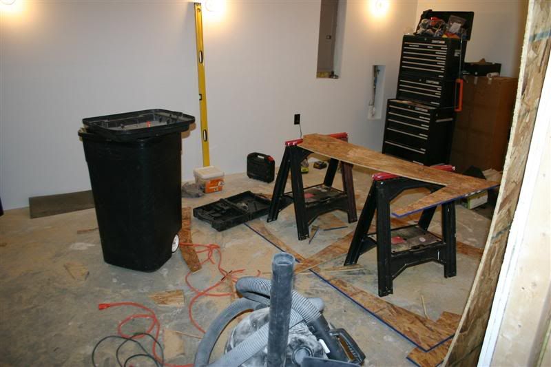

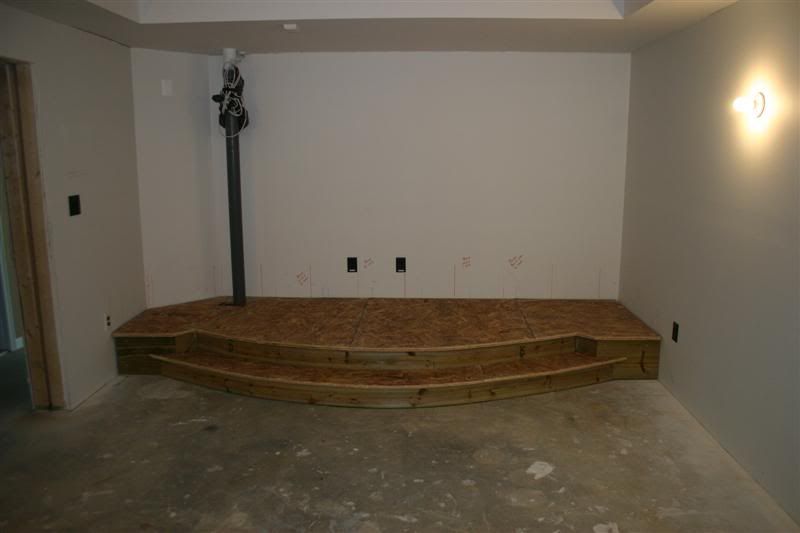

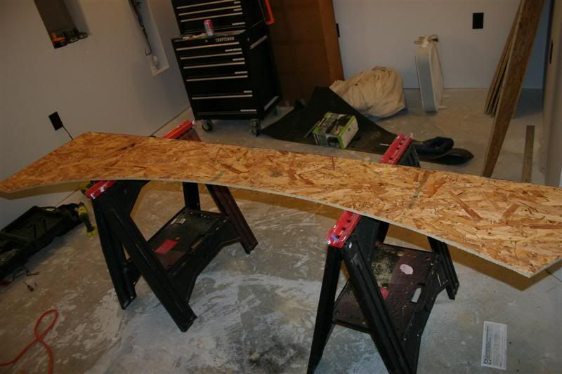

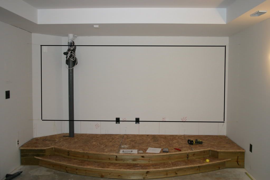

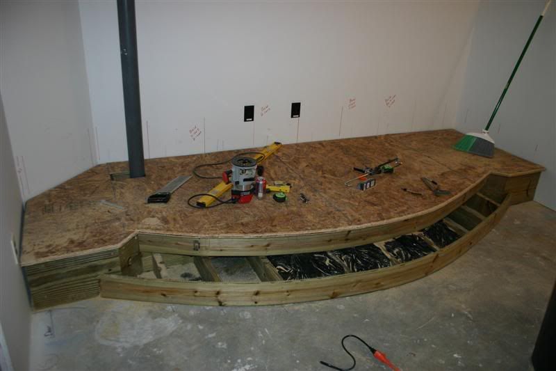

Today I finished the stage. I needed to add the OSB to the first step.
This required a bit of thought on how to proceed. I had a piece of OSB that was 22" wide and 8' long as a scrap from the bar build. I used it to make a template for the curved step. This proved a great idea.
I made the template in two pieces, a long section on the left side, and a short section on the right. I started trying to get a cut on the back of the step that joins the riser for the next step. I cut the template out using a jigsaw, and fine tuned it until it fit just right. I then took a compass, set it to the depth of the lip that I wanted the step to have, and scribed a line underneath the step. I cut this out with the jigsaw and tested the fit. It worked, so I proceeded to do the other side. I then used these as jigs for the second layer.
Once those were cut out and fine tuned, I routed the underside edge with a round over bit. I then installed the first step with liberal amounts of liquid nails and a lot of screws. Then a layer of tar paper, and the second layer of OSB, again with lots of liquid nails and screws.
I then routed the top edge of the step and cleaned up. The stage and steps are rock solid!
Next up...designing the front screen wall and the riser. Should be fun since I don't have any idea what chairs I'll use...

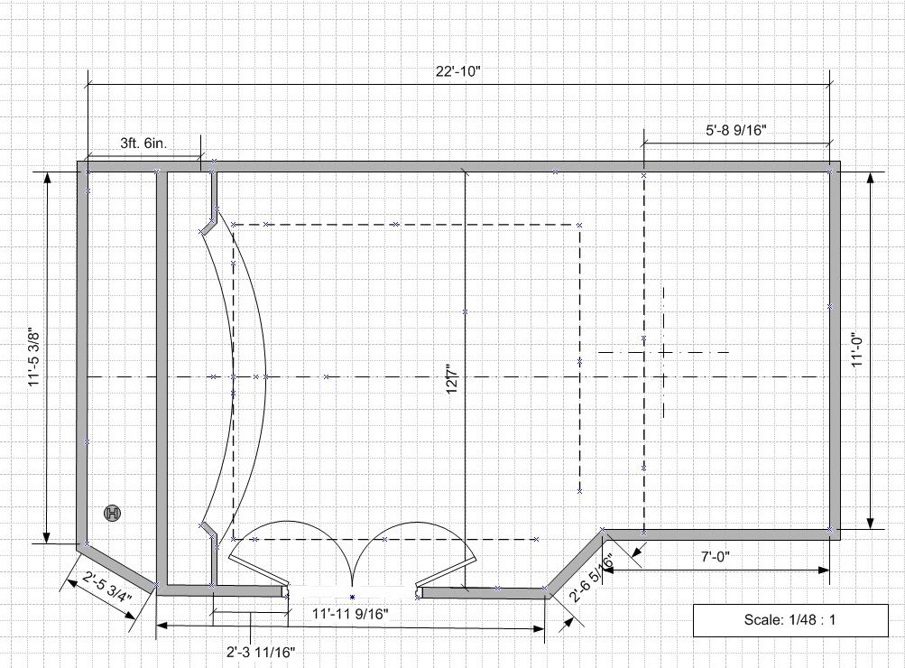

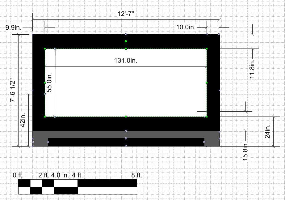

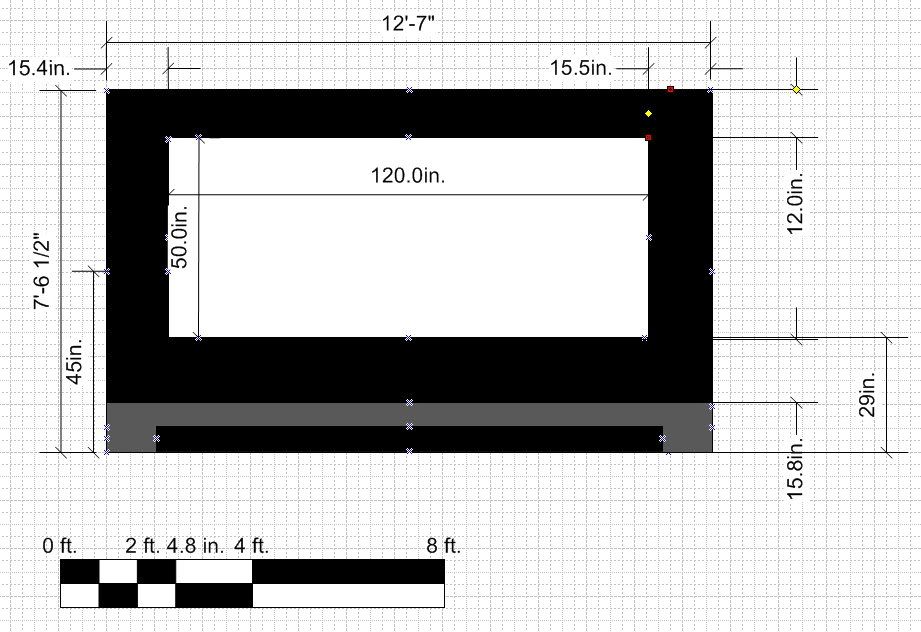

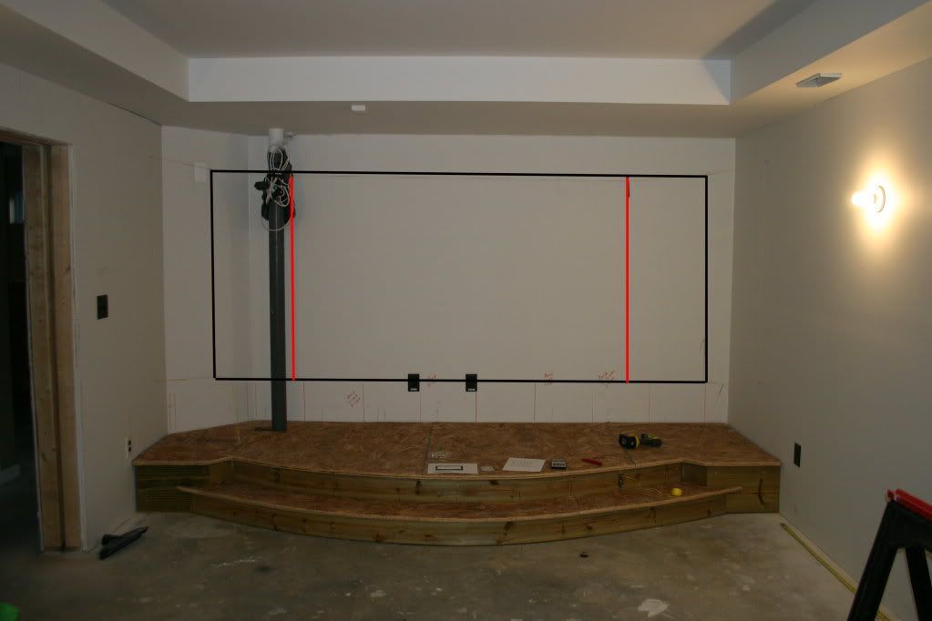

I've seen quite a few folks draw up their plans for the entire theater from the start, then build to it, making minor adjustments along the way. I'm sure this works very well, but it seems BORING! I'm the type of person who needs to experience the space before I build. I'm not able to get a good feel for the space from a piece of paper. I'm making modifications as I go along. Not the optimal method, but that's what I'm doing.
Tonight, I decided to start working on the plan for the screen wall and the room. I started by touching up the room plan that I've been using:
This includes the new stage. The dotted line in the center represents the edges of the soffits. They are 9 1/4" tall. Headroom under the soffits is 7'9", while the area in the middle and the area in the very back of the theater is 8'6" tall. The soffit over the stage slopes back a bit (I had to do it do accommodate a beam and try to maintain symmetry). At the edge of the soffit, headroom is 7'9". Against the screen wall, the headroom is 6'7" to the top of the stage and 7'4" to the floor.
The screen wall will be 26" away from the back wall. That should allow me about 24" of usable space behind the screen.

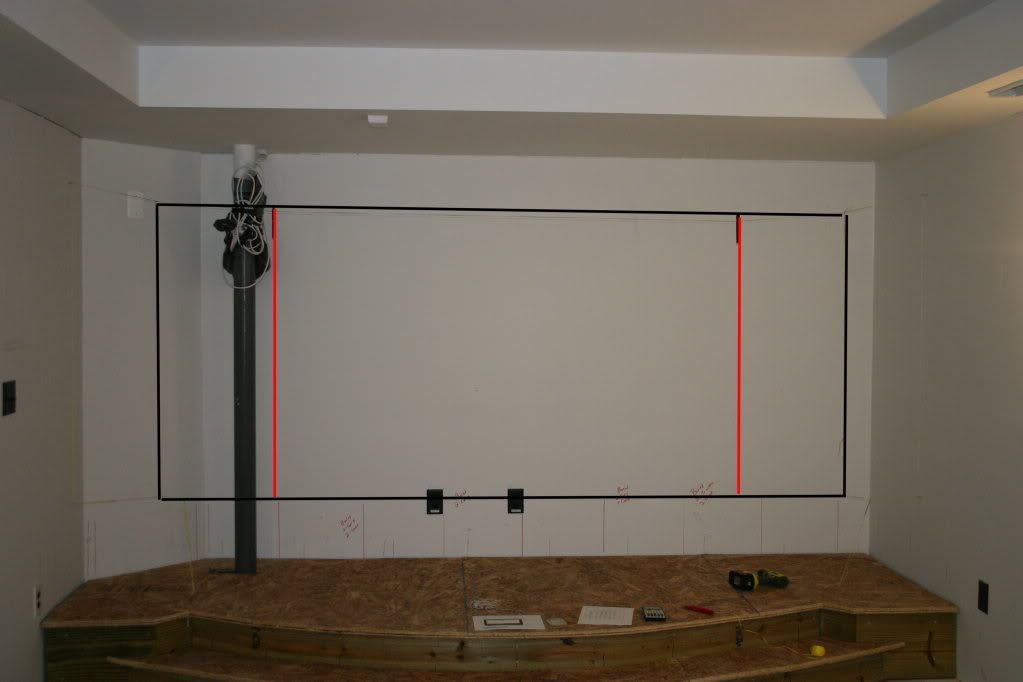

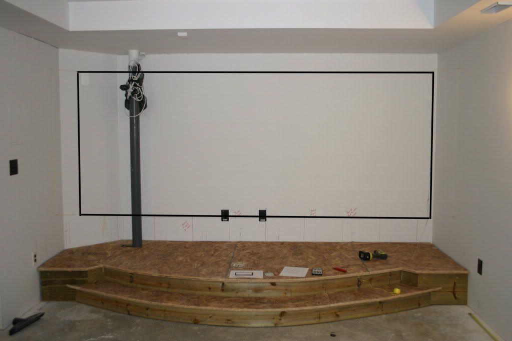

I used Michael's string trick to try and mock up some screen sizes. I'm going with a scope screen in a 2.38 to 1 aspect ratio. My current choices are 142" diagonal (131" x 55") and 130" diagonal (120" x 50"). Here are plans and mock ups of both:
130" Diagonal:
Red lines show the 16 x 9 aspect ratio (if I delay getting a lens)
141" Diagonal:
The 141" screen will leave only about 10" between the edge of the white portion of the screen and the side wall. The 130" will leave 15". We're currently leaning towards the 130" screen.

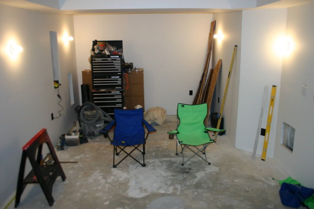

Here's our super deluxe testing seats:
They are a little low, but they worked in a pinch.
The theater will be 20' 6" of usable space from the screen wall to the back wall. The first row seating location will be between 11' 6" and 13', with the second row behind them. The first row will have 3 seats while the second may have 4 depending on the seats we choose. The projector will be mounted right behind the soffit over the space between the first and second rows. The throw distance is about 16'.
I'm going to go measure some theater seating tomorrow to help me understand how high the riser should be. I'm currently thinking that 9" should be just about right, but some measurements will confirm that.

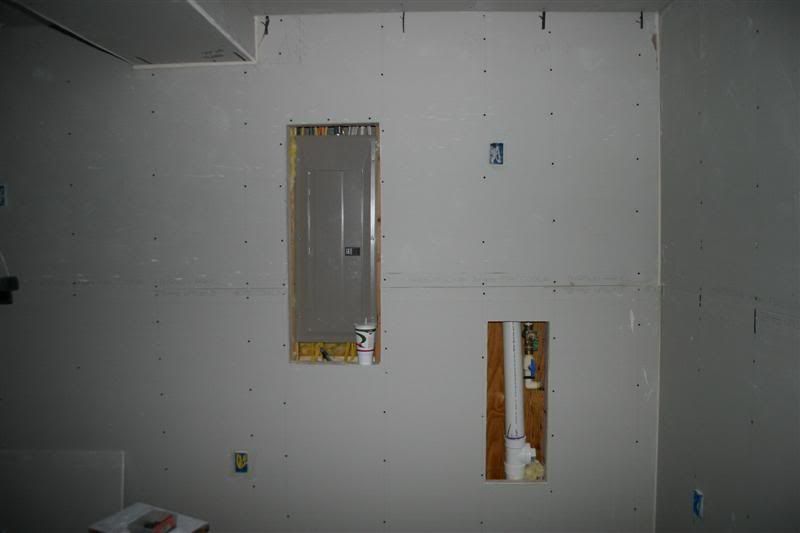

A question about your back row: In your last photo - what is that cutout in the wall in the lower left side of the photo
Craig:
The 2.35 screen will certainly help with the riser height. A 16x9 screen will be taller and will need to be mounted lower, thus requiring a higher riser. I need to see some different seats to see how all of this will fall together.
The cutout areas on the left side are for the electrical panel and the fresh water supply/drain clean out.
I'm going to cover these with a hinged panel when I do the wall treatments.

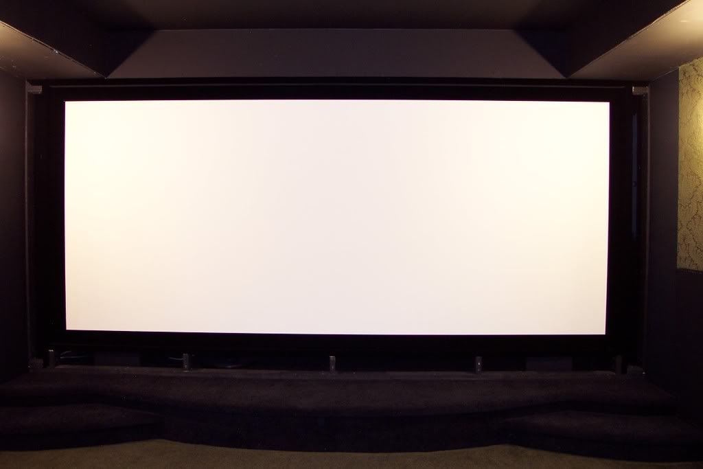

His is a 12' 2.35 SmX screen. It has a viewable area of 144" x 61" but over all its 151" x 68" screen height is the same as a 120" diagonal. The screen is 22" off the floor. ceiling is 8'4" and 7"4" to the bottom of the soffets. After wall treatments he's only got 6" on either side of the screen. Woolly's running a Mitsubishi HD1000 if memory serves. It puts out about 1700 ANSI lumens.
The 140" diagonal plan that I have has only 9" on either side of the viewable image on either side BEFORE treatments. That's not enough. We did the mock up and decided that the 130" diagonal 2.39 is what we've decided on. This is plenty large with about 15" on either side.

I think you should go as big as you can on the screen
I don't sit in the front row alot in my theater but I did this weekend and must say it was pretty awesome filling up my whole Field of vision.

I think there are a lot off guys who suffered through taping and mudding are giving a standing ovation to this picture. He is planning a starfield ceiling so that will hide all that. but for now it is functional.
I get it now. I hadn't seen that before! Well done W00lly!
CJ
carboranadum is offline

I did not tape or mud anything in the theater I just caulked everything real well. I figured I was going to be covering it all up any way so why waste my time putting on a thin coat of mud as no one was ever going to see it

Great idea!
I used the walls in the theater for practice. I filled the seams on the first level with really rough coat of tape and mud. The second coat I did the first coat of mud and tape on the walls for practice. The ceiling and soffits got three (and sometimes four) coats to get them looking really smooth.
Once I got skillz doing the walls, then I did the ceiling and then it was on to the rest of the basement.
CJ
