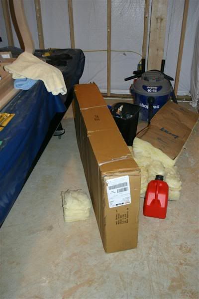

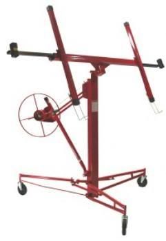

For Christmas this year, I had many items on my list for the basement. I took the sage advice of some on this forum and purchased a drywall lift from ebay as a Christmas present to myself. It showed up a week or so after Christmas.
It came in a really small box. It was quite heavy!
Here's what it looks like assembled.
I got it for $160 delivered. I figured if I could sell it for 1/2 of that after I was done, I'd be really happy.
A friend of mine was able to buy one from Craigslist for about $100..and it was all beaten up and needed three new wheels. I was really happy with the deal and felt as though I was ready to tackle the drywall.

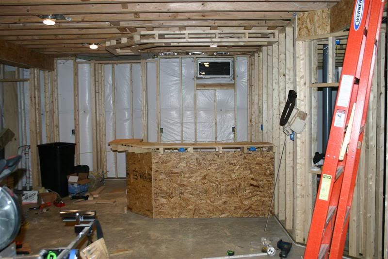

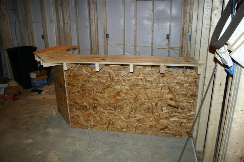

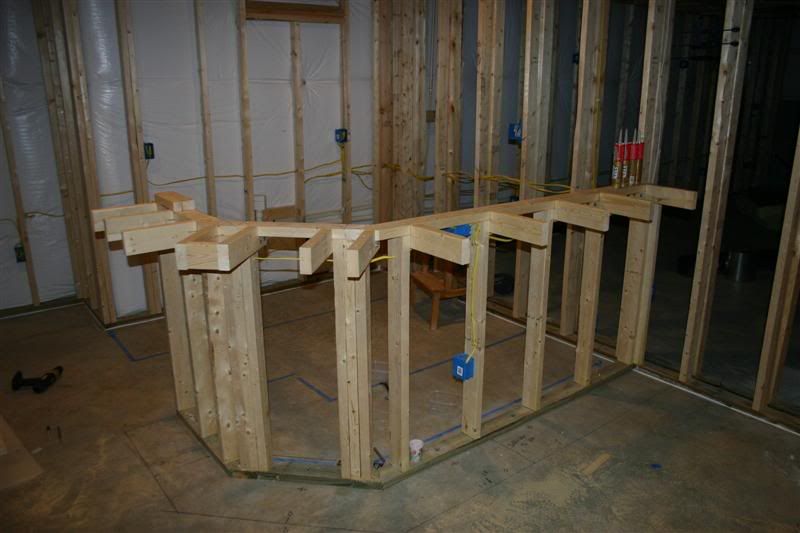

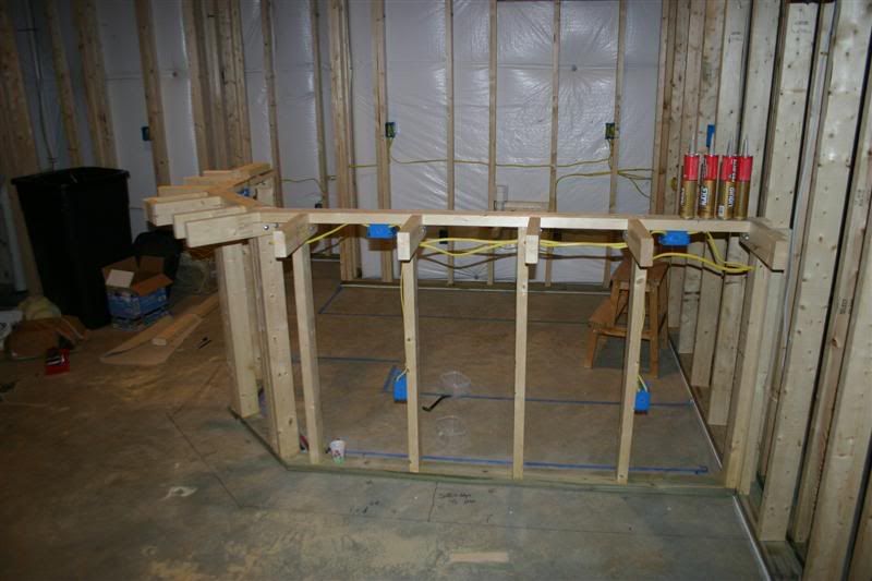

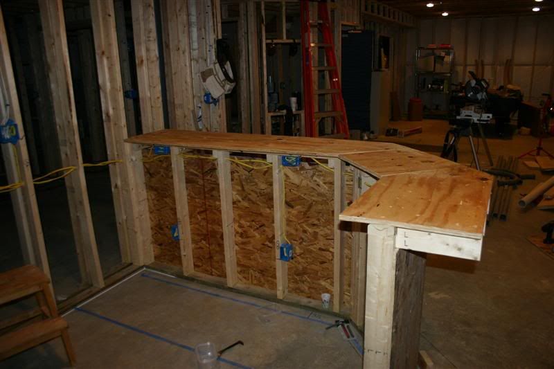

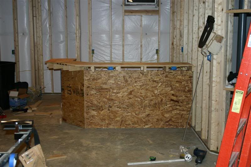

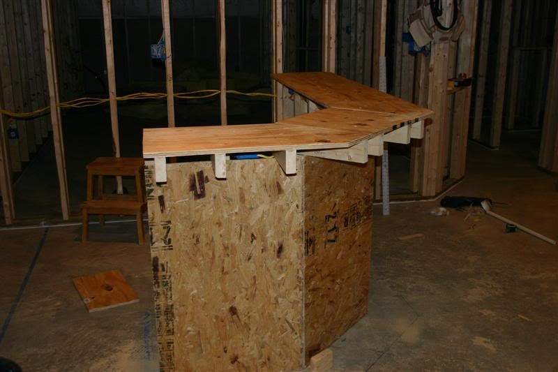

I found that I had a few hours free one Sunday afternoon (after returning from a winter camping trip with the Boy Scout Troop), I decided to tackle the bar top and front. I had some left over plywood that I needed to use, and I decided it was time to get the bar finished up.
I stole, I mean borrowed a page from HawkEyeJosh and I connected support arms to the bar wall framing to support the top. The arms were made of 2x4 lumber with a notch cut out of one end. This allowed the support to wrap around the top plate of the bar wall. These support arms were connected to the wall with 5/16" lag bolts and construction adhesive.
In addition, I added the 1/2 OSB to the front of the bar to enhance the structure. I'll wrap the outside of the bar with cabinet grade sheathing or raised panel cabinet work (as soon as I learn how to make them!).
The bar top substrate is 3/4 plywood glued and screwed to the support arms and wall framing. After a few days, I was able to stand on the bar top. It feels really sturdy. I don't know whether I'll be able to talk the wife into dancing naked on the bar, but I will know that it will surely hold her.
Here are some photos:
It may seem as though this work could have waited until the room was drywalled. I guess it could have, but I wanted to make sure that the bar top and the small soffit over it were in alignment. Also, the plywood didn't have to be carried to the garage!
CJ

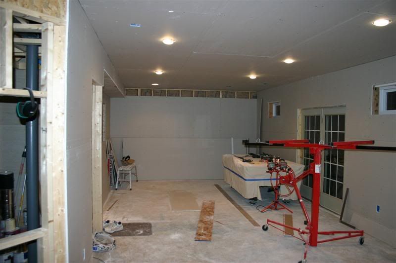

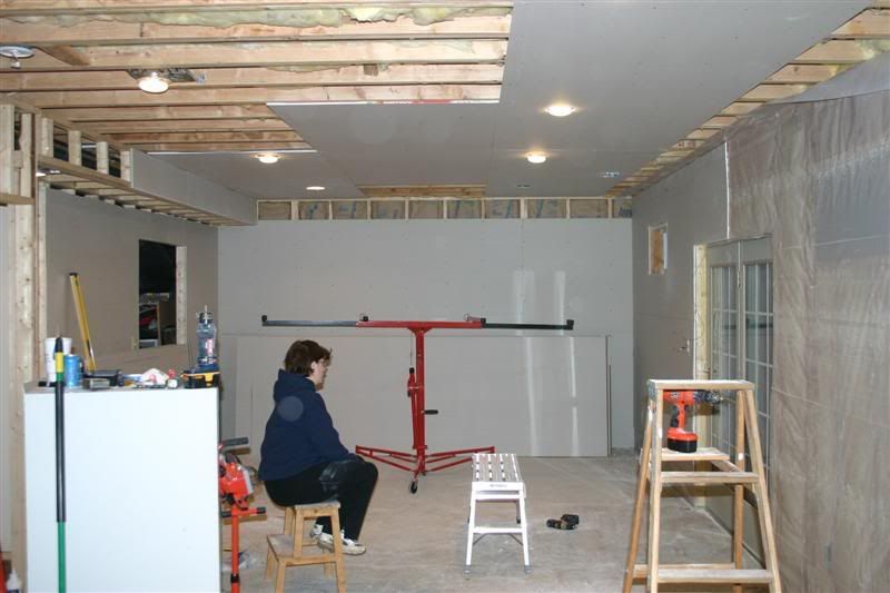

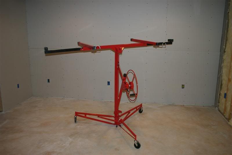

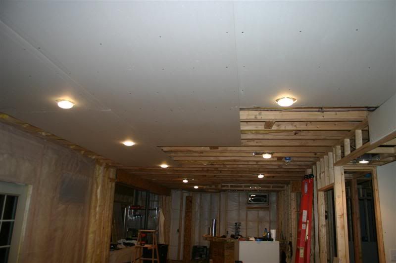

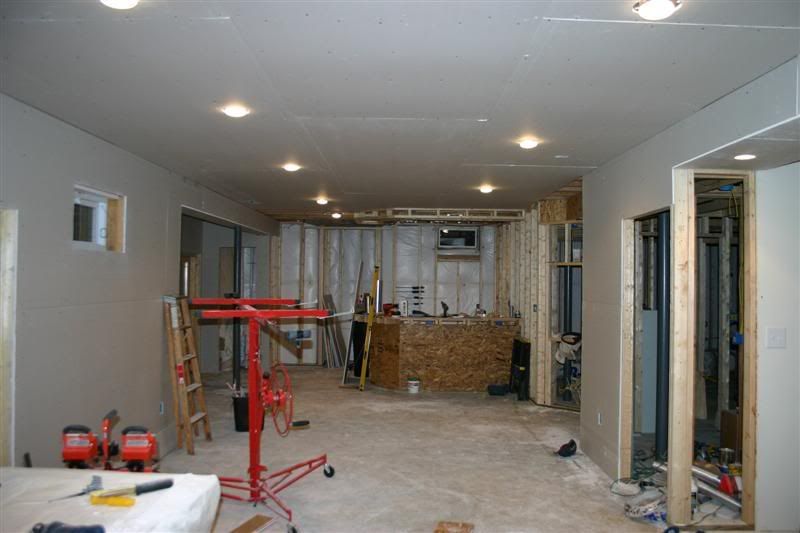

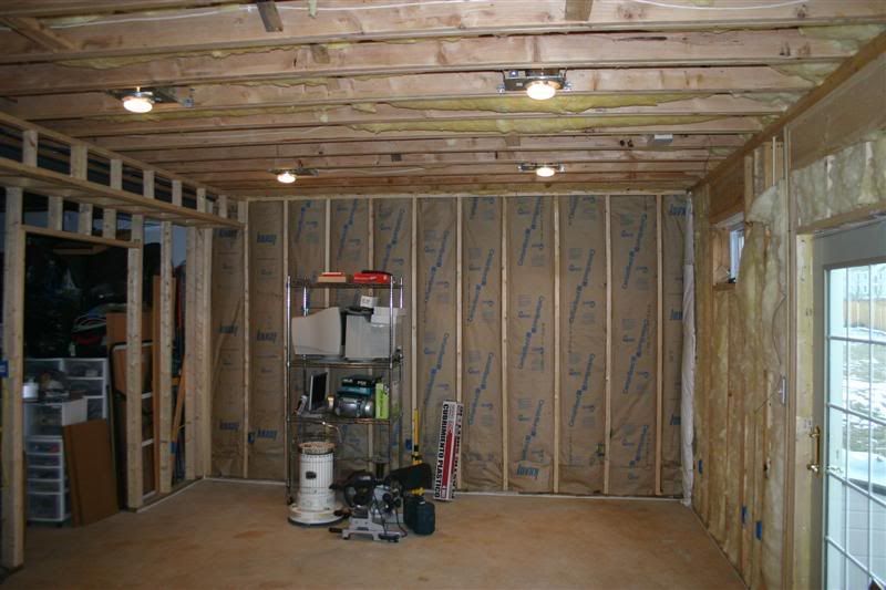

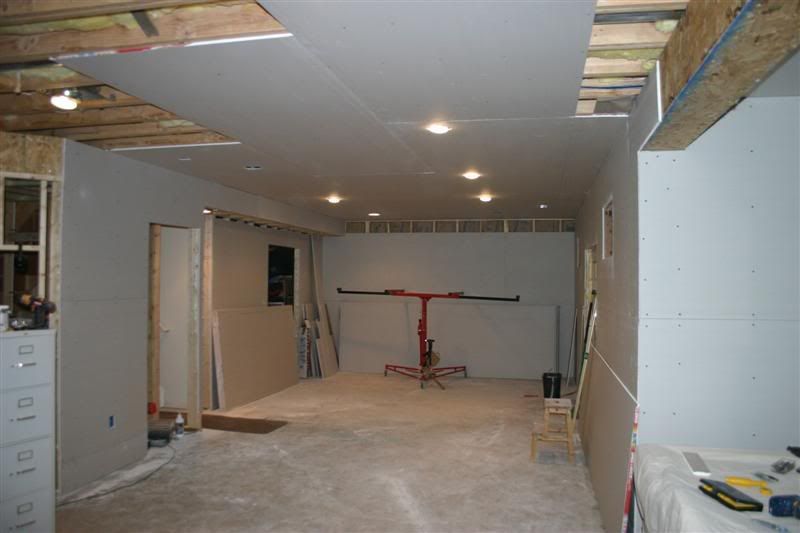

When we last posted about work done in the theater, our heroes had just finished working on the bar area. Early January found us working to get some insulation up and some drywall up as well. We made the fateful decision to work with 4'x12' sheets of 1/2" drywall for the main part of the basement. We called around to some local drywall specialty shops and the price seemed a bit too high, so we decided to purchase a few sheets and schlep it home in the minivan. It worked out, but what a pain! Looking back, I'd buy from the specialty store and have it delivered. I'd also go with 4.5'x12' sections to avoid a second seam.
Here's some photos of moi suited up to tackle the insulation (I look like the marshmellow man - wearing 80's oversized glasses). Can you believe we used to pay extra for the oversized lens blanks. Who would have thought these would make great safety glasses 20 years later!
Get the suit...it's only $10 and it really works. You MUST wear long sleeves though, as the insulation fibers penetrate the suit a bit.
Finished outside wall. It really didn't *NEED* to be insulated, as the builder had insulated part of it. I was looking for sound deadening, and it worked great. Used R-19 in the outside walls and R-30 in the ceiling joists.
That gap at the top was a rookie mistake that would haunt me for some time (words from the future).
That pretty much exhausted the few sheets of drywall that I had on hand. That was one long weekend.
Best...tool...ever!
Thank you to the poster who's name I can't remember who recommended a lift! This dude tackles the 12 footers with ease. Oh, and no one comment on the number of screws holding the drywall up. I forgot how many were required and hung it with screws every 6 inches or so. Better to over engineer I always - oh heck....you know I screwed up!
CJ

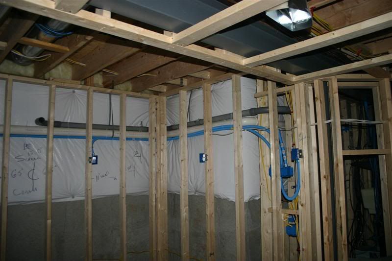

Thinking I was all bad and stuff, I decided to run the projector from a hush box on the back wall of the theater. I ran conduit and a 3" aluminum vent pipe to the projector location. The 2" conduit would be for future expansion, while the aluminum vent pipe would be to draw heat from the hush box. I don't know why the vent pipe is MIA in these pictures. I guarantee it's not made of transparent aluminum.
Here's how they looked:
From the wiring closet:
The blue smurf tubes are for speaker wire. The gray wires on the right are for the alarm sensors located throughout the basement. Teh alarm controller will reside here, once I've purchased one!
CJ

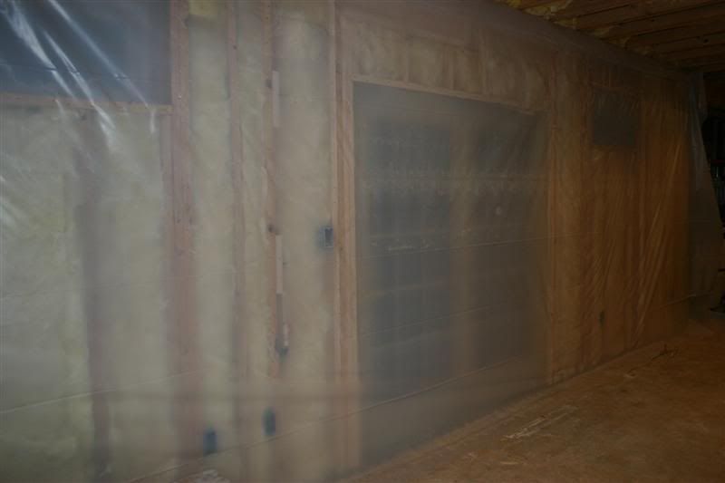

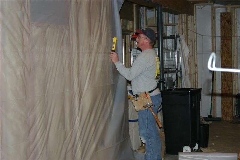

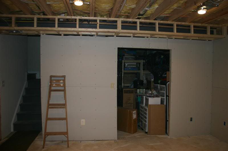

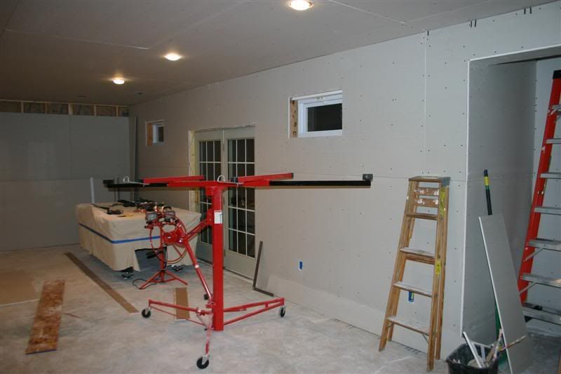

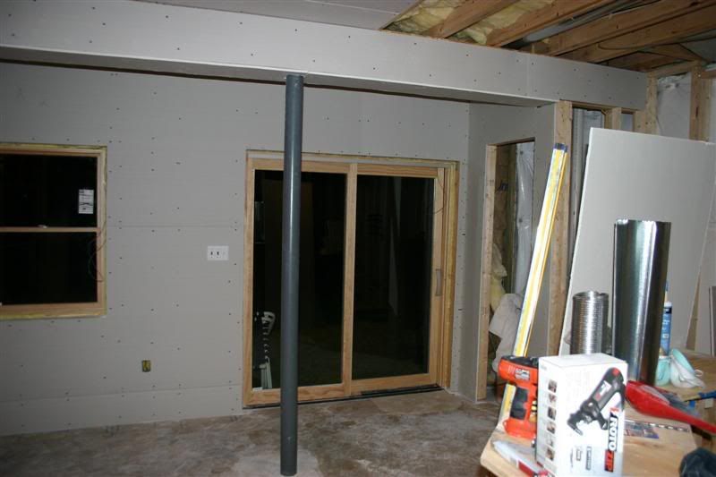

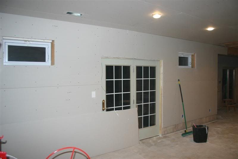

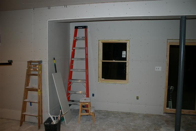

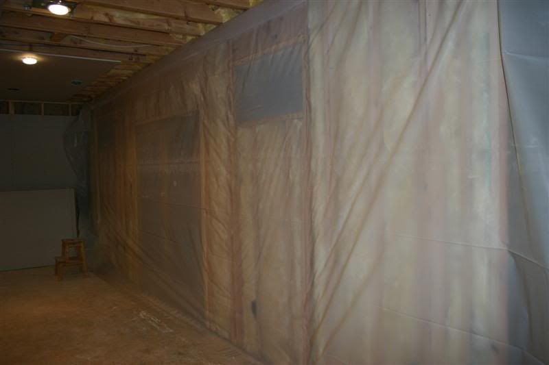

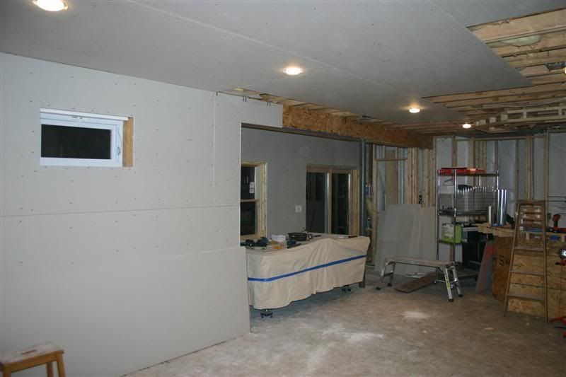

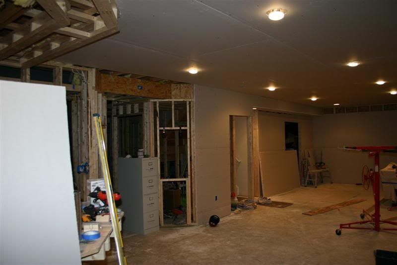

I realize that this is not your conventional build in this forum. I'm building out the entire basement, and I'm going to keep posting photos of the entire job. Occationally, I'll get to the theater, but for now, I'm honing my craft in the rest of the basement so my workmanship is top notch when I finally roll into the theater!
The next weekend (1/26/08), we hung more drywall! This involved me taking Friday off so that we could bring more 4'x12' - 1/2" sheets home. This time, we rented a truck from Big Blue and brought home 24 sheets of the long stuff, and 10 sheets of 4'x8' - 1/2". Our house has a walk out basement and we were able to back up to the back door and unload them. The wife was not happy with me after all of that work. I kept tring to convince her that it was for the greater good. I don't think she was buying it.
Here's some photos of this weekend's work. We covered the back wall with a vapor barrier and then got some drywall up.
Notice the stack of drywall peaking out from the edge of the photo?
Xs mark screws that missed their mark and need to be taken out. We found it was much faster to keep going and come back to remove these later.
A contractor friend of mine told me it would be best to have the 12" strip of drywall at the bottom of the wall as opposed to the top. His ratioale was that it would be easier to see the seam if it was up high. We began to suspect it would have been better to have purchased 54" wide drywall and eliminate a seam.
That was the end of another long weekend. I wish I could spend both entire days working down there, but there's only a few hours available here and there.

I had a few hours free, so I went down and hung a few sheets of drywall in the main part of the basement. I'm working back towards the bar area. Got a soffit around the storage area covered, the outside wall of the bathroom, and a few sheets on the ceiling.
Did I mention how much I loved that drywall lift?

Had some more free time, so down to the basement I went.
More sheets knocked out!
I feel I'm getting pretty good at this.

The work is looking good CJ. I like the bar set up, that is going to look awesome when it is done.
I know it is too late to help you out, but 54" board is definitely the way to go with 9' ceilings. Any reason you chose to hang the walls before the ceiling?

The wider board would have saved me quite a lot of time in the rest of the basement, both from the standpoint of delivery of the raw materials to the fact that I would have avoided one 12" piece and another seam.
I got a little ahead of myself and did the ceiling after the walls in asome spots. What I didn't show is that for the ceiling parts of the main theater, I was insulating as I went along instead of doing it all and then hanging rock.
That insulation stuff is nasty.
I've got big plans for the bar area, but I need to get some drywall finished and make some significant progress in the theater before I start on it.
