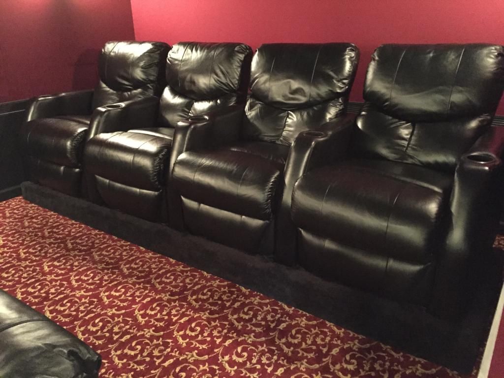

As my kids get older, their heads were popping into my viewing area more and more frequently (they are 19 and 17 now ). I also noticed that the center of my viewing area is a bit lower than I had wanted it to be. So, I built a platform to go under the back row seats. OK, I have to confess, I built the platform three years ago and finally got around to ordering carpet to cover it before Christmas. This week's project has been to cover the riser and install it.
I didn't take any photos of the covering, but I can give you details about the riser. It was 10.5' wide by 42" deep. I used a 2x4 frame and covered it with 2 layers of 5/8 plywood with construction adhesive between them. The cavities were filled with insulation. I placed it under the seats in the back row. I only have finished photos, so here they are.
This raises the seating position about 5 inches or so. We watched a movie this evening and reclined 1/3 of the way, my eyes appeared to be right in the middle of the screen. No trouble seeing over the heads of my kids. I love this new riser!

With the seats being higher, does it feel odd when you go to sit?

Yes, a bit. I really prefer the height. We'll get used to getting in and out.

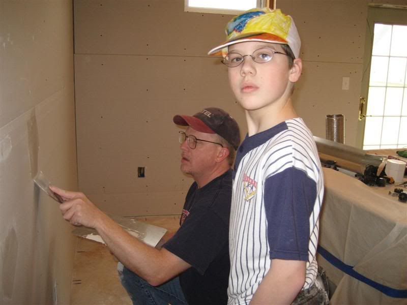

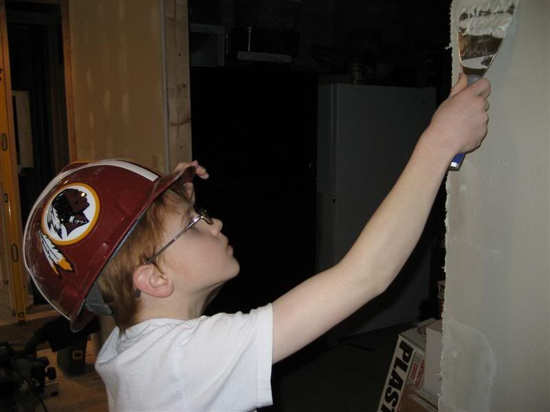

I look at the pictures of your helpers and I remember the projects that I worked on with my Dad, that is probably what leaned me in the direction of being a DIYer. And then there was the time we started to assemble the canoe kit in the basement and I asked if it would make it up the stairs, We tested the few pieces we had together and couldn't make the turn, we finished it in the garage.
