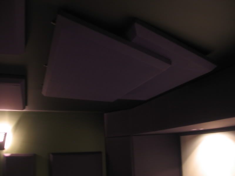

Originally Posted by GPowers View Post
very basic
Maybe one day I'll be able to get mine as basic as Greg's!!
I built mine using lumber ripped down on a table saw and filled with OC703 2". My placements were based on first reflection points, and were made to various sizes and shapes to kinda break up the 'big blocky' look (combination of 15, 21, and 27" widths) and to provide a fair amount of overall absorption:
Everything is held in place by french cleats also ripped down from 2x4 lumber, and secured on the opposite ends using three small metal brackets out of sight lines (I have some further pics/info in my construction thread if anyone is interested). Black for the ceiling was a given, but I had enough left over cloth, I opted to go black against the dark green walls as well, and it seemed to visually work out okay for me and had good WAF.
