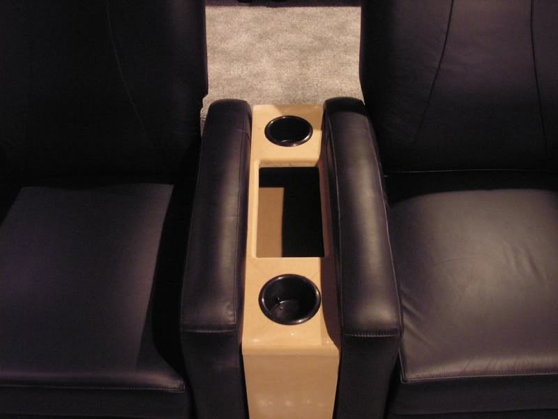

Originally Posted by scottyb View Post
First time to load pics, we'll see if I did it right.
[/IMG]
[/IMG]
Those look great!!!! If you don't mind me asking, how much do you have in one of the double cup holders?
Tony

post #33 of 51 Old 01-07-2008, 05:53 AM
scottyb's Avatar
Join Date: Mar 2000
Location: mound,mn,usa
Posts: 3,591
Maybe 15 to 20 bucks and an hour or so plus painting.

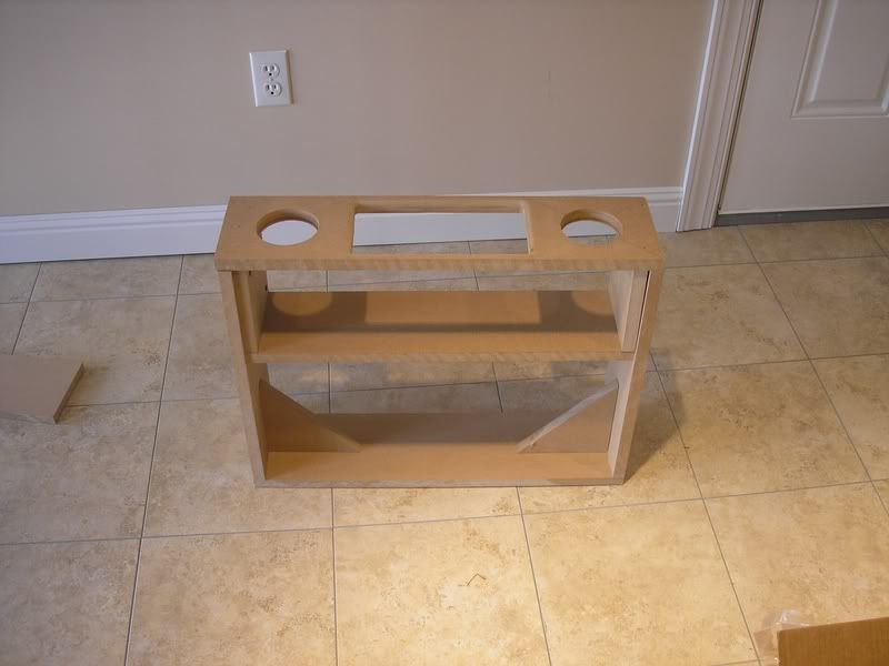

I decided to go with the table idea that I previously posted. I'm taking off a few days this week while the car is in the shop, so I thought I'd try to bang out these tables. I'll post some pictures later in the week when I begin.
Tony

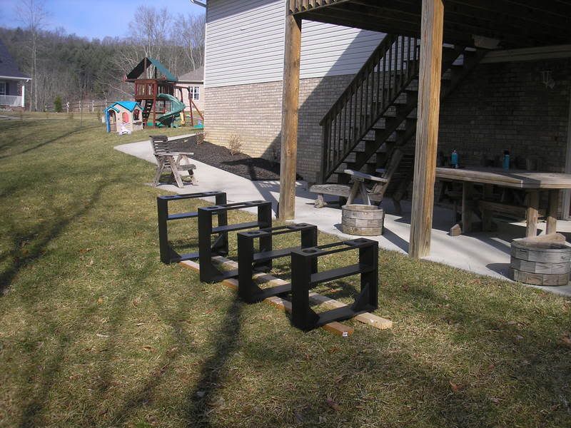

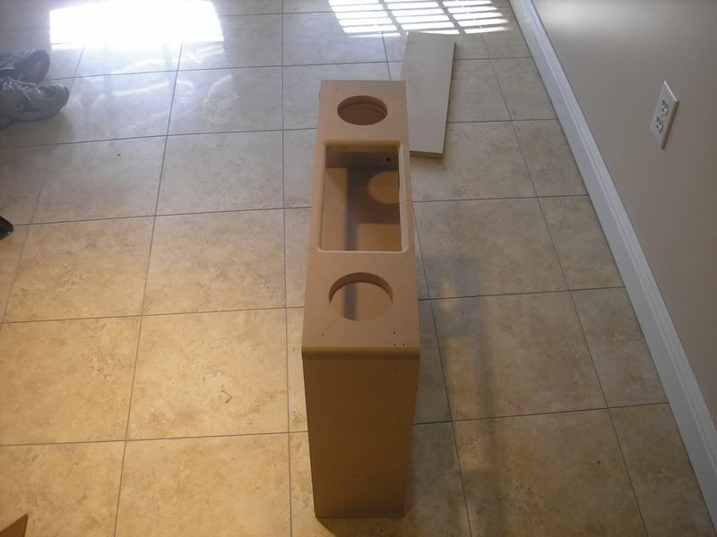

I haven't primed or painted them, but here is what one of the tables look like. I have all four built. I put them in the HT and tested them and they work and look great IMO.
Tony

Tony
Those will work out great what color are you going to paint them?
Scott
The CopperFields Cinema
          Current Photo's
W00lly is offline
post #40 of 51 Old 01-28-2008, 09:36 AM
oman321's Avatar
Location: MASS
Posts: 4,981
Quoted: 127 Post(s)
Liked: 117
Those look great, very nice.
Are you planning on closing in the sides?
oman321 is offline
post #41 of 51 Old 01-28-2008, 09:43 AM - Thread Starter
tonybradley's Avatar
Join Date: Apr 2004
Location: Charleston, WV
Posts: 3,664
Tony
Thanks! My plan is to just paint them black. My chairs are black, and the room is on the dark side anyway. I think they'll blend better with the chairs and almost appear to be one.
Thanks. They turned out nicer than I imagined. I'm not going to cover the sides at this time. They'll be squeezed between two chairs, and the height is lower than the arm rests of the chair, so you won't be able to see the sides. With the Triangle blocks at the bottom, the tables are very sturdy, so I didn't feel I needed the sides. If I have any issues in the future, or if you can see the openings between the chairs, I may do sides.

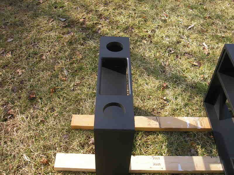

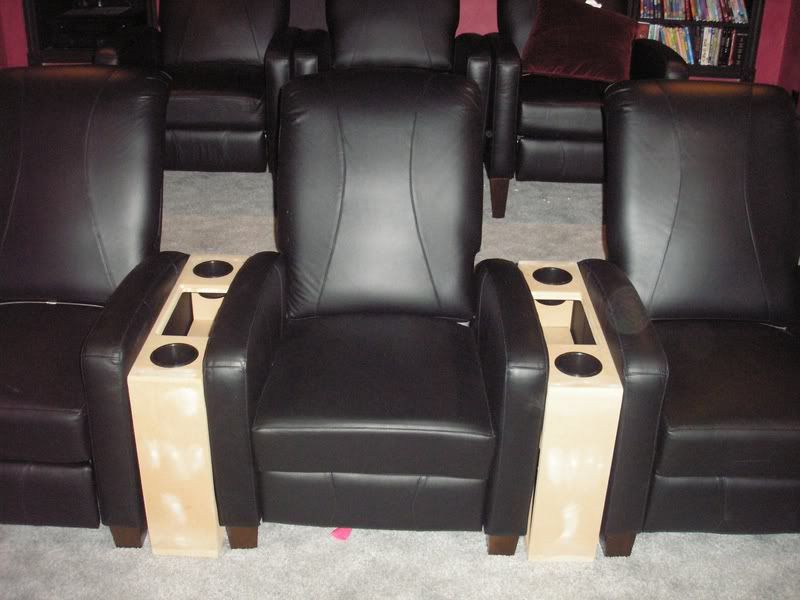

Thought I'd post a few more pictures of the tables between the chairs so you have an idea what it will look like.
Tony

post #43 of 51 Old 01-29-2008, 05:39 AM
chinadog's Avatar
Location: Knoxville, TN
Posts: 5,559
Liked: 40
Hey Tony, nice job! Looking forward to seeing them painted. Have you thought about a cover for the popcorn area when not in use? Might be a good surface area to put a remote while watching a movie if it had a cover. For whatever reason, we just don't do a lot of popcorn in our house. That area would be great for remote or game controller storage as well.
Bud
chinadog is offline

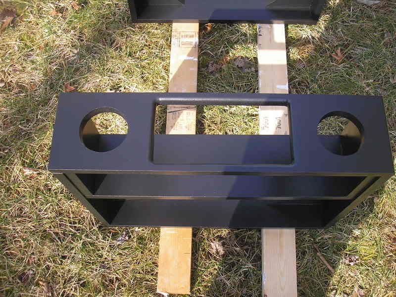

Here are a few pictures directly after putting the clear coat spray on them.
Tony

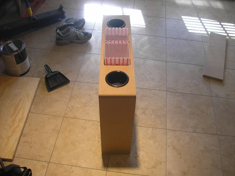

To add to Tony's thread, here is my cupholder/storage solution completed:
(Tony, thx for posting your photos, helps to see other ideas)
Background:
These 4 chairs I bought from "Billy Bobs" going out of business sale back in 2002 here in SE Michigan, they are 4 individual manual recliners, got them for 30% of retail. Sides had cupholder, nothing for middle, so making a double cupholder/storage cabinet sorta arose from necessity.
Build re-cap:
Cabinet is a Home Depot base cabinet 12" wide x 34" high x 24" deep, cut down to 24" high, cut/modified the lower door and re-mounted.
The top is leftover 3/4 MDF glued to 3/4 OSB.
Used left over formica from my subwoofer project for the top.
Maple for the side trim with clear polycoat for protection.
My original thinking was actually to cover the cabinet sides with some soft covering, possibly black carpet or some cotton w/fabric over it, to give the sides a soft feel and integrated look with the chairs.
My wife suggested just painting and seeing how it looked/felt sitting next to it. So, I painted the cabinet same as my walls, dark green (leftover paint) instead of black.
(I might call this the "leftover" project if it was my own thread, sorry for thread hijack Tony, I felt it was easy to add to your thread for others to see different solutions)
