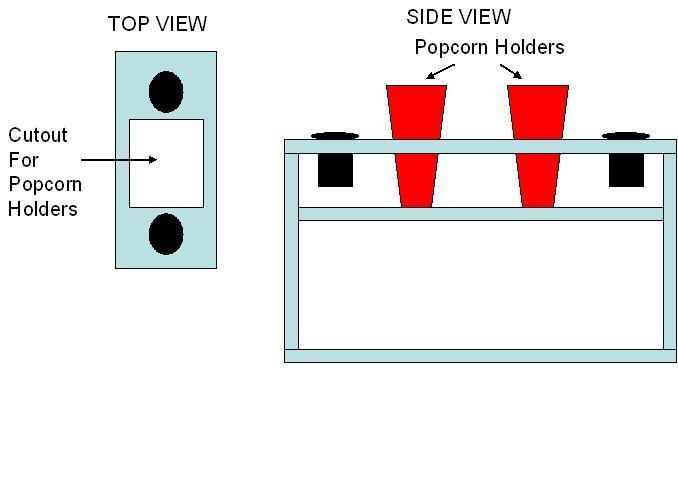

That is one that I did think of and have drawn up. After hearing the thought about the box between each chair, I'm really liking that approach, if I have the room...will have to measure. I remember seeing someone's thread somewhere on this forum a year or two, or maybe even three where they used PVC pipe to make cup holders between chairs. I couldn't find it when searching. I should search the archives.

I'd have to measure and make sure this would work as far as the size of the box. If not, I could take it down to one popcorn holder. This is really simple, but may look nice between each of the chairs.

I like it TB,
Might be uncomfortable reaching for the rear drink though depending on the depth (if you go to the back of the seat). You might try to model it with the two cupholders up front and the you'll probably still have space for the popcorn at about midway. Either way it's looking good.
Come to think of it you might consider a hybrid of the ideas being given. You could also attach the PVC cupholders to the front of the table unit with, the popcorn slots up front. Good luck.

I like it TB,
My friend said the same thing as you regarding the placement of the cup holders. He also felt it may be to cumbersome to reach in the back for the drink. My wife and I, in the car, tend to have issues with grabbing the wrong coke or water out of the center console cup holders unless we are looking directly at them. That was my only fear with placing both of them at the front of the table. Still not out of the question. Need to do some measuring. Most folks recline in the chairs, so that would make it a little easier to grab the drink in the back. The hybrid idea is an option. At least now I have some great ideas to play with. Thanks.

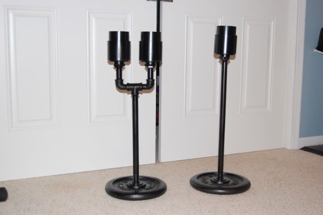

We just thought about this ourselves, and voila!
Works fine or us.....
And you can move 'em anywhere...

Tony, I'll be building tables with cupholders for between my chairs too. We can build them together out in my shop. I'll be building mine very similar to your design in post 12. You'll need 4, I need 3, though the one I'll be putting in the back will be much more complicated than the front two. Get in touch and we can schedule a a weekend to knock them out.
Chip

Originally Posted by usualsuspects View Post
Ask and you shall receive - pic courtesy of member scottyb.
OK here's the scoop on this cup holder.
I stole the idea from another member but don't remember his name.
I enhanced it though.
Instead of the total build and screwing the holder to the floor I put a 25lb weight plate on the bottom of the the pipe. This way you can move them as neccessary and vacuume under them. The reason for the heavy weight is to prevent them from being knocked over. I painted the whole thing black and it looks great.
I also invented a variation on the same plan by putting a T at the the top of the floor pipe and then put two elbow pipes and then went to the cup holder so you get two holders in between or in front of two chairs. I'll try to figure how to take a pic and post.
It sounds like this thread is going a different direction but I thought I'd post for others when they do a search.
These have helped the function of my theater a lot.
Tables are too easy to have the beverage knocked off, be it a kid or an adult.
Feel free to ask any questions and I'll try to get a pic soon.
Scott

tonybradley,
acutually after looking at your seating these would be perfect for you as you could keep your seats very close together.
If you want to go this direction send me a PM and I'll send you my number.
