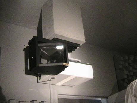

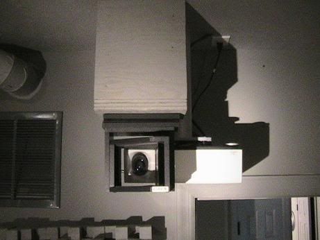

Here are some pics of my HD79 Optoma and my CAVX panamorphic lens...sweet!

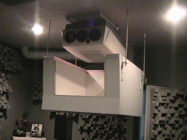

Here is the old CRT coming down, along with the hushbox of unusual size.The box was sealed and air conditioned (really just vented using a squirrel cage fan in the basement)

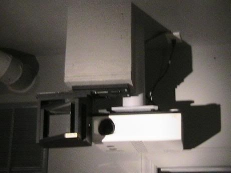

This is my simple, inexpensive, PJ mount...
You poor *******s... My GF actually said,,, "We can't put the couch there, that's where the sub goes"!!!

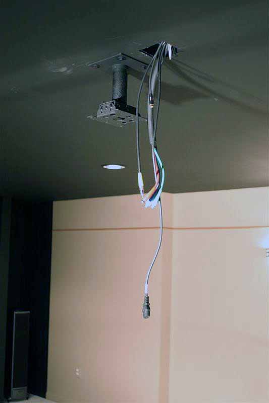

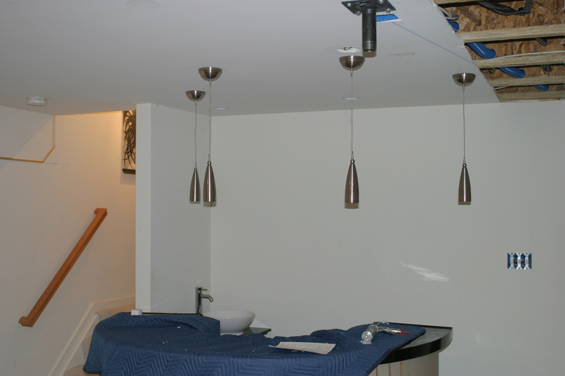

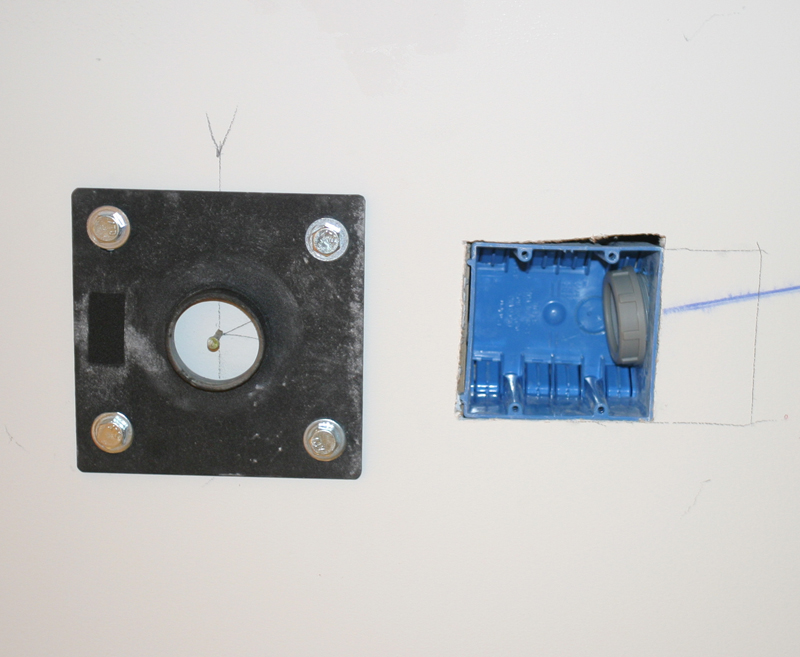

I have a Chief mount supporting a Runco CL-700 and a Panamorph U85. I used crinkle paint from Home Depot on the downrod to make it match the mount and base.
You can see the mount just on the left edge of this shot. The blue conduit holds the cables. The blue box just to the right of the mount is a double-gang electrical box.
Another angle.
Close-up of mount and box.
With projector (and me). Hole in wall behind and to the left of me is for an equipment rack.
Mount, painted downrod, and cables fished through.

My PJ and lens mount...
the PJ mount is a Peerless Universal attached to a cathedral ceiling plate. The lens mount is an old unused swivel/sliding keyboard shelf that I modded for the heavy Panamorph lens. I can actually slide the lens out to the left or swivel it out of the way. But most of the time I just keep the lens in front. The Panamorph sticker is just what it is... a DIY sticker! Tacky...tacky...!
