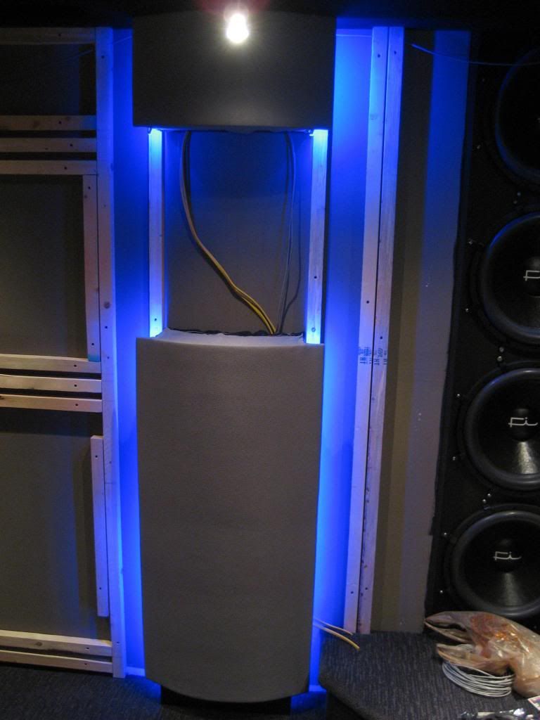

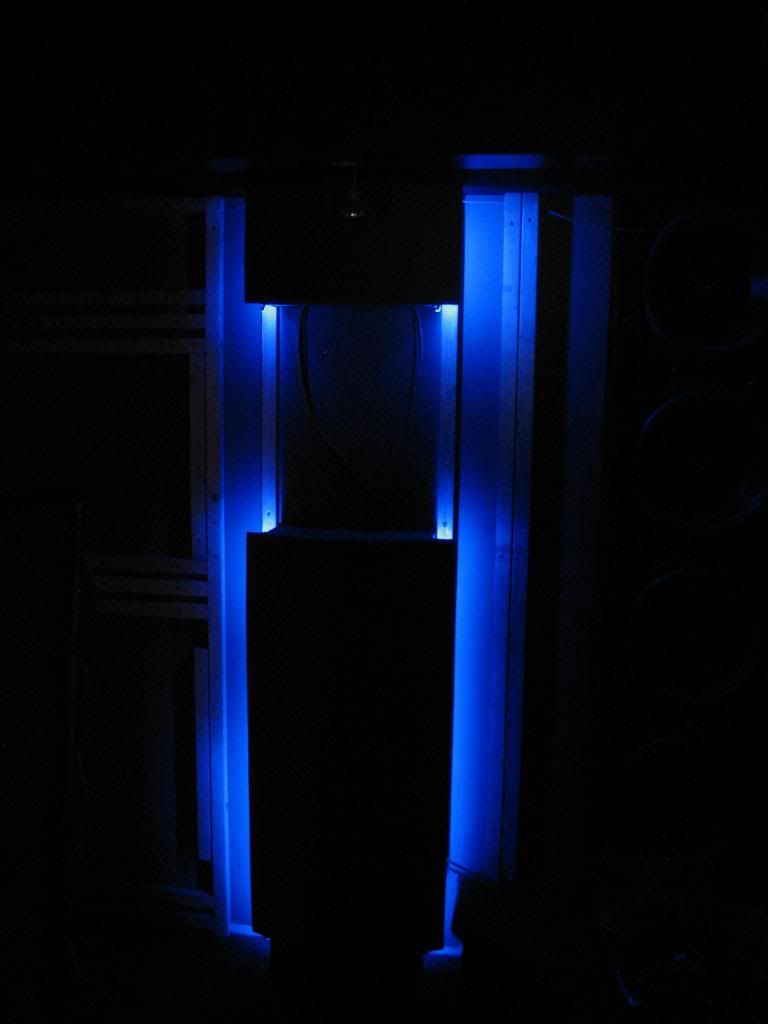

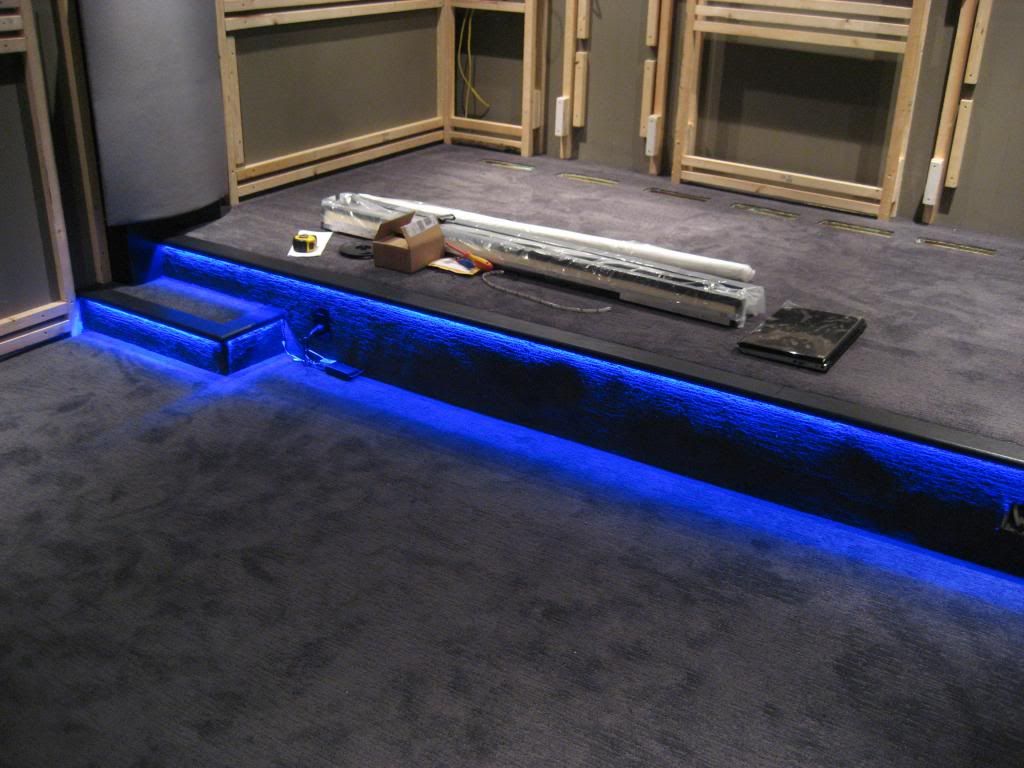

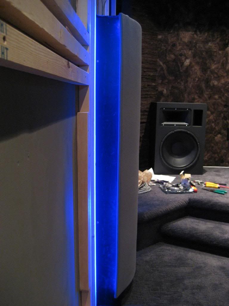

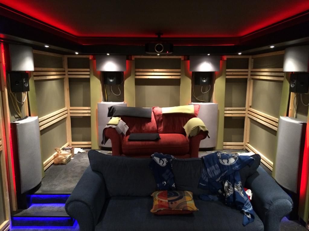

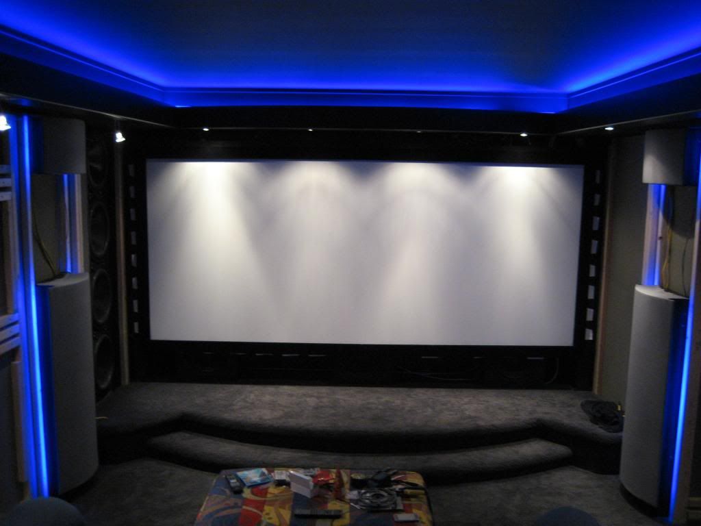

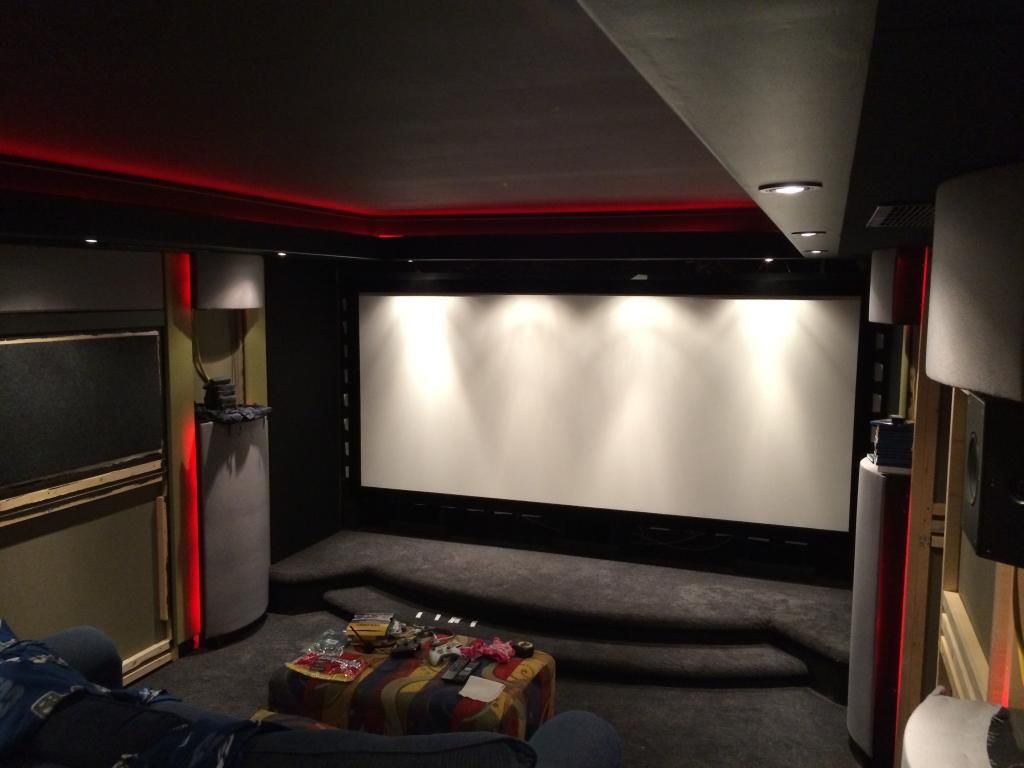

I want to share. Room isn't complete yet but I think they look pretty good. LEDs are RGB 5050 and I can do just about any color I want as well as do various effects with them. Most of the time they are all one color but I can make the soffit, step, and columns all different colors if I choose.
Riser Step:
Columns:
Soffit:
Current Room Status:

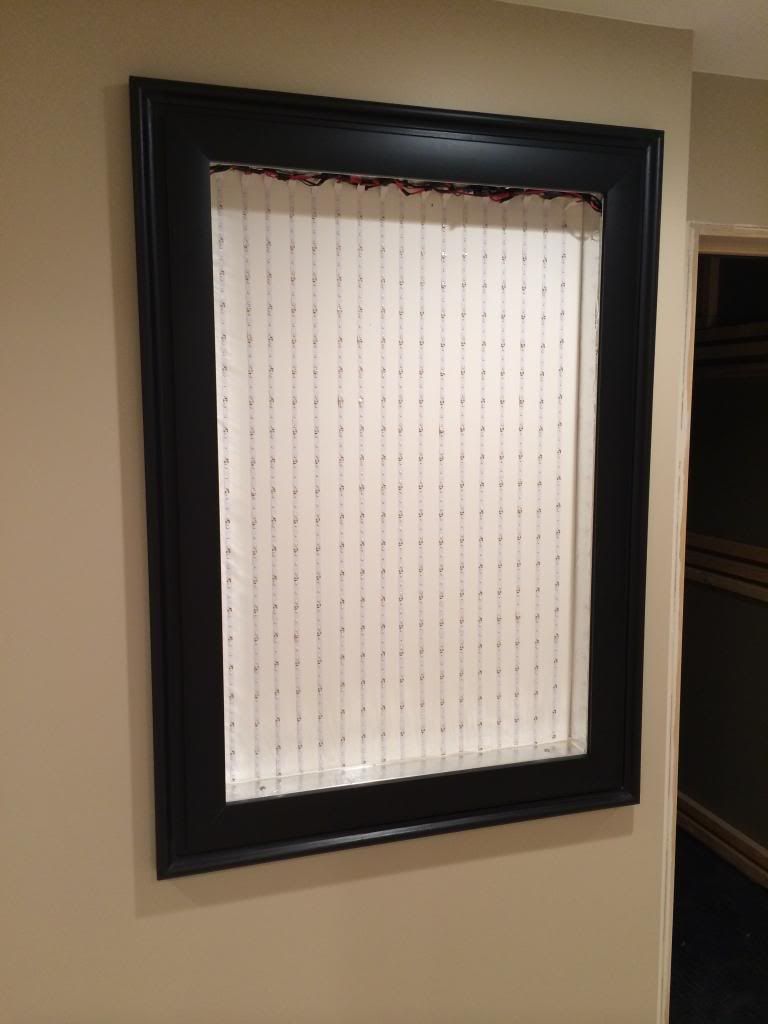

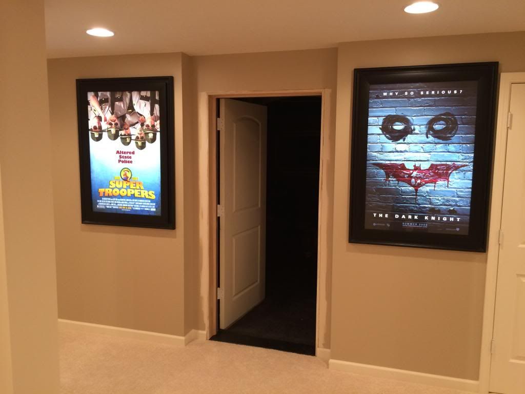

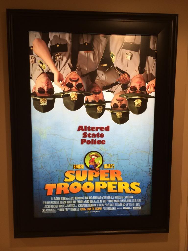

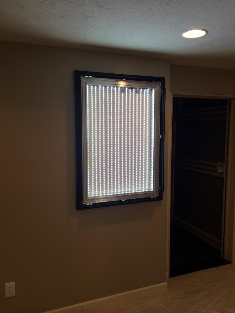

And a little side project that I also used LED light strips for:
Hopefully I'll be able to update this post in the next couple months with completed room pics.

Awesome posters of two great movies. How did you mount the LEDs under the riser lip? I want to do the same soon.

I left a gap between the front roundover on my nosing and the vertical portion of the riser. This gap was just large enough to accommodate the width of an LED strip and the thickness of the carpet. My carpet runs up the face of the riser and was stapled at the top under the nosing. The nosing was painted which helped because I didn't have to fit carpet that was wrapped over it. The sticky side of the LED strip (and maybe a little friction from the carpet) is all that holds the strip in place. I don't think I have any shots with the LED strip in there but I might be able to get one tonight if needed. Here are a couple without the carpet and lights to show the gap I started with.

Its possible I will be doing the exact same thing with select pine (stained). Hoping with pad and carpet, the results will be similiar to yours. I only have one piece of plywood for my riser floor. Hoping this extra piece in the front will make the lip of the riser more sturdy...

You'll definitely want to use adhesive under the nosing piece along with screws. I used strong construction adhesive under the nosing to hold it to the OSB. The screws you see were mainly to hold the piece in place while the adhesive set up. This will give you a very strong connection between the two and may also help with making things a little more solid. Also triple check measurements. Make sure it is where you want it because it will be near impossible to move later should you need to. I nearly made this mistake by installing the nosing piece a 1/2" too close to the riser. I wouldn't have had space for the lights which was the whole reason for doing it this way in the first place.

They look pretty bright, do most people keep their LED rope lights on or off when their watching movies?

Typically turn everything off when watching movies. I leave all LEDs on when gaming. It does bleed light to the screen but I am less critical of it when gaming. Plus it allows me to do other tasks between matches.
