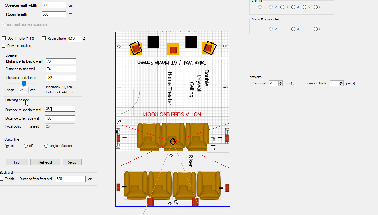

Originally Posted by wkearney99 View Post
Safe bet is put both an AC wall outlet AND a box for conduit to 'somewhere else' for control wiring. This way you're covered either way. There are such things as a 2-gang mounting box that has one side enclosed for AC wiring and the other open for low voltage. You put a double-gang faceplate over it.
A point to consider it make sure there's suitable room to hide things. My one mistake in a ceiling tray was not taking into account being able to see the outlet box from the other side of the room. Now, only I know it's there and nobody else would likely see it. But during the frenzy of planning and construction that one detail slipped my attention. The solution? I just painted the transformer stuck in the outlet to the same color as the surrounding trim!
Had I planned better I would not have powered the outlet there. I'd have pulled a conduit from the wall switch location to somewhere out of sight (in this case, the attic above) and then conduit from there to the tray. I'd have then been able to run either AC or low voltage to/from any of them. Now that the walls (exterior) are spray foam insulated I'm kind of out of luck.
As for tape suppliers, there's a lot of them. My advice, if you want consistent lighting all the across the display the purchase it as a roll of tape, NOT SECTIONS. With sections you run the chance of slight color differences between them. With one tape that's quite a lot less likely (but cheap tape can still let you down anyway).
I just watched a youtube video where the guy did a recessed outlet.
I'm a real dunce when it comes to terminology - can you explain your opening sentence more?
I wonder if I could feed the wires through the wall and have the transformers sit on the other side of the back wall.
The light rails would run alongside HVAC soffits - see the grey lines running left to right in the picture below.

I take it e* on the left/right above the seating is the intended outlet for the lighting mentioned here? I take it there's going to be some kind of soffit or other means to hide the ropes?
Recessed outlets seem like a cool idea until you realize a wall wart won't fit. I have one like that and had to use an extension. There are such things as larger recessed boxes and if you had room, yeah, that'd be great.
Yes, pulling conduit from them back to the rack's location would probably be ideal. That way you could run whatever's necessary. Just realize that this will entail splicing wires together to connect to the tape. There are plenty of kits available to make that work. Essentially you have a clamp-on fitting that goes onto the end of the tape. From there you have pigtails of wire onto which you splice your longer in-conduit wire. Snake that back to the rack (or wherever) and make the connections to the controller. Consider carefully what kind of controller you're going to use as some are RF and can go through walls vs some that are Infrared and require direct line-of-sight. One controlled via RF would certainly be less trouble than IR. Using wall-switch dimmers works, except there aren't any color-control options (at least not with a standard single-gang wall box position).
My first sentence assumed your lights were being controlled from one outlet. And that you weren't set on what kind of power/control to use for them. That being the case, putting an outlet AND a conduit serves to give you options down the road. If you put an outlet and you control it by a switch, do NOT install it with just 14/2 (two wires). Have the electrician pull 14/3 to it, leaving the red un-connected. That'd allow you, later, to potentially change from a switch-controlled light to one that required constant power. the price difference in the wire is negligible and the install labor the same.

ugh there is so much I don't understand about this! Thanks for trying to explain it to me.
I was under the impression that I would have both light rails powered from outlets at the back of the room... but then there's the power brick problem as you mention. On the one side I can probably hide that in the AV closet with no issues. On the other side I would have to figure out how to hide the power brick in the adjoining room on a shelf or box or something.
Maybe the best option is to power the strip from the AV closet and run it all the way around the front of the theater in a U shape.
As for controlling color and brightness, I was assuming that it was going to be app controlled. As I look at the options on 1000bulbs.com it looks like that's not an option at present. Seems like maybe Philips Hue would be the way to go? I feel like if that were the case everyone would be using them and I see that almost no one does?

There's no reason you have to run it in a U-shape. If that doesn't fit the plan then just run it in strips. Just pull the wires from them back to one place and put the brick/controller with them.
Color control is a mess. Smart bulbs and Hue strips is another mess. Mainly because they don't integrate well with traditional lighting wall controls. That's fodder for a WHOLE other thread.
Thus it's my advice your 'safest bet' to get you through the 'right now' situation is to run blue low voltage conduit (aka smurf tube) from the ends where the strips terminate back to the rack area.
Then you can spend some time to figure out what kind of lighting controller you're prepared to use. Even with Hue strips you could still cut the control cord going from the plug to the strips and splice it into something else. Including just using the controller with a whole other brand of LED tape. Plenty of folks have done that, ditched the Hue tape and used something else entirely.
If you run both, conduit and 14/3 you've got the best of all possible options. You can use the 14/3 now to control them with a transformed up there in the ceiling and a regular wall dimmer. You could later use a controller 'up there' that doubles as a transformer and provides color control (aka Hue strips). You'd forgo using a wall dimmer though. Or since there's also conduit you could pull whatever's necessary later to support other options.
I wouldn't run just 14/2 wired outlets controlled by a wall dimmer. That would work but you'd lose options. Since you it's being built now's a good time to future proof.
ok so my electrician is coming on wednesday (for consult, not installation) - what do i tell him? (feeling really lost right now - sorry not trying to be difficult)
Look, at the very least have the two locations wired with 14/3 instead of plain 14/2. This way you'll be covered for both local constant-powered AND for wall controlled dimming. But do this only because there's some scheduling crush. If you have the time then talk to him about it and what it would take to either run 3/4" plastic low voltage conduit instead or both. It'll likely cost you more, but it's likely cheaper to do it now rather than later.
Here's an important question, the ceiling above this space; how is it framed? Which way do the floor joists above run? Are they running across the seating (left/right) or perpendicular (front/back)? If they're running front/back then it'd be easier to run more wires later. If they're running left/right then NOW is the time to deal with it.
One other thing, who's doing the wiring for the speakers and their placement?
There are other folks on AVS that offer paid home theater consulting. It'd likely be worth spending some time/money to talk with them. If just to get a handle on all of this without stressing yourself out trying to learn it 'in a hurry'.

Electrician is coming out for consult not to install
Speakers and such are me.
Joists run left to right
Ok, that'll give you some time to get up to speed.
And you've already planned their placement? Type/gauge of wire, etc?
Well, then now's the time to get it right, otherwise you're not going to add anything later due to the joists being in the way.
I've learned over the years that unless you're SURE about the wire, there's no shame in installing conduit. For some of my more challenged locations (ones with joists in the way) I ran BOTH my planned wires and a 3/4" conduit. It's not money wasted when you discover later that you need the access.
